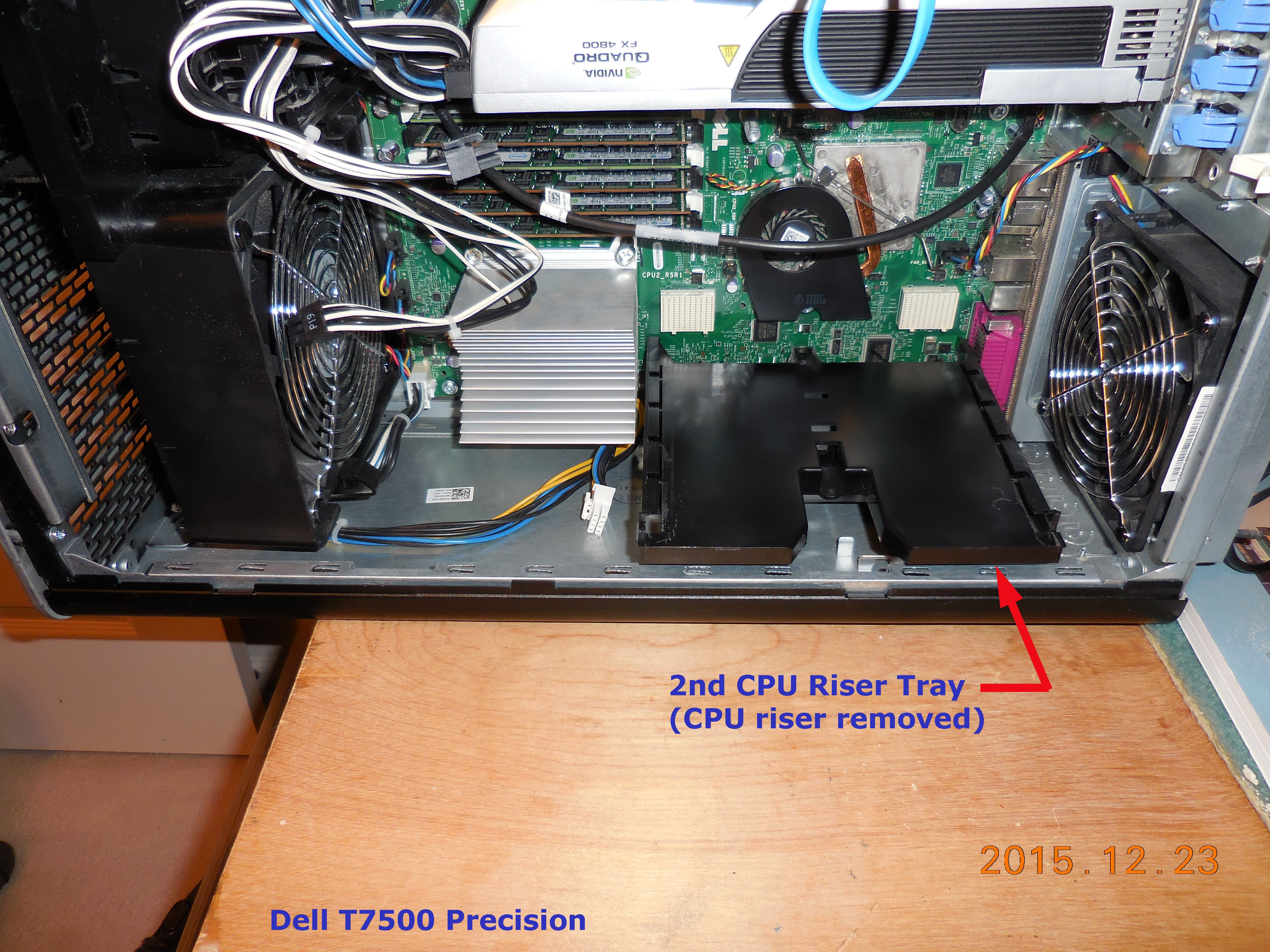

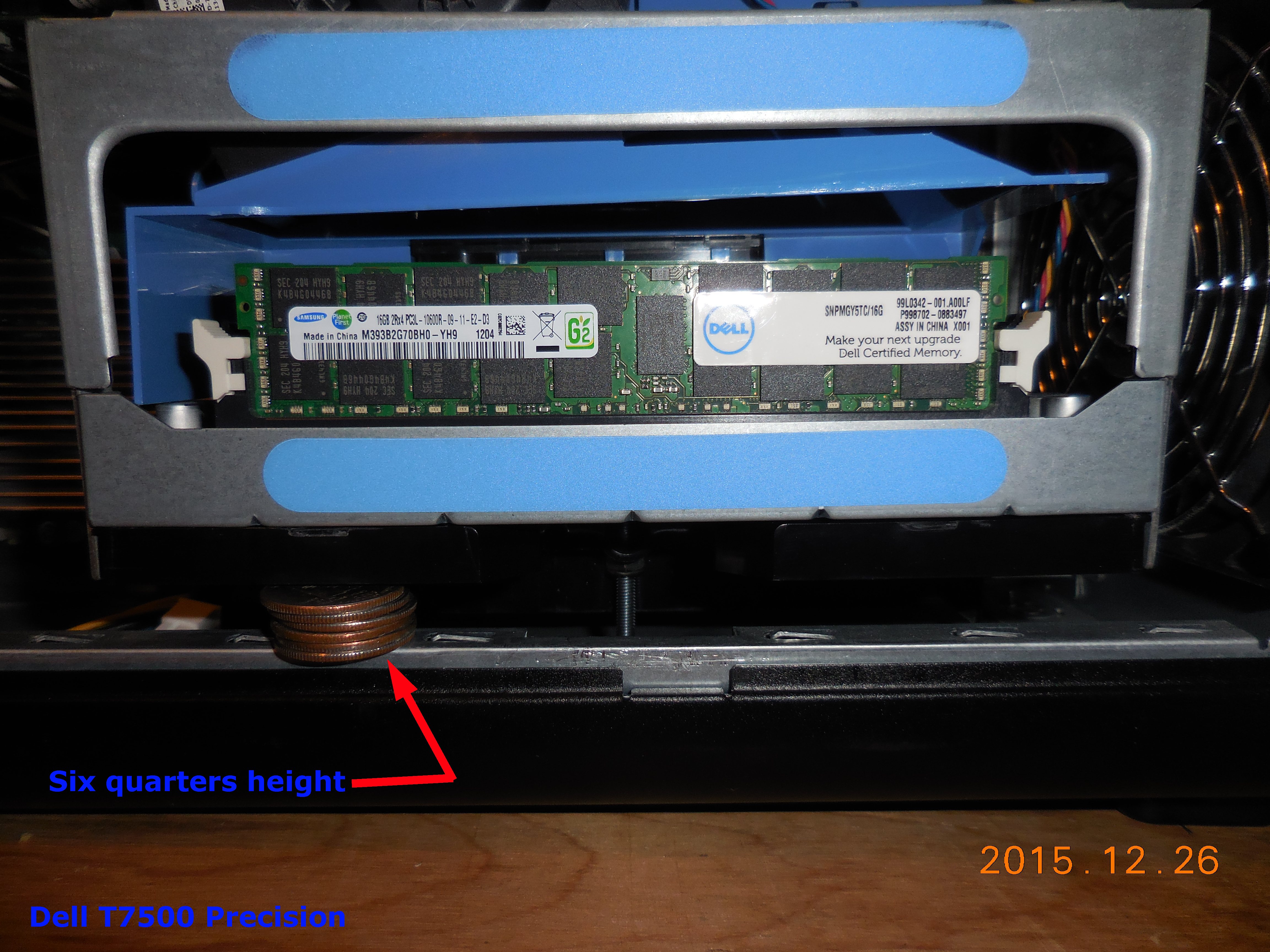

I just upgraded "Winni3" from 48Gb to 128Gb RAM. Half the RAM sits on the mainboard, the other half on the 2nd CPU riser card. The 2nd CPU riser card must be removed to add/change RAM at either location.
After installing the new RAM, it wouldn't boot. The power button was solid amber (not blinking) and the front panel diagnostic lights 2-3-4 were blinking, with all the fans eventually ramping up to pretty high speeds. Removing the 2nd CPU riser card allowed normal boot.

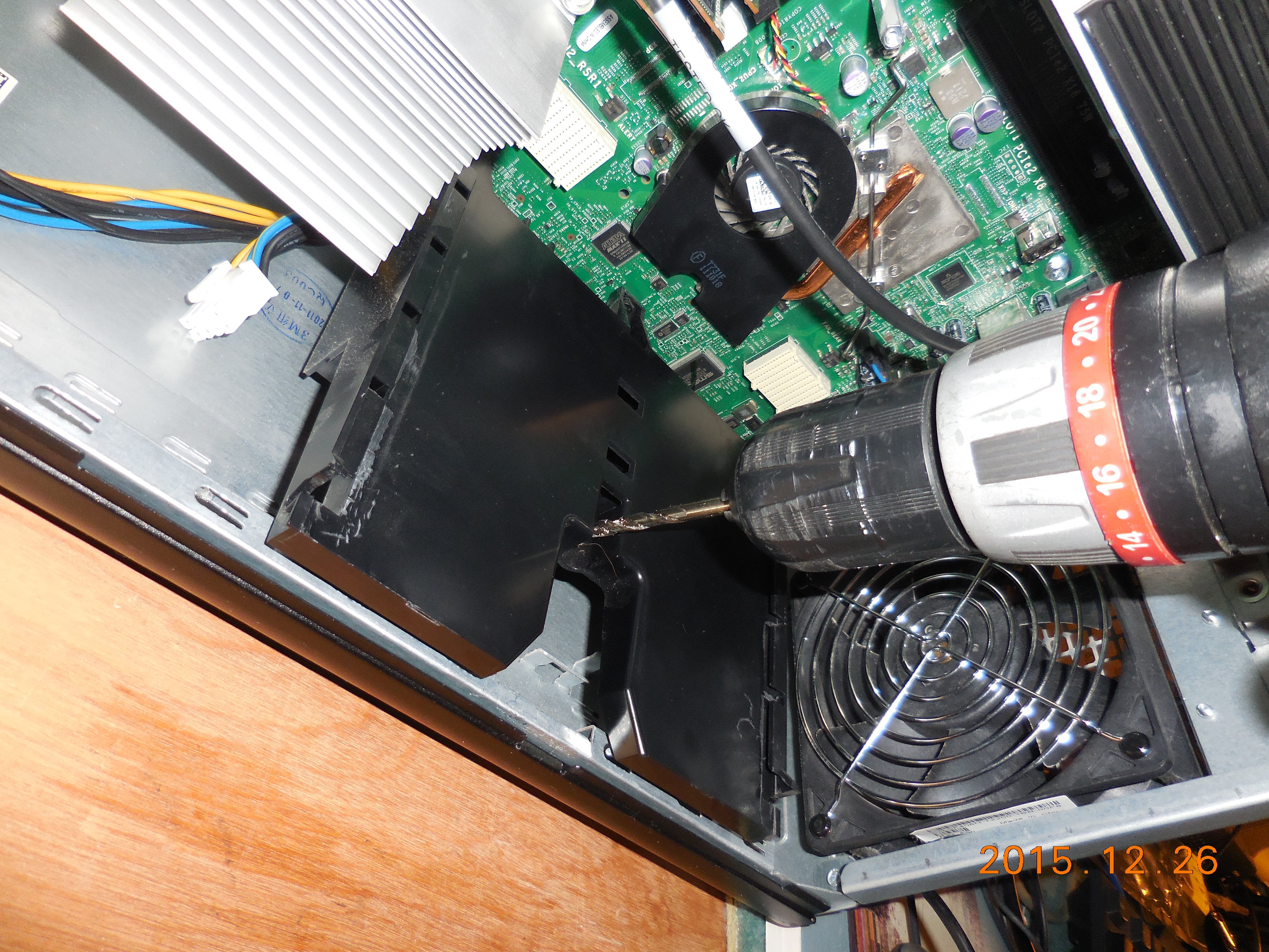

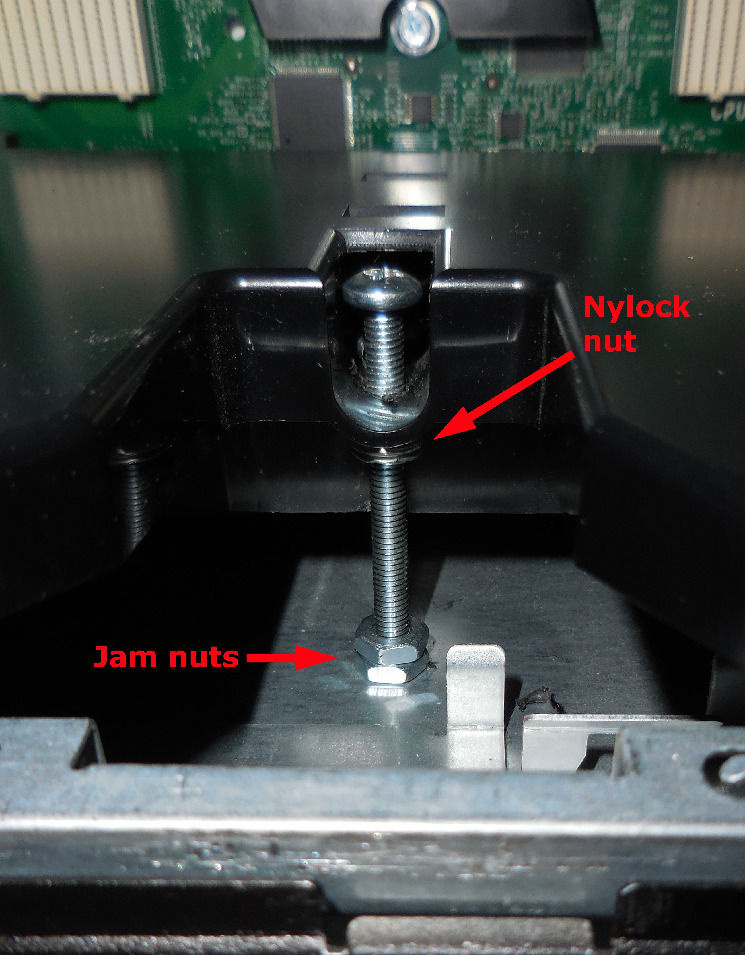

Google found this problem, and G-Man49 fixed his by supporting the 2nd CPU with shims. Yup, that seems to work here too. Make sure the LED on the mainboard at the upper left goes out before rebooting, as even with a fixed/supported riser, if that light doesn't go out between reboot attempts the same symptom seems to persist.
(Note that it's very easy to install RAM incorrectly on this model, as three DIMMs are required per CPU as a minimum, and they must be installed in slots 1, 2, 3 but those numbers aren't contiguous on the boards!)

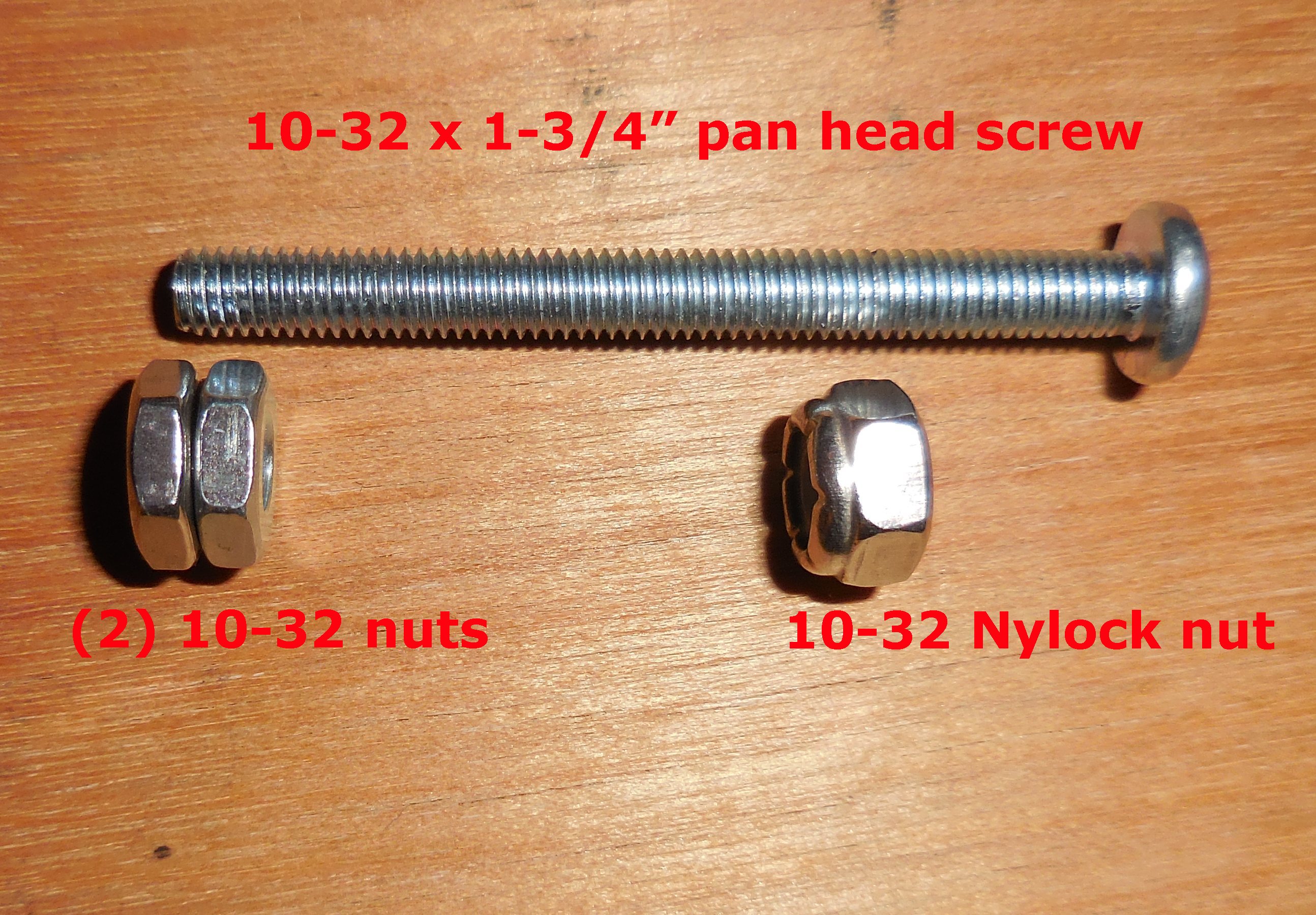

You can't just stack quarters or washers or whatever as I have done below for illustrative purposes, because the side cover fits on that ledge. I went with a jackscrew.

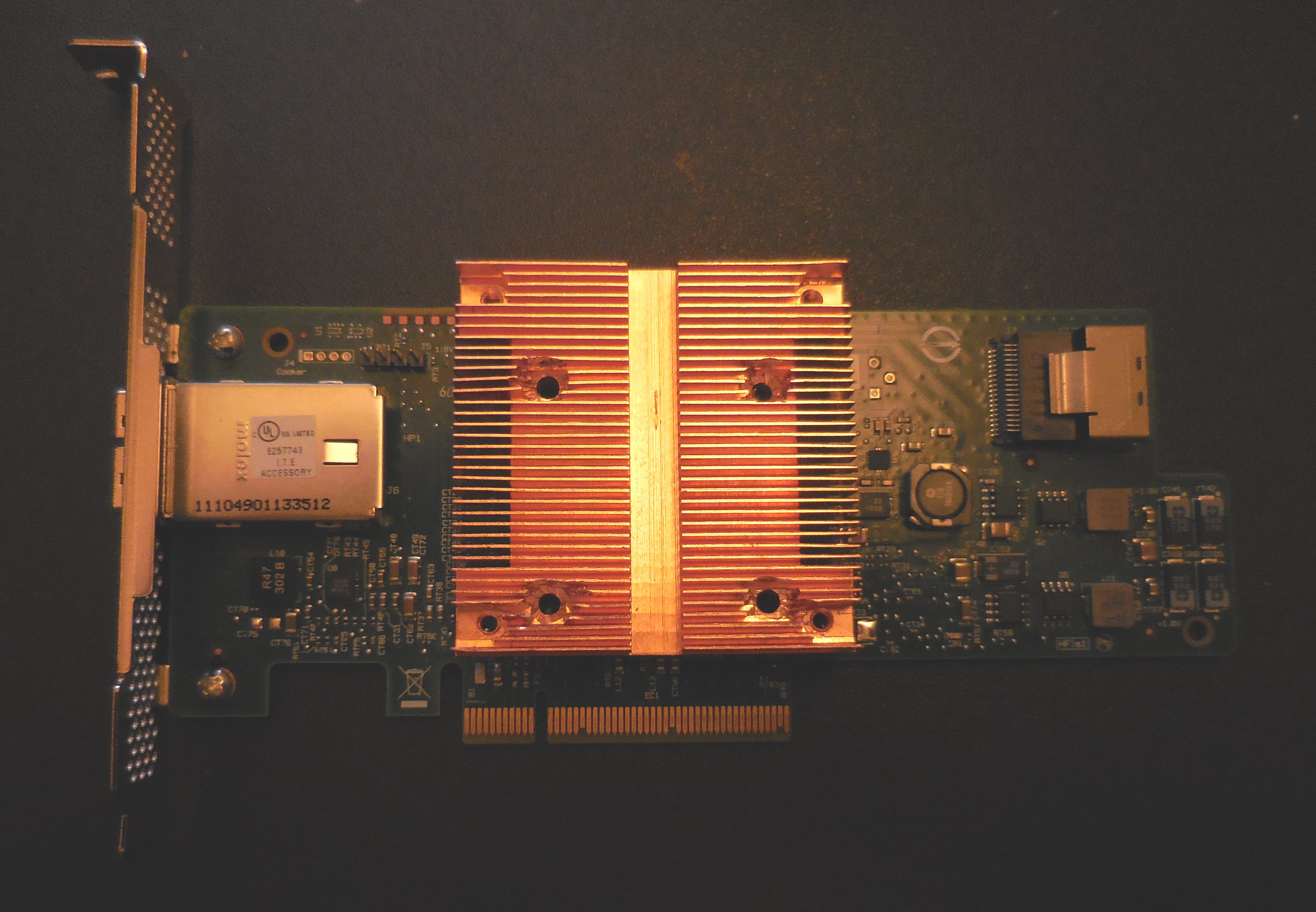

LSI SAS 9207-4i4e heat sink
The T7500's SATA ports are limited to 3Gb/s (SATA II). It seems that most PCI & PCIe SATA III adapter cards (HBA) do not really support high enough bandwidth to fully utilize a SATA III's 6Gb/s spec., especially modern SSDs or even merely multiple fast spinning disks that have a 6Gb/s interface.

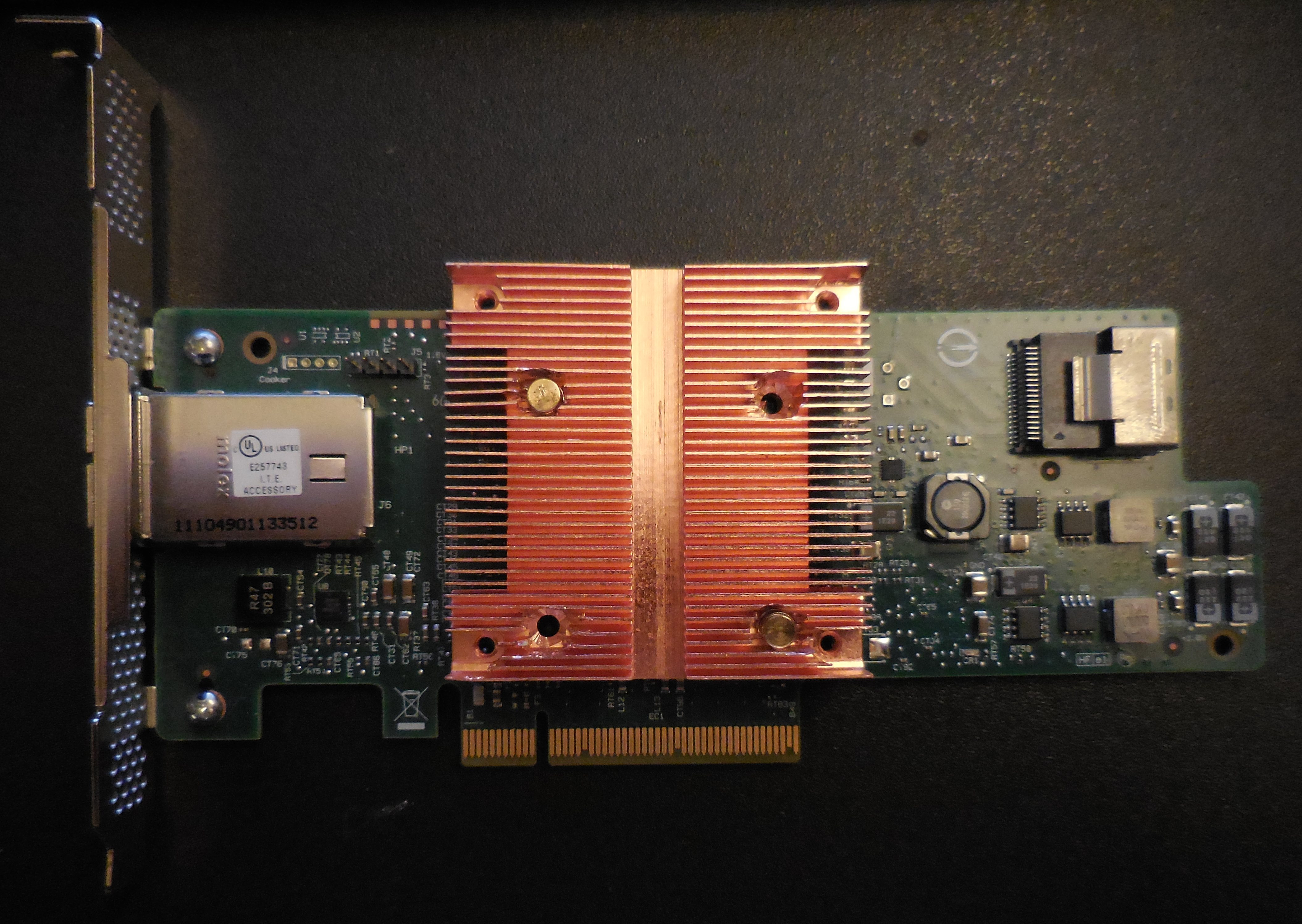

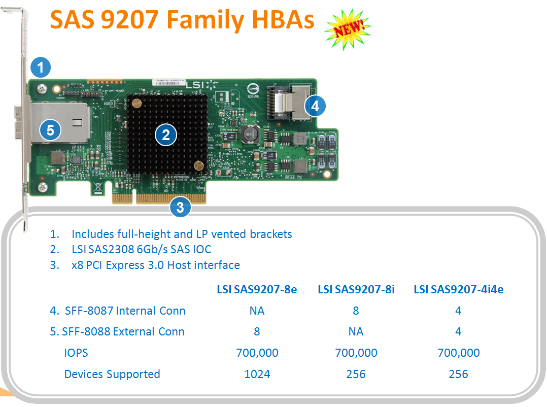

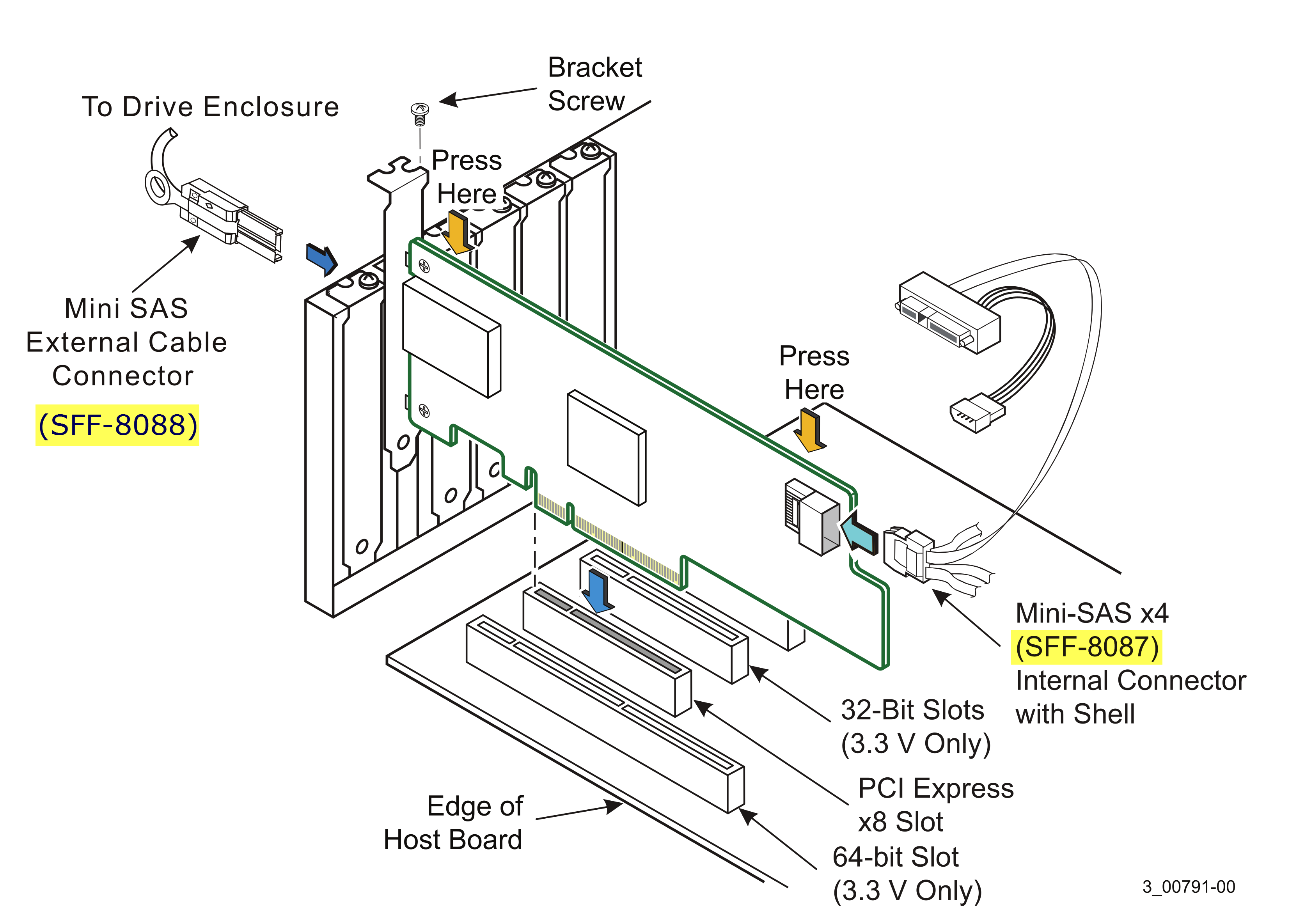

One way around that is to use a better HBA. I settled on an LSI SAS 9207-4i4e. Seems to work great so far, but it has a MPU that gets so hot that I cannot keep my finger on it, even when the box is idling. The spec calls for 200 lfm of airflow, and perhaps my box (that has eight fans) doesn't meet that. My fix is more heatsink and a dedicated fan.
Here's what it looks like from the factory:

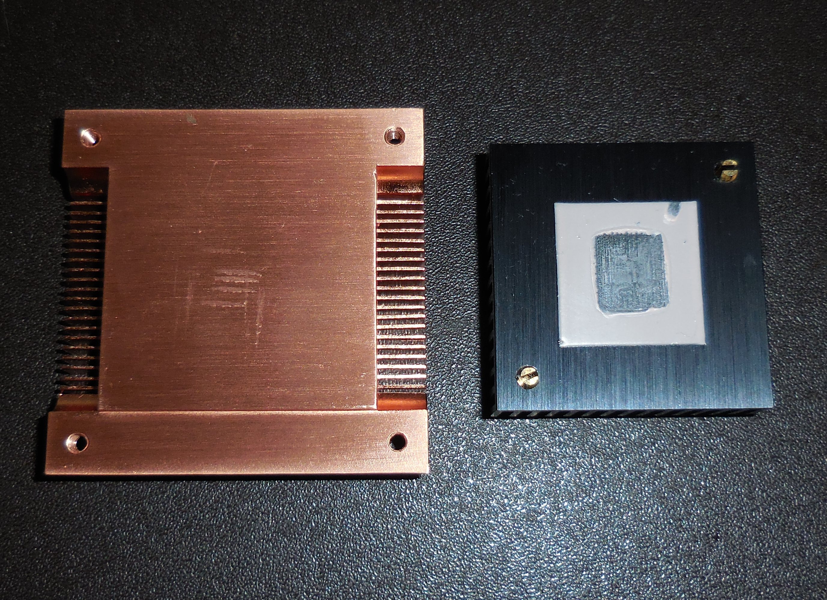

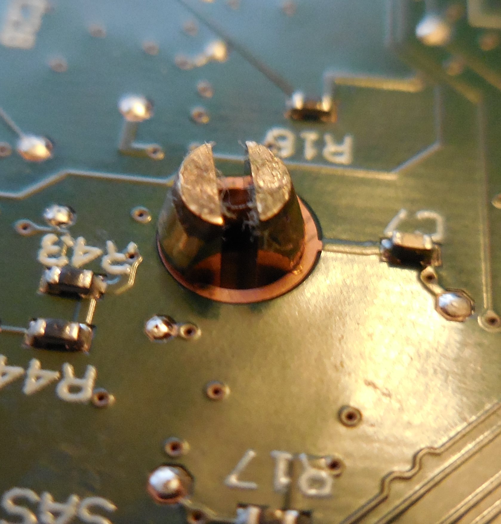

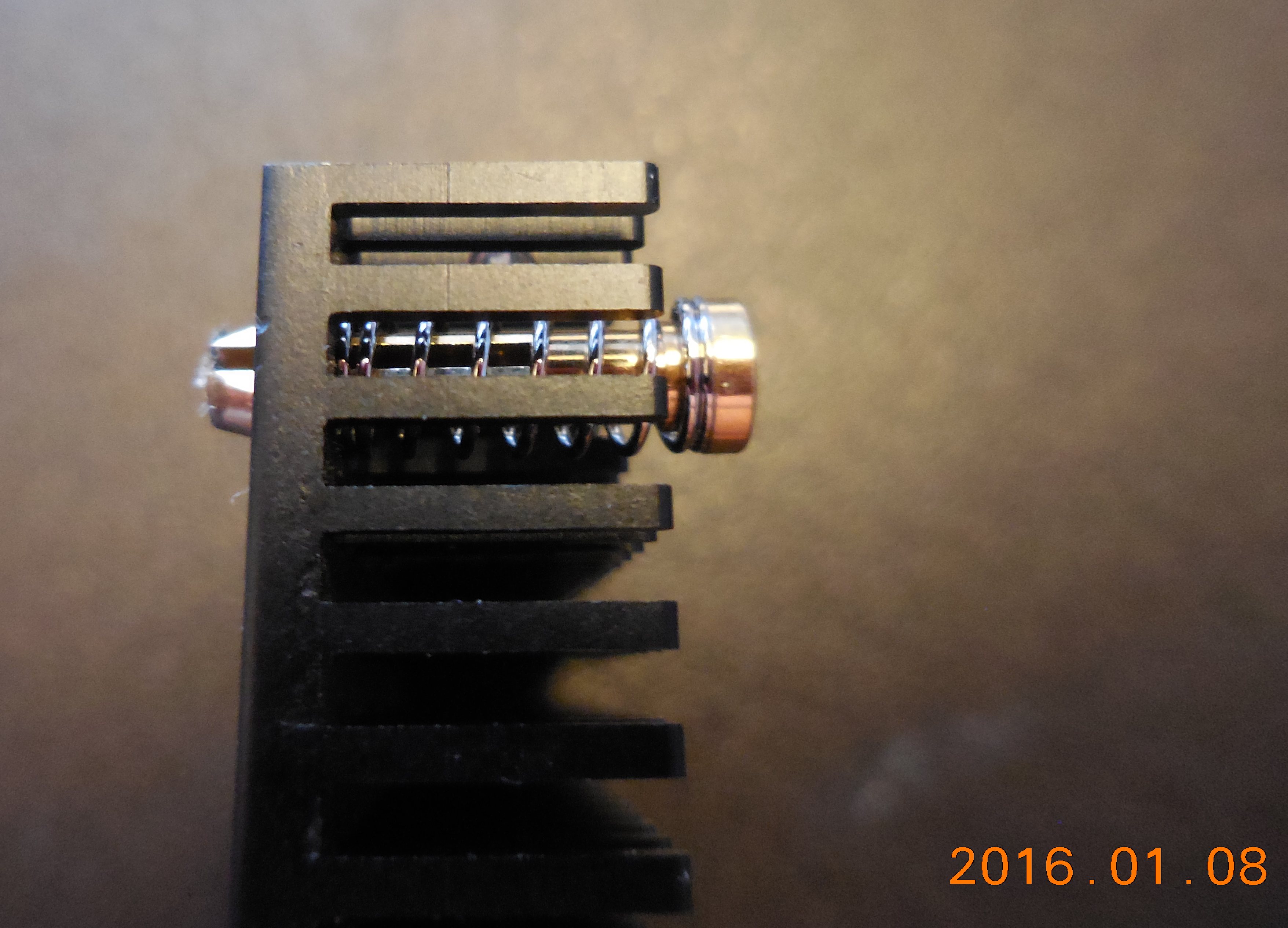

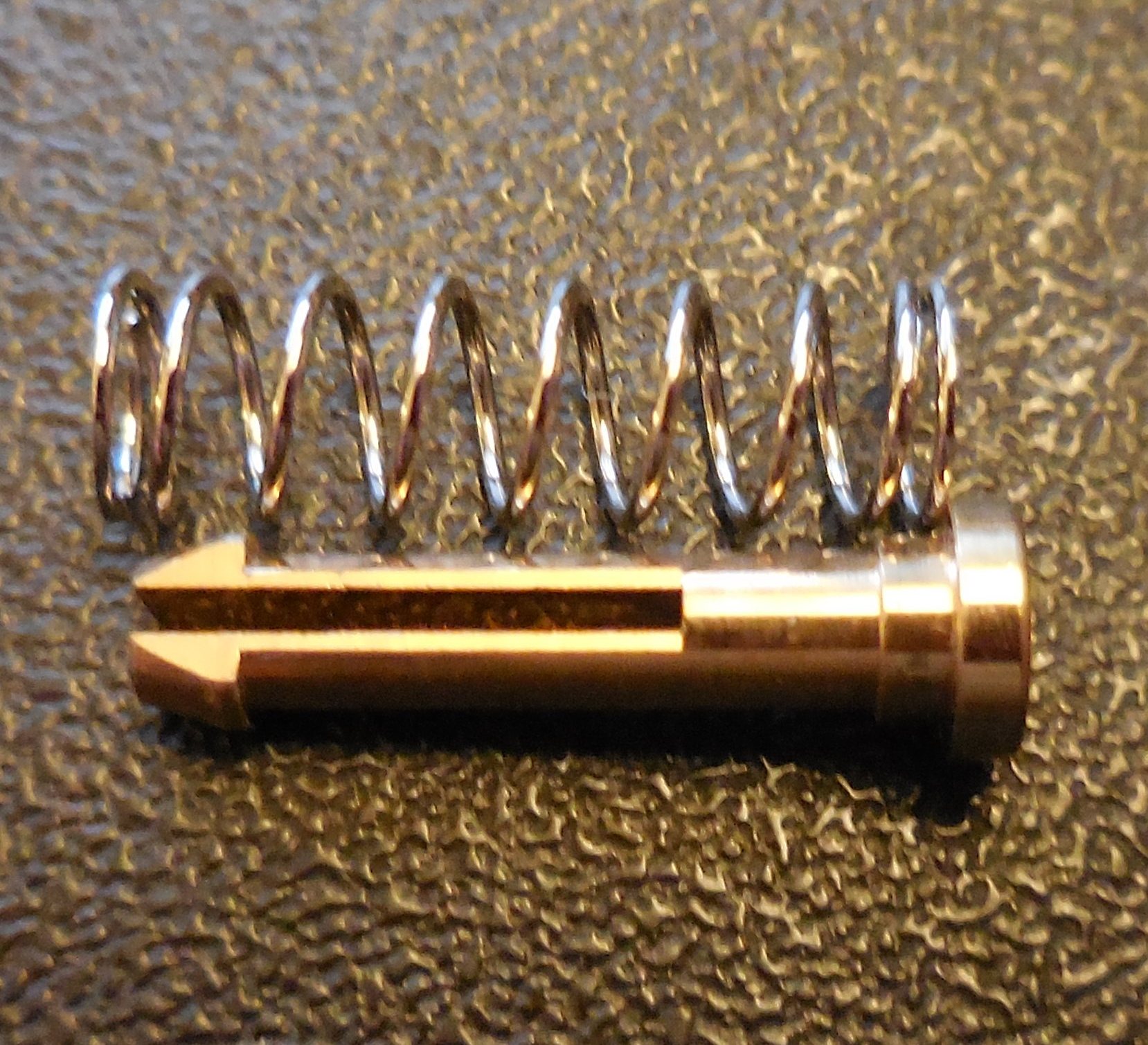

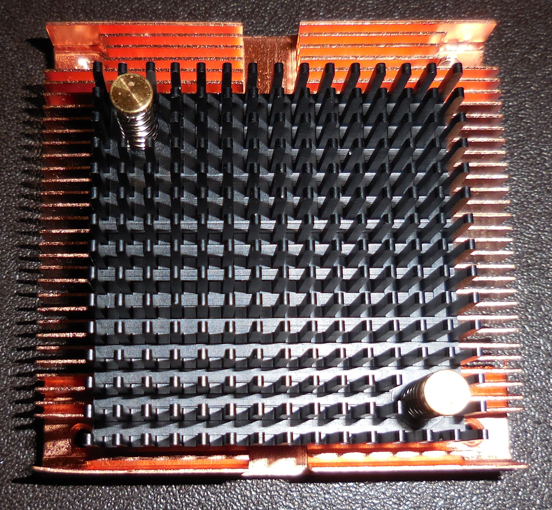

That black heatsink is not very tall, and not very large. It's held to the PCB via metal posts with (2) split barbs, and springs provide the clamping force:
I bought a $14 CPU heatsink/fan combo for an AMD Socket A (462), a Masscool 5R057B3 60mm:
I unscrewed the fan and here's the square inches comparison:

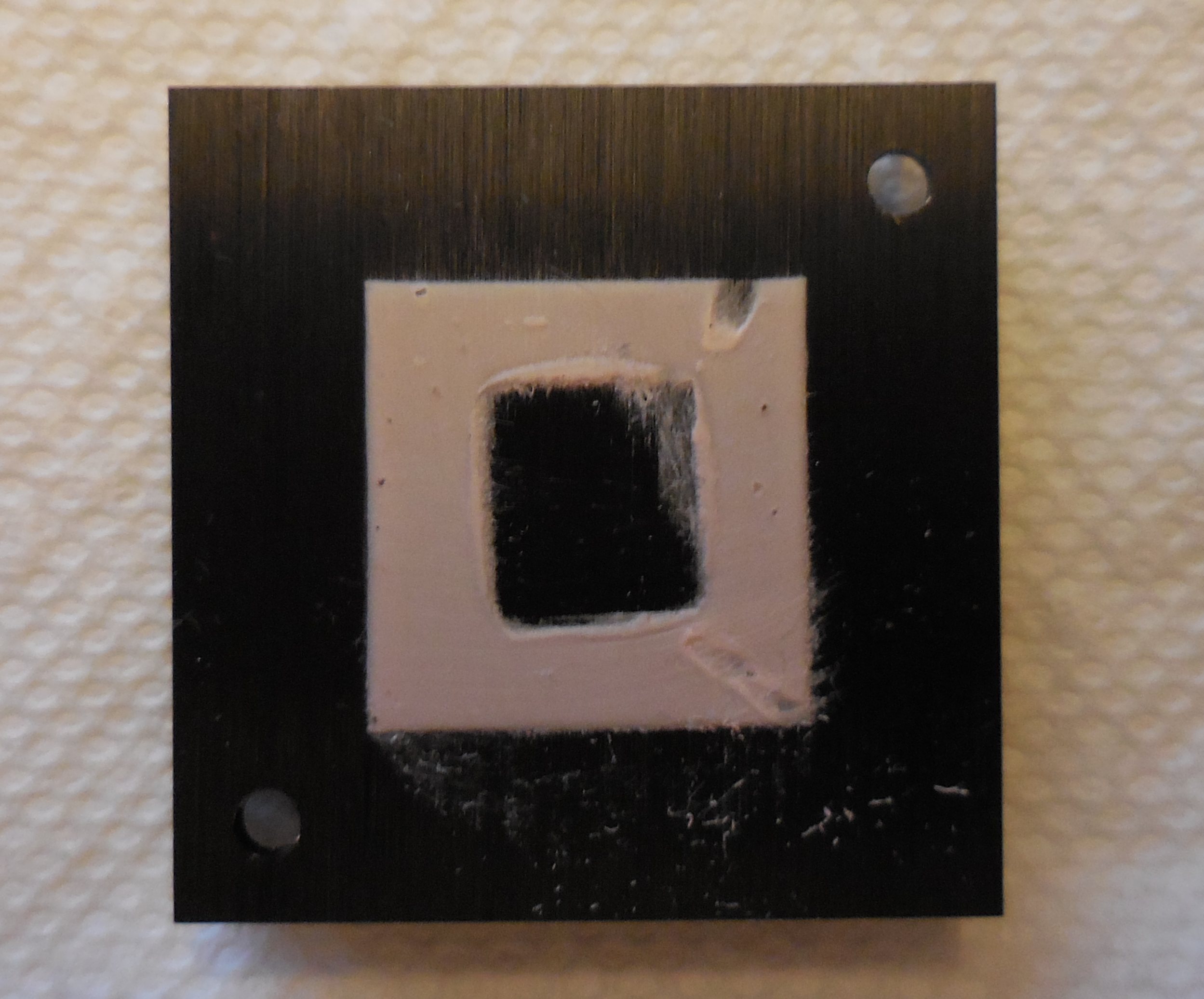

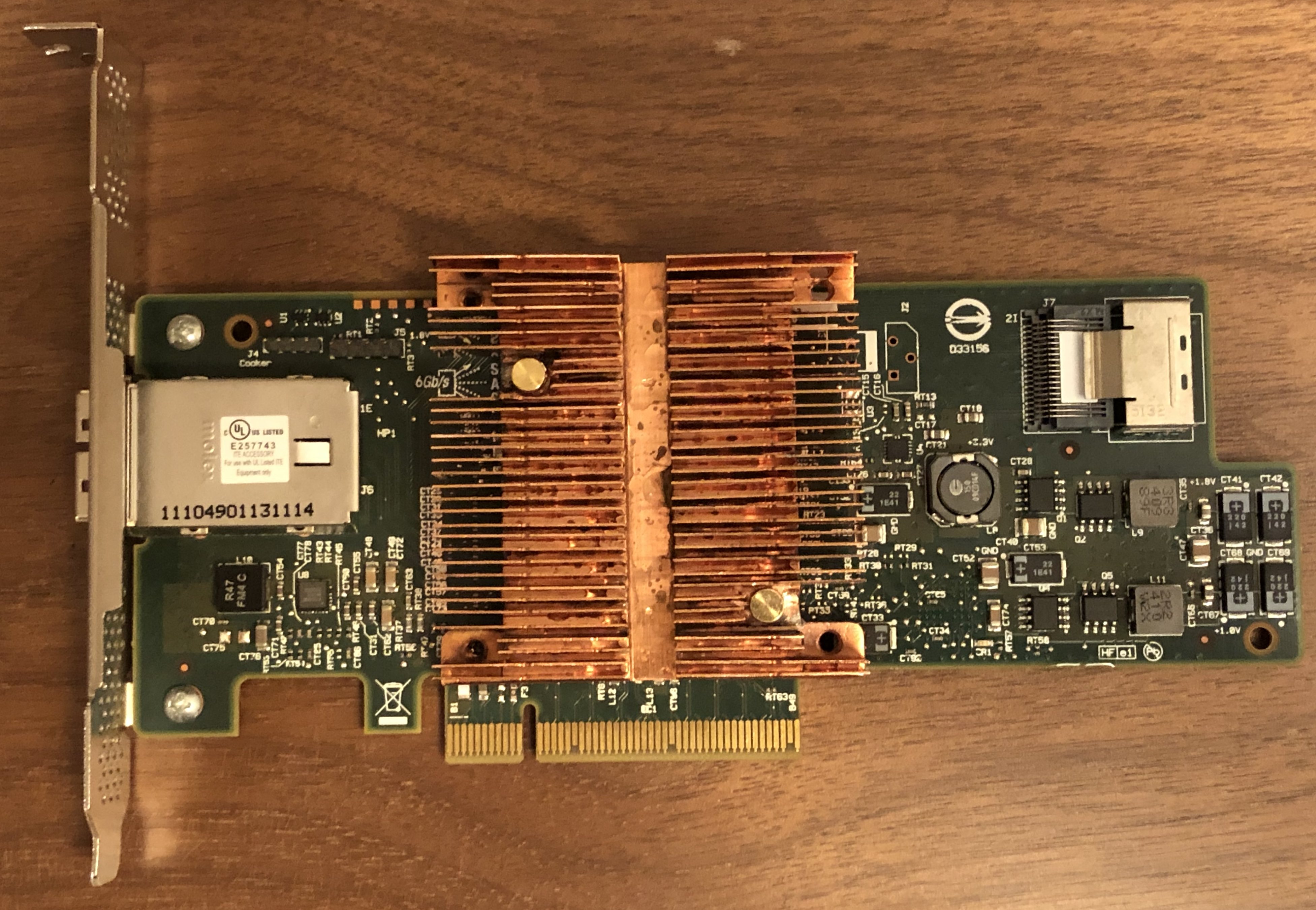

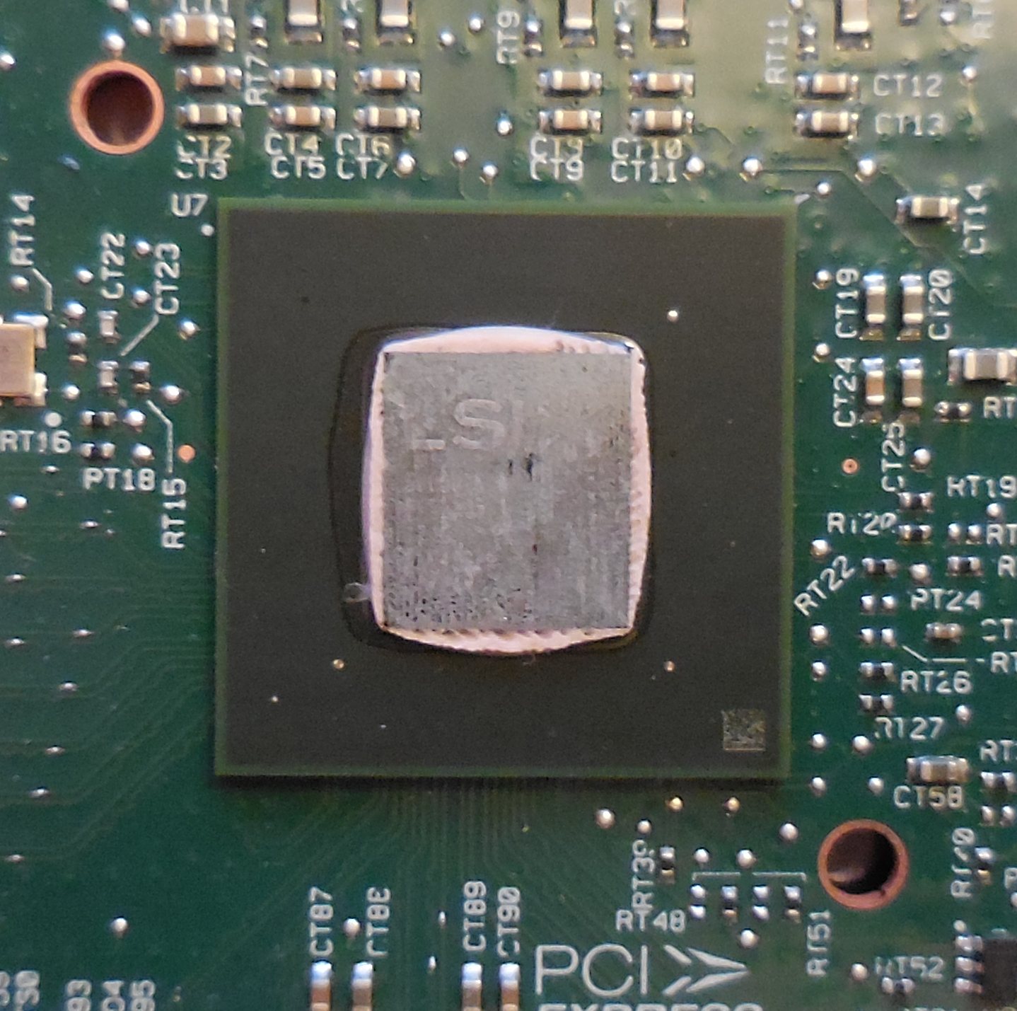

Next, I drilled the copper heatsink for the post barbs, then used a Dremel to cut back the fins. I did it wrong the first time, transferring the holes from the old heatsink to new backward, that's why there are four holes instead of two. The Dremeling was fussy work, taking a lot longer than you'd think. Then I trial-fit it: [13Nov2021 ALS: Doing this job a second time, for another box, and adding these notes:
I needed to remove the old thermal transfer paste, and it was really nasty to remove. No luck with denatured alcohol, it wouldn't touch it. Aerosol carb cleaner was only slightly better. Acetone did the job, but it still took more work than I'd thought it would:

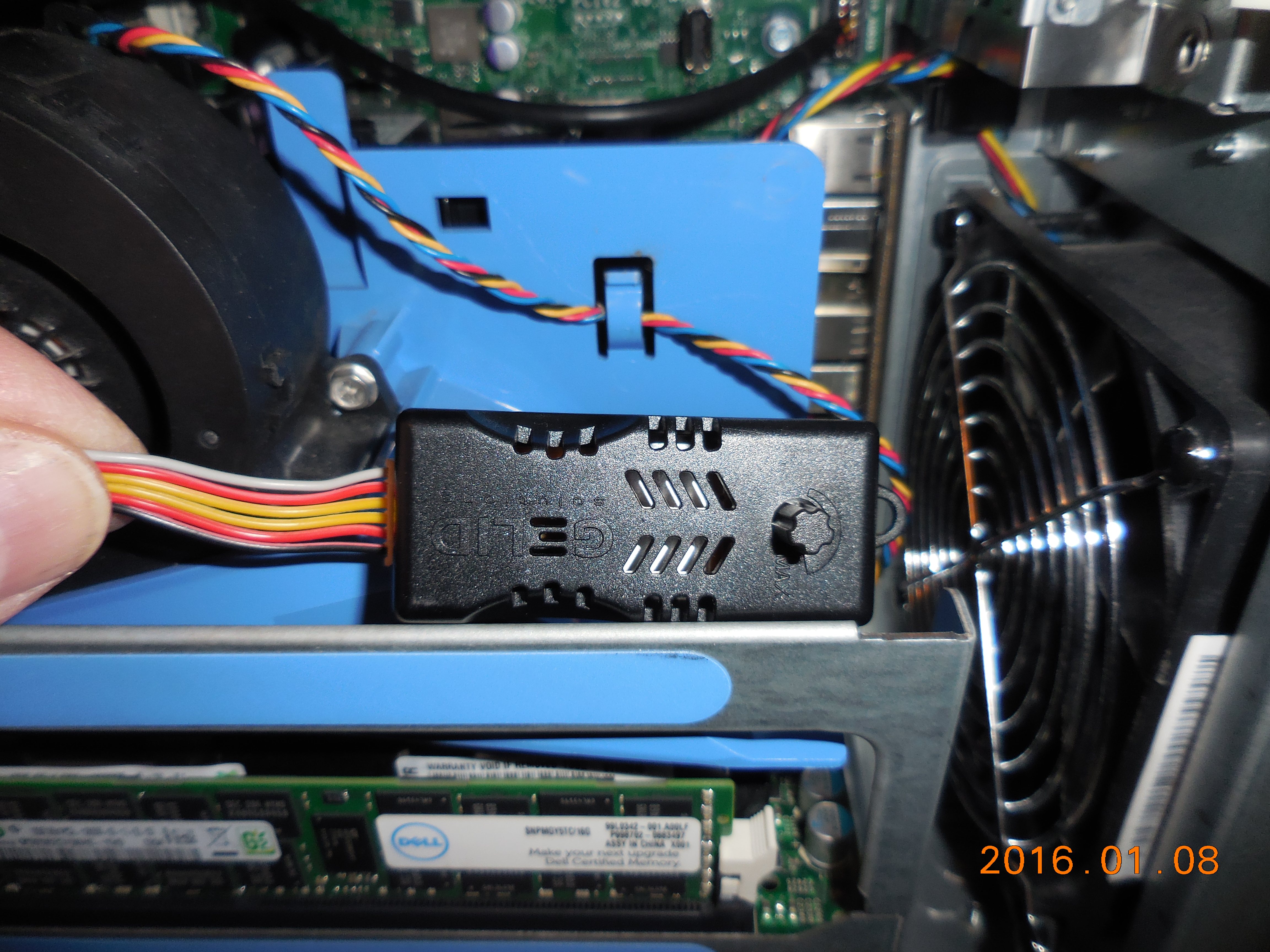

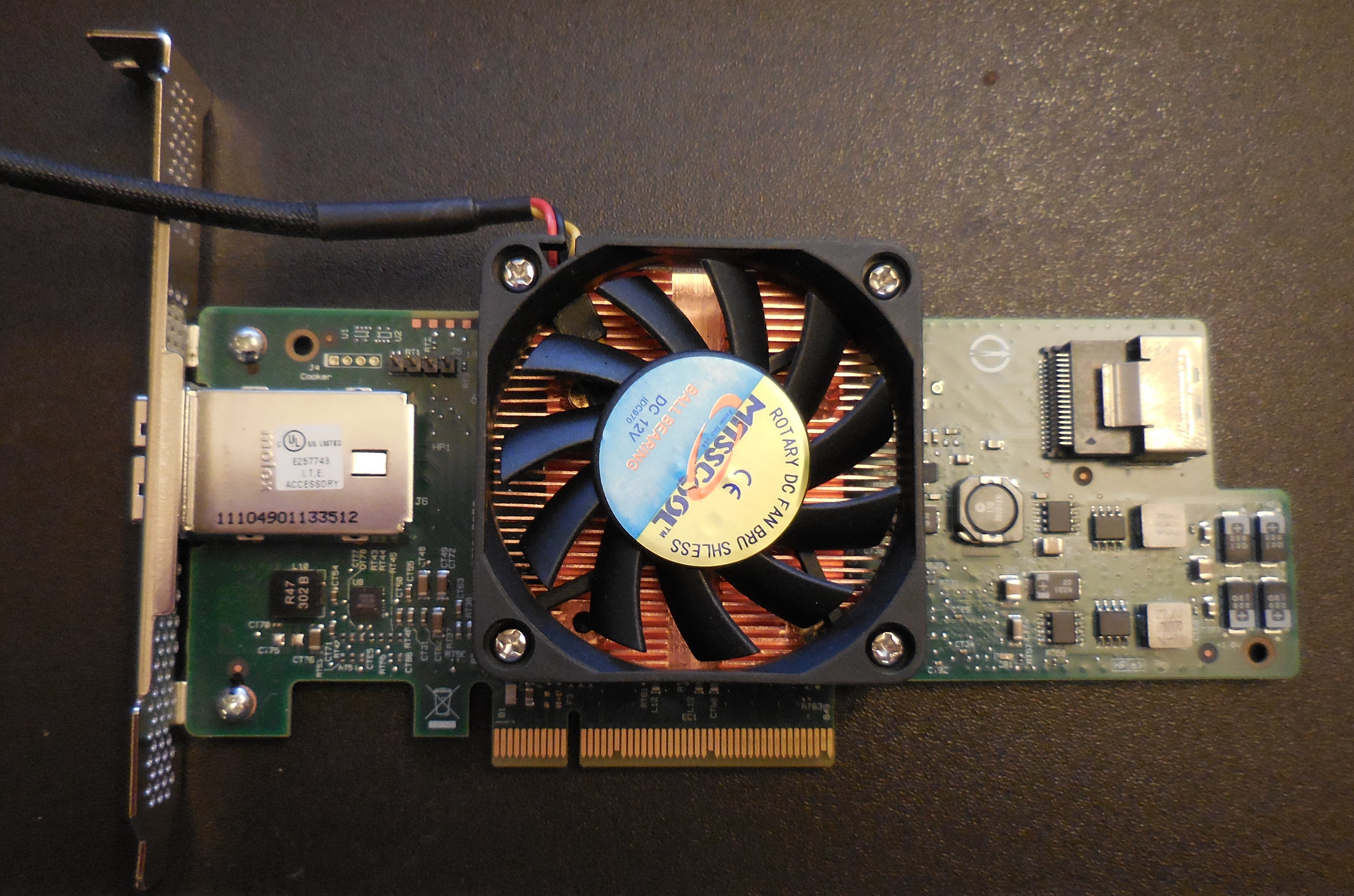

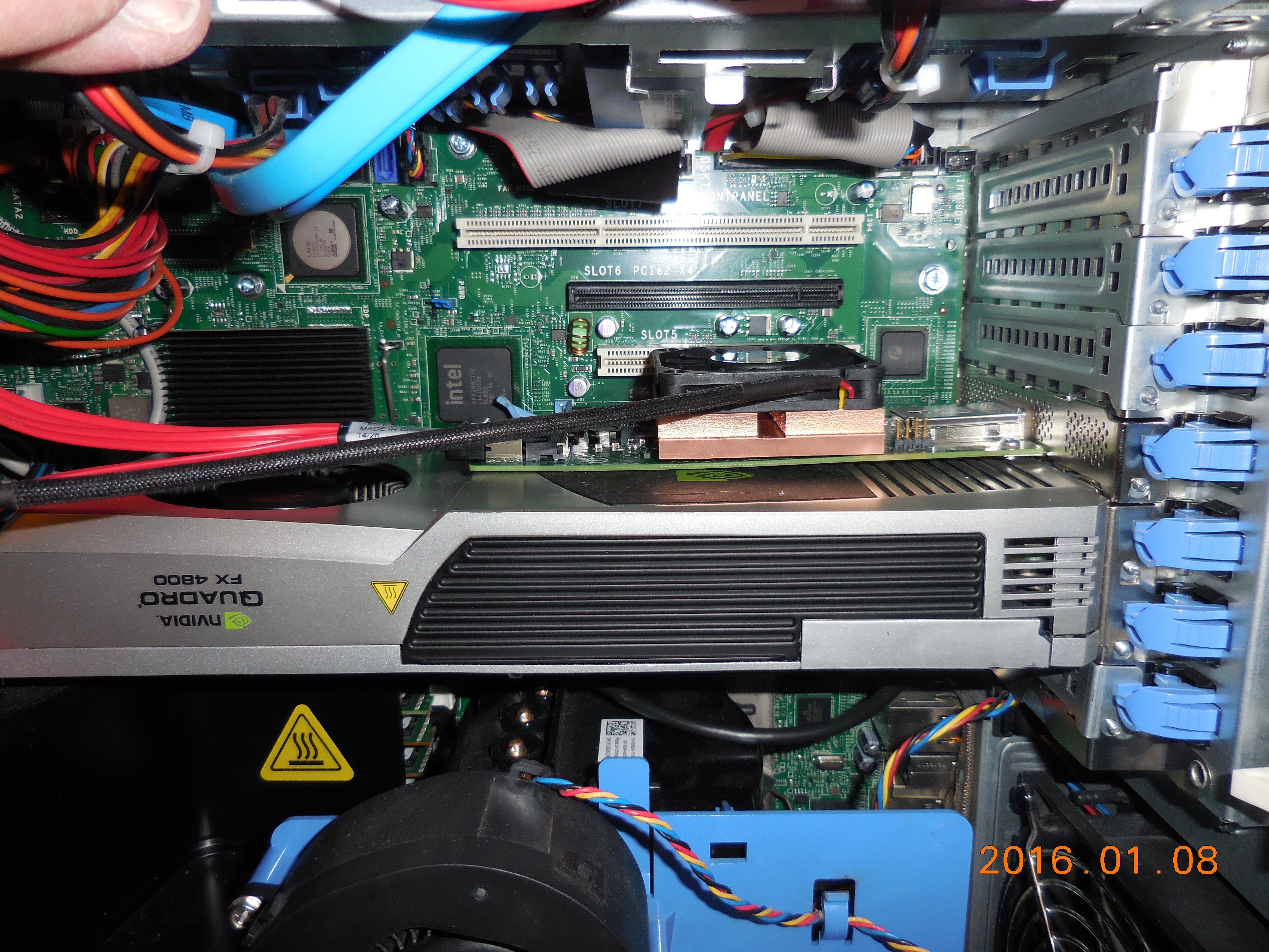

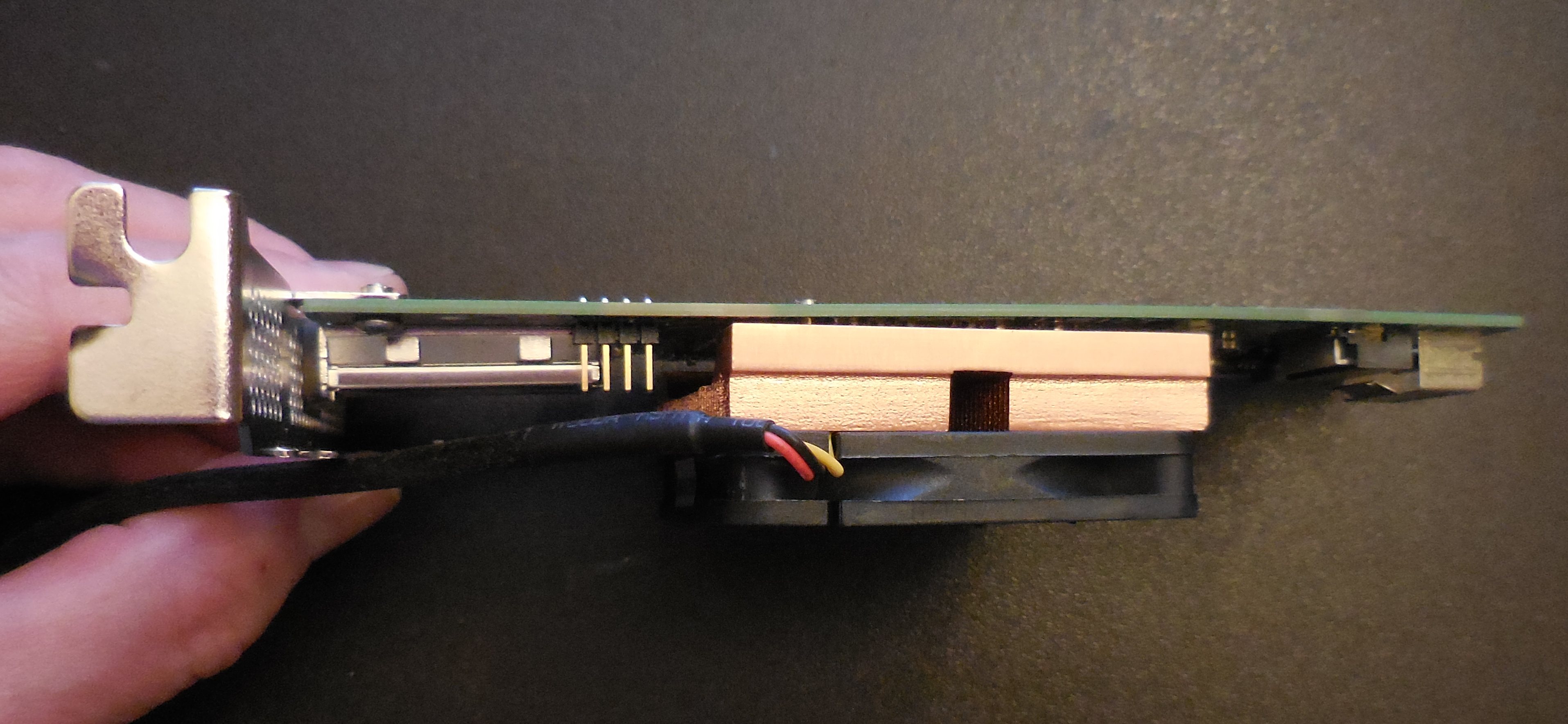

Installed, the fan & heatsink now completely obscure the adjacent PCI slot, but that's no loss: what's PCI anymore? I had also bought a $9 fan speed controller, Gelid FC-FX01, because this MPU will not need a fraction of the cooling of an AMD CPU, and I don't need the noise of a 4800 RPM fan. The last piece I needed was a Molex 4-pin to fan 3-pin adapter to provide power to this controller. I happened to have one laying around in a drawer.
With the fan controller turned all the way toward minimum, the fan noise cannot be distinguished from all the other fans running in there, and the copper heat sink is 105°F in a 72°F ambient room. Much better.
[20Jan2018: the internal breakout cable I used is 3WARE Cable Multi-lane Internal Cable (SFF-8087), to adapt from the LSI's single internal port to four SATA drives.]

I cut off three coils from each of the two heatsink hold-down springs on the barbs, as otherwise the springs were coil-bound/completely compressed.

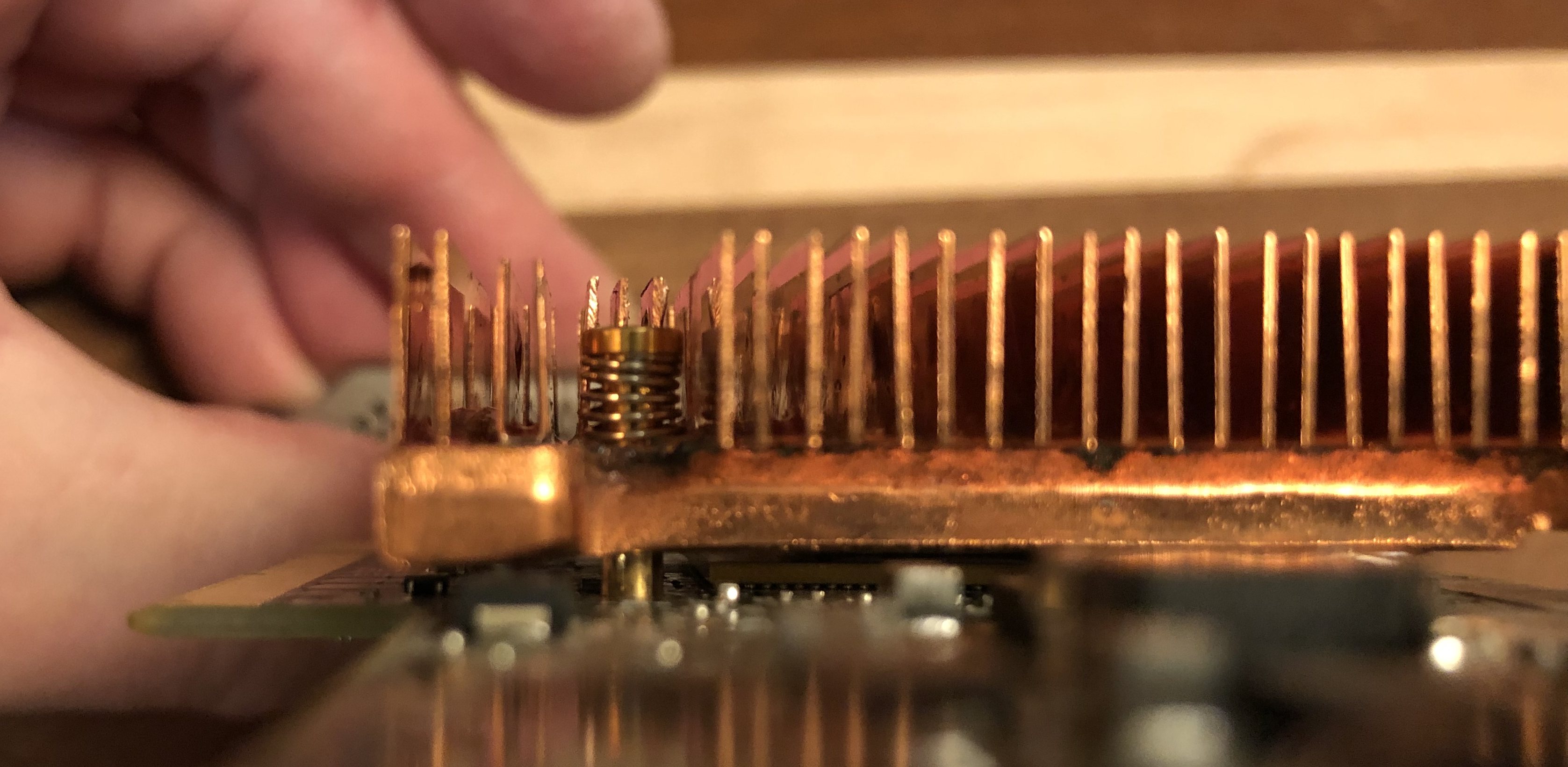

- The barb shank is ~.114" dia.
- The heat sink and PCB holes are ~.125" (1/8")
- The barb shank's "glans" is ~.145". 1/8" holes in the heatsink work fine.

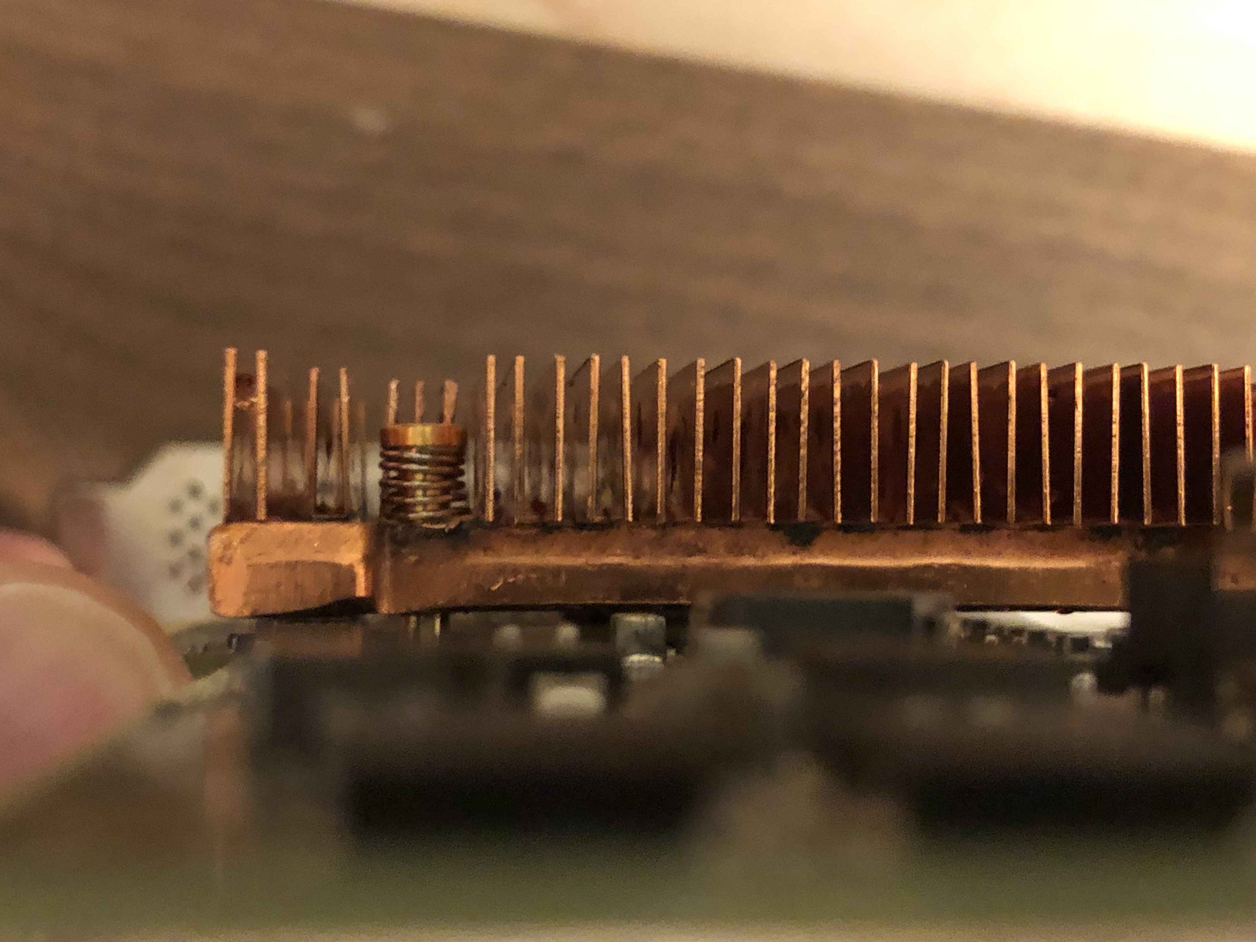

14Nov2021: I just did this job again, for another LSI SAS-9207-4i4e. This time, the previous fan/heatsink wasn't available, so I used an Evercool Socket A Socket 370 P3 1U Low Profile CPU Cooler CU3A-610CA that I picked up on eBay. I used the same Gelid fan speed controller, and for the HP Z620 I tapped power from a spare PCIe 6-pin connector, using the male connector I chopped off a Cable Matters 104042x2 PCIe 6-pin to 8-pin adapter.
