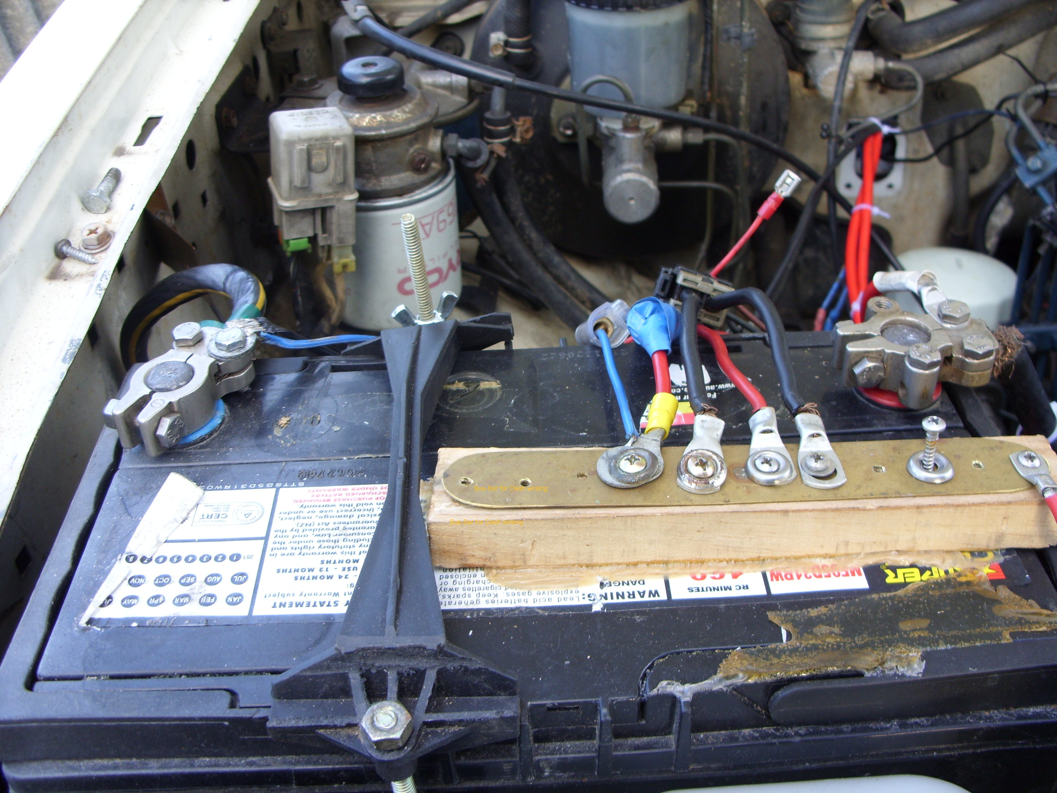

Ever diesel 720 I have ever seen has 4 fusible links coming off the battery post, 2 green and 2 black, even the Canadian spec diesel 720 with an SD25 that had power steering.

Like Plenzen I have those as well, Five of the little and Large Buggers, Now, next question if I may, do any of these have the control over my Ignition Switch, You see I have removed my Battery and Starter and had these tested and both are Perfect, or as near too as any other man made Item in this "Vale of Tears", I have even relaid my homemade Wiring Circuit that has worked
perfectly for me for the last three Months, and confidently turned my Key to start her up, Only to hear my Tears as they hit the Dashboard and nothing more, I have no Dashlights, Taillights,
Headlight, Horn, Brakelights nor Indicators as well, only a clear sound of Silence!
