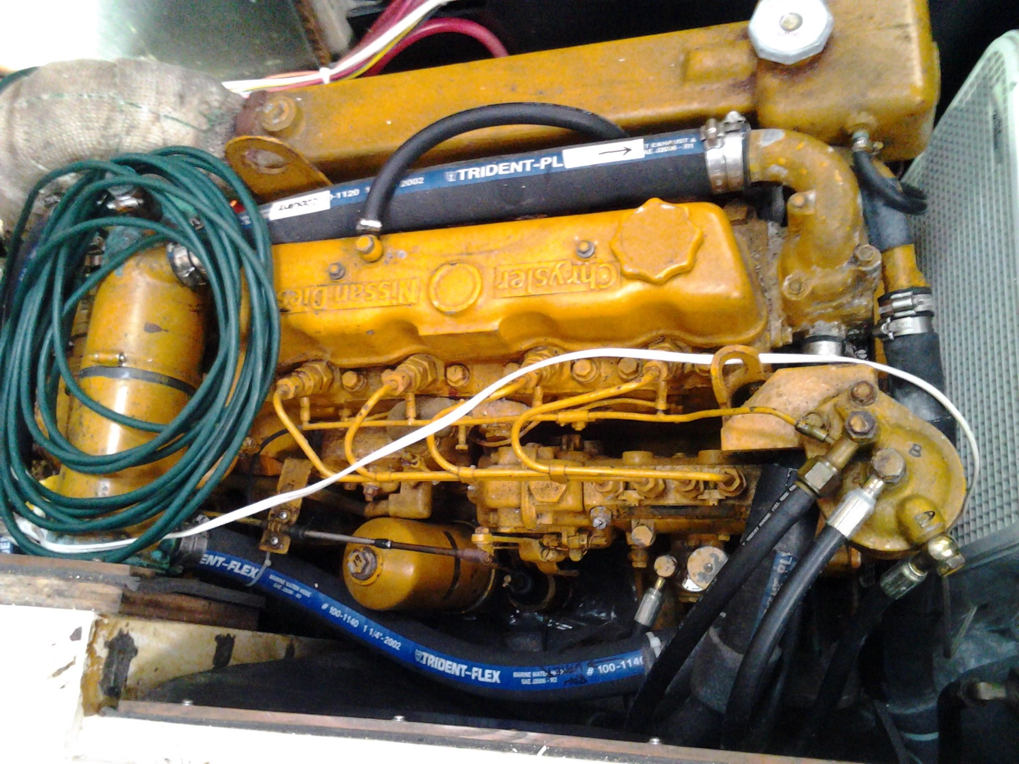

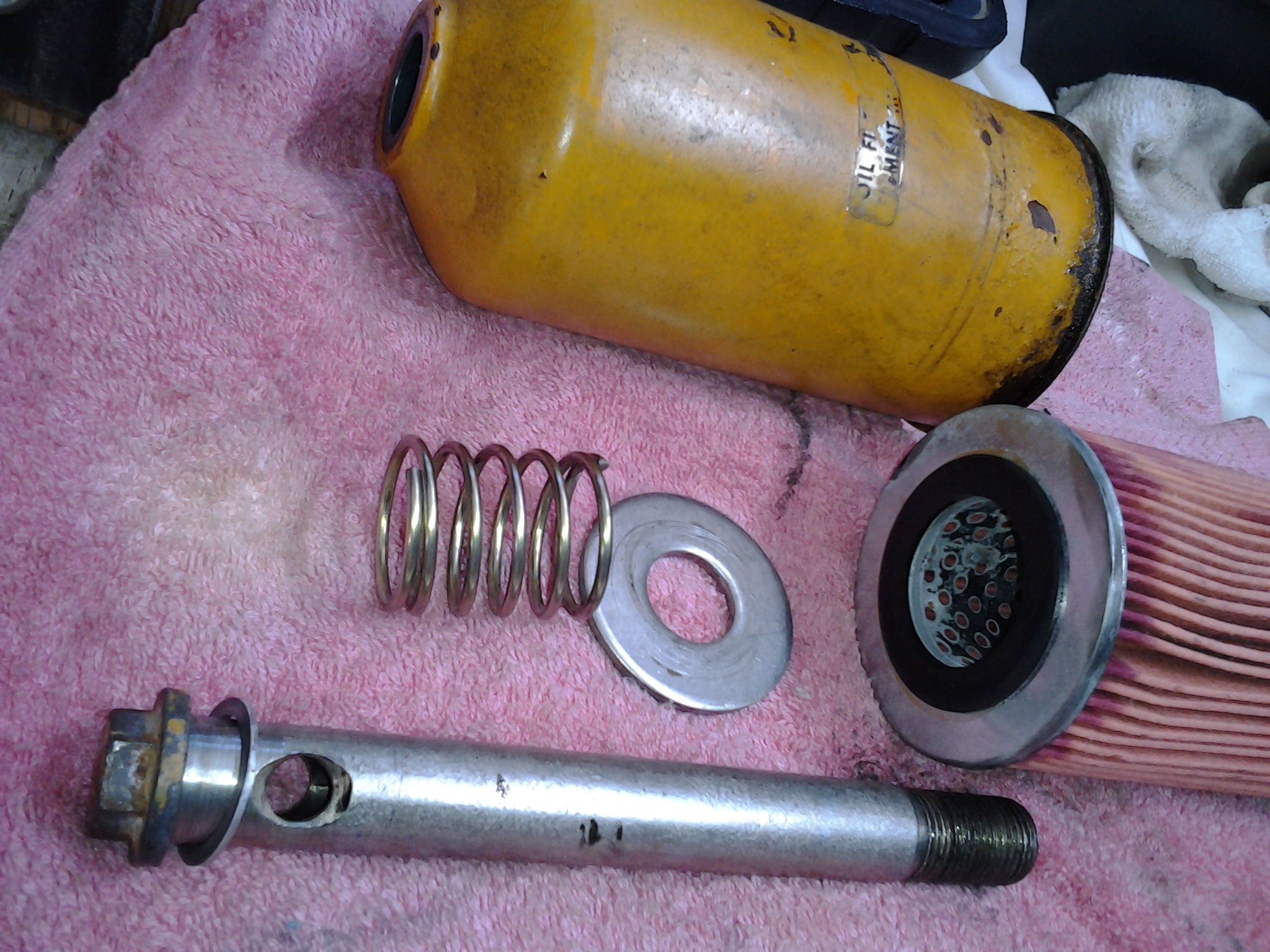

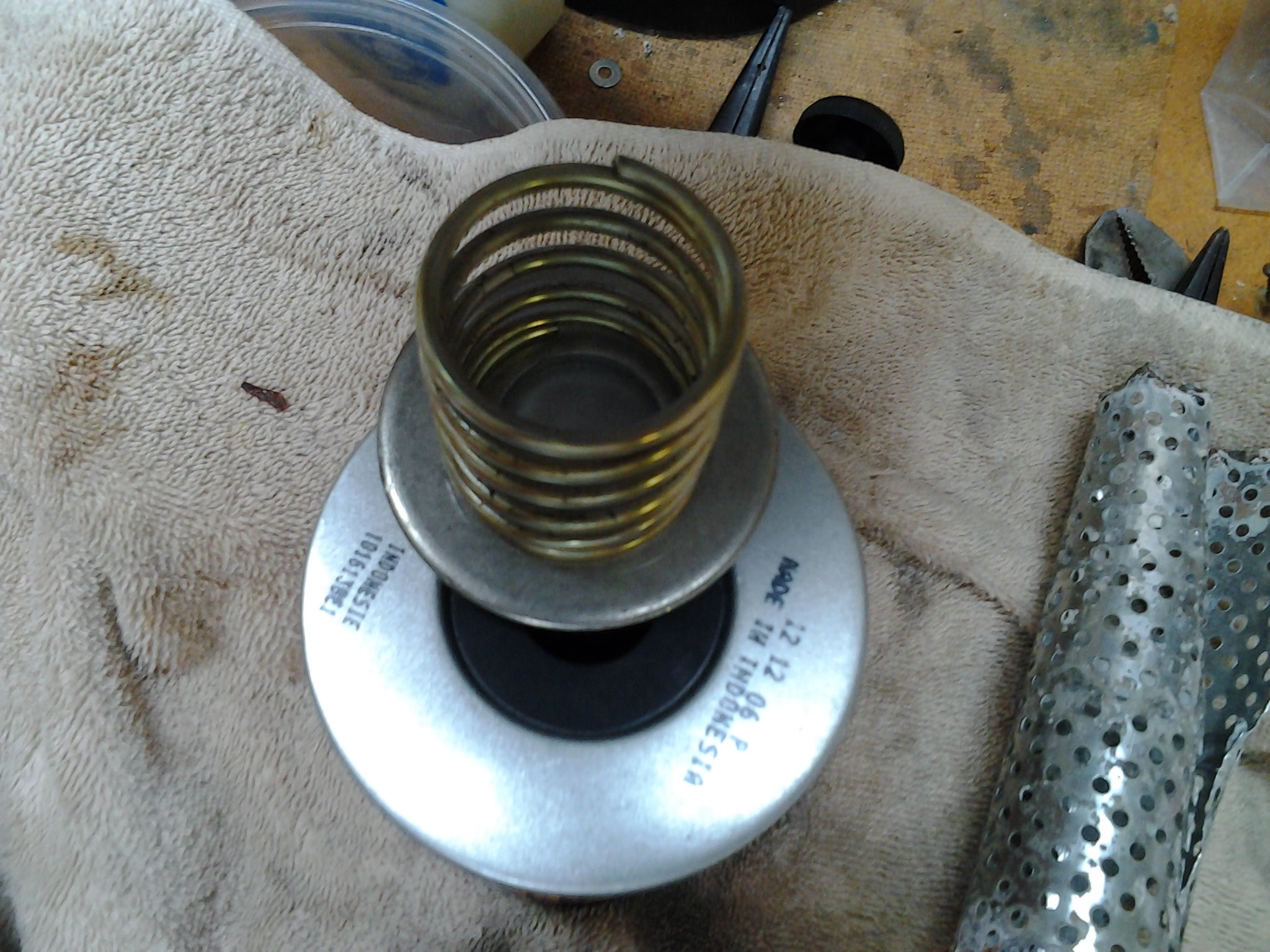

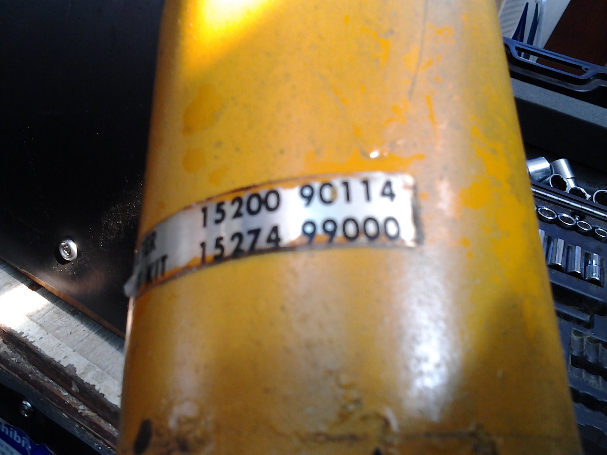

Hello, I have a 1978 SD22, engine shop put oil filter in upside down. Am I missing a piece? I do not see how large opening at bottom of filter can seal to head. Thank you.
- 2016-08-24 14.21.59.jpg (452.43 KiB) Viewed 40499 times
- 2016-08-24 14.16.47.jpg (496.51 KiB) Viewed 40499 times
- 2016-08-24 14.17.59.jpg (461.33 KiB) Viewed 40499 times
- 2016-08-24 14.16.33.jpg (521.45 KiB) Viewed 40499 times
- 2016-08-24 14.29.43.jpg (299.43 KiB) Viewed 40499 times

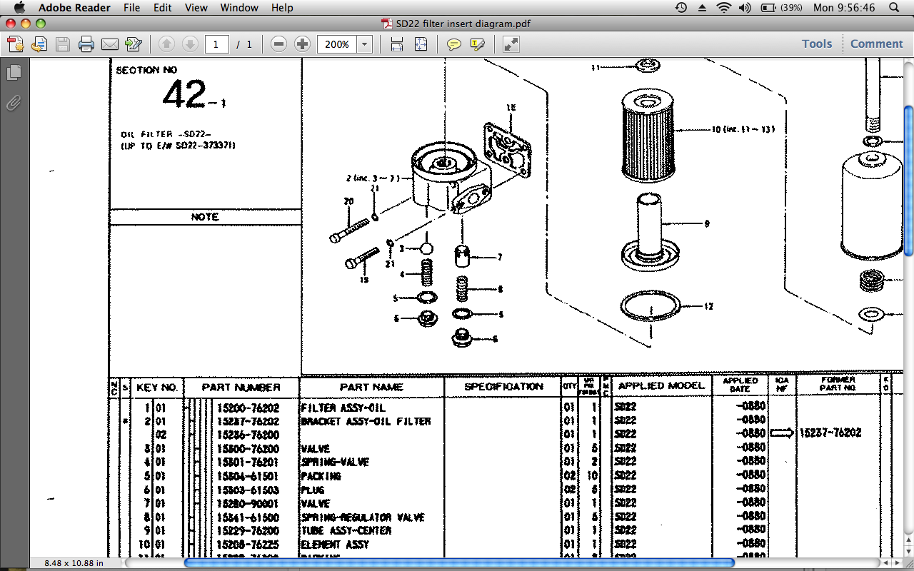

I did see that, thank you. Wish I had a better picture of that parts diagram, I can't seem to blow it up big enough to read. I have never seen that filter insert before nor do I see it in any of my manuals. Probably impossible to find now. I don't understand how it would seal to the header. That IS my same engine, the yellow SD22 4 cyl (MN4-33). Wish there was a picture of the top and bottom, it might have its own seal or shares the one that the canister mates to. Been talking to Eldon at McFarling Diesel in NE, he confirmed the filter WAS upside down. Will send him more info as soon as I get back to the boat. Thx.

I'm thinking they maybe gave you the wrong filter. ?
The large opening at the bottom of the cartridge is supposed to be sealed by the washer and the small hole is supposed to fit snugly around the bolt shaft. It appears as if the filter they gave you has the wrong hole at the small end. ( or i may not see it correctly in the photo) The large one appears nearly too large as well but that's how it appears to me.
There is supposed to be a flat O ring/gasket between the canister and the mating surface of the filter housing (same diameter as the filter canister) As you tighten the "through" bolt it seals the canister so the housing.
Once the filter is sitting on the spring and washer it should be sitting just slightly above the end of the canister. As you tighten the bolt the filter is pressed against the washer and spring sealing that end. The small end is sealed around the bolt. The more you tighten the canister is pressed against the flat O ring/gasket sealing the whole assembly.
Hope that makes sense.

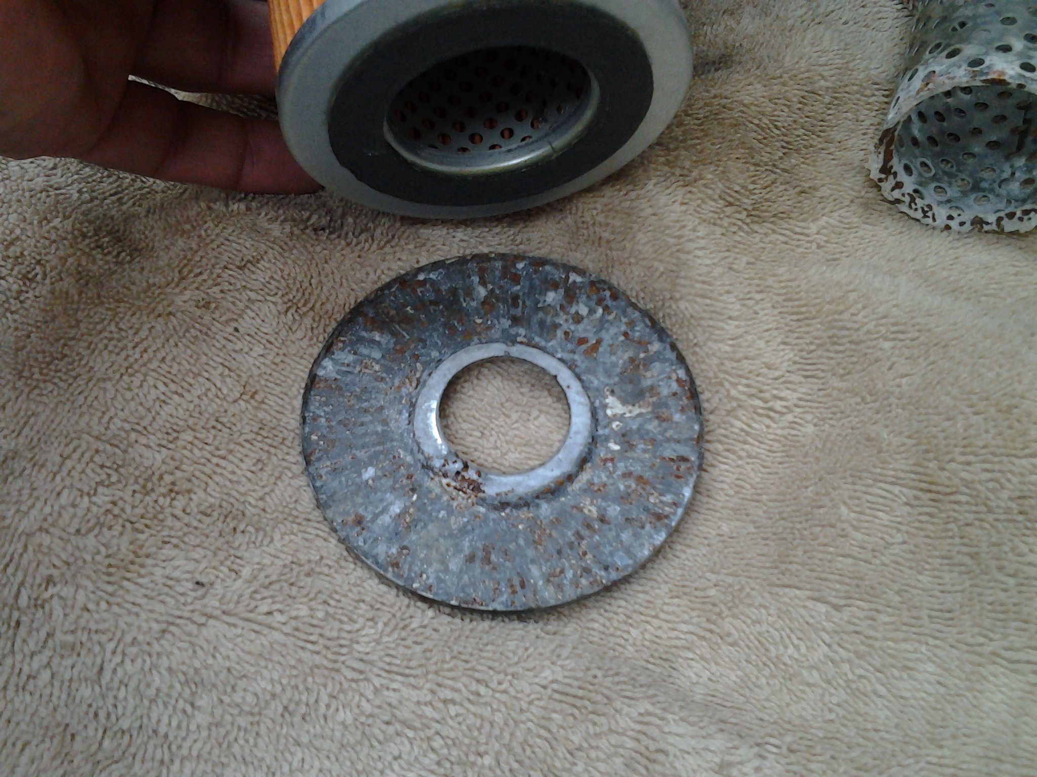

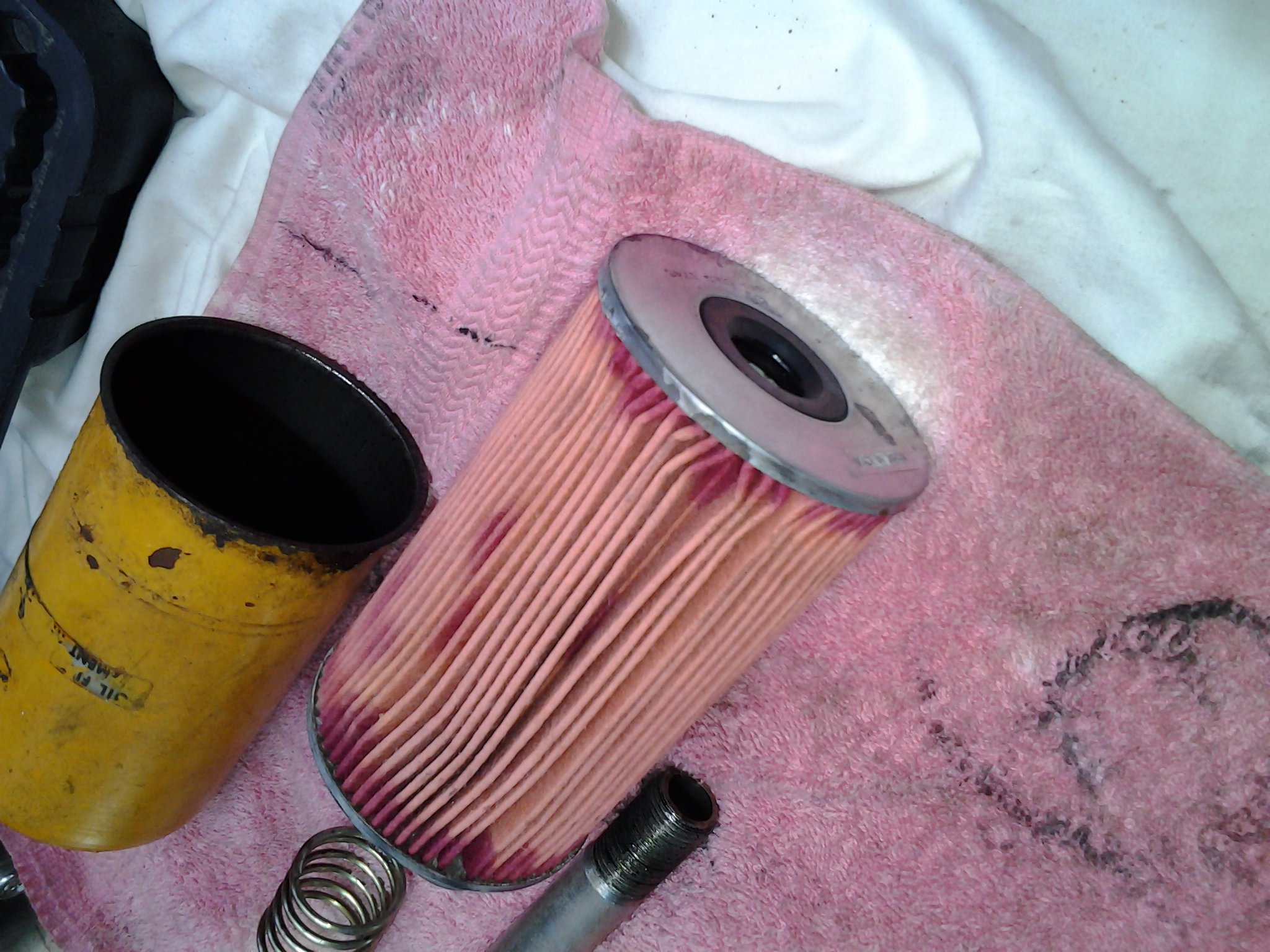

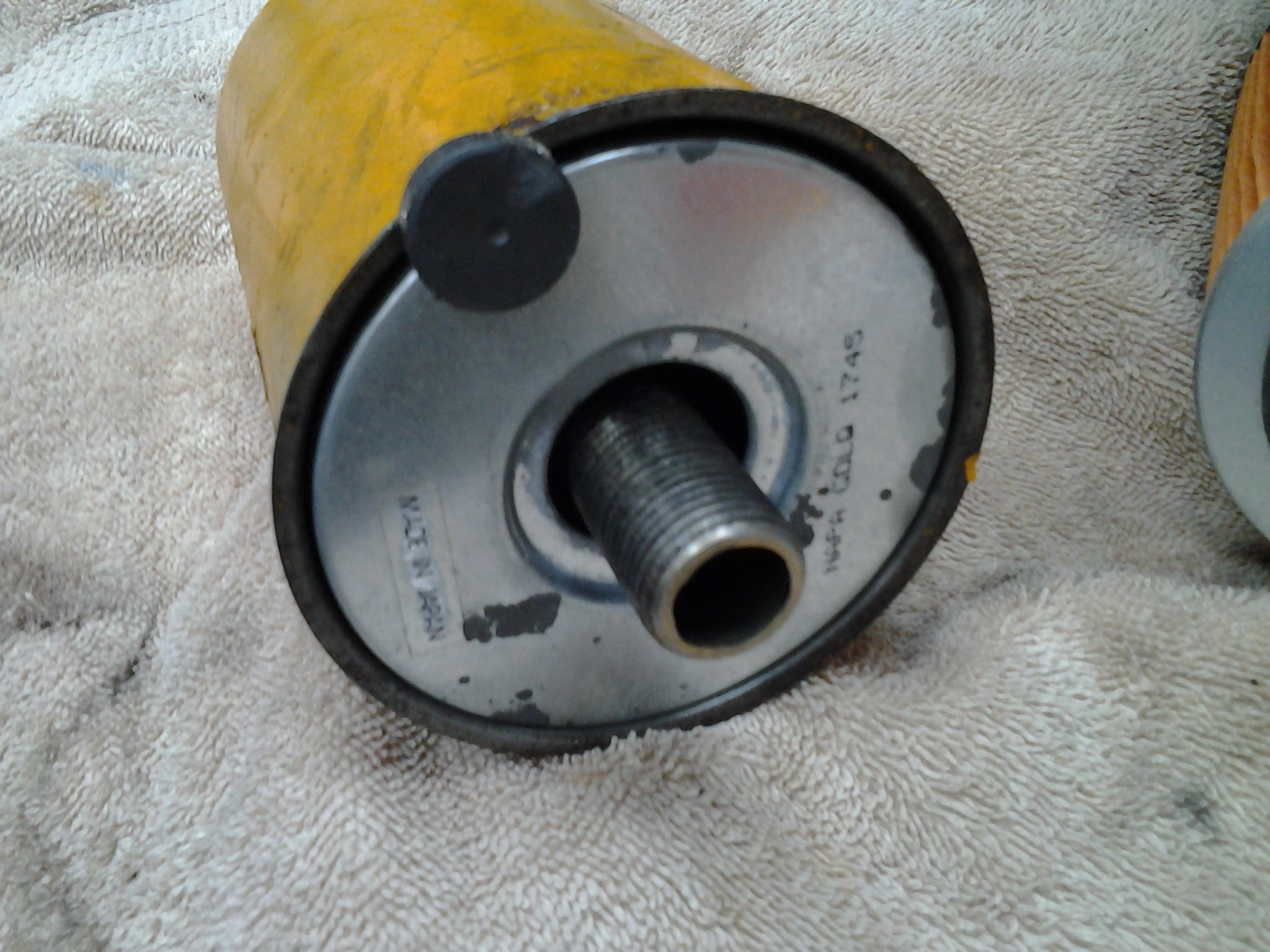

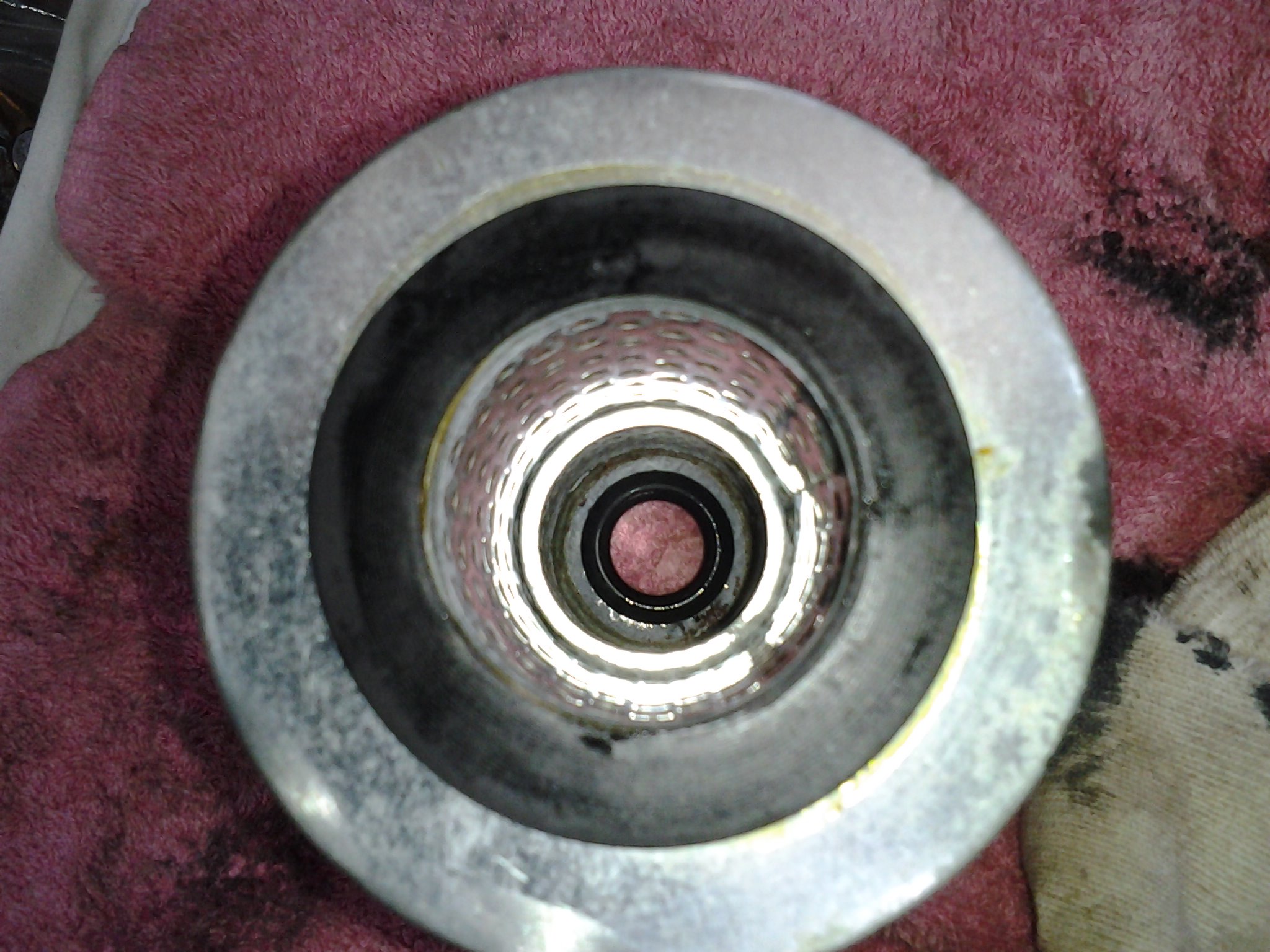

Yes it was both the wrong filter (Napa 1745) and installed upside down. The large hole goes down and is supposed to mate against part #15229-76200 in the last diagram attached. I am missing that part. I have the correct filter now #51399.
I realized that the
incorrect napa 1745 filter just fits inside the cover, its a bigger OD than the correct filter #1399 (in photo). I took the bottom
off the old filter, the correct filter fits in the old filter bottom plate just like it would sit on the missing "T" tube, minus the tube for now, but at least the oil will be going thru the filter. The only "if" now is will plate seal to the engine header. Looks like the tube was a stand pipe to keep the filter full when with the engine off.
Would you happen to have any shops in your area that could contact? No luck here in the US. The shops here a also getting a "no" from Nissan supposedly for my SD-22 serial # 137562.
Sorry I did not see this reply from you, for the 1st one I did receive an email notice, but not this one. Thx, Rich
I realized that the

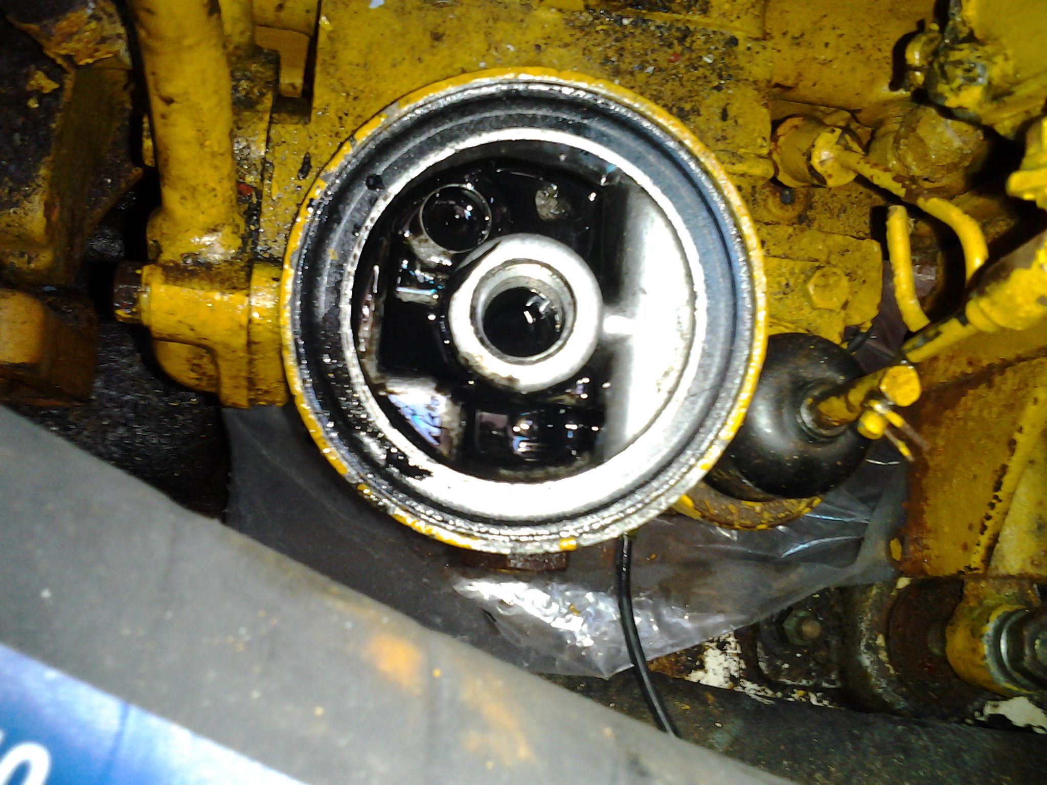

- My mod 1
- 2016-09-17 10.34.27.jpg (416.77 KiB) Viewed 40441 times
- My mod 2
- 2016-09-17 10.33.35.jpg (452.93 KiB) Viewed 40441 times
- My mod 3
- 2016-09-17 10.34.17.jpg (535.63 KiB) Viewed 40441 times
- My mod 4
- 2016-09-17 10.39.35.jpg (535.34 KiB) Viewed 40441 times
- Old post pic
- PICT0430.JPG (68.85 KiB) Viewed 40441 times
- Nissan part diagram
- Picture 2.png (144.96 KiB) Viewed 40441 times

Thanks Tom, The boat is a Sailcrafters/Columbia 41. I have not tried my mod yet, still waiting for a response from a couple of fork lift shops. I did finally get the 51399 filter and I'am using the bottom of a new dismantled napa 1745 filter (wrong filter) as you can see in the photo with the round magnet holding it in place. Hoping it will seal to the header gasket since it is a little larger than the filter and just smaller than the cover. Have had to explain the oil flow situation to alot of people when they suggest "just use a spin on", since the flow is a little different. What (IP?) pump did you have that was in the way? Thx.
- Scan 162550002.pdf
- (681.48 KiB) Downloaded 2011 times
- 2016-09-10 09.16.43.jpg (713.43 KiB) Viewed 40385 times

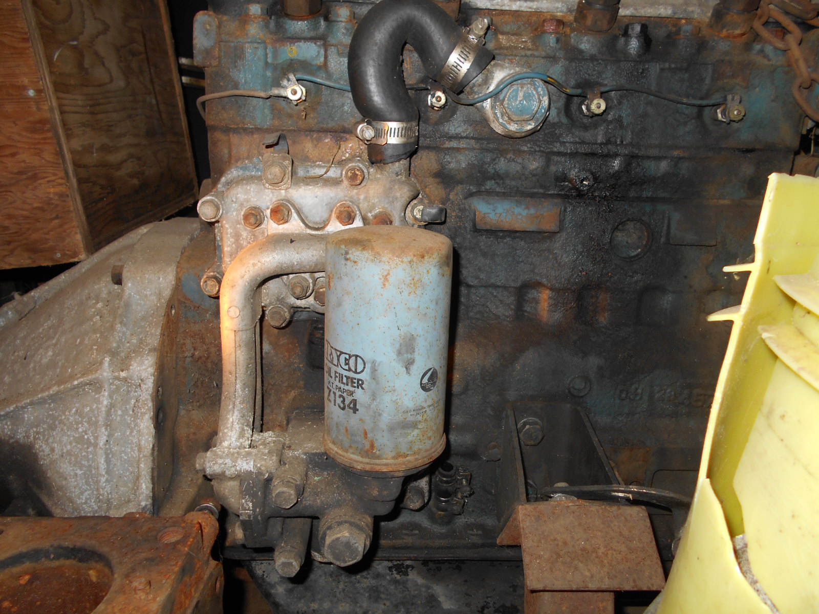

- Posts: 645
Re: SD22 (MARINE) OIL FILTER PROBLEM
Sailboat wrote:Thanks Tom, The boat is a Sailcrafters/Columbia 41. I have not tried my mod yet, still waiting for a response from a couple of fork lift shops. I did finally get the 51399 filter and I'am using the bottom of a new dismantled napa 1745 filter (wrong filter) as you can see in the photo with the round magnet holding it in place. Hoping it will seal to the header gasket since it is a little larger than the filter and just smaller than the cover. Have had to explain the oil flow situation to alot of people when they suggest "just use a spin on", since the flow is a little different. What (IP?) pump did you have that was in the way? Thx.
This block looks a lot like my diesel engine I imported from Australia, and my SD25 blocks, they all have the oil filter that points straight up instead of tilted forward like the normal SD22 engine, except the SD25 engines have an extra hose coming from the head fitting to the oil filter/cooler assembly.

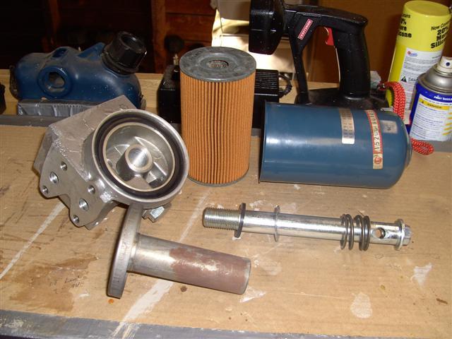

I just changed the oil and filter this morning, and took this photo.
The metal base of the element is bigger than the inner ring on the mounting plate. The element rattles around on the inside of the cannister when you're fitting it(it's a smaller diameter than the cannister.
But, when you begin to tighten the hollow bolt - that goes through the cannister + spring + washer - the element begins to line up and center inside the cannister. It makes sense as the upper washer on the element is tight to the bolt. Once the spring begins to compress on the element, it's pushed down on that inner ring.
As I began to tighten the bolt, I watched the element. I didn't guide it - it just centered inside the cannister. I took a pic before the bolt drew the cannister down to the rubber gasket (the one included with the element). You can just see the element can resting on the inner rim of the mounting plate.
Not perfect - it doesn't have a rubber gasket for a 100% seal, but it's not a bad seal. All oil is pumped through the hole in the hollow bolt, above the element, and suction pulls it through the element, and back to the engine.
I know the element wasn't designed with this in mind, just luck.
