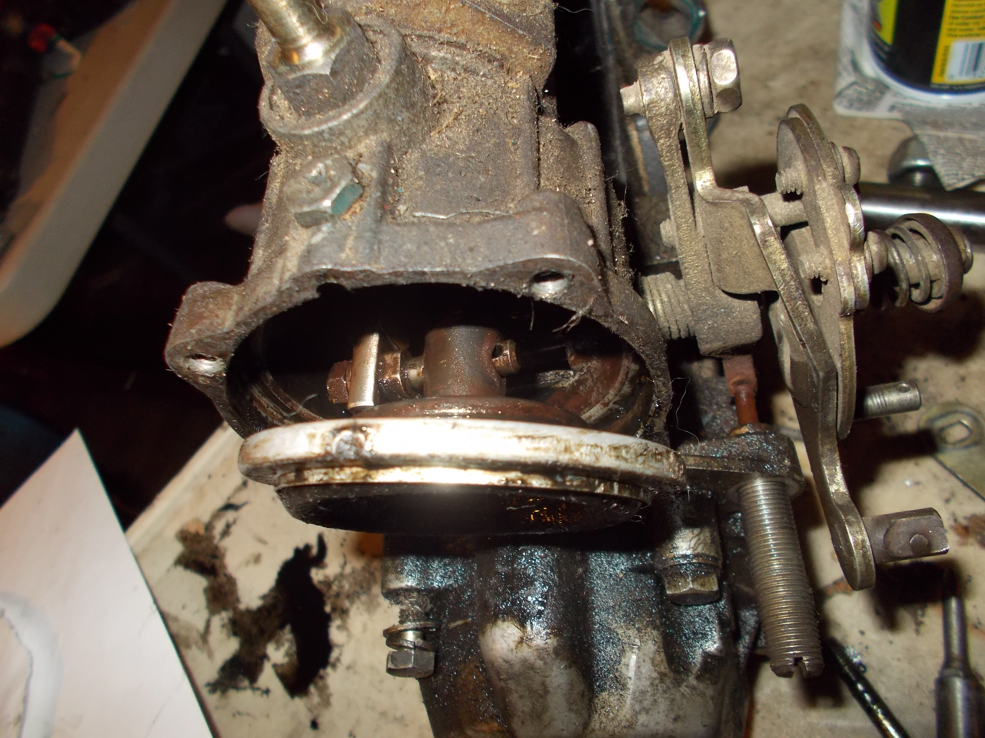

I've got the back off my pump (in the truck) and I can't tell what's holding the diaphragm in. I don't have a spare so I want to be super careful getting this one out for cleaning. Is there a circlip or something that needs to come out? Also, has anybody got a source for these yet? I read the many threads and followed links but didn't see one. Thanks

Do you see where the clip would be in the attached photo.

Aha, so I have to get behind it for removal. Can it be pushed open with the fuel lever or do you pry it with off a tool?
