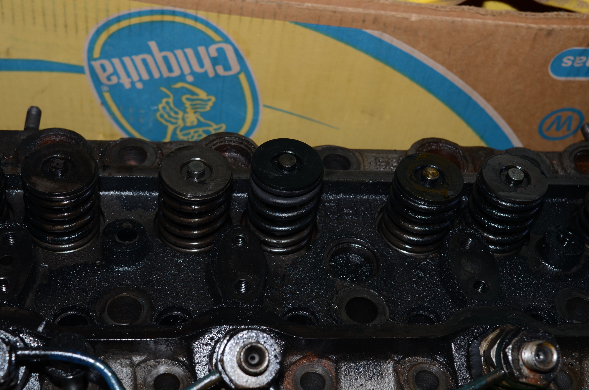

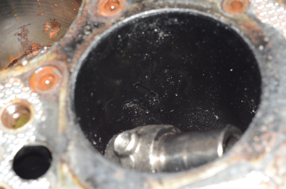

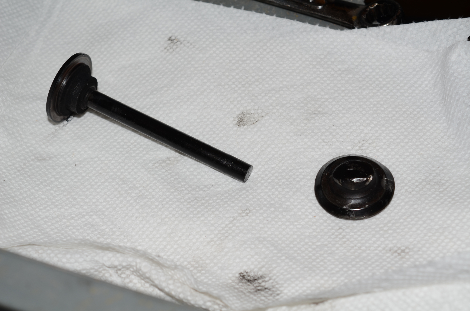

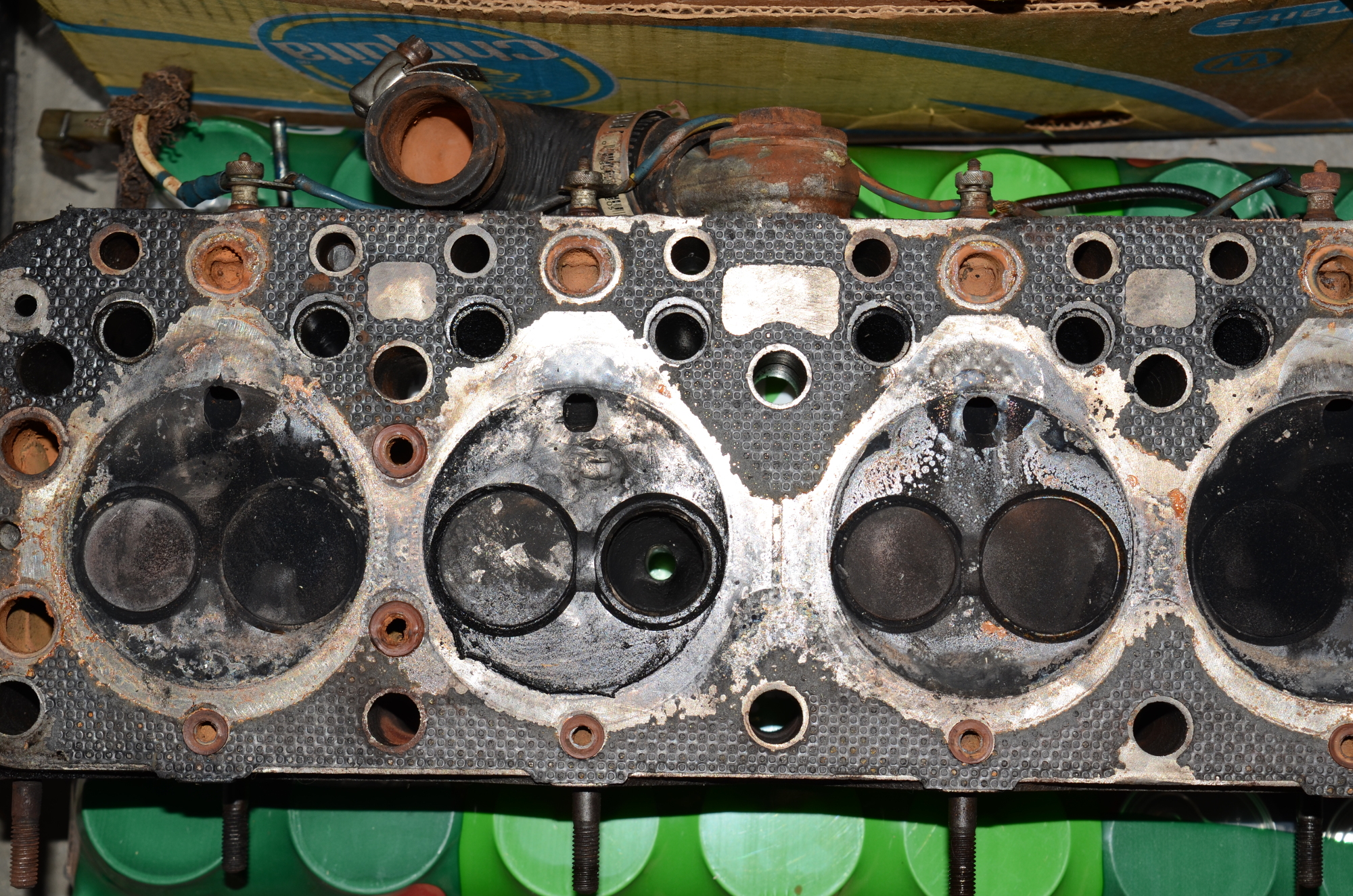

Pictures attached. let me know what you think
scored bore
scored bore

the spring. The discoloration was more prominent before accidentally getting oiled during removal
combustion chamber
combustion chamber

Just looking at this and trying to come up with an idea as to why. It's interesting that the head of the valve broke off. I was expecting to see that the keepers were missing.
I know that there are a couple of different head gaskets for these that will not allow oil to flow to the top end depending if you have the correct head and block match up. But not sure that "may" be the issue here.
Incorrect fuel pump timing, IMO, should not cause this failure. It would have to be SO wrong you would have difficulty in starting it, if at all, and, too far advanced and still able to run would most likely be so noisy you would hear it, and would probably break the top piston ring and not the valve.
I also find it interesting that #3 failed both times.
Incorrect "engine" timing could cause this but I would expect to see damage to the other valves from "0" clearance.
Even setting the valve clearance too tight would not cause this as it would have to be so far out of adjustment it would not start and, I think leaving an adjustment nut loose I think would most likely just back out to the point where the valve would not open at all.
You are most likely going to have to buy a liner to replace the one that is scored. Once they have been installed they are pretty difficult to remove without damaging them and "re using" them from one install to the other is not really a good idea anyway. They are a dry liner and there is a special pressing/pulling type of tool/procedure required to get them out. They can be put in by heating the block and freezing the liner but as mentioned above not really recommended.
Just doing a bit more thinking here.
What kind of shape is the crankshaft in, especially as it related to #3. Are the bearings pounded out, perhaps allowing the piston to come too far up in it's stroke and then hitting the valve ?
Perhaps pull the rest of it apart and see what that uncovers.
I will have to ponder this a bit more, but those are my thoughts for now.

Just looking at your photos again and, to me at least, does not look like there is a lot of oil lying around on the top of the head. It should, IMO, have quite a bit more lying there than what I see. Did you wipe it down at all, or is that just the way it came off ?

I could be wrong on this but it appears (to me at least) that the head you show is pretty "dry" and appears to have been pretty warm to get all that black crusty carbon there. As stated above, when I do a valve set on my truck ( which has been a while) that I end up with some oil running down the sides of the head making a mess.
Have you checked the rocker shaft for excessive wear on it and for "side to side" wobble in the rockers themselves ?
Another possible problem is the valve seat is worn out and not allowing the valve to sit flush and on center. This can cause it to wobble as well.
From the looks of combustion area of the head you show the EGT's do not seem to have been excessive to me.

I'm also looking at the area between #2 and #3 on your picture and it almost appears that they may have been leaking into each other. Both combustion areas seem to be really clean as well and I am wondering if you did not have a bit of water intrusion into them.

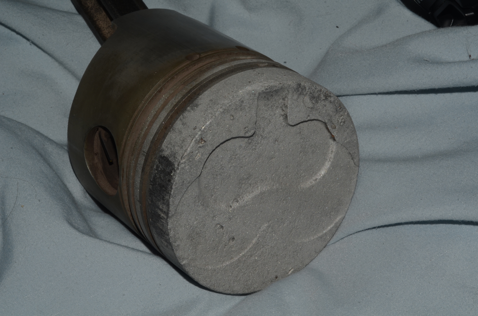

Also, does this look acceptable for a replacement piston? its a bit pitted, not sure if that would cause problems.
donor piston
donor piston
1982 720 SD22
Florida
Re: Dropped valve, engine failure-- Cause?
Piston does not look too bad. I assume that you media blasted it with something to get it that color ? What kind of shape are the ring lands in? Hard to tell from the picture.
How does the liner look or are you going to get a new one ?
You say the rockers are fine, how about he rocker shaft ?
I am wondering if the lack of oiling in the top end might have allowed for a valve to hang open and get hit maybe ?
Might also be the cause of the worn out guides.
As for guide wear I will have to look in the FSM for a number. It's pretty small as I recall though.
I would take the oil pump apart as well and see how worn that is and how much tension is left in the pressure valve. If it's getting a bit weak either see if you can get replacement or find a washer to put under the spring to add a bit of pressure to it.

plenzen wrote: I am wondering if the lack of oiling in the top end might have allowed for a valve to hang open and get hit maybe ?
That was my first thought when I saw that clean break...
