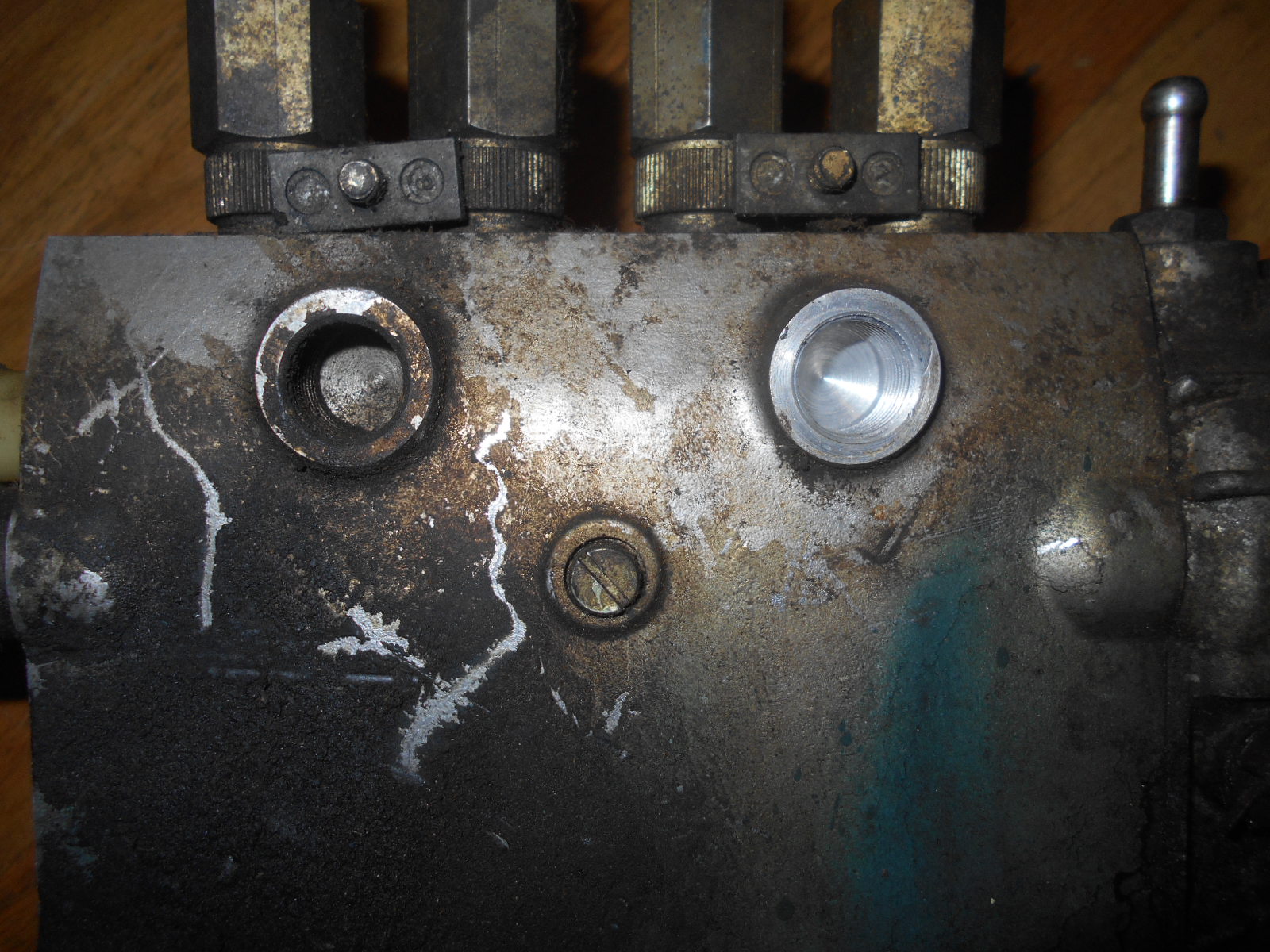

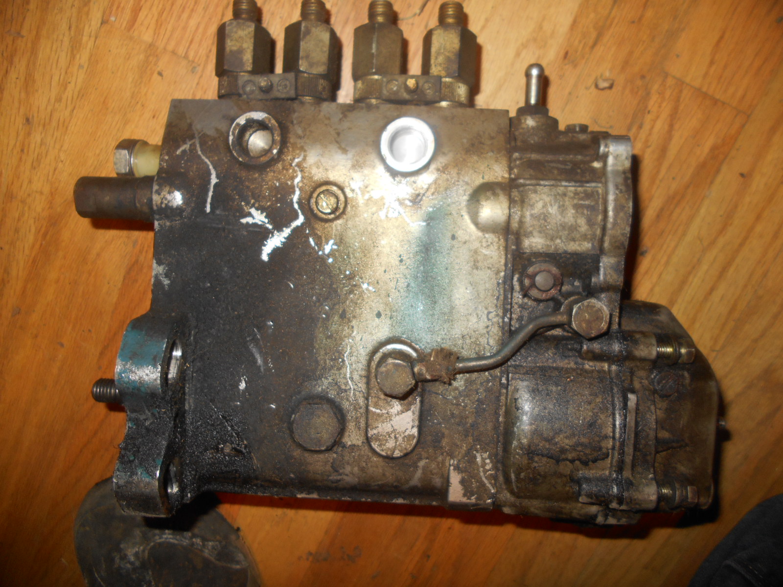

Re: Plensen or wayneswold Help needed please
I have never had one apart and put back together, but I have one off the engine right now, so I took a couple photos of it.
Could that little screw have been removed, or did it just start leaking for no reason?
The pump don't have a top to remove, are all the injector lines tight on the top of the pump?
This might not be the kind of pump you have, if yours is a VE type pump then I have not a clue.

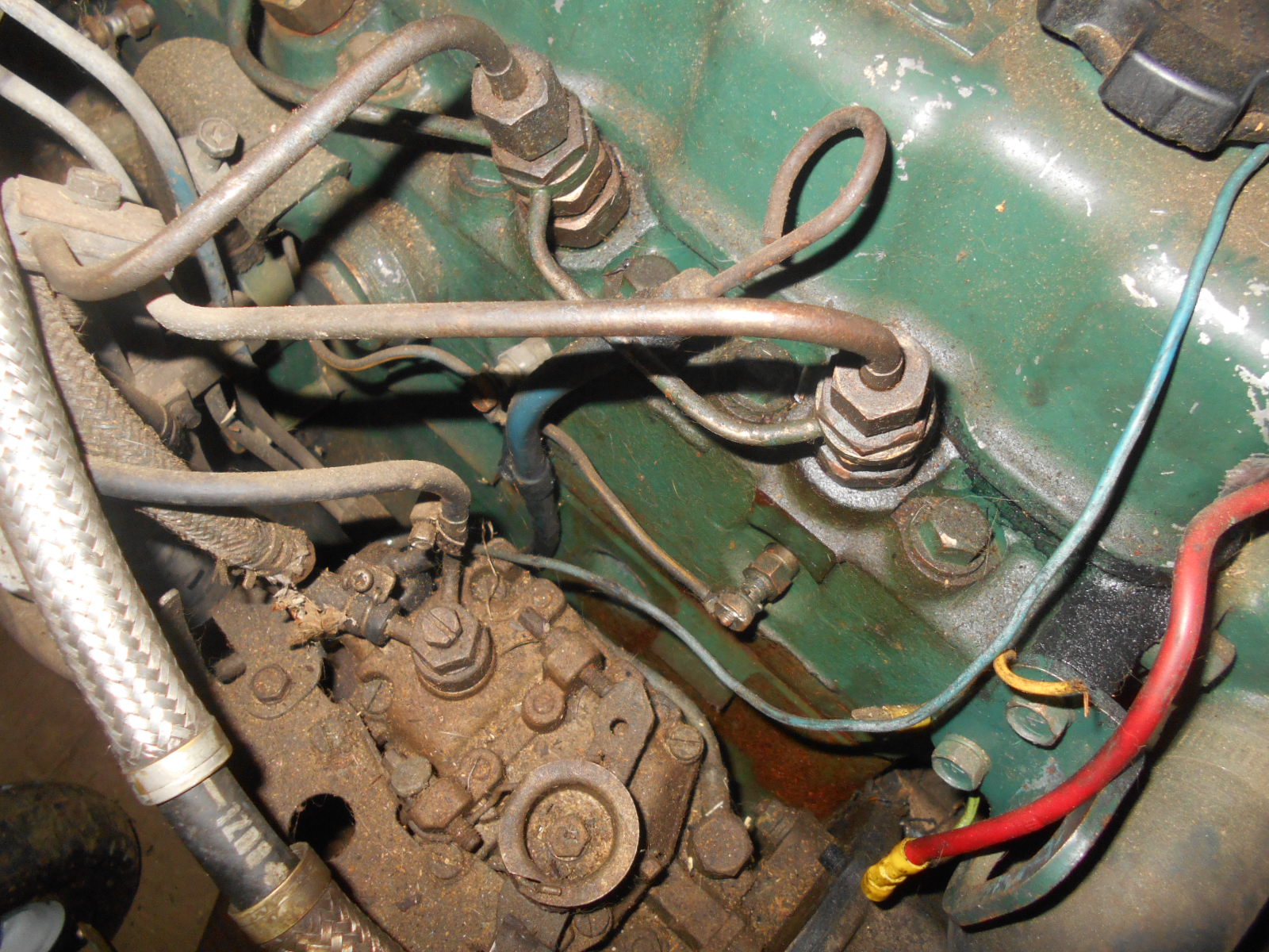

There is not a lot in back of the VE injection pump except a fuel supply line going to the front of the pump and the oil dipstick tube, if the fuel line got a hole in it that would be a leak for sure.
You can see it squirting out from between the seams in the housing, I just cannot see how changing glow plugs could cause this issue unless something got dropped and a screwdriver was used to retrieve dropped part and the line in the back got punctured or the housing was used for leverage and it got damaged, seems like you would be able to see the damage though.
Below is a photo of the back of the VE injection pump, I do not know a lot about these pumps, I have this one because a business back east was clearing out their inventory on eBay and I snagged this rebuilt one for a reasonable price.

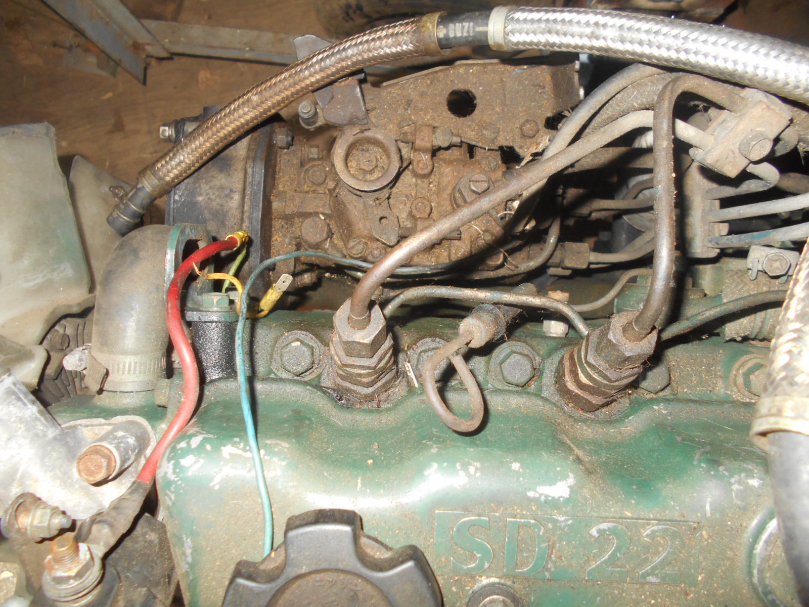

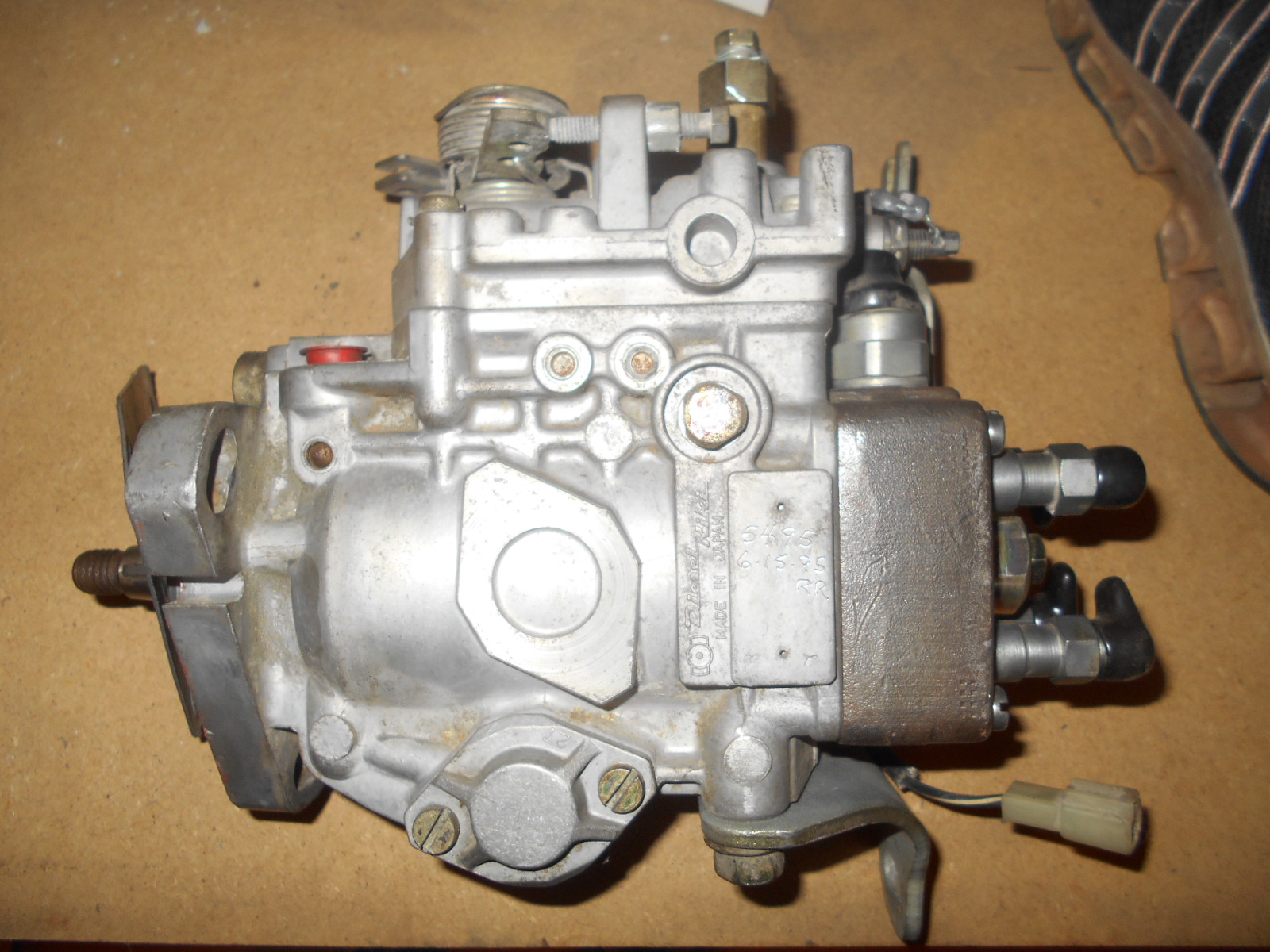

I have heard that the VE type injection pump don't last near as long as the inline pump as they last a long time.
Is the SD22 and SD25 VE type injection pump the same pump, can I use a SD22 pump on my SD25 and expect it to run properly or does the SD22 pump need to be turned up/modified internally?
I would likely already have tried to turbocharge the SD22 I have with the VE pump if I had not bought the SD25 turbocharged engine from Larry(larryr on here), but in the end I am happy it played out the way it did and I succeeded in getting the 720 and the 521 running properly with the turbochargers as blow thru with the inline pumps, I have learned a lot over the last few years.
I even learned how to make it work as a draw thru, but a proper turbocharger with proper seals needs to be used so oil isn't pulled thru the turbos seal, and they do make such a turbocharger as I asked when I visited a turbo specialty place, but I am cheap and didn't want to spend that type of money as I still didn't know if this whole thing was going to have a happy ending.
Below are a couple photos of my rebuilt SD22 that I put a VE type injection pump on that I got off an engine I had shipped from Australia, you can see the oil dipstick tube between the first and second injectors, it's in the same place on the Australian engine, but the tube might have gone up to a different place.
- DSCN7054.JPG (454.9 KiB) Viewed 17332 times
- DSCN7053.JPG (463.56 KiB) Viewed 17332 times

Is this the same injection pump as your injection pump?
http://www.ebay.com/itm/Nissan-SD22-OEM ... V2&vxp=mtr
The pump is used, but the seller has 100 percent positive feedback, something to think about if yours cannot be fixed.
