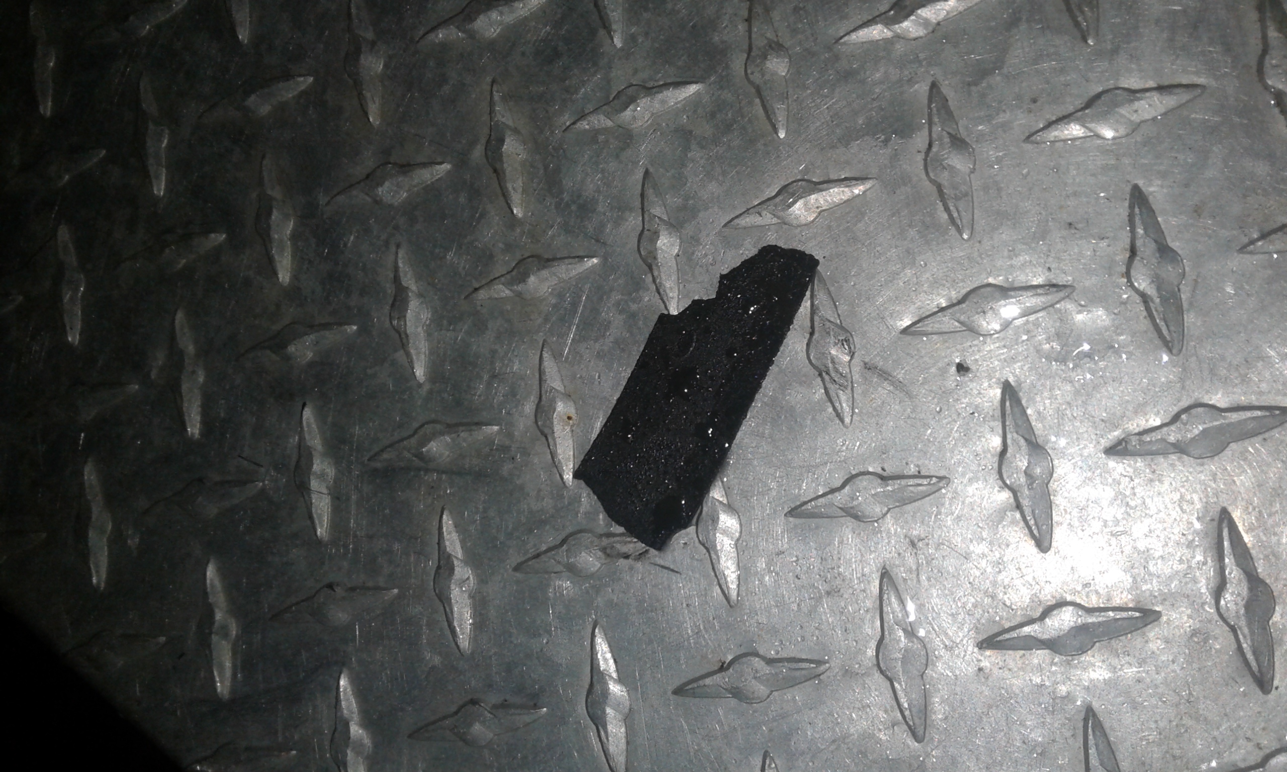

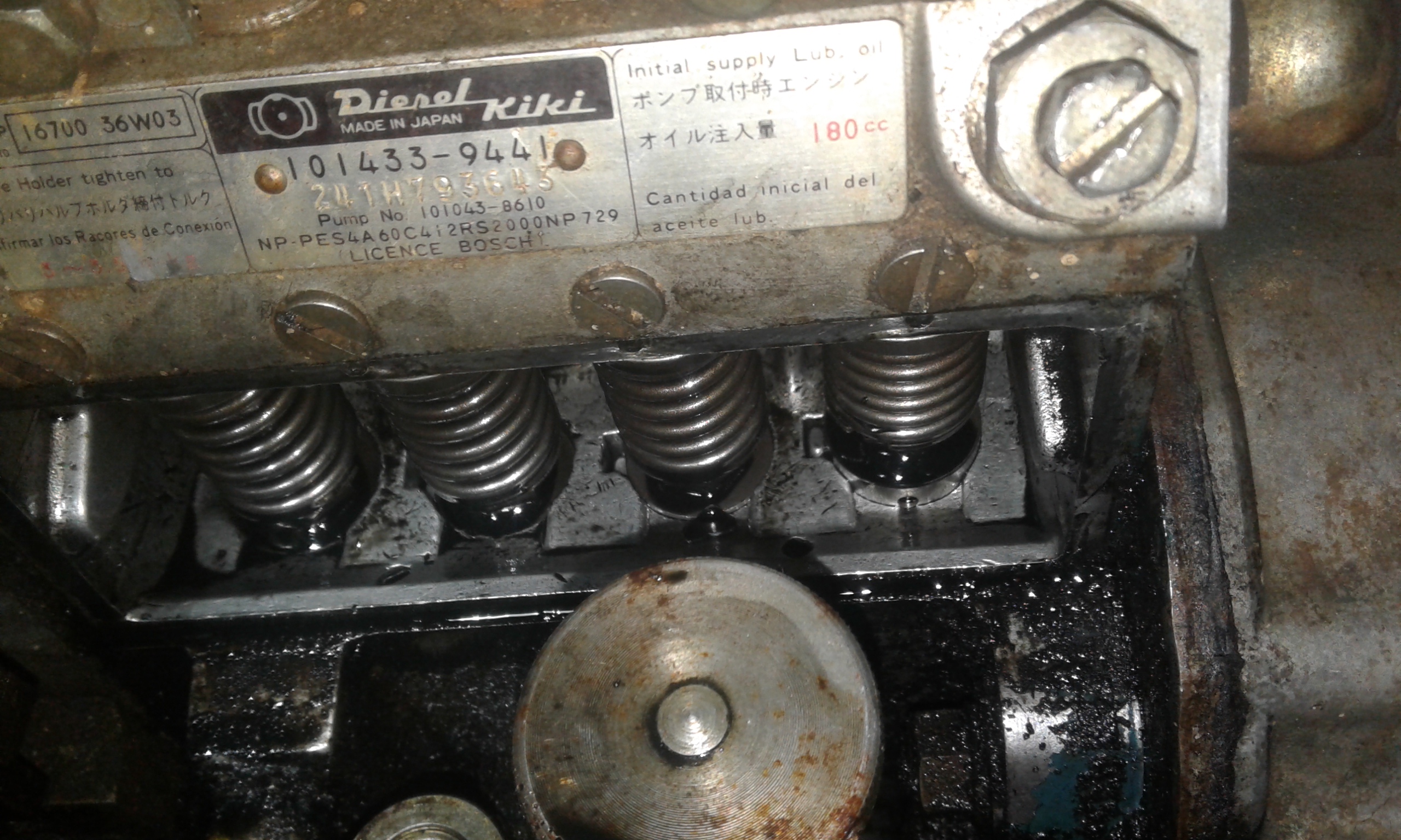

I think this is how you post pictures, this is where I retrieved the stuff out of the pump and the largest piece, all of the debris was similar besides being smaller pieces. It was all up in the plunger springs.

I'm trying to find an exploded view of your pump to see what the heck that was. I'm thinking a deflector of some kind that directs spray or something like that for lubrication.
Heat shield maybe ??

I didn't even think of it possibly being an oil deflector but whatever it was came apart and stuck the fuel rack open

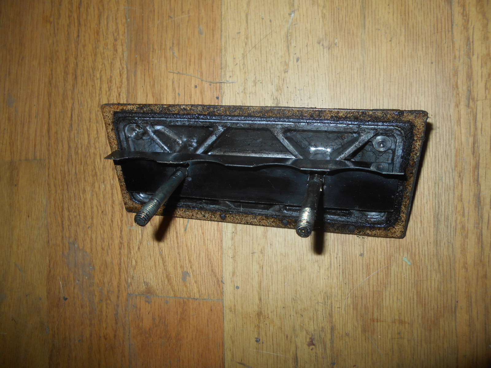

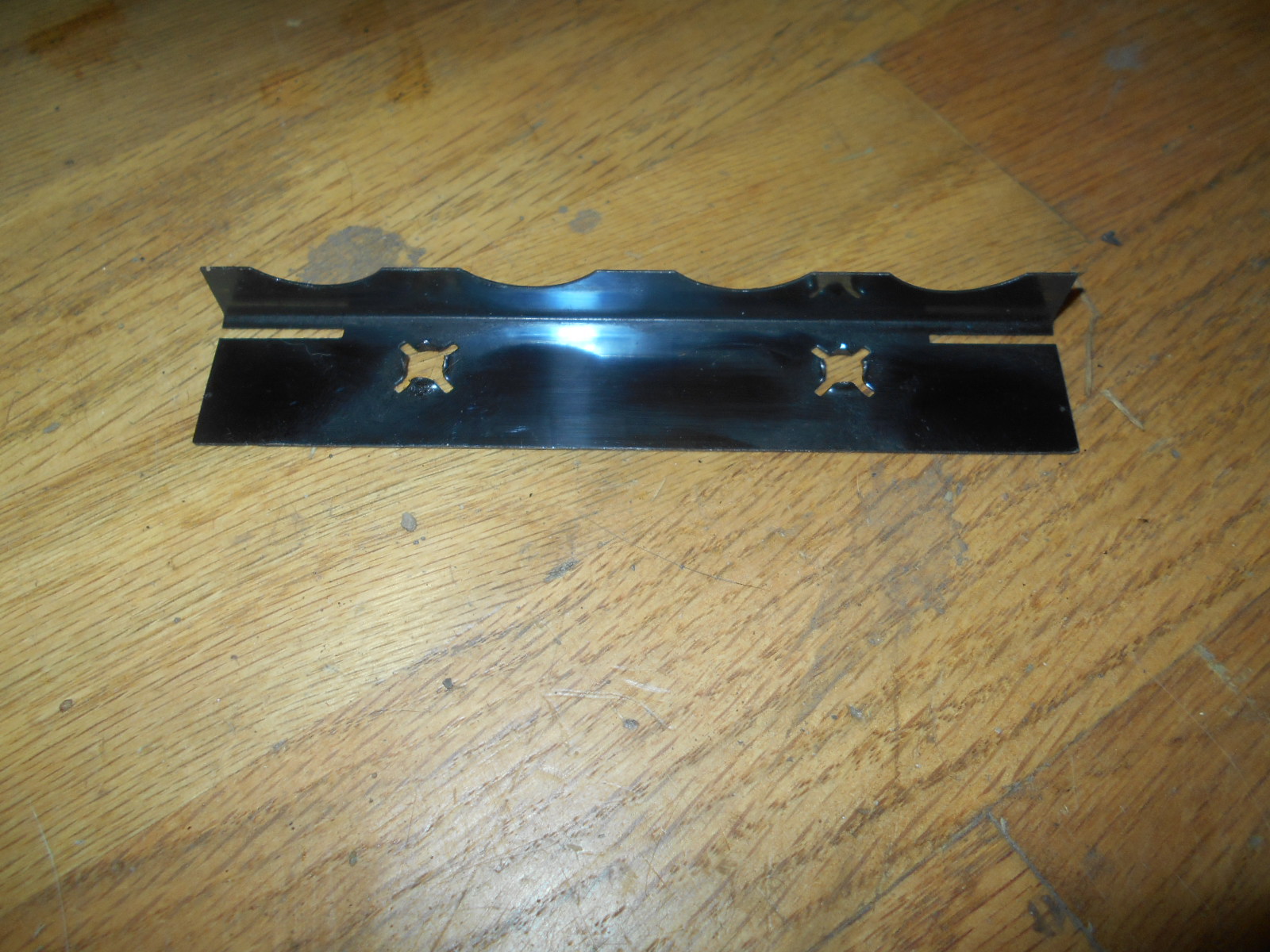

Did you have this piece of metal held by the two bolts that hold the cover on?
- DSCN7157.JPG (472.79 KiB) Viewed 12941 times
- DSCN7156.JPG (474.04 KiB) Viewed 12941 times
- Posts: 13
- Joined: 8 years ago
- Location: Vernon, Florida
Re: Sd22 Runaway and diaphragm hunt
No I don't, it wasn't there when I took it apart, that does look like what all of the debris were at one point. Was that an oil deflector?

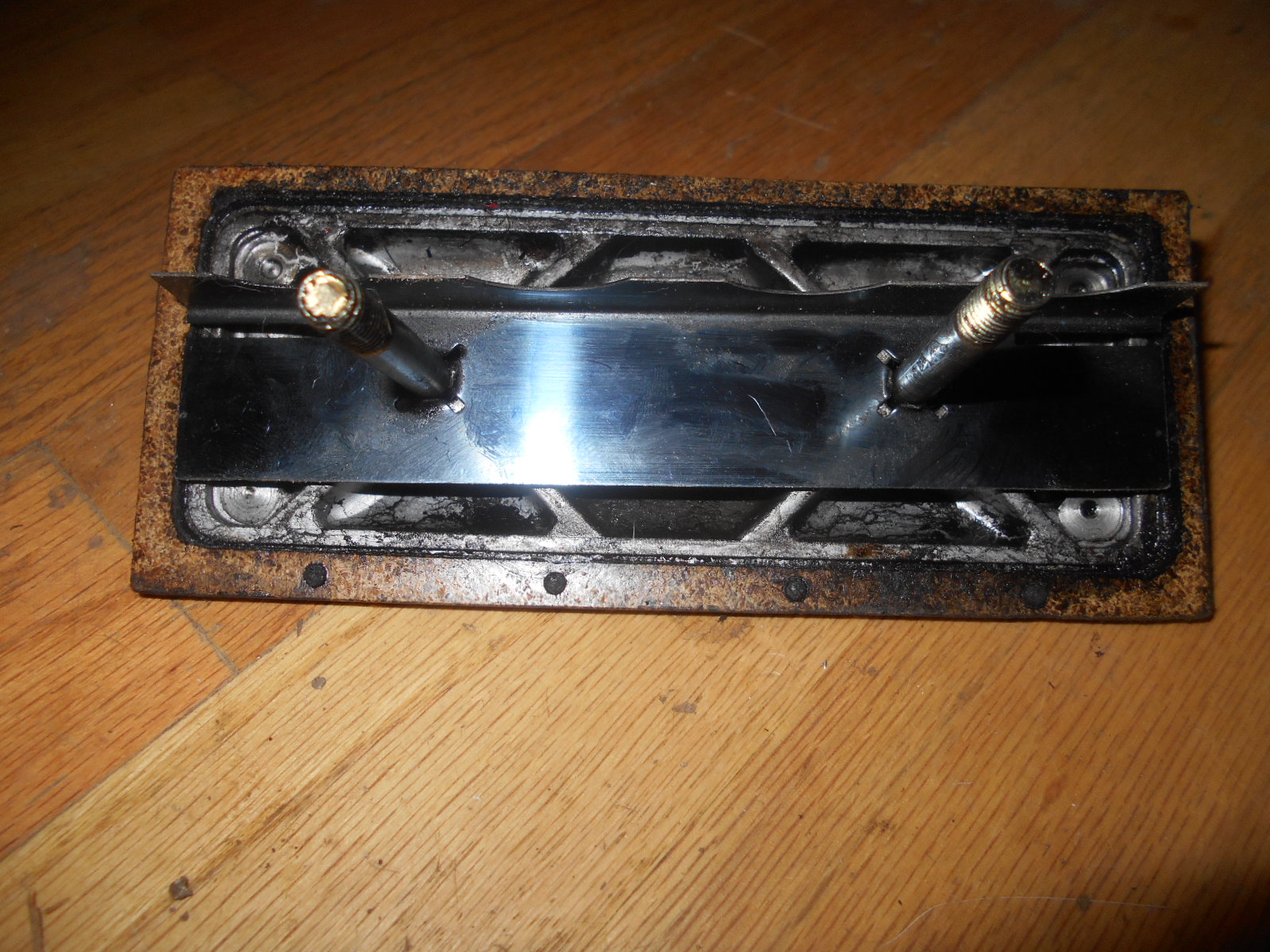

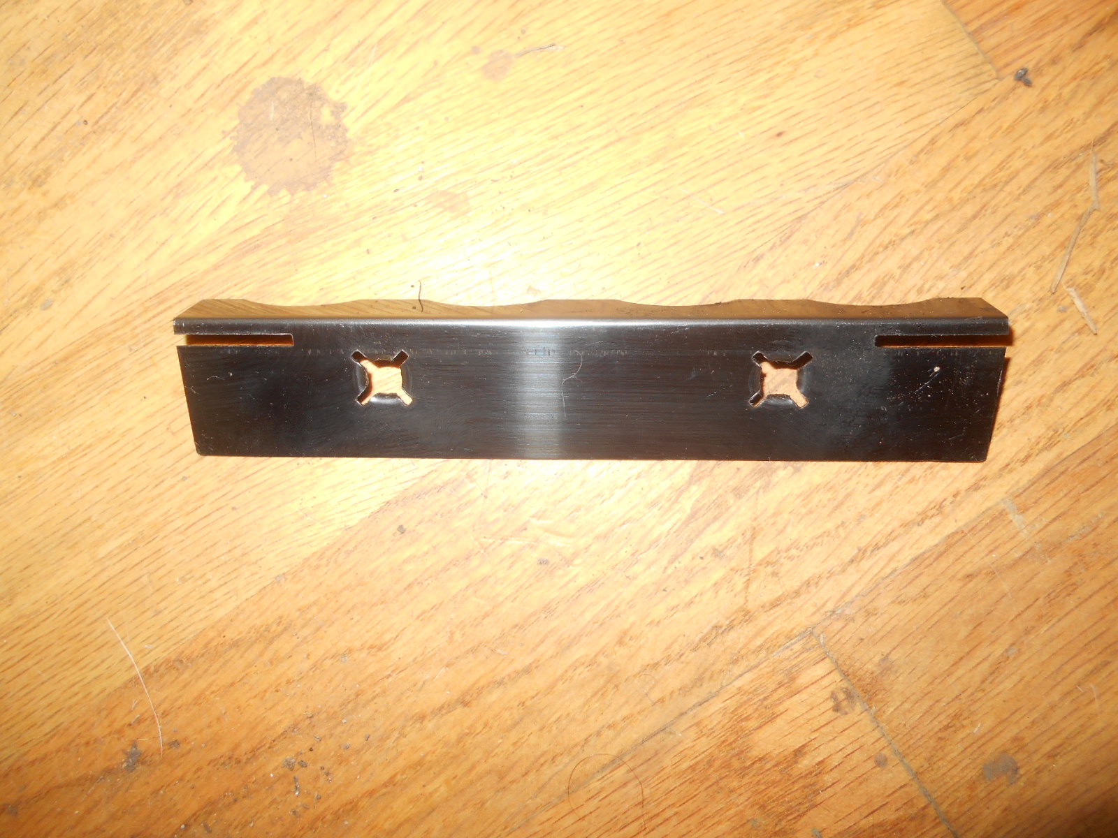

Well I am not sure the exact way it mounts, but it is something like this in the photos below.
- DSCN7159.JPG (463.27 KiB) Viewed 12935 times
- DSCN7158.JPG (459 KiB) Viewed 12935 times
Is it necessary for that to be in the pump? If so does anyone know where I could find one?
I am sure it has some kind of function, hard to say if it is needed/required.
My question would be how it got chewed up in the first place, did someone take it apart and then put it back together wrong?
I would say that it's there to direct lubrication towards the plungers, or, to keep oil from spraying directly against that cover like a crankshaft slinger does for the front seal. How it became loose and got chewed up by the plungers is another mystery. Finding one may be a "quest". I would suggest visiting a diesel fuel injection rebuild shop and print picture of what Wayne posted and asking. It may be a common part that crosses many 4 cyl inline pumps.
