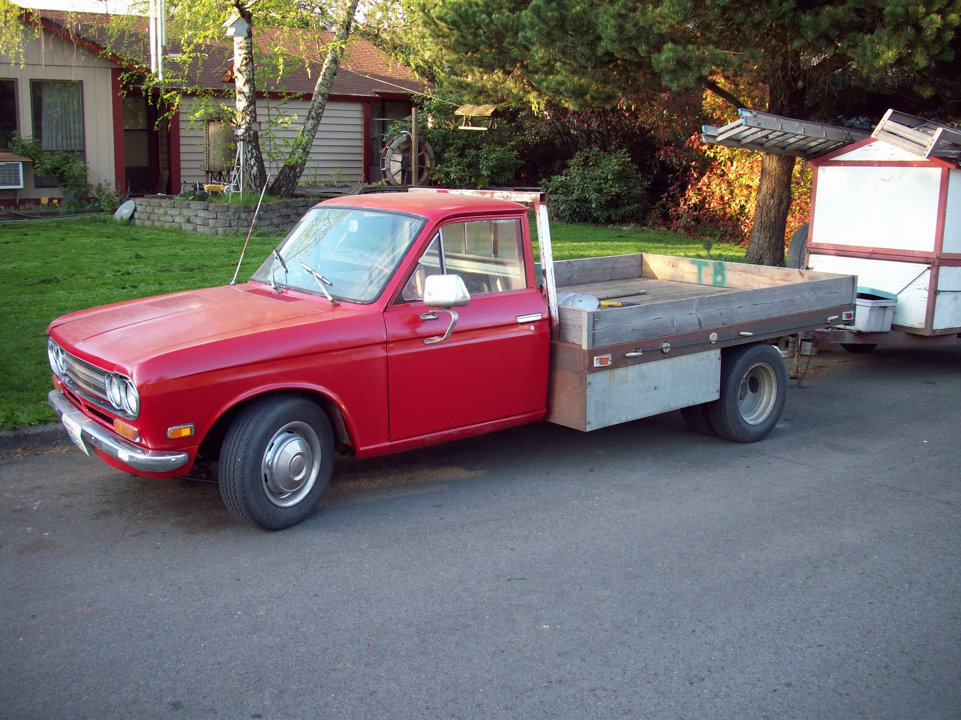

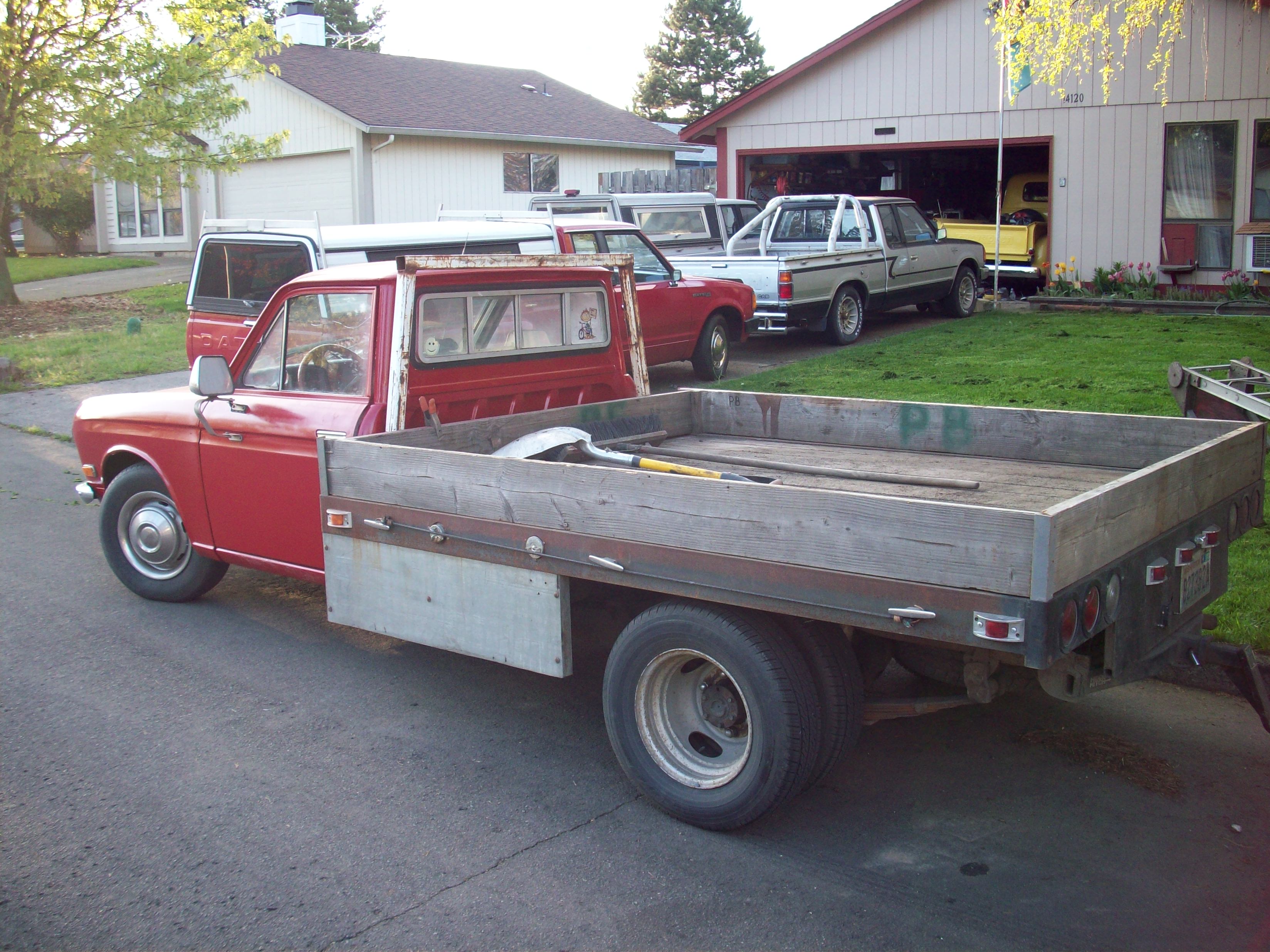

This is my 1971 Datsun 521 work truck, it was made by me to suit my needs, hauling heavy loads, debris, and firewood.

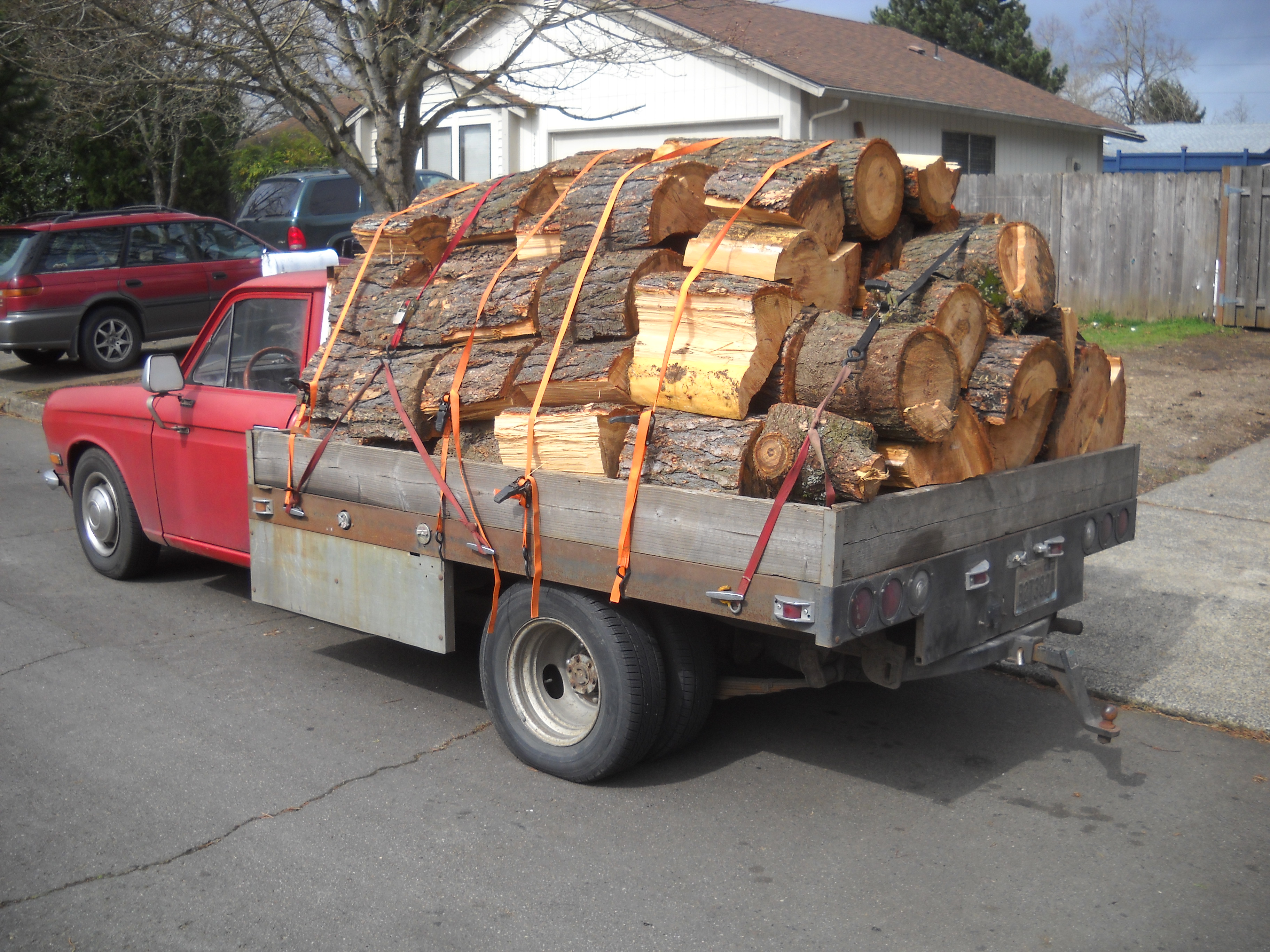

This one of the many loads of wood I have hauled over the last 20+ years with this truck.

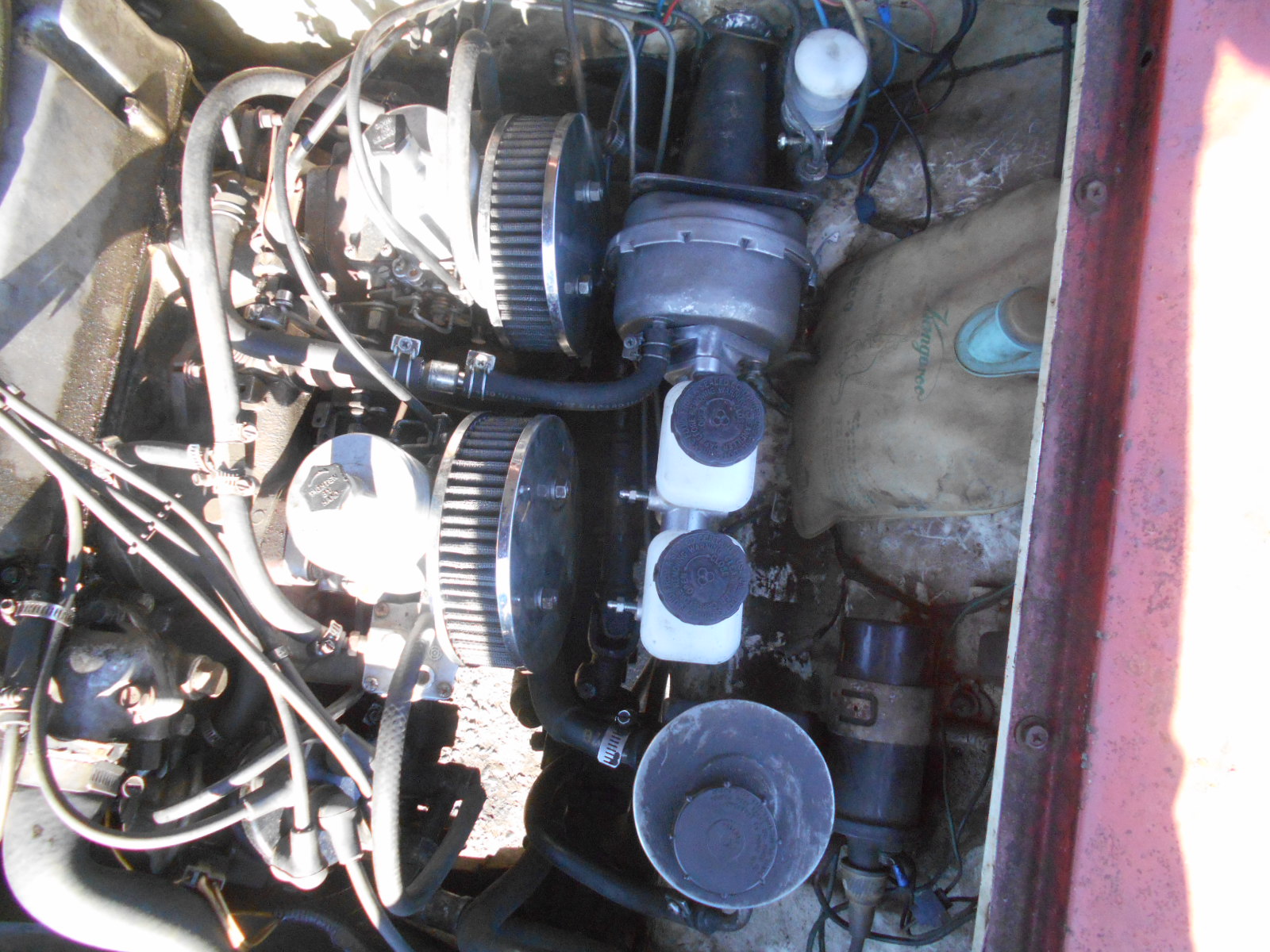

Recently I bought and installed a 1973/74 Datsun 620 power brake booster, and 1979 Datsun 620 brake master, the truck has dual SUs, power steering, a heavy duty 5 speed transmission, a LZ23 hybrid engine, and front disc brakes from a 1990 V6 hardbody.
The first power brake booster only lasted a couple months so I installed another one today, unfortunately they forgot to install an internal rubber piece and I was very unhappy for a while, I pulled it back apart and figured out what was wrong and used the bad boosters rubber piece, this usually takes me a week or more to figure stuff out like my 521 turbodiesel issue, but I figured it out right away this time and now I have my awesome brakes back again, I drove this thing for 20 years with the stock single reservoir/circuit brake master like when I hauled that load of wood above home, I should have upgraded to power brakes 20 years ago.

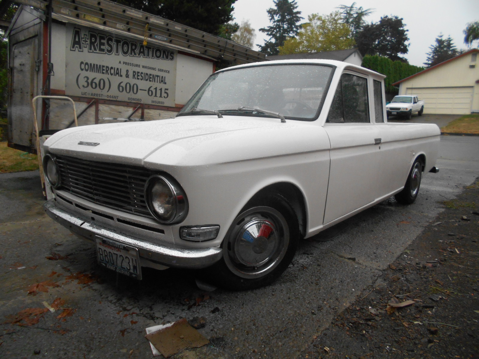

Here is a photo of my 1966 Datsun 520 ute.
