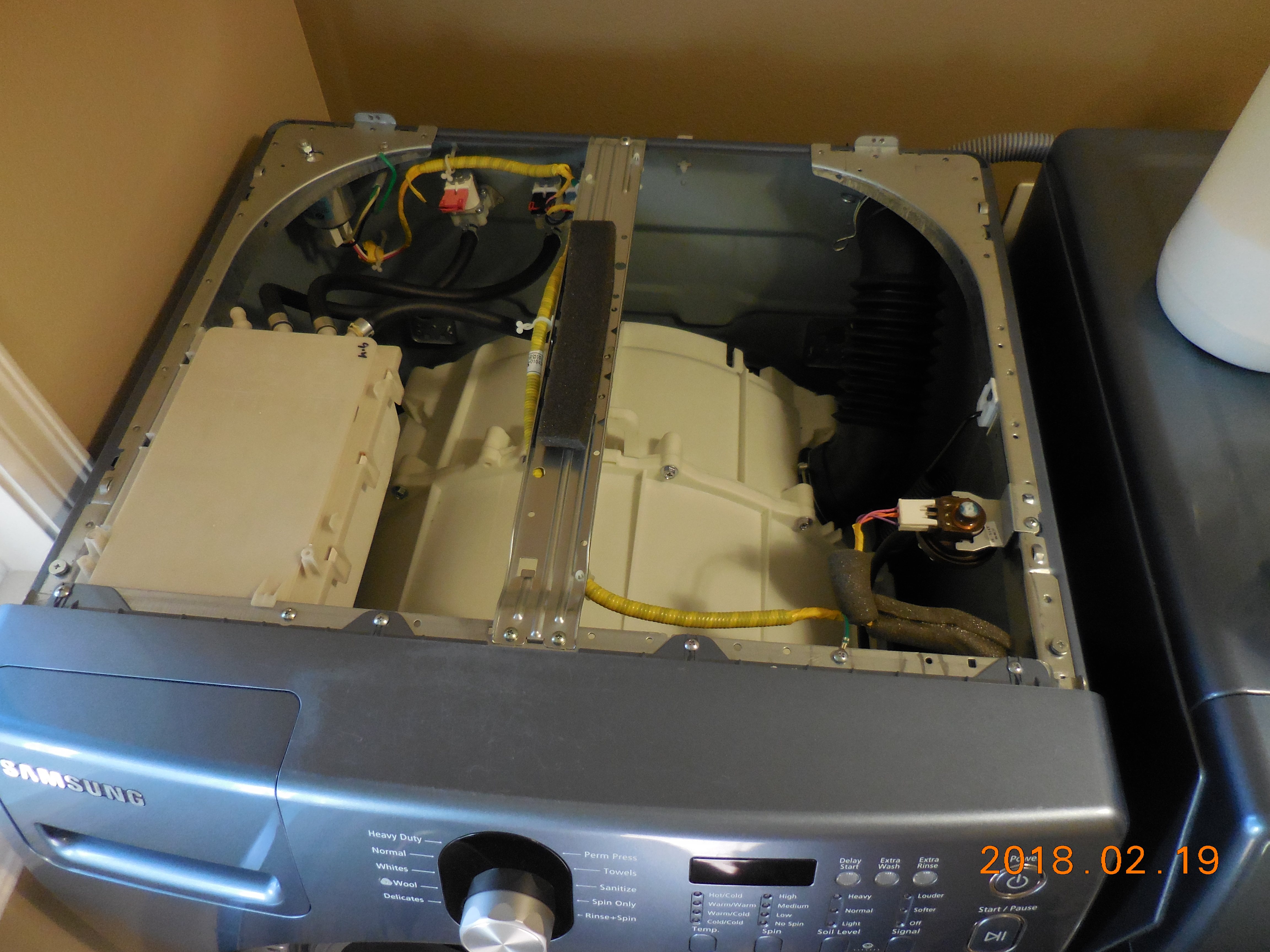

The WF219ANB/XAA front-loader started giving the dreaded (and common) "nd" code (no drain) last week. While I had the usual issues with junk in the lower filter and a partially obstructed drain hose (the installer had a loop in it!), cleaning it all out didn't fix it: the tub would drain two or three times OK, then another "nd". If you search for that code and Samsung, everybody will point you to a failed water pump, clogged discharge hose, clogged pump inlet hose, etc.: all problems related to getting the water out of the tub. The water pump motor is cheap (the pump + motor a bit less so) but the labor is not so easy, due to having to remove the top and front of the machine to access the pump enough for removal (you can just barely reach and remove the hoses, but that's about as far as you'll go). So, I wanted to make damned certain that the pump had to be replaced.

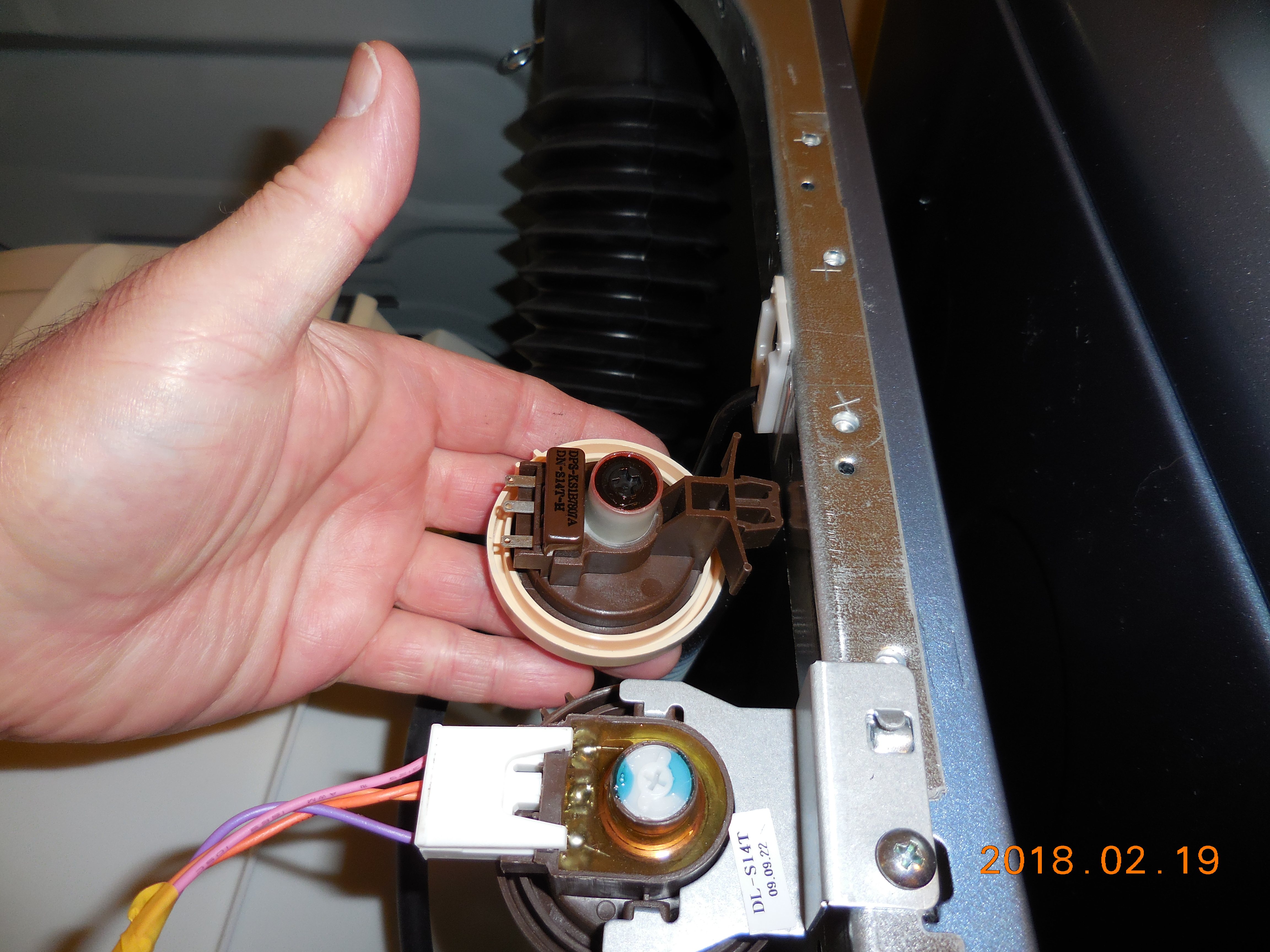

The Board Input Test of the water level sensor signal (output is shown on the LED panel!) was showing a water level sensor frequency of 284 (28.4khz) for full and 624 (62.4khz) for empty.

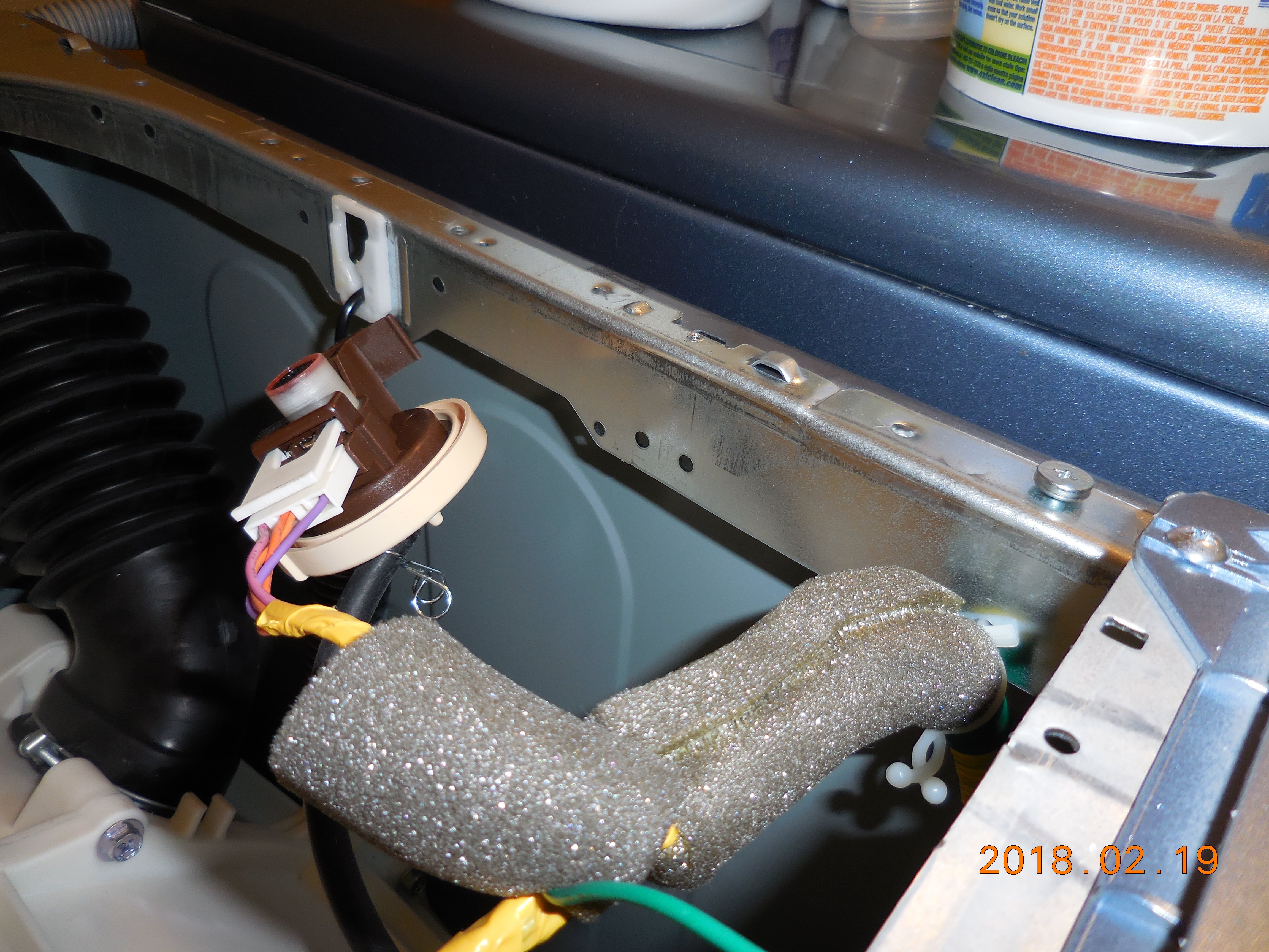

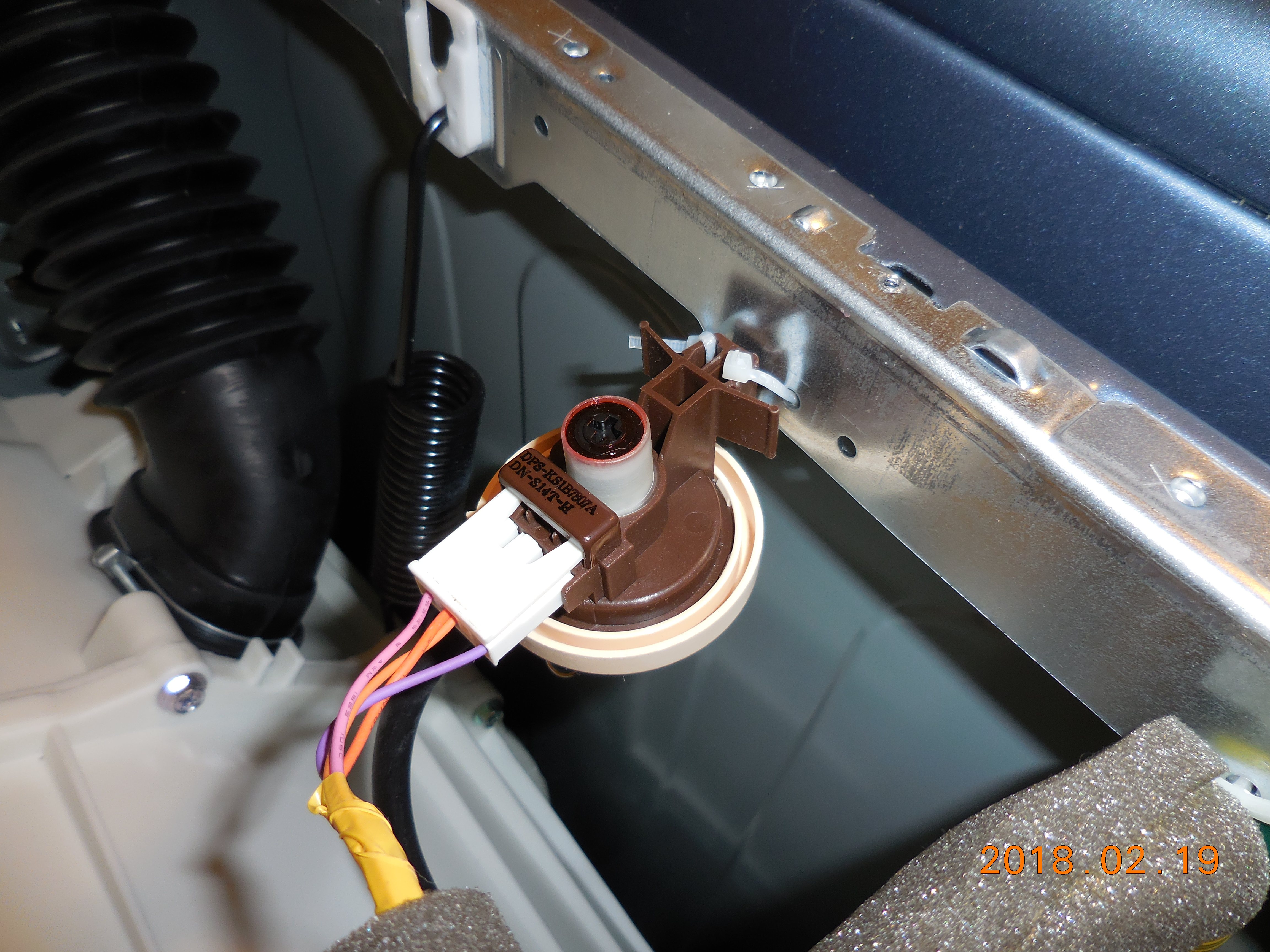

Not knowing the normal specs, I rolled the dice and purchased this ERP ERDC96-01703B replacement for the original DC96-01703B (that's the right part No., according to Samsung's website). While the metal bracket of the original does not come with this replacement, apparently neither does the metal bracket come with the genuine Samsung part. However, electrically it appears to work OK. I now have a full tub reading of 438, an empty tub reading of 632, and have run two loads to completion without an "nd" code; previously, I could not get through a heavy-duty cycle without it stopping.
It's early days, and who knows how durable this $14 replacement will be, but out-of-the-box it seems to have solved my no-drain problem.
[09Mar2018]
Fifteen loads later, no problems. I'm calling the "nd" (no drain) problem solved, by replacing the water level sensor.
Following several guides on YouTube, etc., I have also adjusted the water level via the plastic screw-top on this sensor, to provide about one minute more water run time during fill cycles. The water level is noticeably higher. Make small (1/2 turn) adjustments and check. I ended up at two turns in for about one add'l minute of fill time at 70 PSI inlet pressure.
Fixed my problem, though the EPR part is not a drop-in, screw-compatible replacement.

- Top of washer off.
- Samsung_DC96-01703B_Water_Level_Sensor_01b.jpg (1.65 MiB) Viewed 70706 times
- Original 2009-vintage water level sensor (affixed with integrated metal bracket).
- Samsung_DC96-01703B_Water_Level_Sensor_02b.jpg (1.66 MiB) Viewed 70706 times
- Replacement sensor loosely connected.
- Samsung_DC96-01703B_Water_Level_Sensor_03b.jpg (2.07 MiB) Viewed 70706 times
- Replacement sensor zip-tied to chassis.
- Samsung_DC96-01703B_Water_Level_Sensor_04b.jpg (1.87 MiB) Viewed 70706 times
