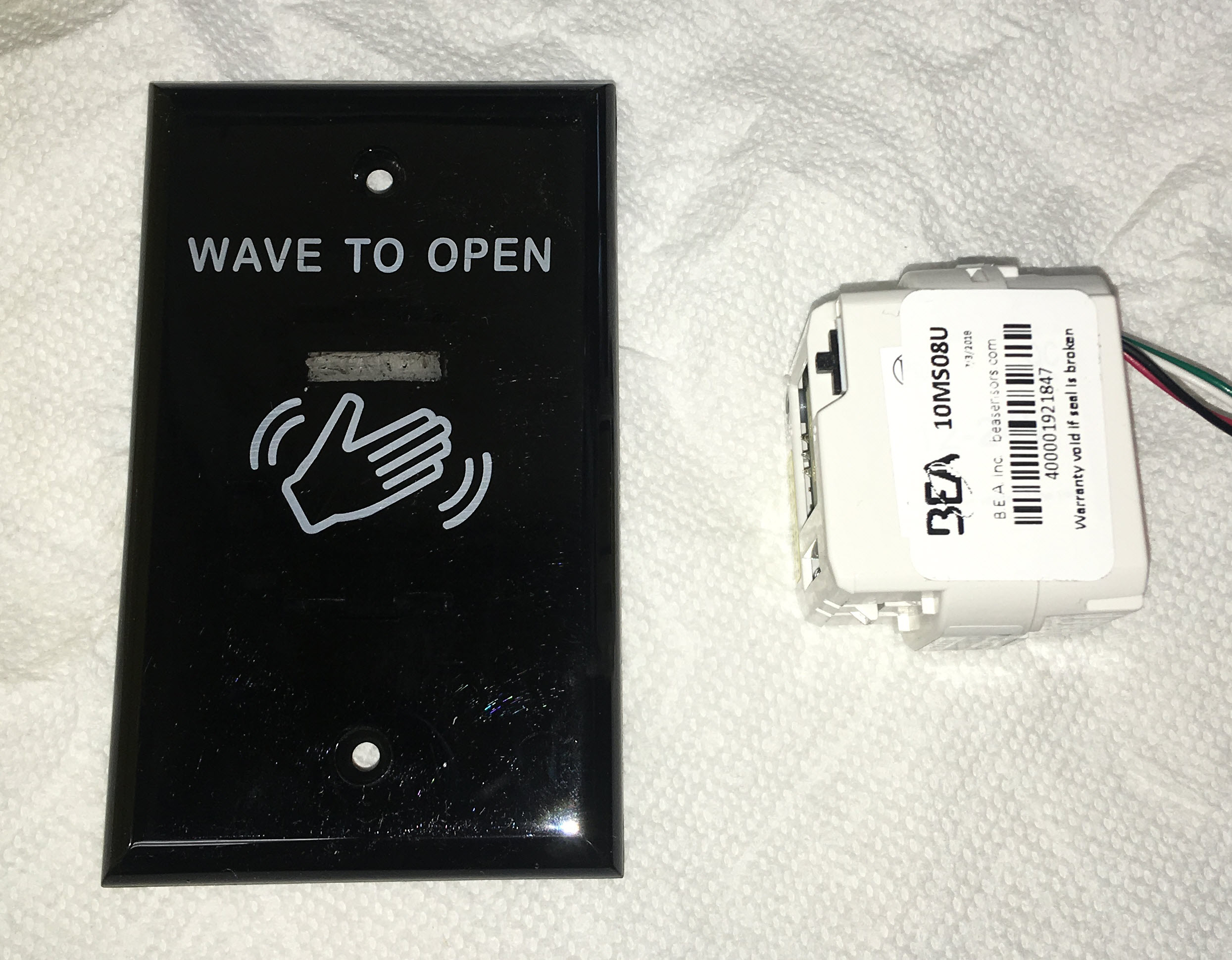

The BEA MS08U is a presense-detecting sensor that uses microwave technology to sense an object in its field of view. It's range is adjustable between 4-24". It's typically used to trigger a door operator (automatic door).
A problem I've run into is that people will be in the habit of slapping the shit out of a physical switch, and even though this switch clearly states, "Wave to Open", some people will still beat on it out of habit.

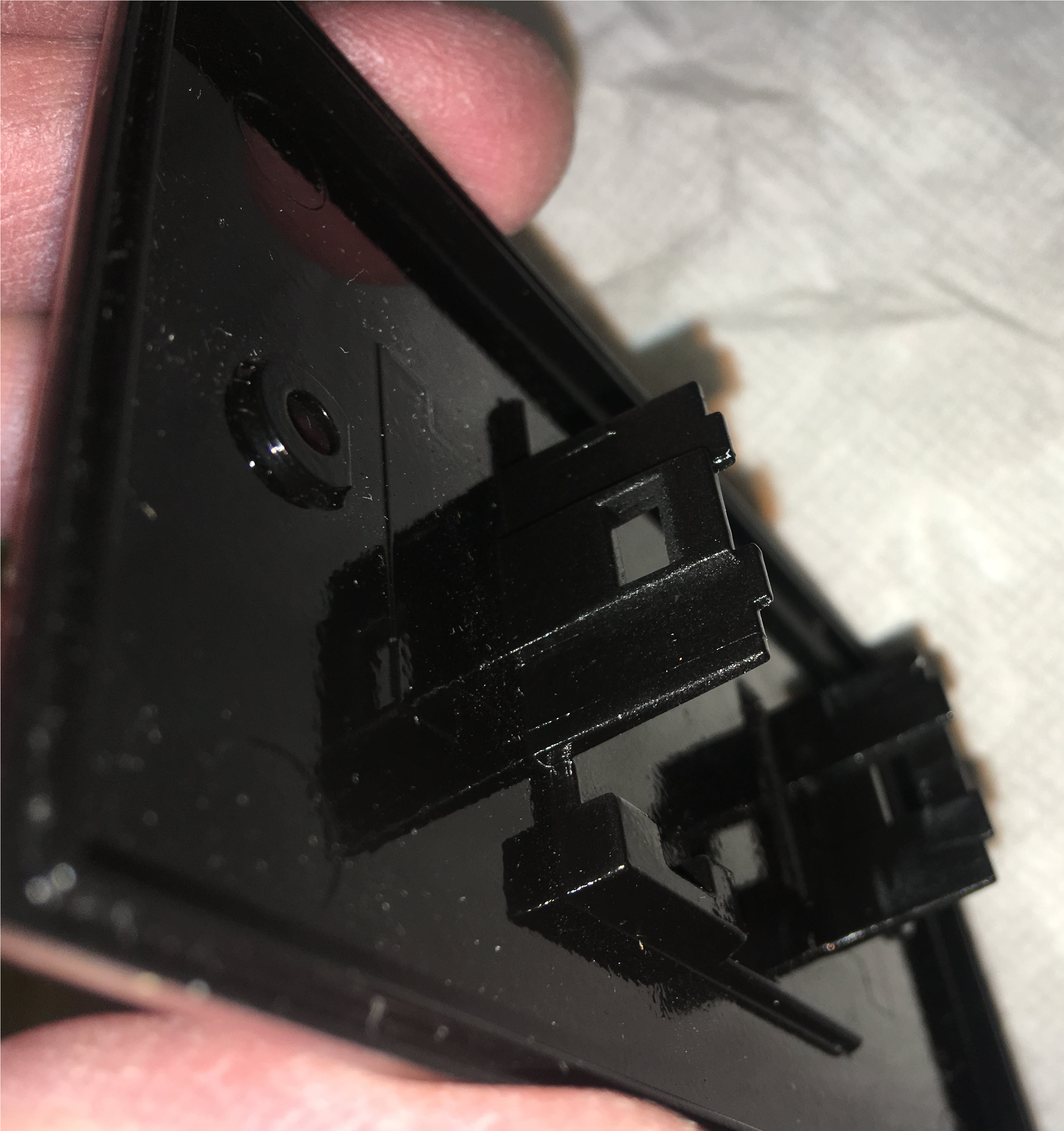

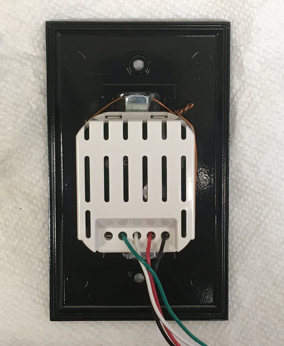

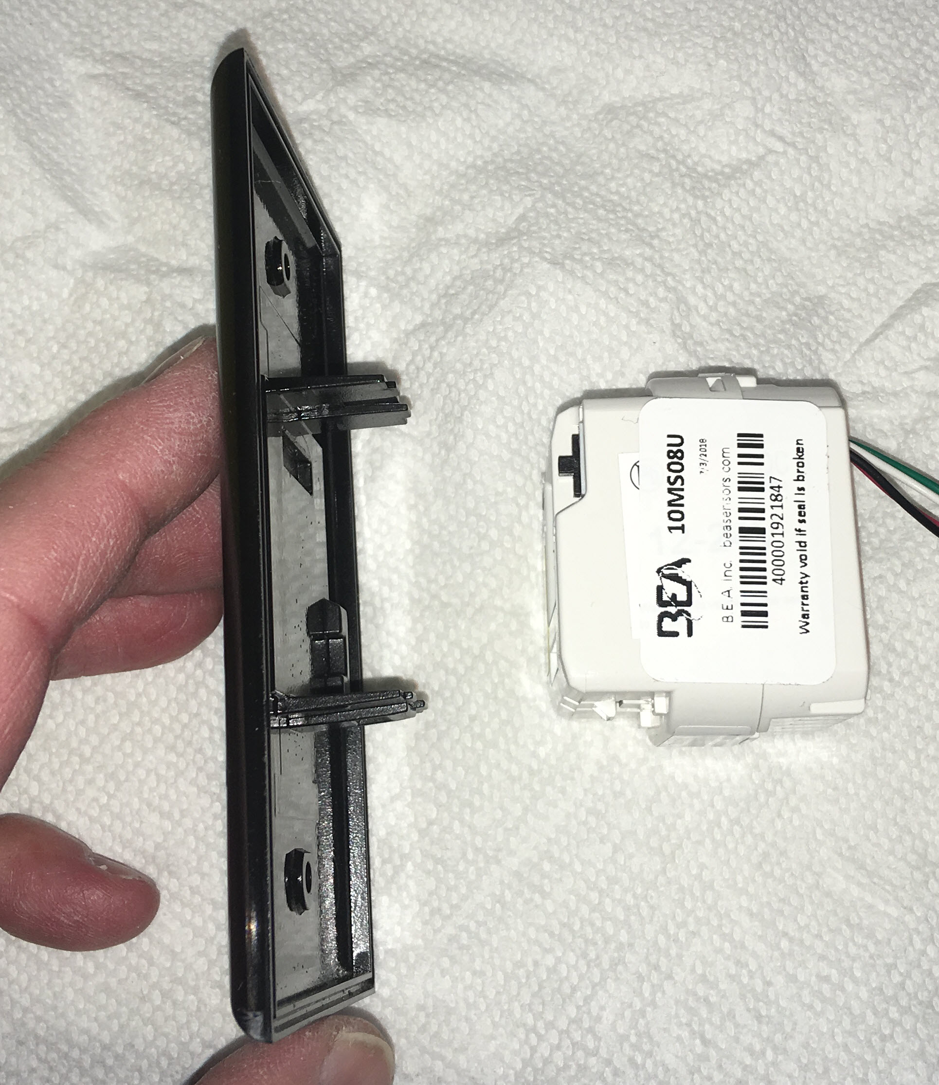

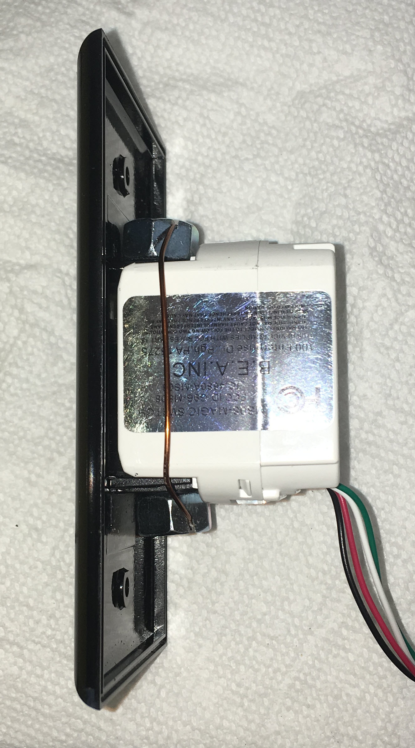

The wall plate is plastic. The sensor clips into it. If you flex the wall plate, the sensor can become unclipped. I've been fielding a lot of service calls for the sensor sitting in the wall box instead of clipped to the wall plate. I tried the fix below on three of them today; time will tell if it is effective.
BEA MS08U "Magic Switch": sensor won't stay clipped in

- Assembled view.
- BEA_MS08U_11b.jpg (189.57 KiB) Viewed 72895 times

That seems like it should work. Even if the wall plate flexes, the wire still holds tension on the snap brackets against the sensor body.

A quick fix that does the same thing without any prep is to use the 2 nuts and a zip tie thru the nuts, but your way will likely be more solid.

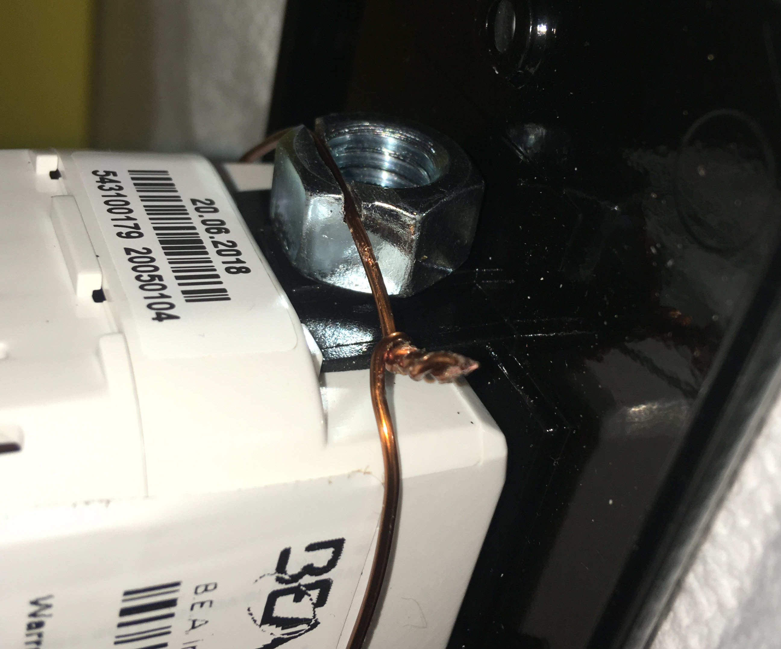

Caxambu: yes, I'm hoping that when folks smack the front of the wall plate, even though the center of the wall plate flexes in, and the tension on the molded-in tabs holding the sensor module clipped in is diminished, the copper wire wrap will retain the sensor module.
In the past, I just used the copper wire, but it didn't work because there was no tension on the black molded clip arms; they weren't getting any tension from wire, since the clips are narrower than the sensor module. That's what the 3/8" nuts are for: to get the tension to the back of the clips.

Wayne: nope, the sensor is wide enough that the added width of even small nylon wire ties will prevent it from installing in the wall box. Same problem if I turned the nuts sideways: too tall, won't clear the metal sides of the wall box.
Commercial wall boxes are metal and have folded-over aperture design, so the opening is smaller than, say, a metal rework box or a residential plastic box.

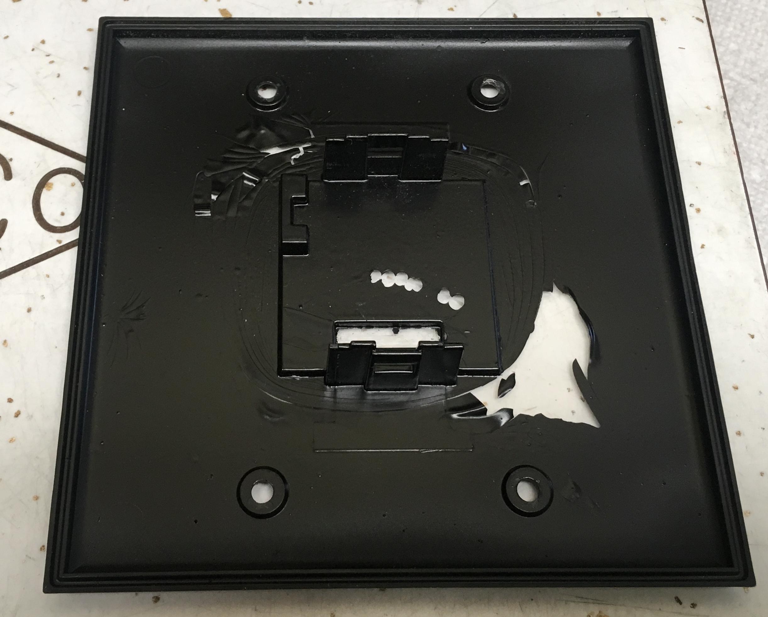

I had another one today, same problem: they hit the face plate hard enough to flex the paint off the back. The clear plastic is painted on the inside, and the paint is not as flexible as the plastic.
Despite the appearance, the plastic is not cracked, only the paint.
I used the same method to repair, though I replaced this wall plate with a spare. And I cut the slots in the nuts wider (two passes with the bandsaw), so the wire isn't as tight to fit in the slots.
The pics I took above were very helpful in reminding me what I'd done the last time. As you get older, notes to self become more important.
