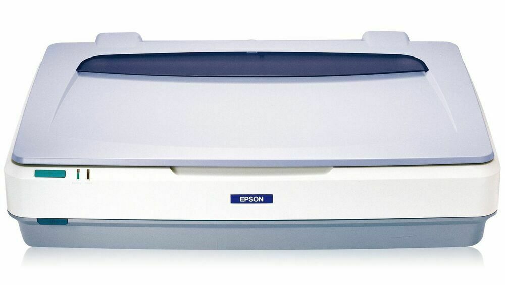

My old Mustek Paragon 1200 A3 Pro (11"x17") scanners have died of old age. I've scanned probably thousands of pages on the first one, only a hundred or so on the second. I got the first one free from a business that didn't like the four-minute fluorescent lamp warm-up time, and it was a real workhorse for me. The combination of age and SCSI finally prompted me to buy a replacement.

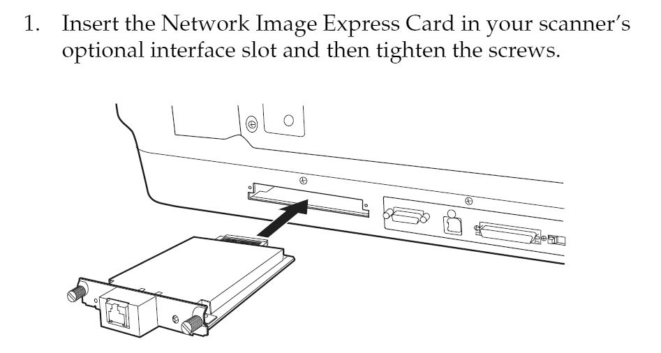

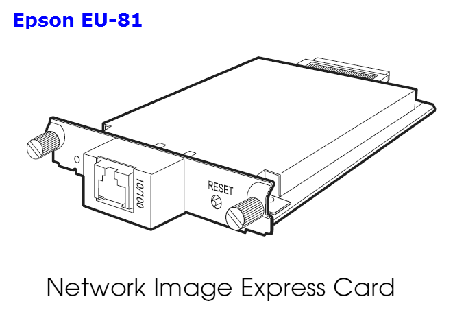

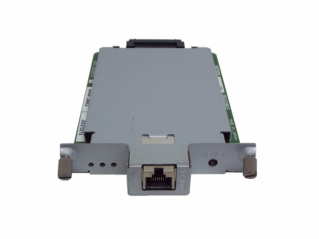

I chose a 2003-era Epson GT-15000 ($393 shipped) (substantially the same as the GT-20000), which has both SCSI and USB interfaces built-in, and I found a rare (or, merely expensive: $129 shipped) optional ethernet adapter, EU-81 (aka B12B808393 or B808393), so it can be easily shared amongst all our networked computers here.

One pleasant surprise was that the EU-81 adapter was already configured to use DHCP, and when powered-on its built-in configuration webserver let me view the current settings and firmware level. I only had to use my router's "who's connected" page to figure out the GT-15000's DHCP IP via the MAC on the EU-81.
Unfortunately, I didn't know the password for the EU-81. While its webserver will happily show me settings without credentials, it won't let me change them. So, I had to push the Reset to Factory Defaults button on the EU-81 (hold the Reset button, power on unit, hold button for a further ten seconds then release). That's where the real trouble began.

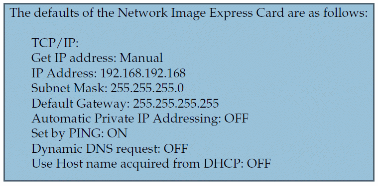

Epson's Factory Defaults for the EU-81:
EU-81 Factory Defaults table
192.168.192.168 isn't exactly an easy subnet to access.
arp worked to "reset"* the IP:

*(arp -- the Address Resolution Protocol -- doesn't really reset the IP; it updates the computer's internal table of IP<->MAC addresses so an IP address, which is 32-bits, can be used to address (talk to) the device via it's 48-bit MAC address on a LAN. IOW, arp changes the computer, not the scanner's NIC.
Now I could again access the EU-81's internal webserver, and theoretically and set my own password (and change settings). In practice, the default username isn't documented and the web UI won't allow password change without username. I was able to use EpsonNet Config 4.9.5 to reset password (leaving username blank); see next paragraph.

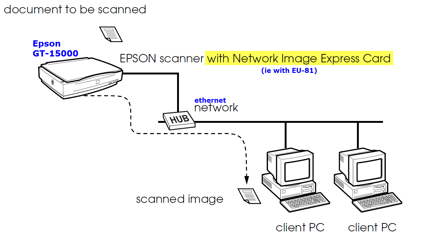

When you Google "SANE network scanner", you're invariably pointed to installations where a scanner is connected to a remote computer (via USB, SCSI, FireWire, or parallel port), and a SANE daemon (saned) runs on that remote box, making that scanner available to a SANE client running on your computer.
However, that's not how a network-attached scanner works, and it can be hard to tease out the steps to make that work.

Then, edit /etc/sane.d/epkowa.conf (config file for epkowa backend) and insert the GT-15000's IP address. Add:
Code: Select all
net [IP address] [port]
to the file. In my case:
Code: Select all
net 192.168.0.14
The default port is 1865 and I didn't need to specify it; it's optional.
