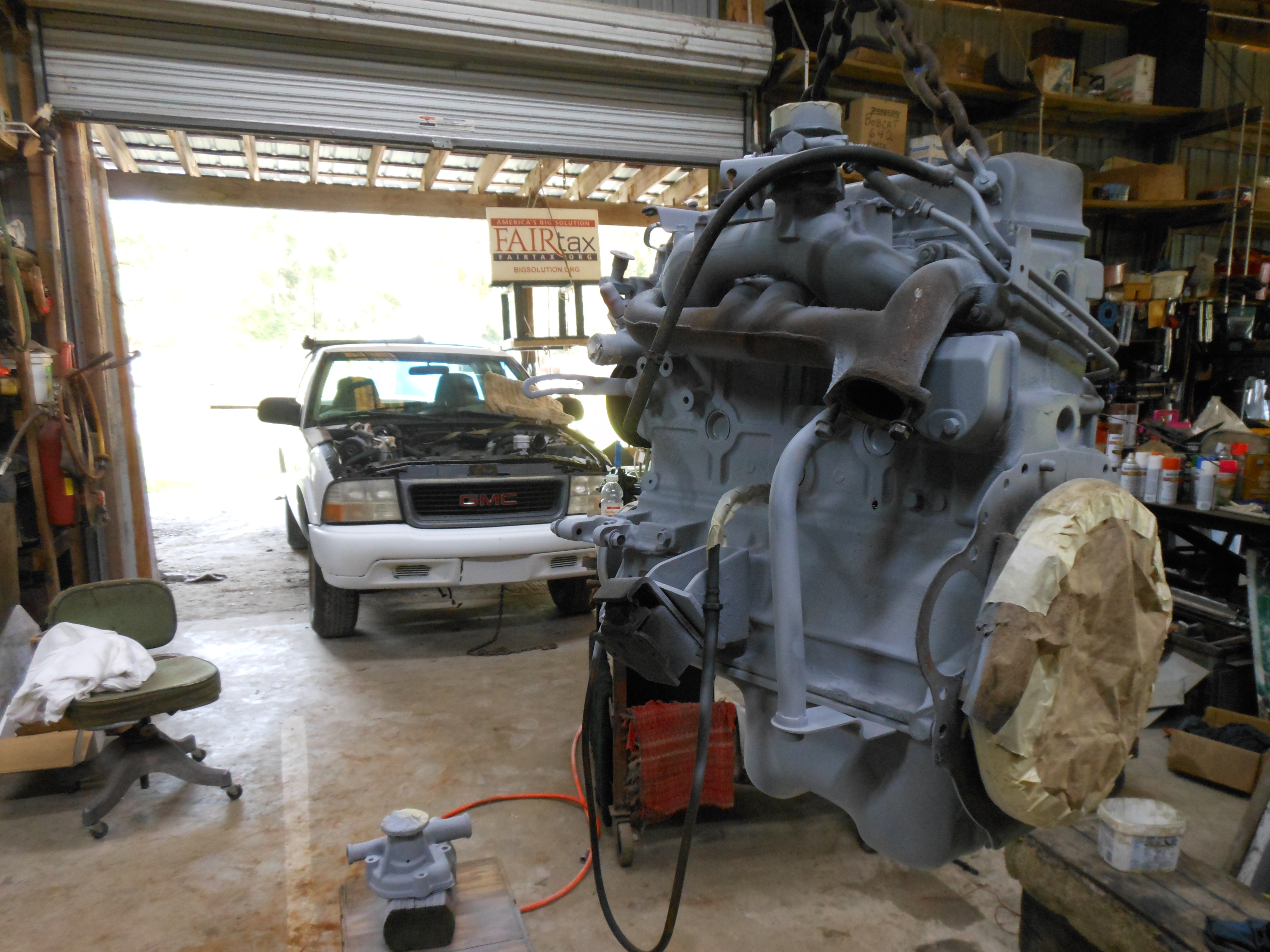

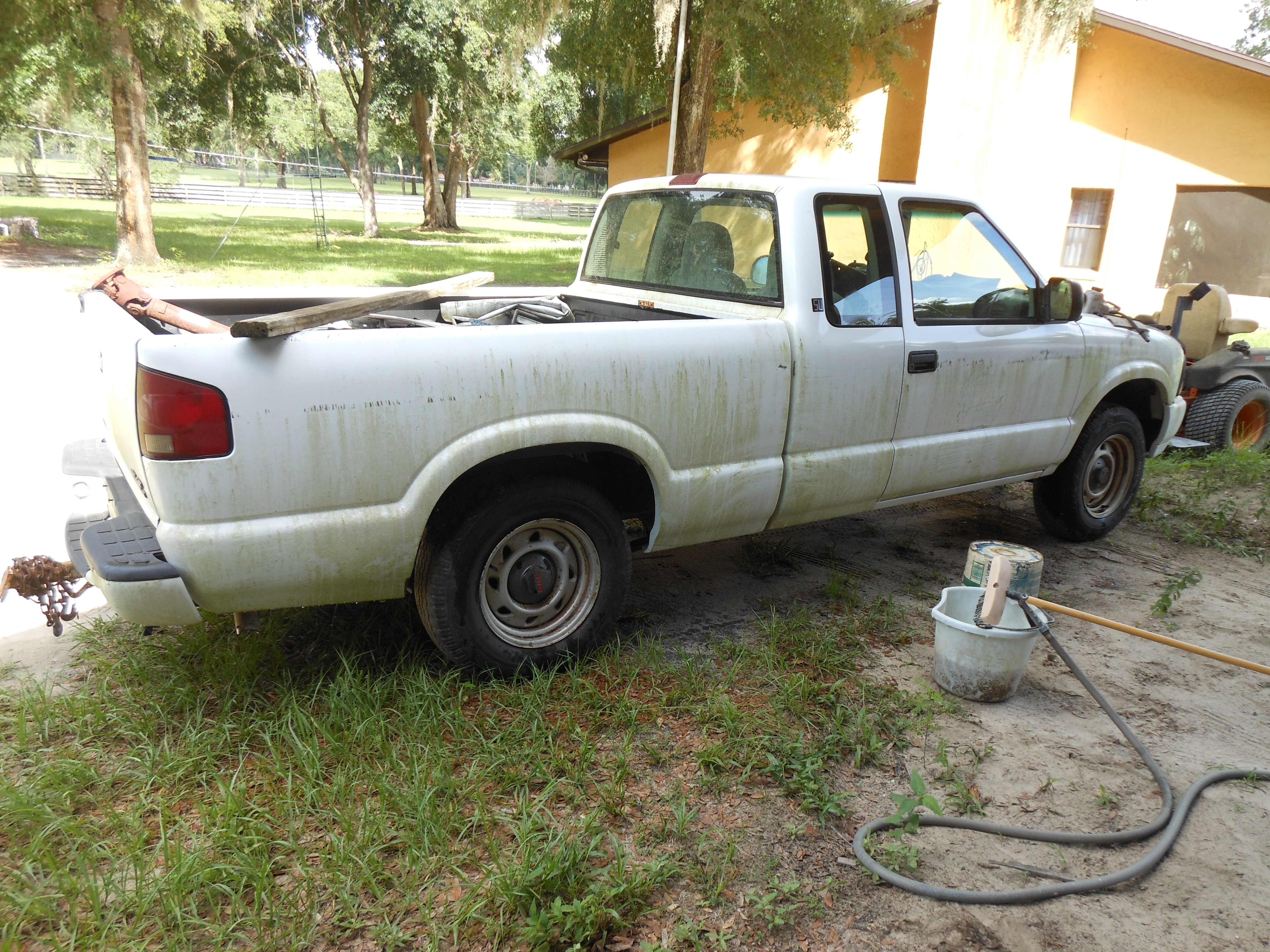

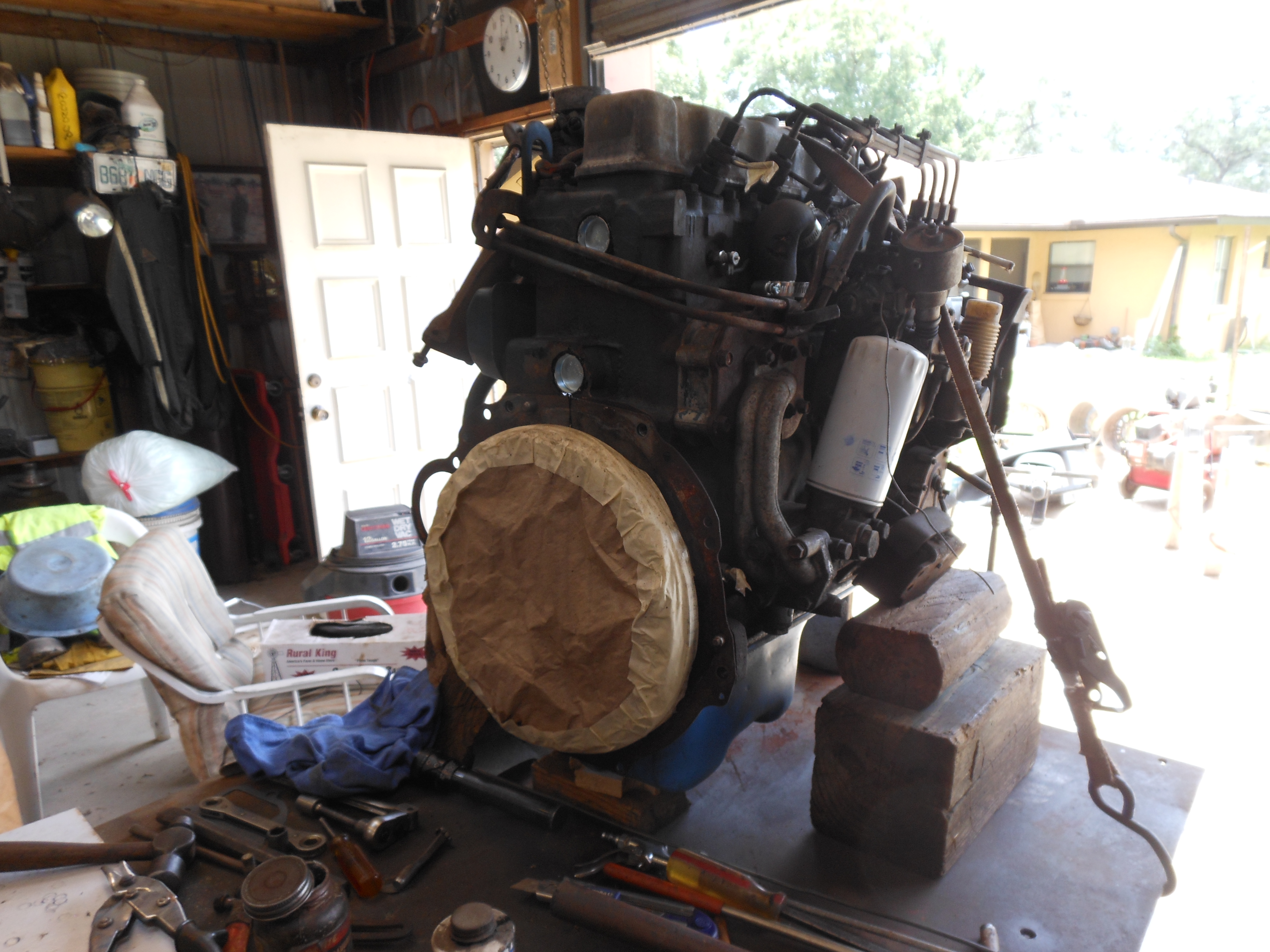

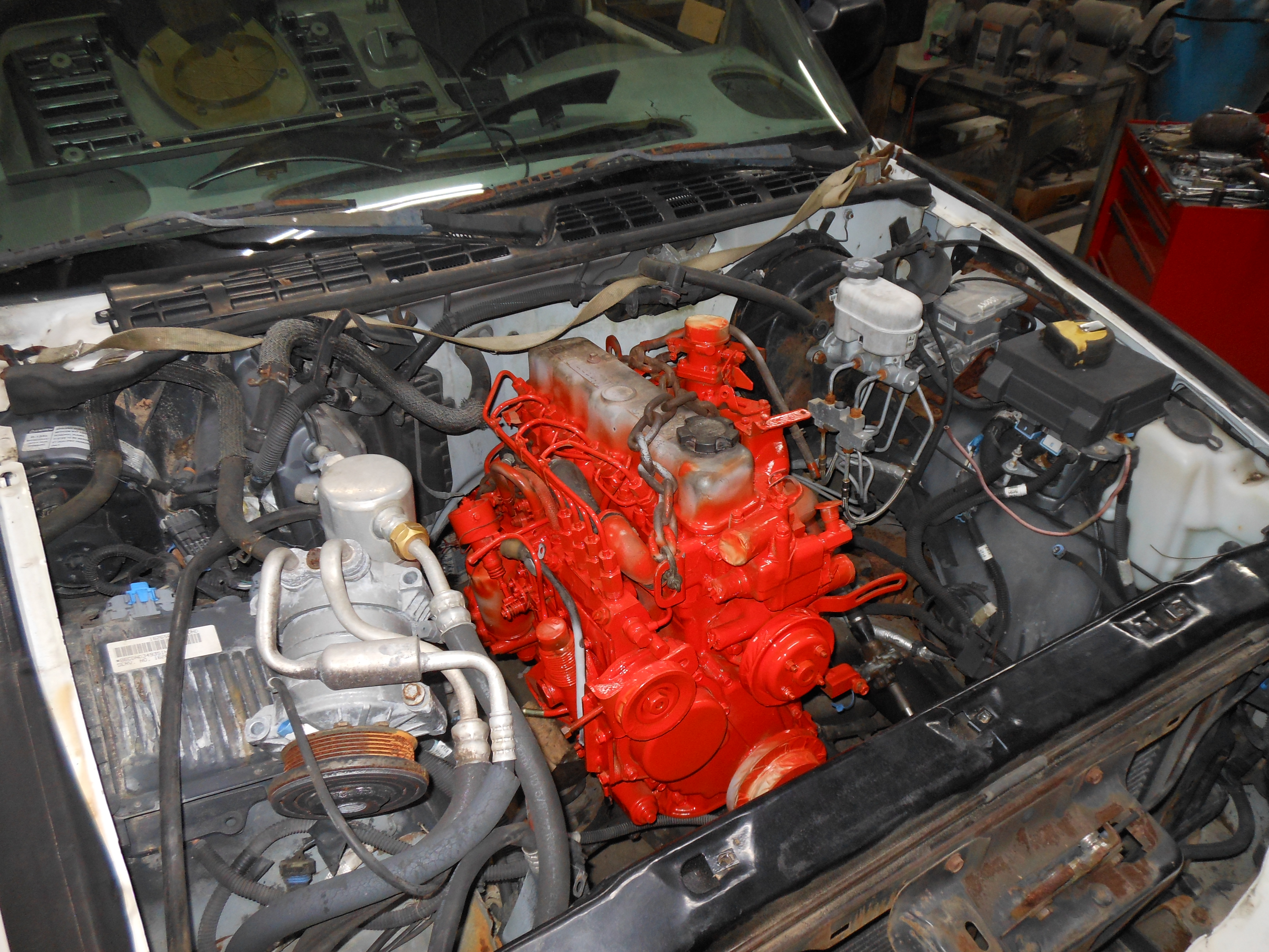

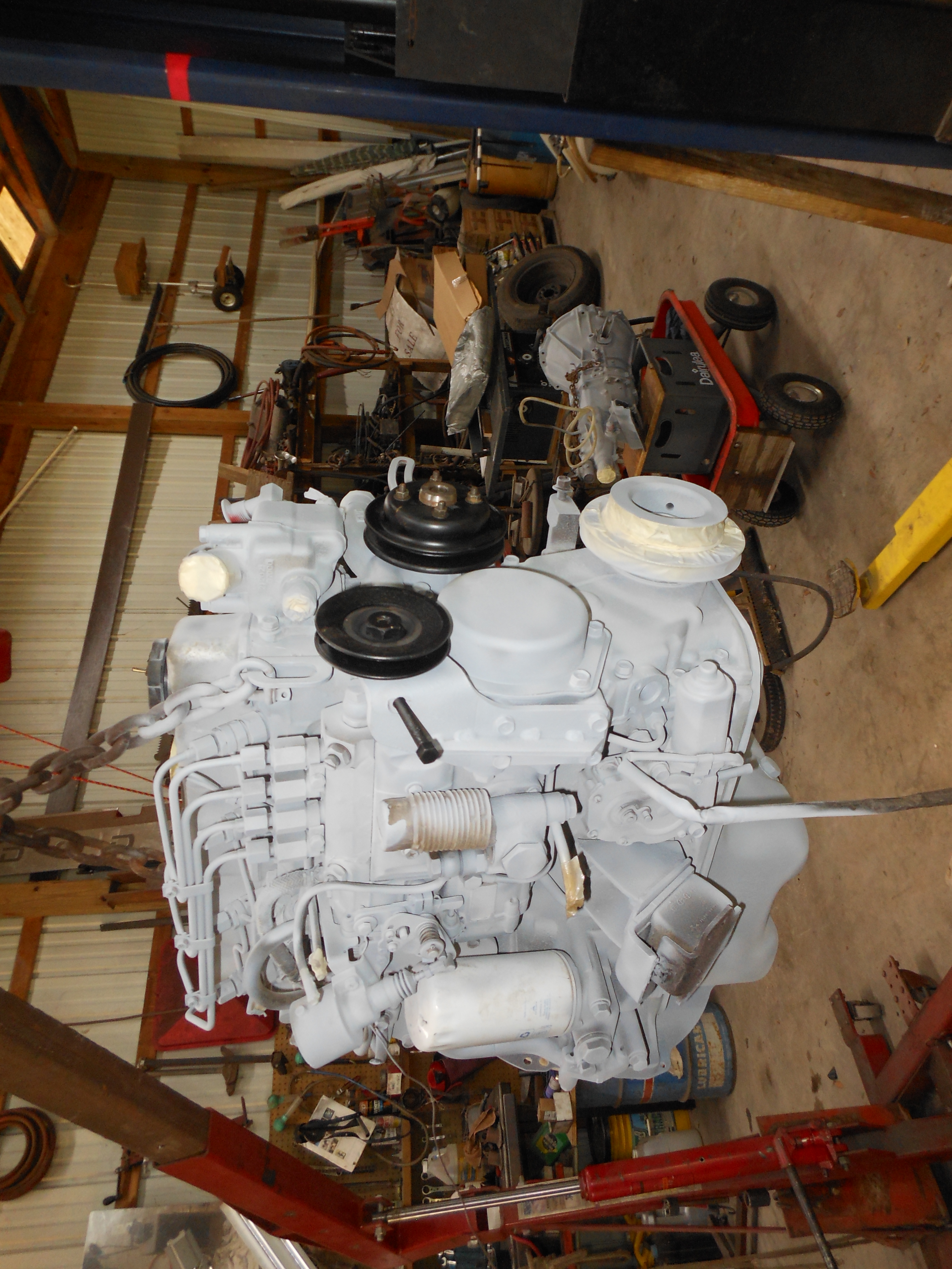

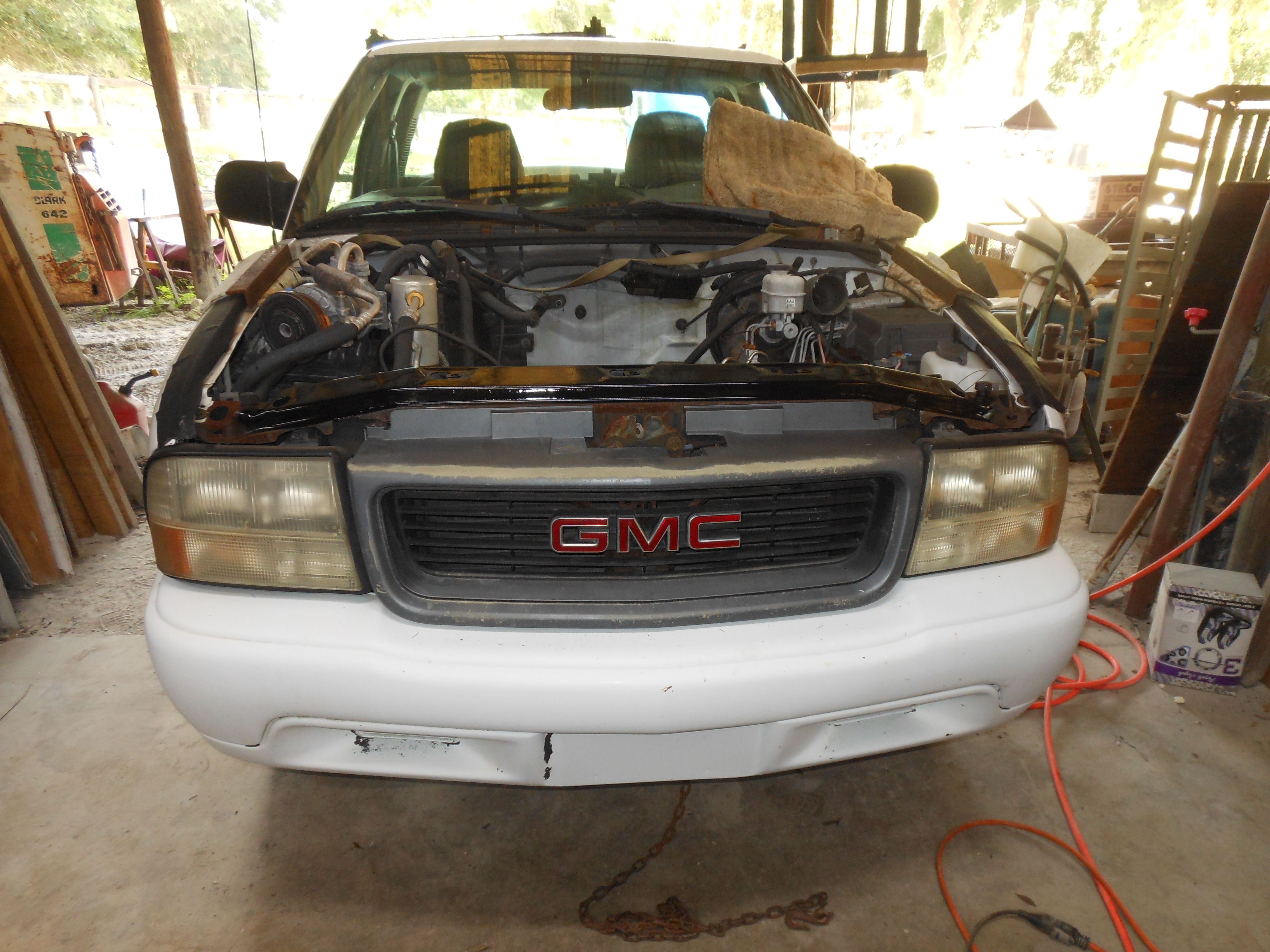

OK Mr. Scrapman,
Here are some pics....I hope..
The Pictures ended up out of alignment being the last pic was the first entered ? ? ? The first one is removing all the green stuff to show some white paint...The rest are cleaning up the engine and transmission in prep for some brighter paint....There will soon be some pics of the engine mock up sitting in the frame.
- 2000 Sonoma...Nissan SD 22 transplant 010.JPG (3.47 MiB) Viewed 96706 times
- 2000 Sonoma...Nissan SD 22 transplant 009.JPG (3.44 MiB) Viewed 96706 times
- 2000 Sonoma...Nissan SD 22 transplant 008.JPG (3.32 MiB) Viewed 96706 times
- 2000 Sonoma...Nissan SD 22 transplant 007.JPG (3.35 MiB) Viewed 96706 times
- 2000 Sonoma...Nissan SD 22 transplant 006.JPG (3.41 MiB) Viewed 96706 times
- 2000 Sonoma...Nissan SD 22 transplant 005.JPG (3.32 MiB) Viewed 96706 times
- 2000 Sonoma...Nissan SD 22 transplant 001.JPG (3.38 MiB) Viewed 96706 times

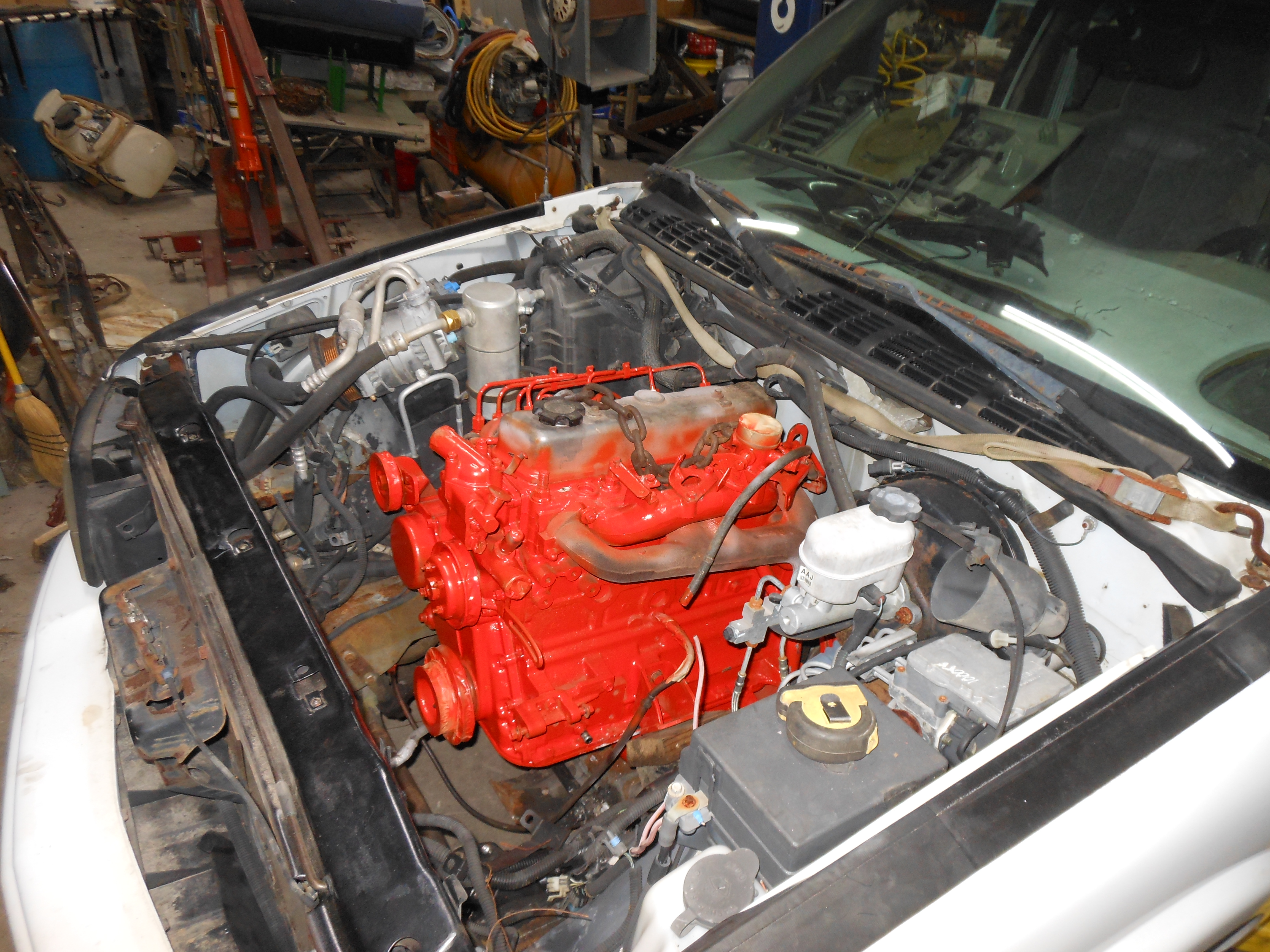

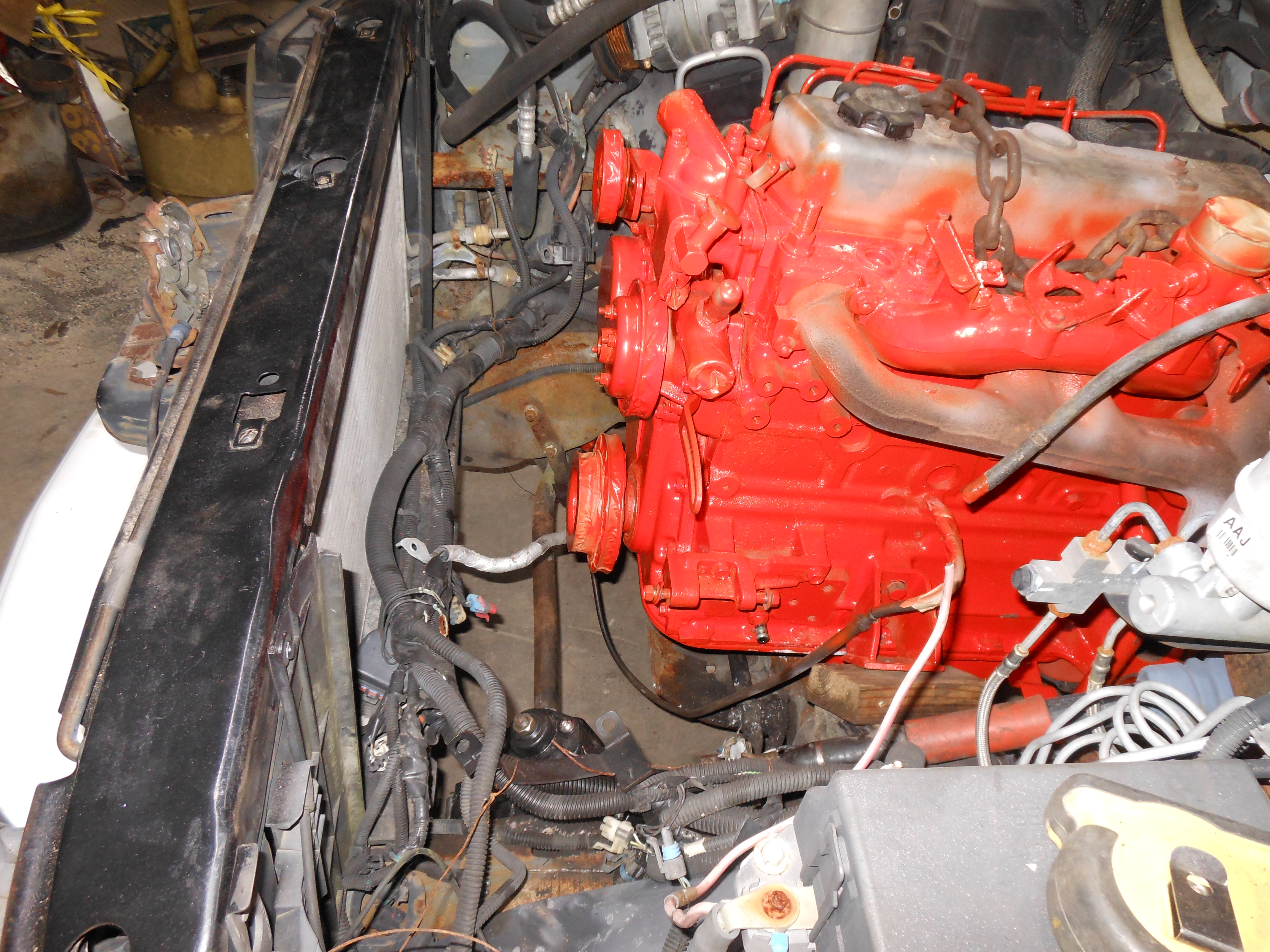

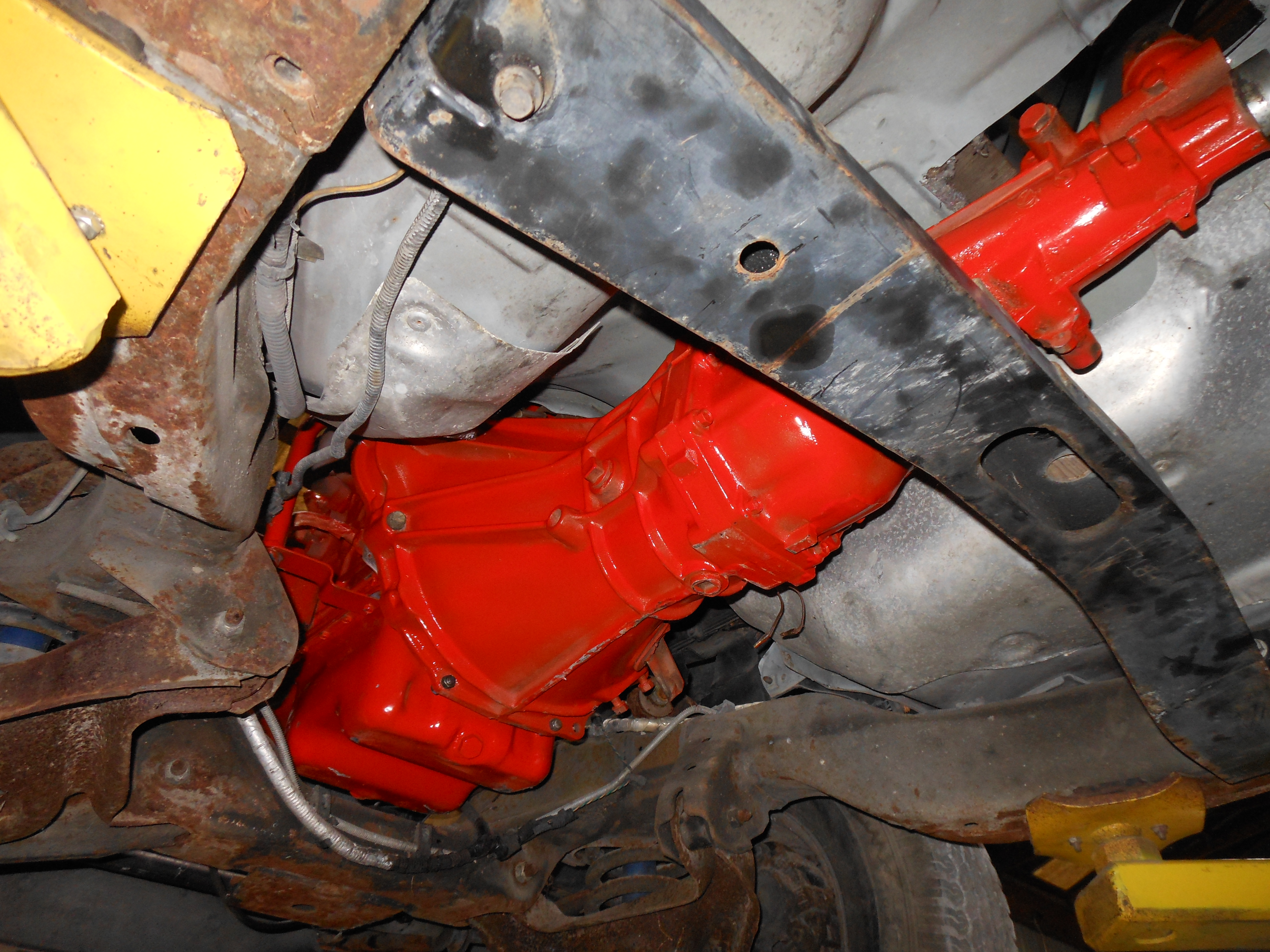

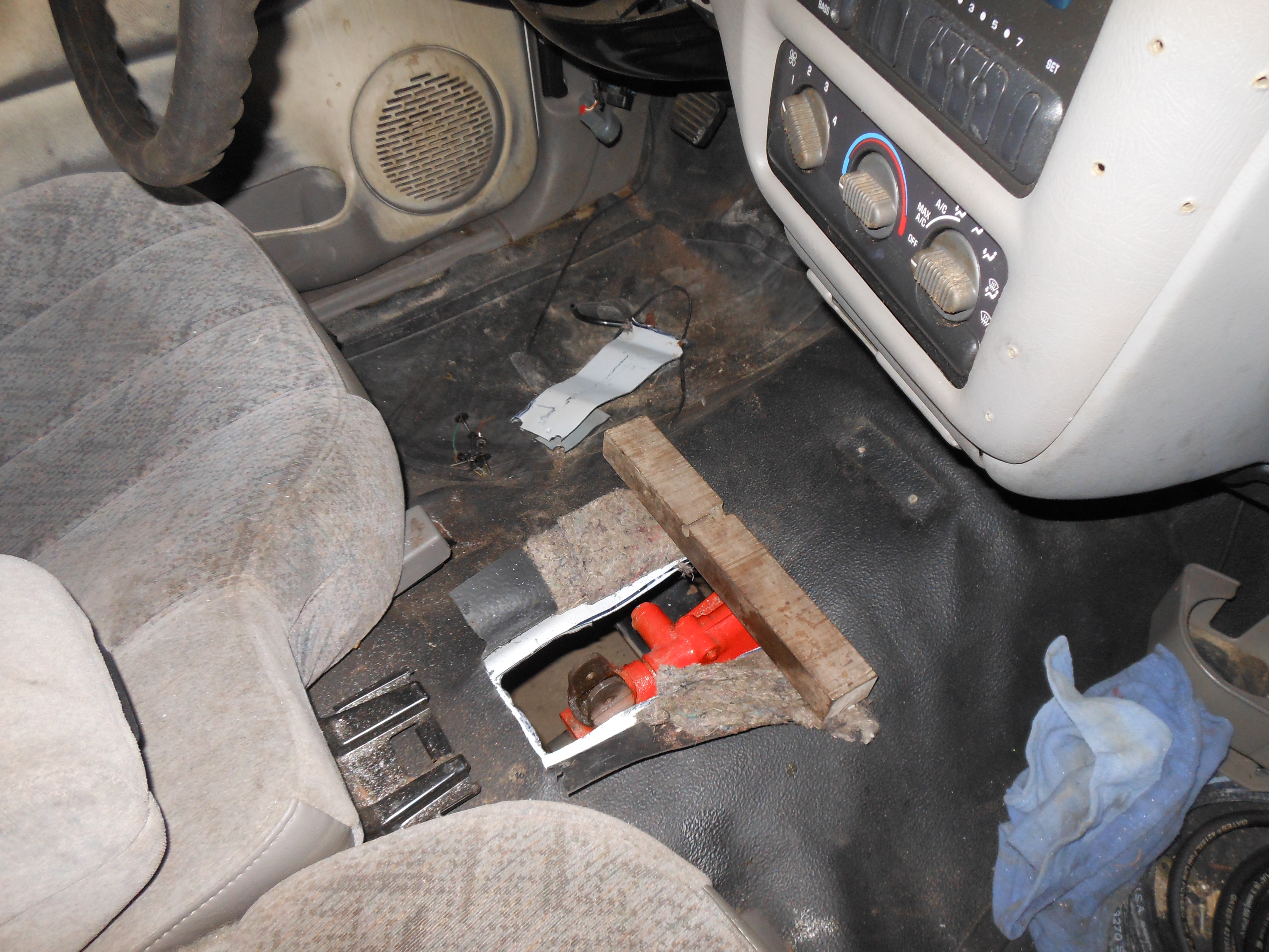

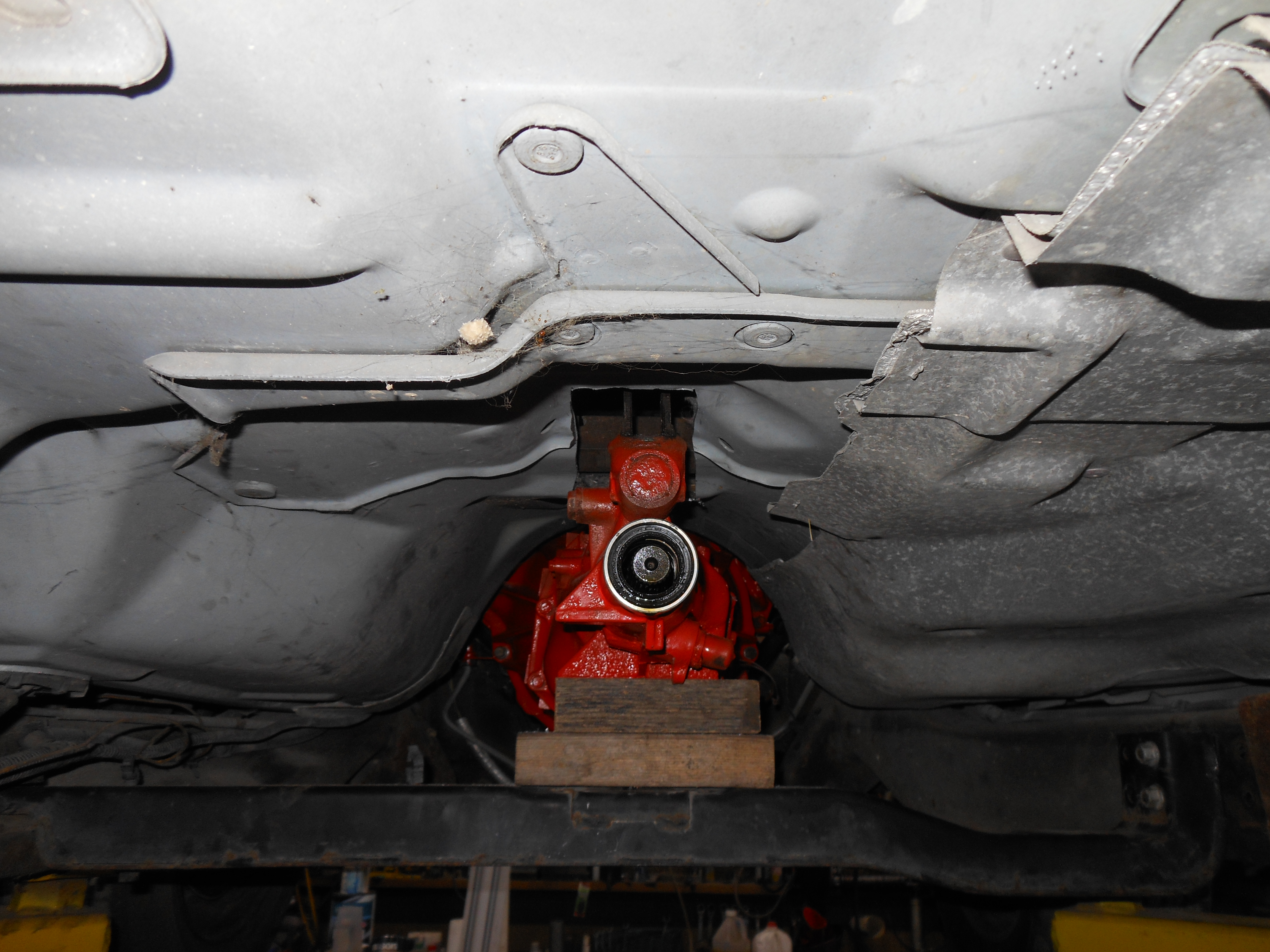

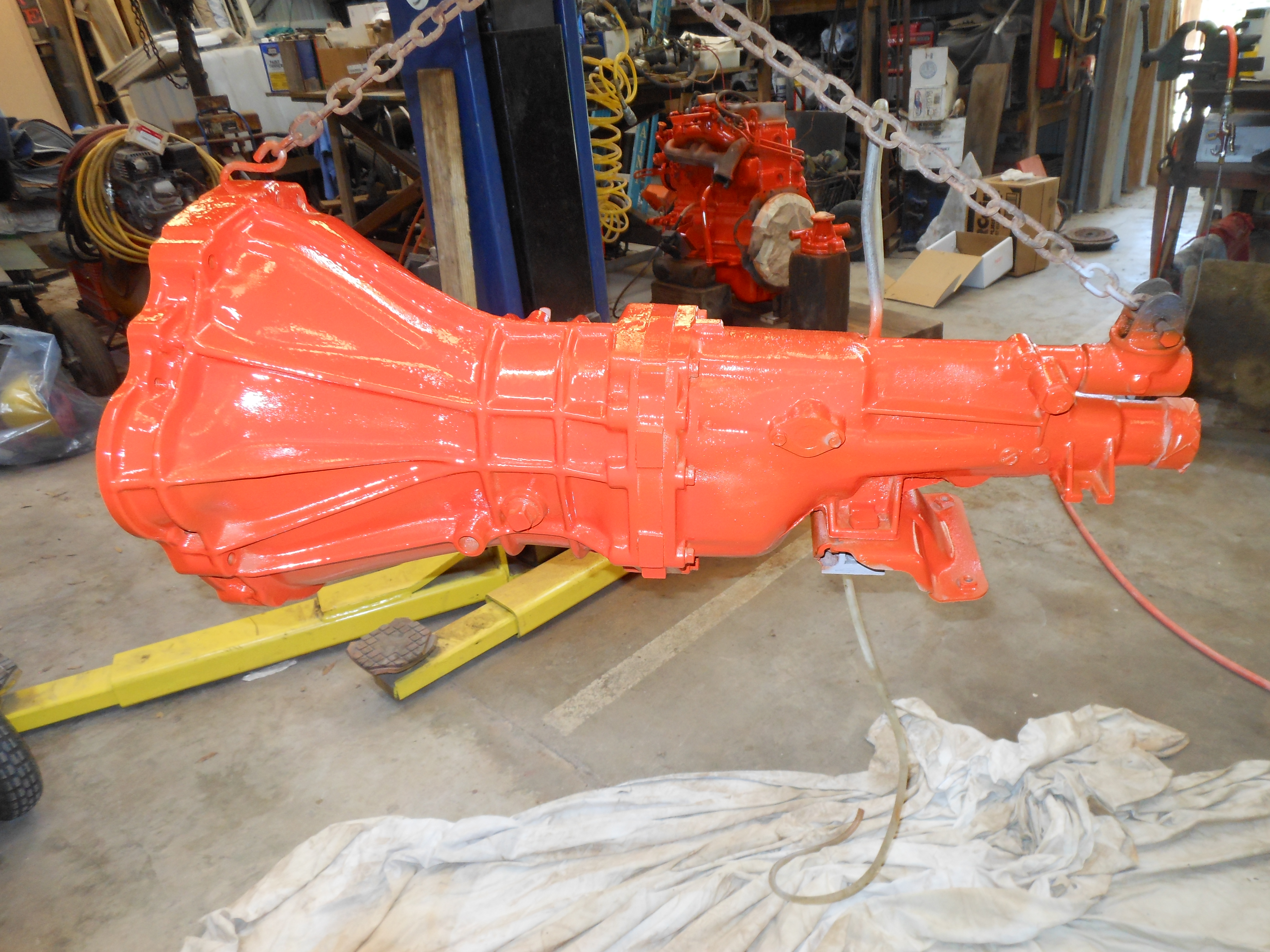

Well, from what I can see my idea of putting an SD22 into a Sonoma has no interest even with some starter pics.......Here are some additional pics....
- 2000 Sonoma....Nissan SD 22 transplant 007.JPG (3.42 MiB) Viewed 96634 times
- And the transmission
- 2000 Sonoma....Nissan SD 22 transplant 006.JPG (3.35 MiB) Viewed 96634 times
- Floor opening for the 5 speed stick transmission
- 2000 Sonoma....Nissan SD 22 transplant 004.JPG (3.47 MiB) Viewed 96634 times
- 2000 Sonoma....Nissan SD 22 transplant 003.JPG (3.39 MiB) Viewed 96634 times
- Mocking up the engine and motor mounts
- 2000 Sonoma....Nissan SD 22 transplant 002.JPG (3.4 MiB) Viewed 96634 times

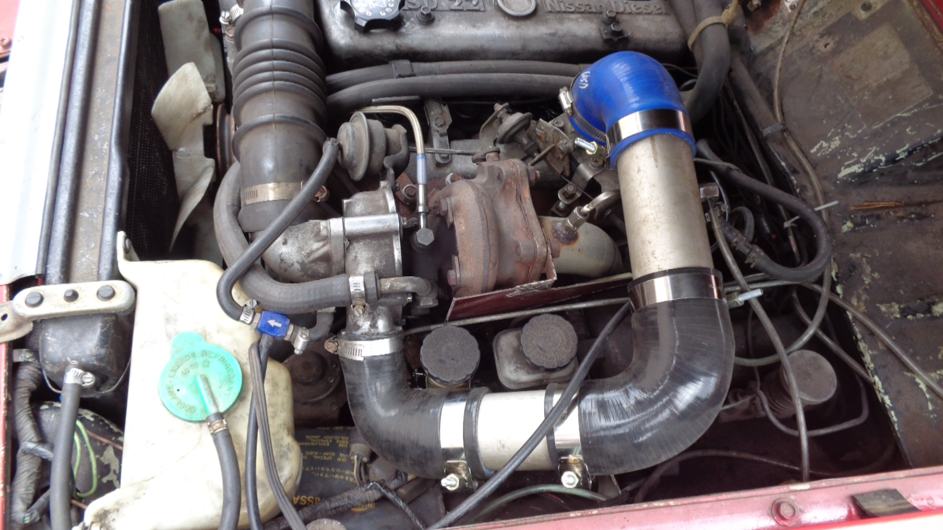

Here is the thread your looking for.
http://nissandiesel.dyndns.org/viewtopi ... 75500#3659

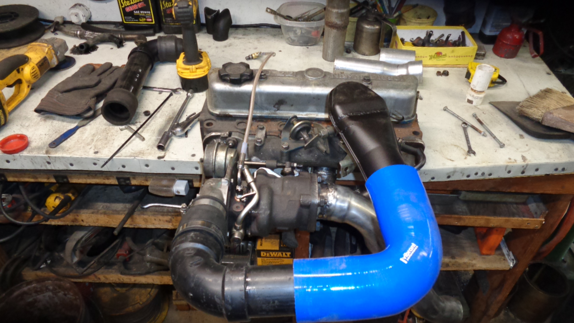

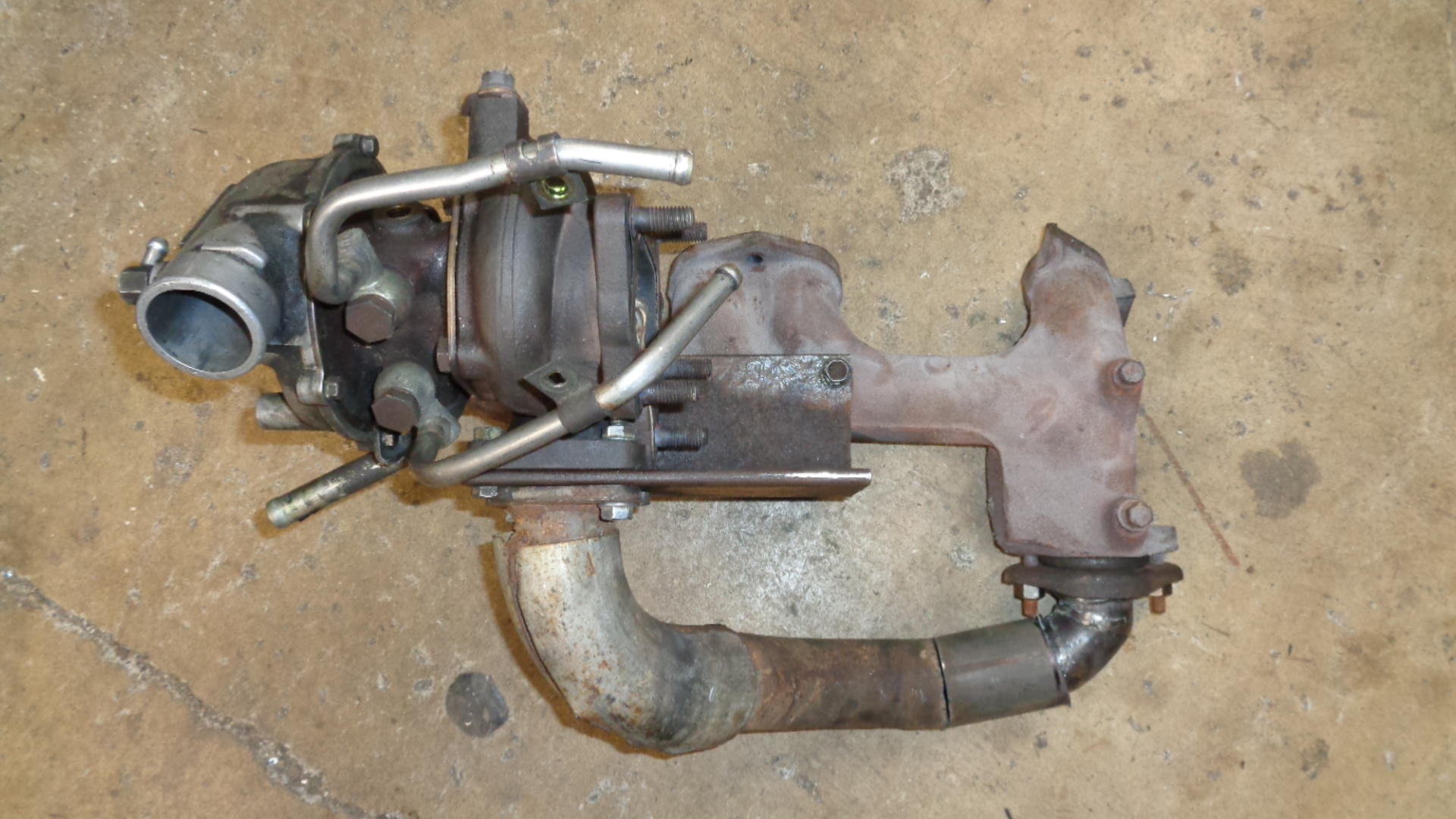

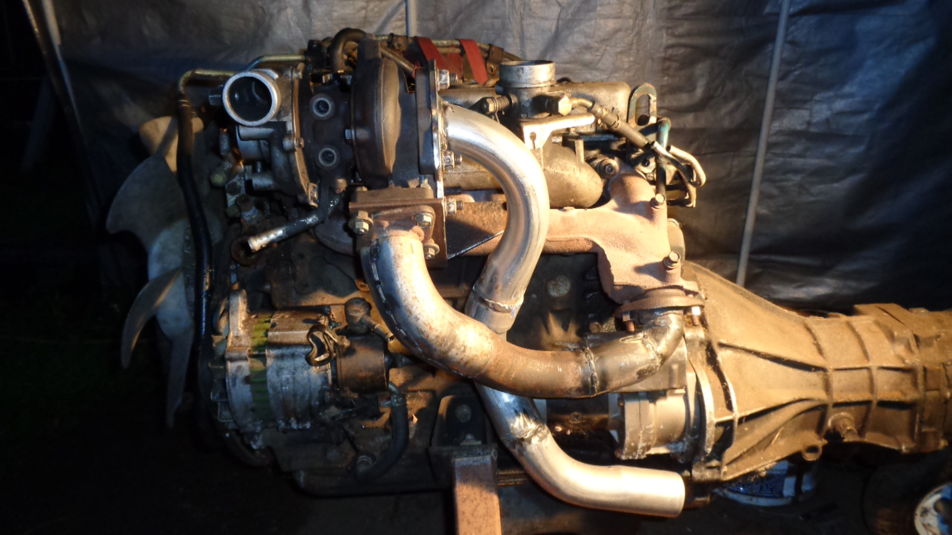

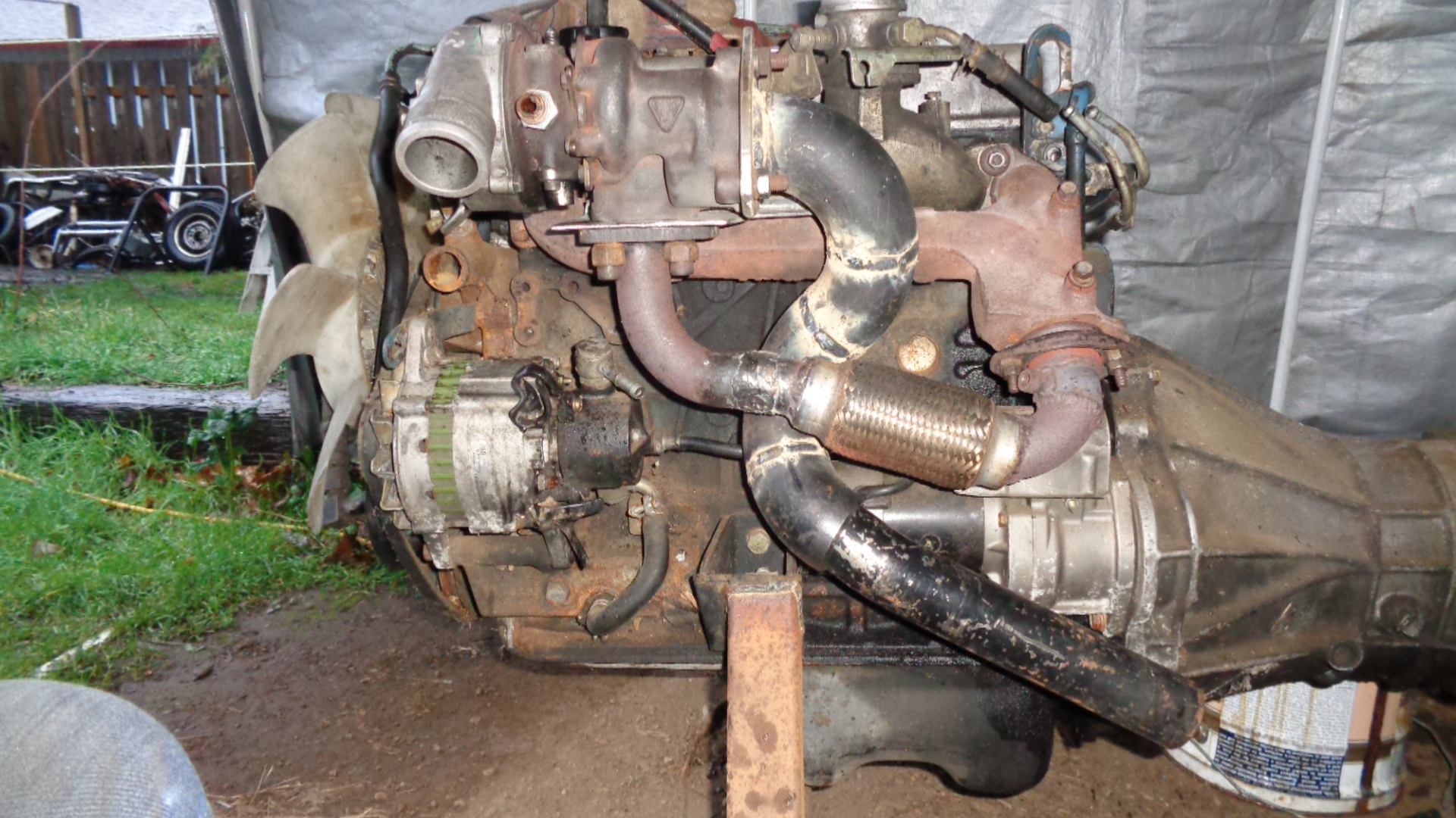

You are planning to turbocharge your engine, there are a lot of ways to accomplish that, I have done it a few different ways but the easiest is to make a "U" pipe coming off the stock exhaust outlet and pipe it to the turbocharger located right over the alternator. I recently helped my friend turbocharge his SD22 diesel engine in his 720, I was not impressed, it didn't seem to have much more power than before but he says it doesn't lose speed on the hills like it used to.
I would not have been happy with it but I am spoiled, my Datsun 521 kingcab SD25 turbodiesel is awesome, it's my favorite vehicle to drive.
Here is another one I made, same idea, I put all these setups in my 720 to see if they worked properly with a 2001 VW Passat turbocharger, they worked fine with a lot of power, but they were not like my 521.
- image.png (2.89 MiB) Viewed 96621 times
Re: SD22 5 speed into a 2000 Sonoma SLS

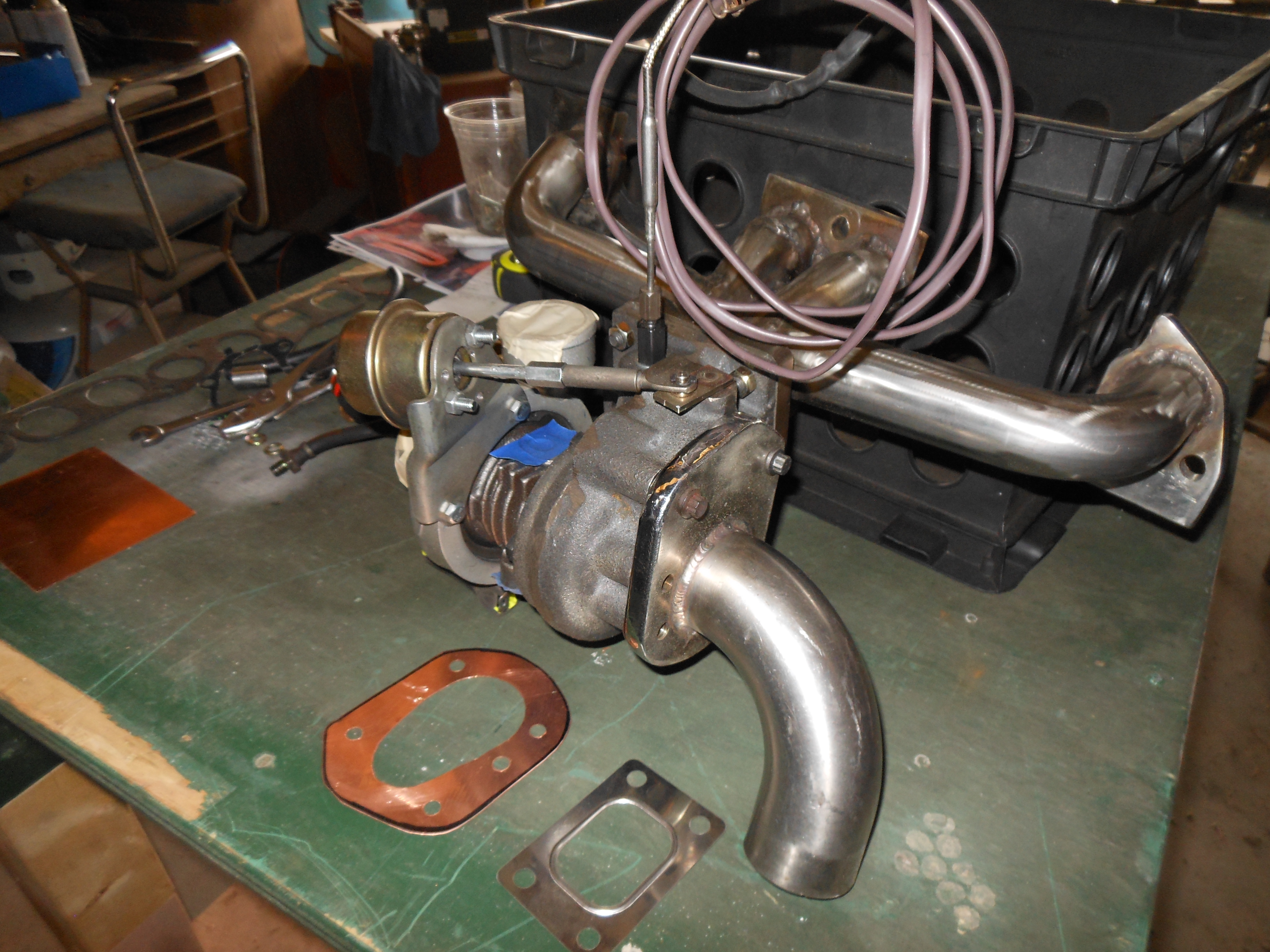

Here are some more photos, I am posting them to give you ideas.
This is the log manifold I made for my friend
My friends truck

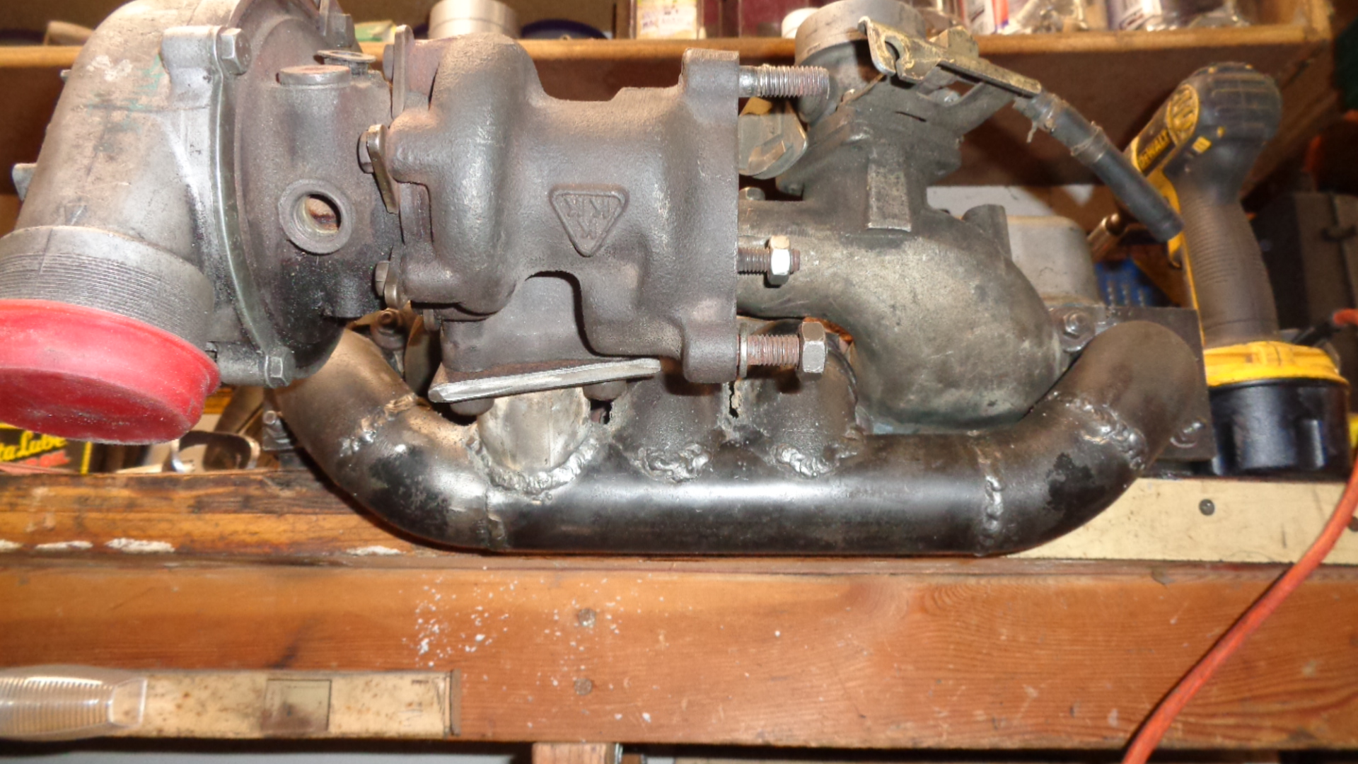

Thank you Sir for the pics. I wish I would have seen them before I built my stainless steel manifold. Yes, I like the stainless but it came at a cost of more than I would like to admit. Did you use an after cooler? I am going to try to plumb one in to my system. I don't know which type of air cleaner I will use but it may be one of the cone types that I can clean and re oil. I even thought of using an old oil bath ? ? ? I will post some pics of the manifold and turbo as soon as I get my camera battery charged up. Is that PVC pipe that you used on the intake ? Thanks again

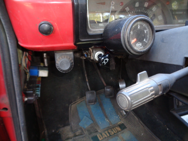

I have tachometers for both my SD25 diesel engines, I used the ISSPRO diesel tachometer(0-4000rpms) on my 521 kingcab turbodiesel, it came with the gauge, wiring, sensor, and magnets that I glued to the front crank pulley with the glue supplied, I searched on ebay for "diesel tachometer ISSPRO" and came up with 4 results but none of them appeared to come complete with everything, the place I bought mine is ISSPRO Inc which is near me in Portland OR, mine was a black gauge face, white markings, orange needle.
I like this ISSPRO gauge the best as it has never failed me.
My 1980 Datsun 720 turbodiesel has a "Tinytach", the first one I bought worked great(sold that truck), it acted normally in all functions, speeding up/slowing down/idle, my second Tinytach did not work properly which is very annoying, when I let off the pedal it goes to total hours rather than dropping in RPMs, when I give it pedal it comes right back and works again, I contacted them about the issue and they sent me another pickup sensor and it didn't fix the issue, I sent another message and they never responded again, I will never buy another one as they didn't fix the issue.

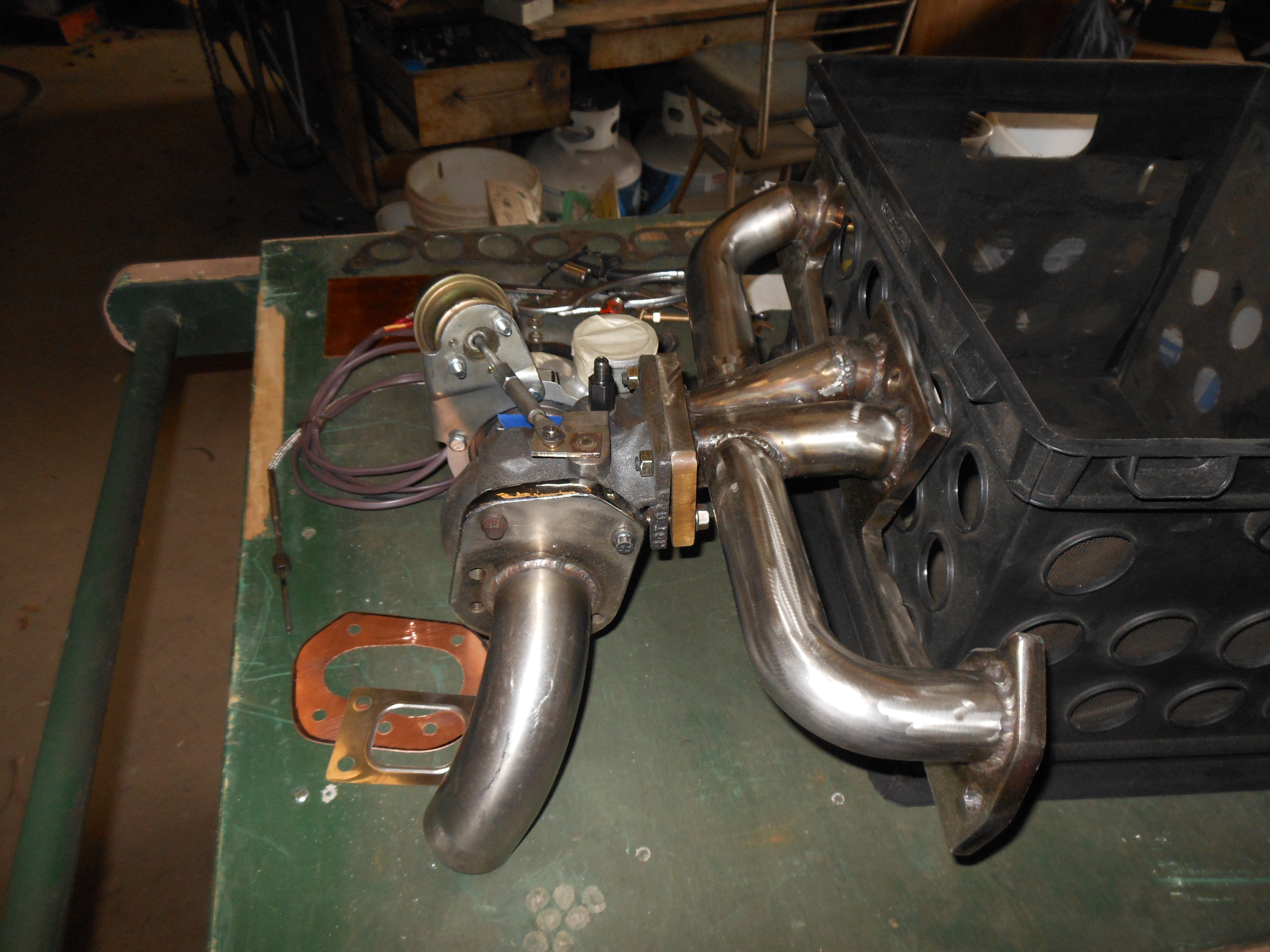

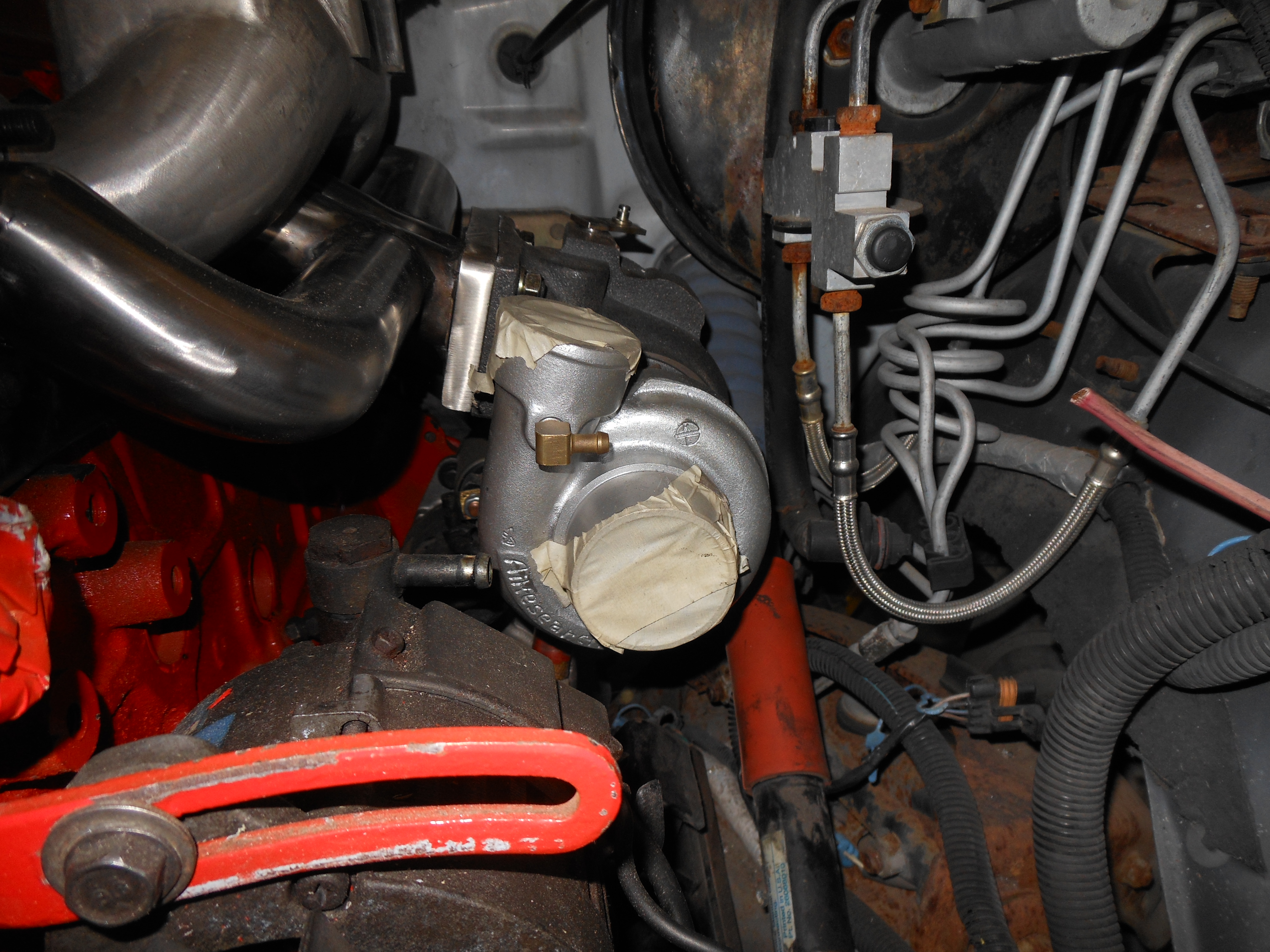

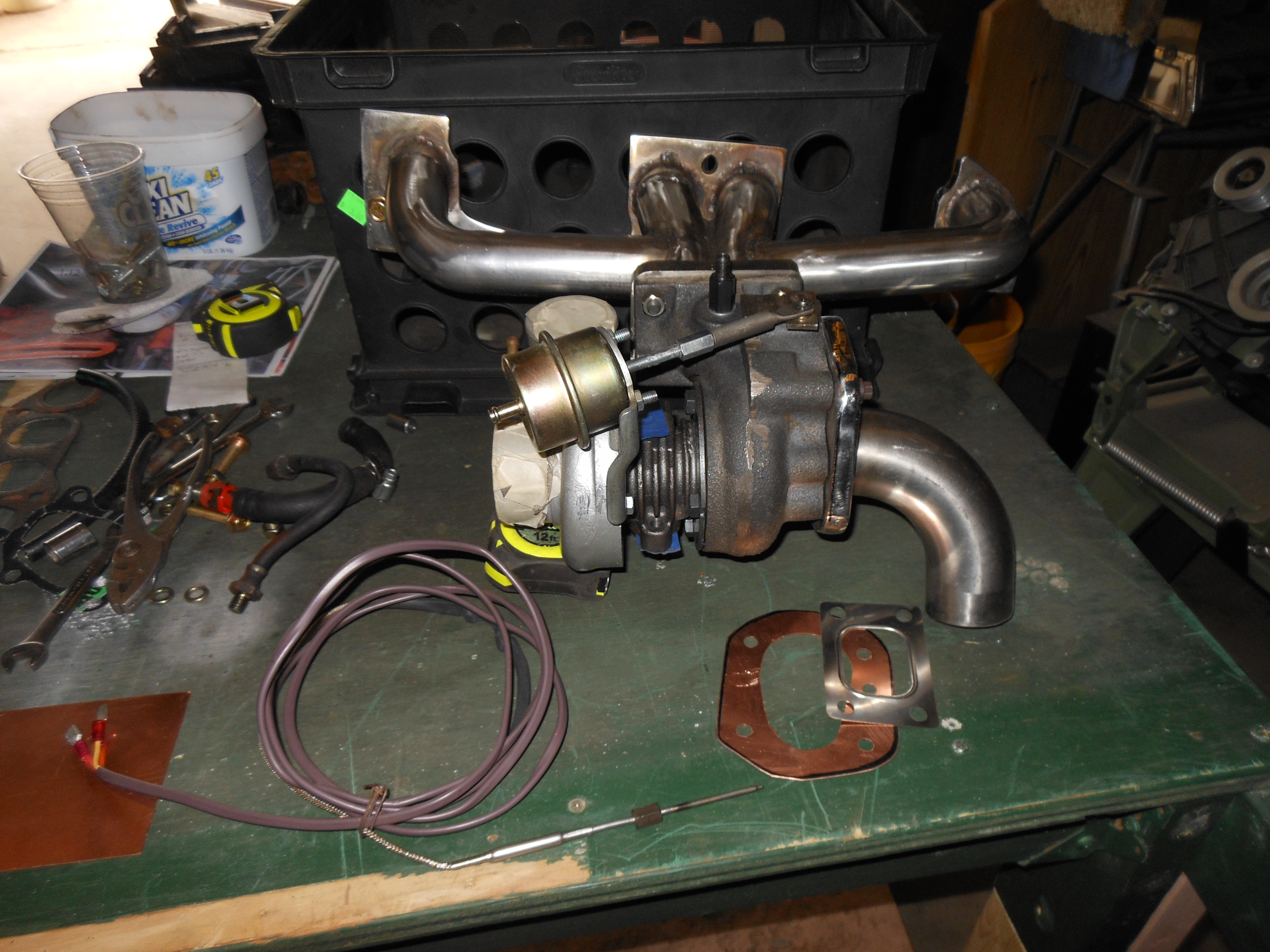

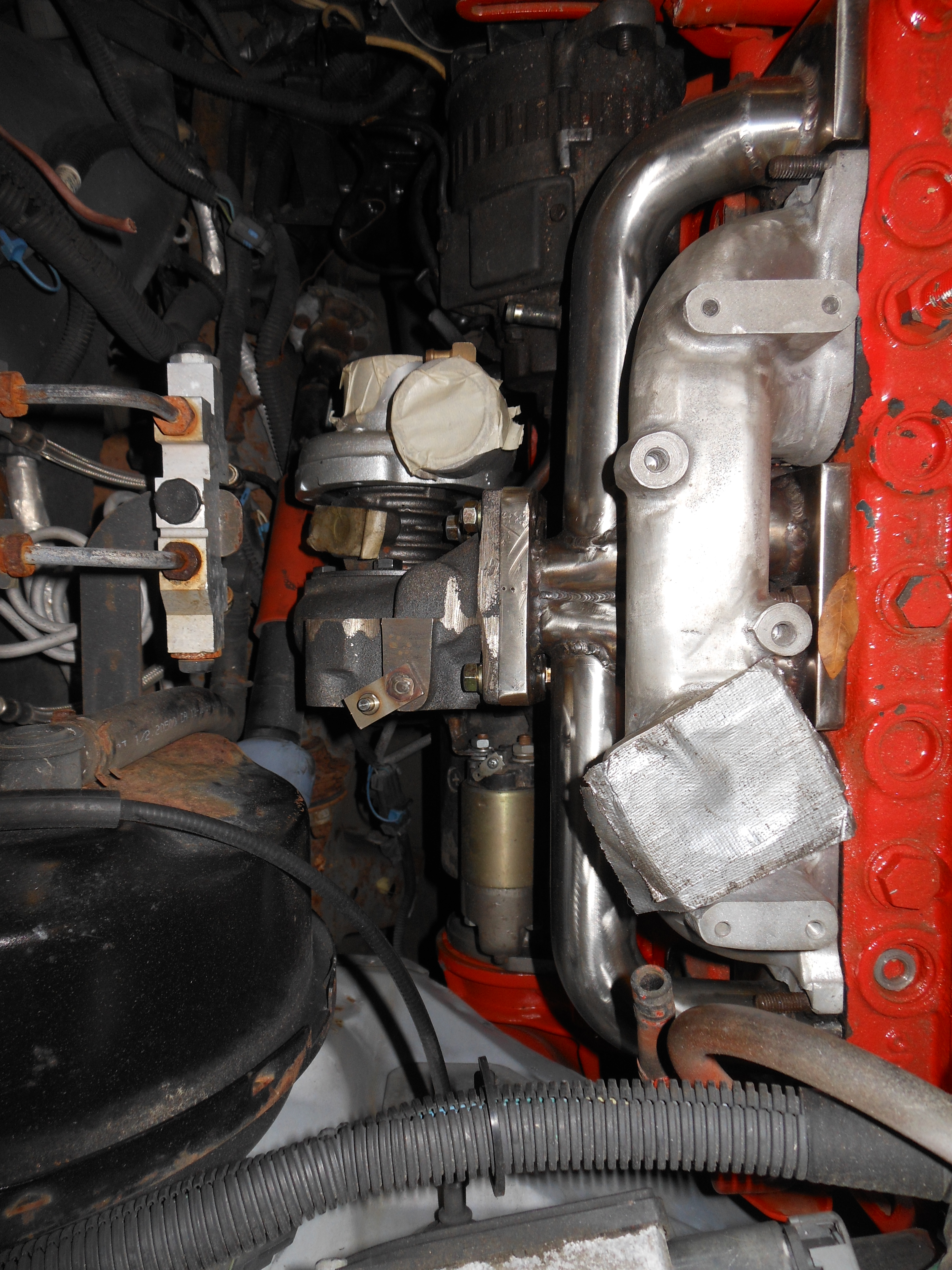

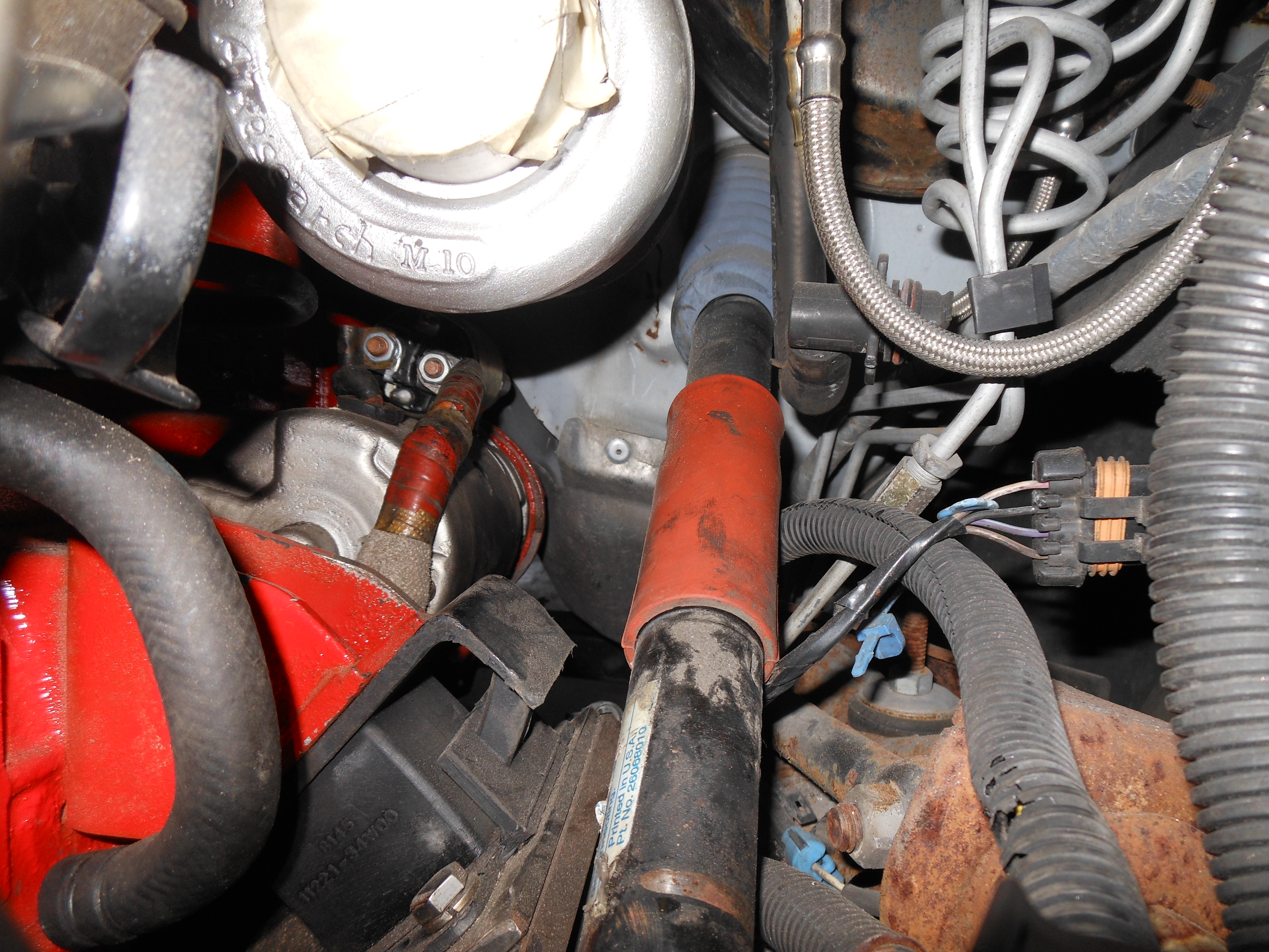

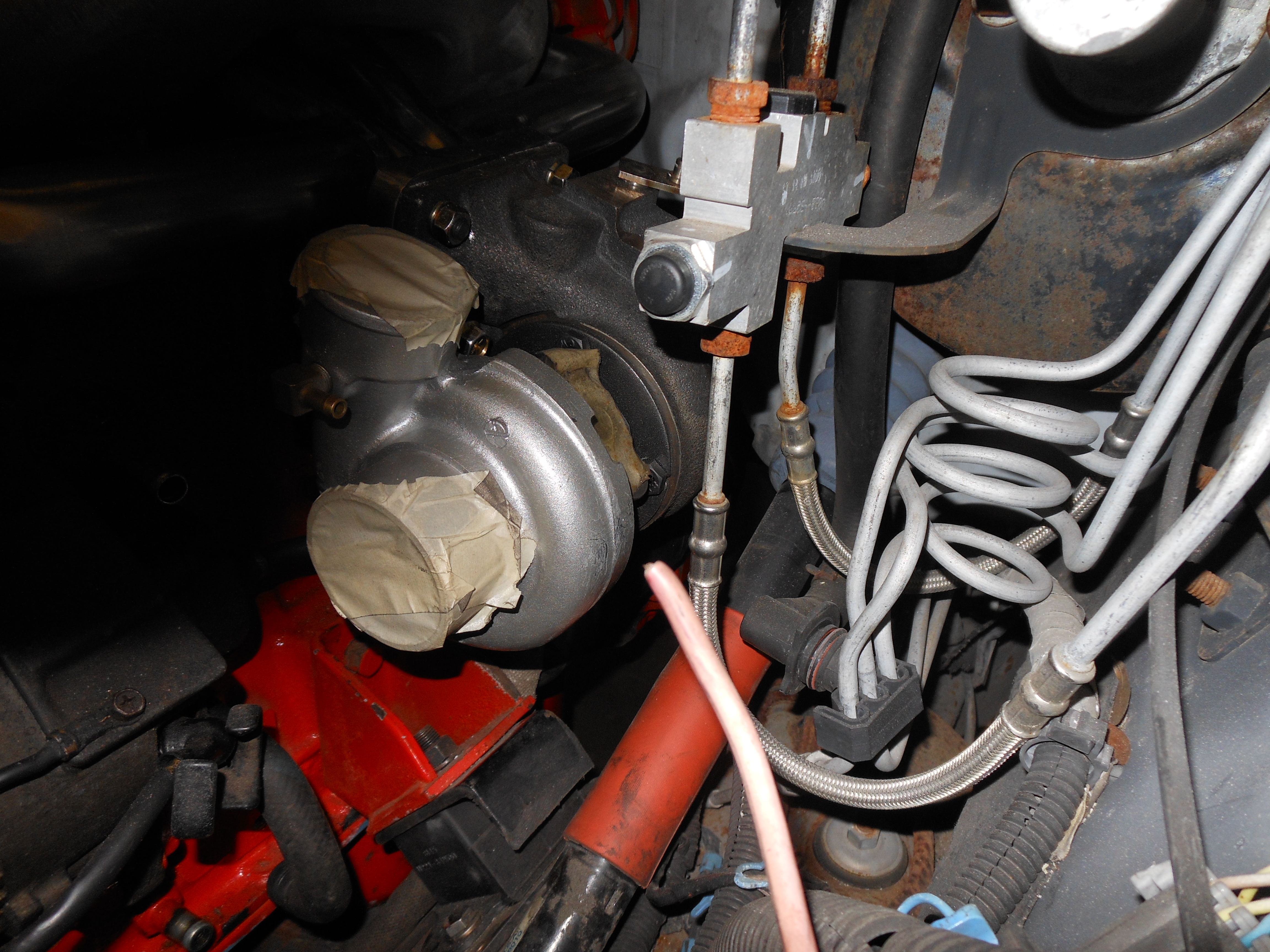

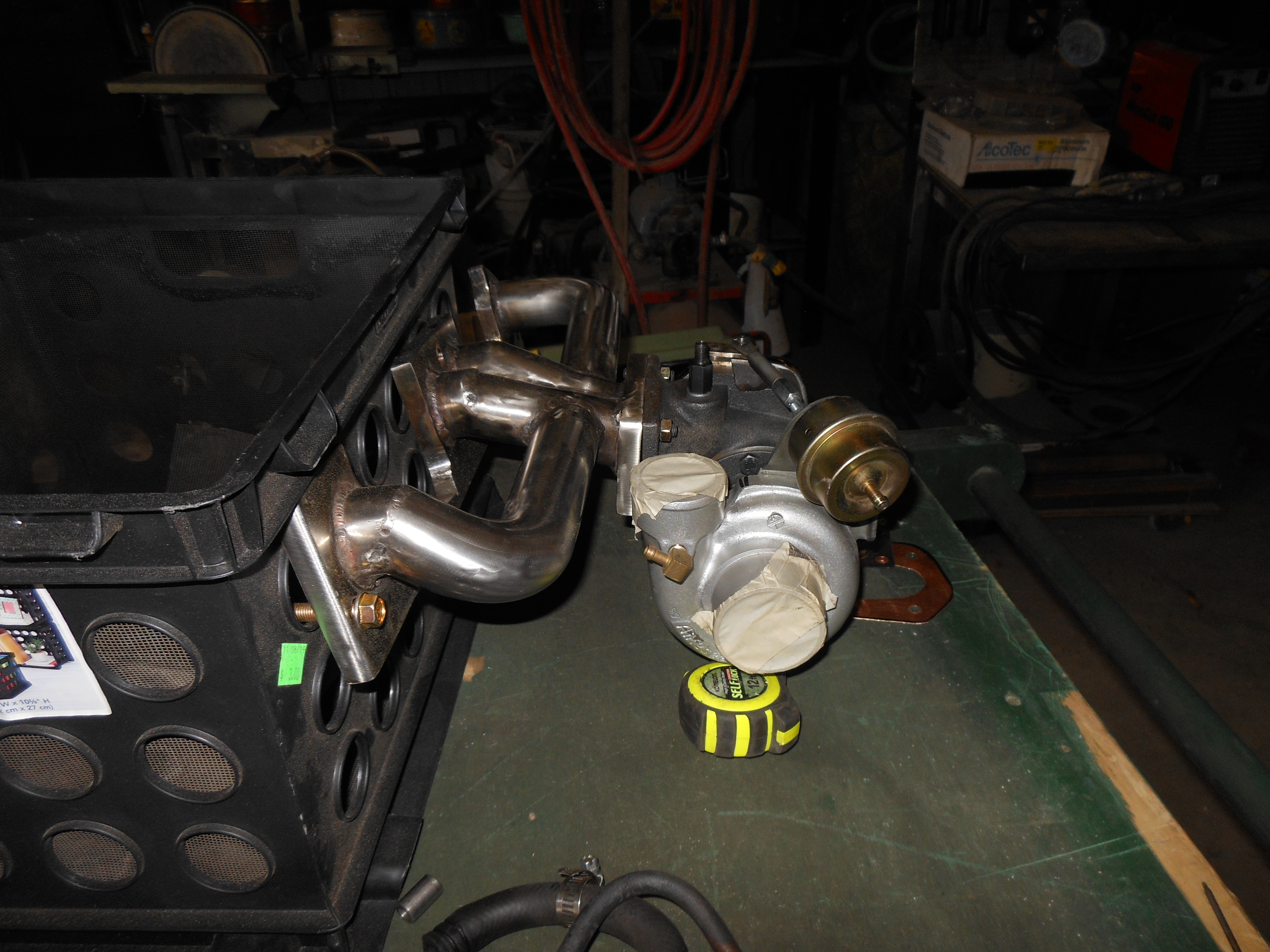

I have just ordered an Autometer Old Time tach #1478 from Summet which matches the speedometer I already had....To this I added an Autometer diesel tach adaptor. I also have a bunch of stewart warner gauges to add to the mix.....The
turbo is done except for my getting the pressure hose and the drain hose.... ....I am now in the process of pulling the Sonoma dash in order to plant the new gauges into it....more pics to follow.....- Attachments
- Turbo manifold 023.JPG (3.34 MiB) Viewed 96039 times

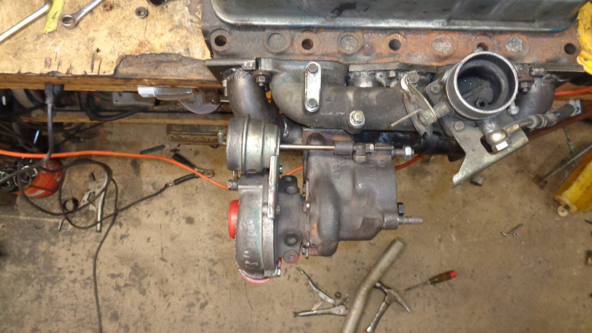

.....Just remembered these pics were also on the camera....
