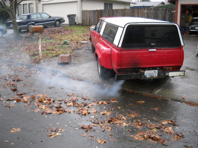

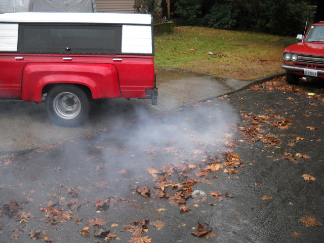

Here are a couple photos of how it smoked and the color of the smoke.

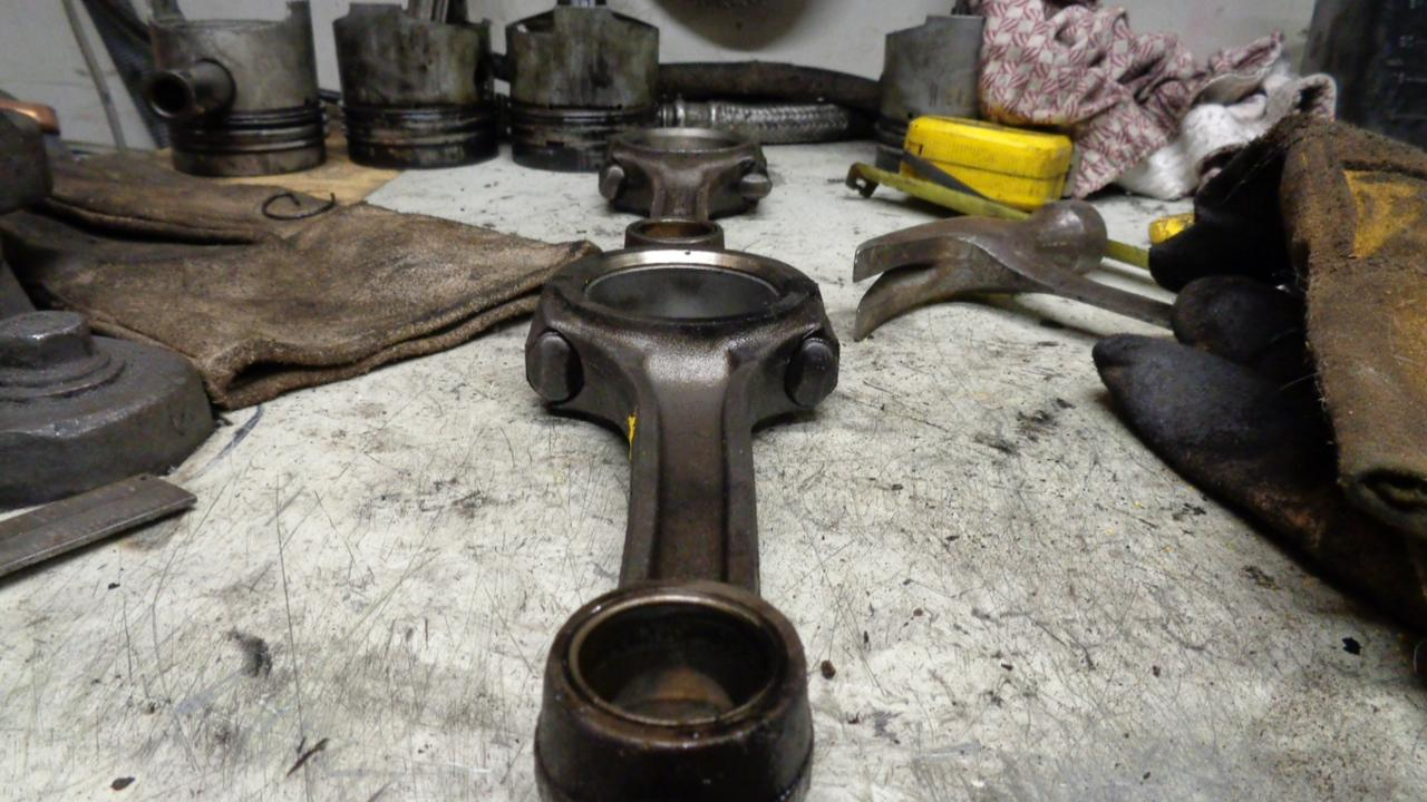

If you have read the latest in that thread I put the link to you would know that it has an issue, #3 cylinder came up 1mm short of flush with the deck like the other 3 cylinders did, I had some SD22 rods I compared to the SD25 rod, they are the same length and width, but they are slightly different in size and weight even though I think if I used 4 SD22 rods I believe it may work, well it turned out that #3 rod is bent, you can see it in this photo below, that is an SD22 rod in the background.
I was going to visit a forklift place tomorrow or the next day that says they carry Nissan forklift parts, I am hoping to find one SD25 rod.
I am thinking the piston coming up 1mm short may have been why it was smoking so bad or maybe contributed to the smoke as 1mm is a lot and it likely lowered the compression in that cylinder, maybe a lot, I could not tell it had a bent rod though, fact is that cylinder bearing was the best one of all the bearings.

I apologize as I didn't get to go through this whole thread, but very good find on the bent rod. I'd still be interested in the engine with that set back of the rod. Nissan forklift dealer should be able to come through on finding something. I definitely do like your 521 pickup and 720 dually even more! I have a dually rear myself I want to put into a truck, as well as a handful of the factory dually wheels that came on these full floating rear ends. I am located in Florence, Arizona. Thanks.

As to your smoking overheated SD 25, I think perhaps when it got hot the rings lost all their tension and thus the drop in compression and the smoking. Smoke looks more like oil smoke than fuel as it appears to be a slight bit blue.
The rod damage almost looks like Hydro lock damage. Might of had a bit of water in there after the overnight soak ( no pun intended ) and when it "hit" the next day it likely squashed it a bit. That is a guess on my part, but I have seen "hydro locked" rods before, however they looked a lot worse than that one you posted the picture of, the ones I saw happened when the engine ingested water and a pretty high RPM. ( marine application )
