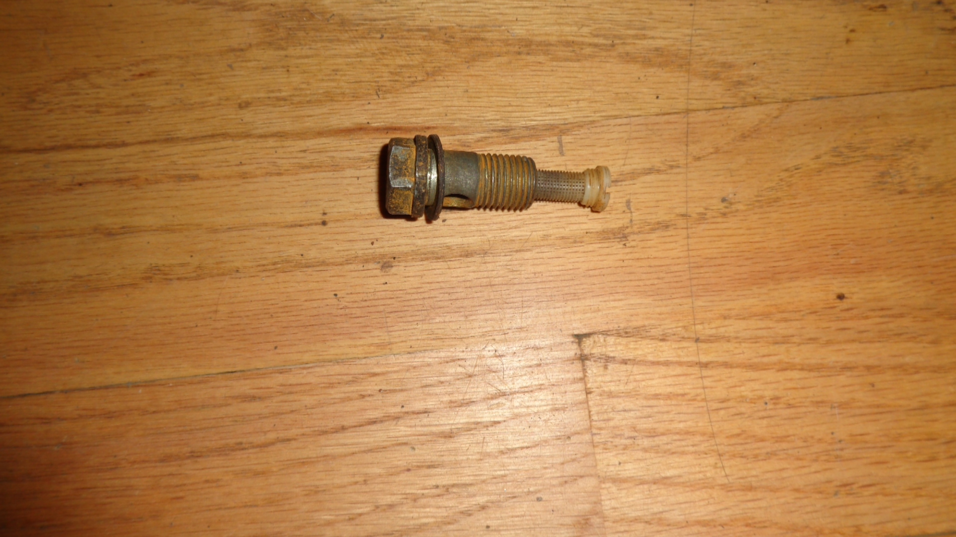

I don't really know a lot about the boat engines and what they all have, is there a lift pump with a primer on the side of the injection pump?
If there is, does it have a screen in the bottom banjo fitting where the fuel enters the lift pump, that one may need to be cleaned.
