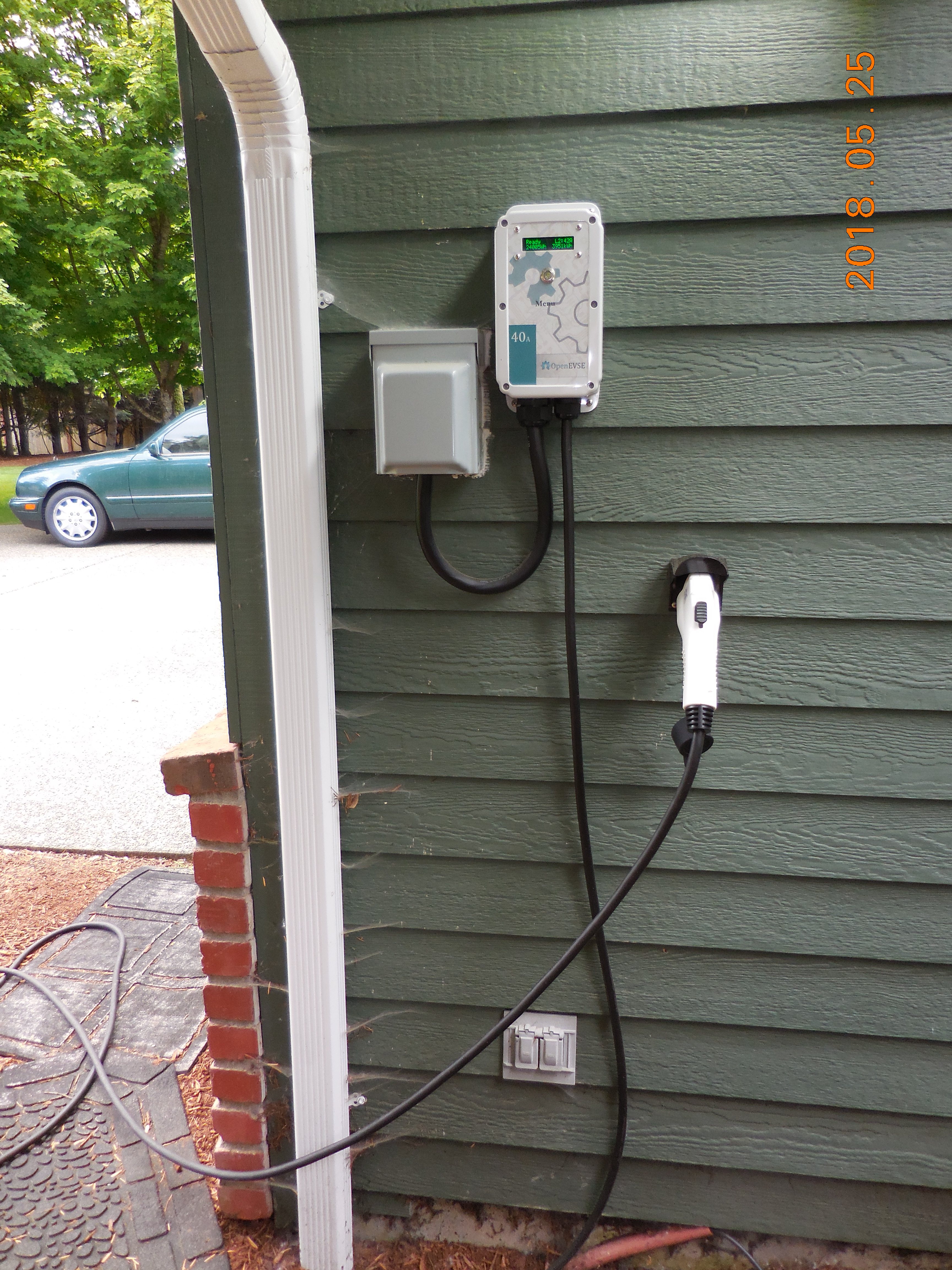

There are a LOT of mfgrs of EVSEs. I bought an OpenEVSE charging station for my first EV in Aug2017; $600 for the "Advanced" version (with WiFi and color LCD), assembled -- I did not have the time to assemble myself, though I would have loved to.

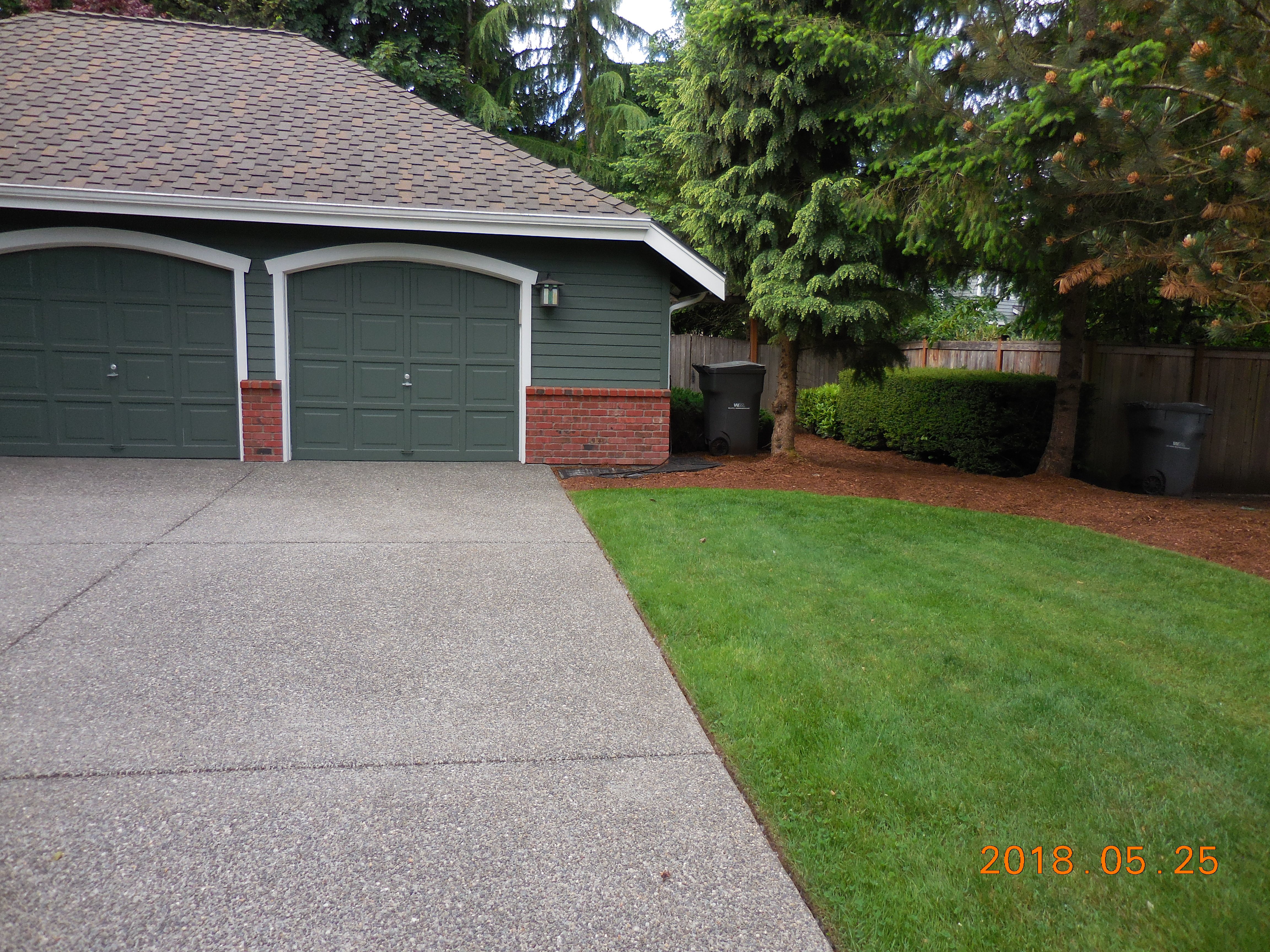

Where I park the RAV4 EV.  The tree on the corner has since been removed, as it was fouling the garage's foundation.

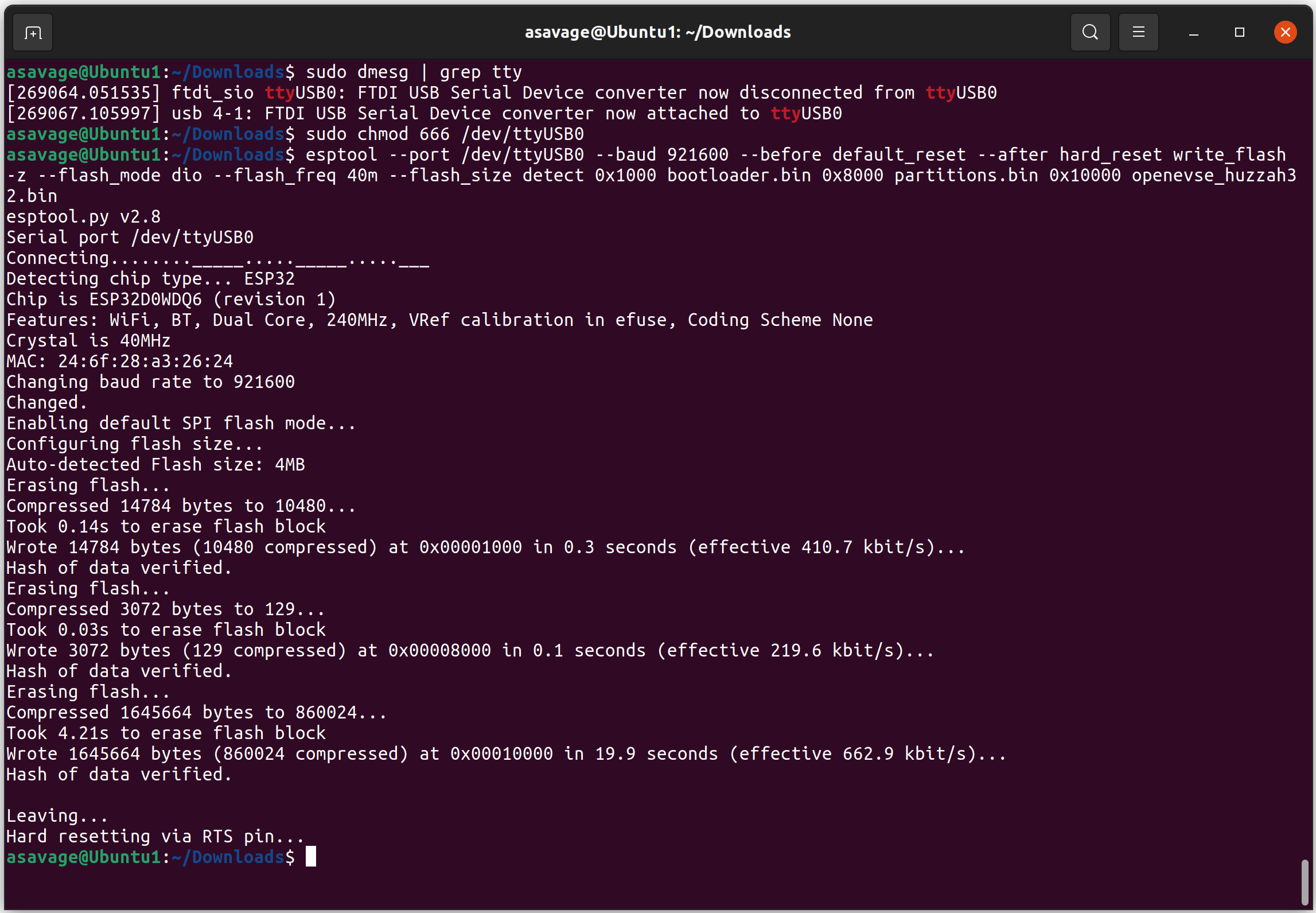

I upgraded my original ESP8266 WiFi hardware to the current ESP32-WROOM-32 version. I bought the module from Adafruit for $13.50 + shipping, around $22 on my doorstep, and it comes with some pin header strips. OpenEVSE does sell their version (same Espressif chip, different PCB and headers) for $40 + shipping, and it comes pre-loaded with a recent firmware, but since I already have the USB<>UART programming tool, I decided to buy the bare/no-firmware-installed board. I cut off a chunk of pin header, six pins long, and soldered it to the board: hardware part done.
Instructions for the esptool command line are here. Since this is a new install, flashing the bootloader and the partitions file is required, as well as the actual firmware, so for Ubuntu 21.10 and python 3 and the esptool Ubuntu package installed, I used:
Code: Select all
esptool --port /dev/ttyUSB0 --baud 921600 --before default_reset --after hard_reset write_flash -z --flash_mode dio --flash_freq 40m --flash_size detect 0x1000 bootloader.bin 0x8000 partitions.bin 0x10000 openevse_huzzah32.bin
That requires three files (from here):
  • partitions.bin
  • bootloader.bin
  • openevse_huzzah32.bin
Subsequent firmware updates should be able to be OTA via the unit's web UI, but if I ever needed re-flash this module, I would not need to re-flash the bootloader or partitions info.

    asavage@Ubuntu1:~/Downloads$ esptool --port /dev/ttyUSB0 --baud 921600 --before default_reset --after hard_reset write_flash -z --flash_mode dio --flash_freq 40m --flash_size detect 0x1000 bootloader.bin 0x8000 partitions.bin 0x10000 openevse_huzzah32.bin
  • esptool should be "connecting" . . .
    Code: Select all
    esptool.py v2.8
    Serial port /dev/ttyUSB0
    Connecting........_____....._____.....___
  • You'll have around 20 seconds to get the ESP32 to begin accepting data. In order for the ESP32 to use its serial interface to input flash data, you have to put the chip in flash mode, by using the two switches on the Adafruit ESP32 Huzzah.
    • Press and hold the GPIO0 button
    • Press and hold the Reset button for ~1/2 second
    • Release both buttons
    • If the button pressing/releasing timing was right, esptool will stop "connecting" and move on to "Detecting chip type..."
ESP32-WROOM-32 Huzzah initial firmware/bootloader/partitions load

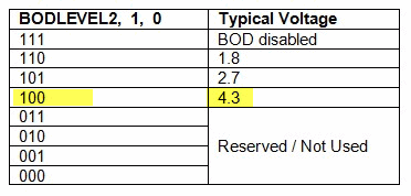

oPossum wrote:Bits 3 to 7 of efuse will always read 0 - they are not used.
So 0xFC (1111 1100) is the same as 0x04 (0000 0100)
Bits 0-2 are to enable/disable Brown Out Detection (BOD), and if enabled, to set the voltage below which the AT328P will not run. The OpenEVSE code sets it to only run when the supply voltage is above 4.3v .
Atmel ATMEGA328P Brownout Detection voltage chart.
The default for this chip is/was 0xFF (B1111 1111) (opinions vary), or different programming tools/versions read-back an unset bit (which on this device: unset = 1) as either 0 or 1, so depending on the tool and version and age of the chip, one might get 0x04 or 0xFC.
See this post for more.
It's even possible that the WinAVR version of avrdude, and the Linux version read-back unset bits differently. I'm not chasing it down further, I'm happy with it working.

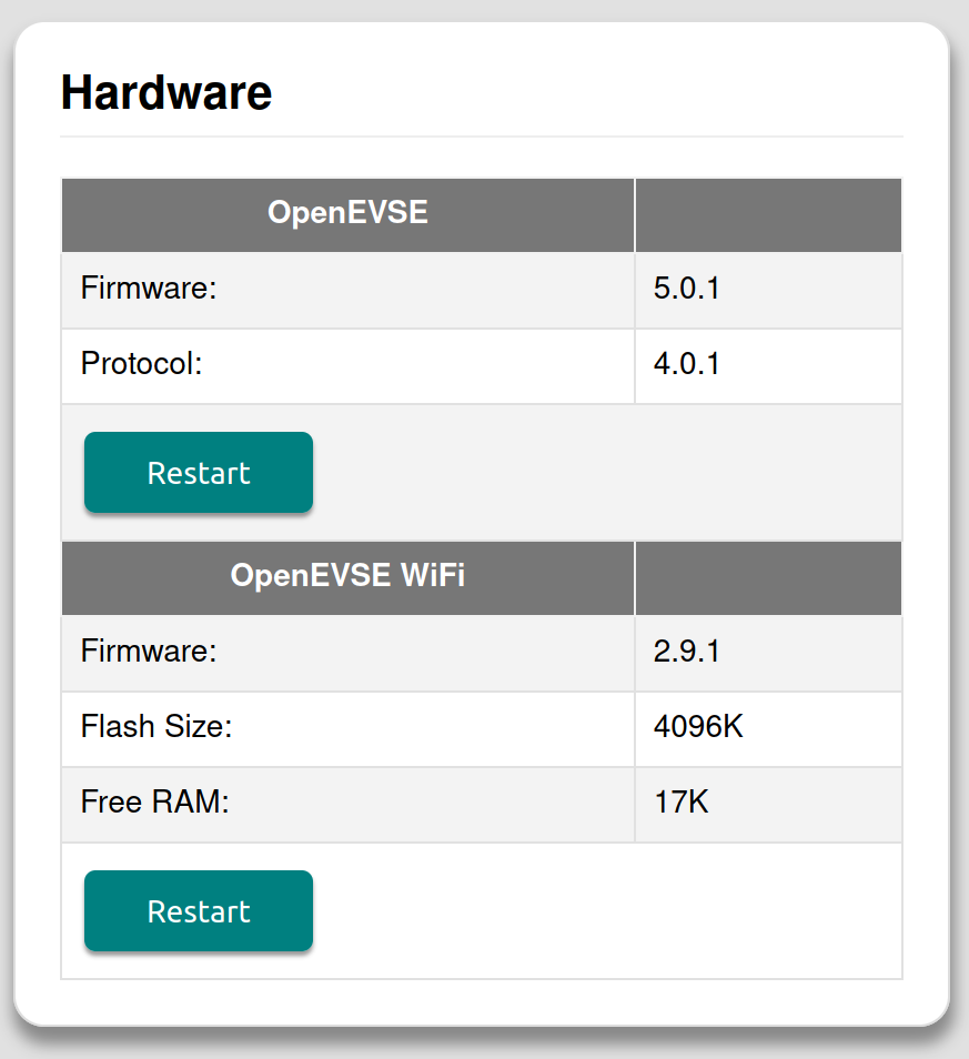

After the above, the EVSE's web UI shows the updated firmwares:
OpenEVSE Advanced v4 with updated firmware for the controller and WiFi modules.

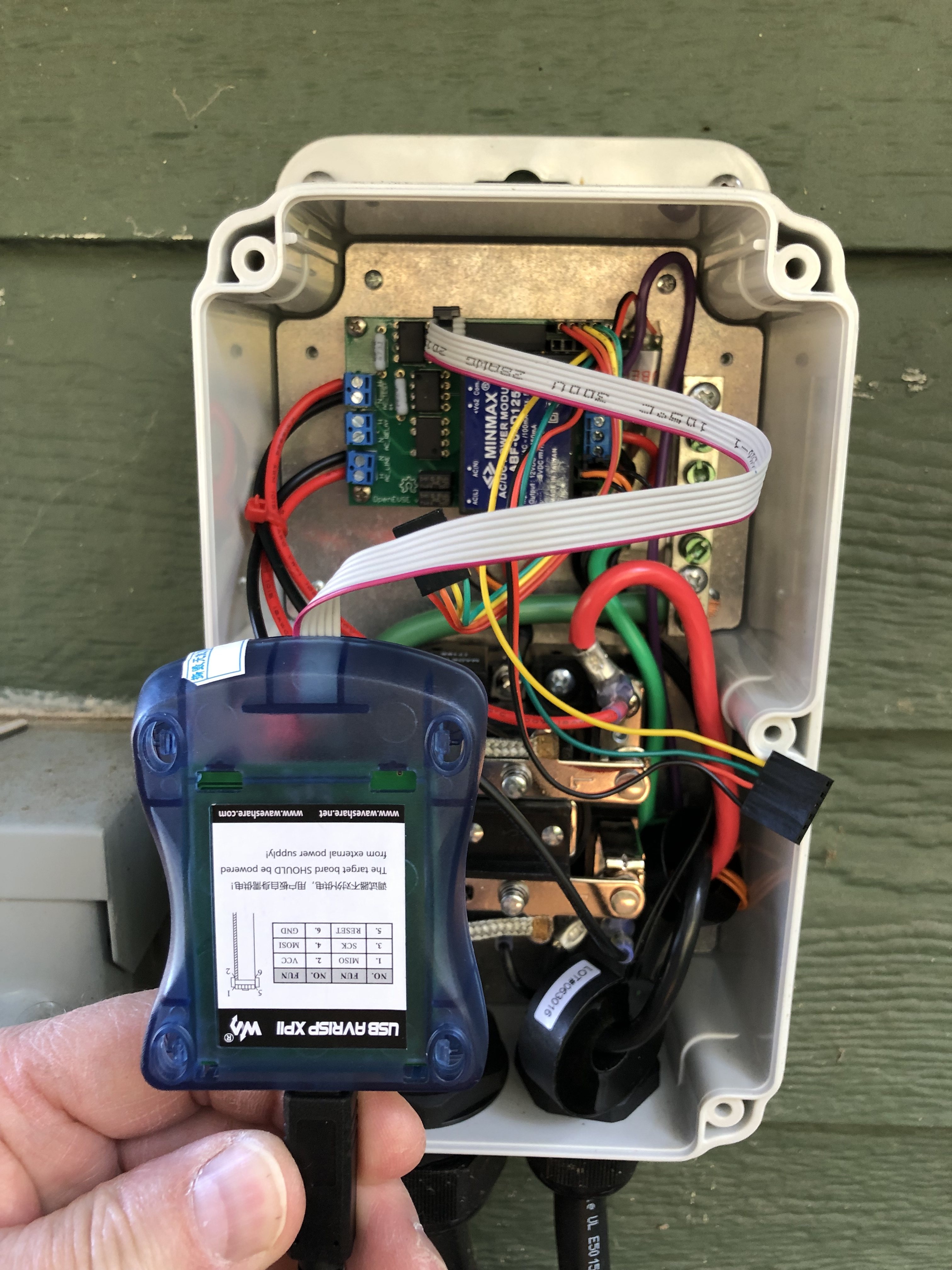

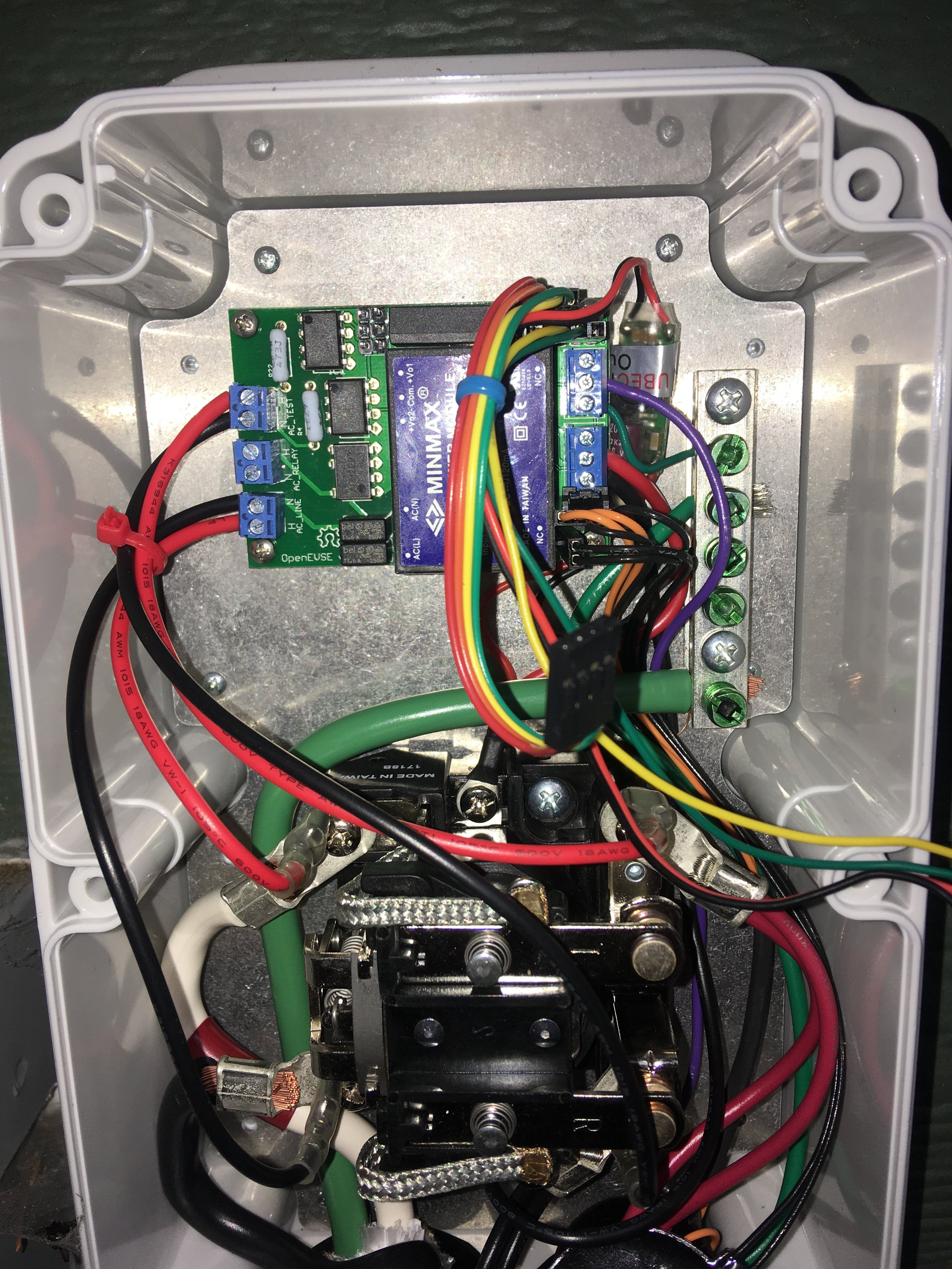

A couple of reference pics from Oct2019:
OpenEVSE Advanced v4 hardware

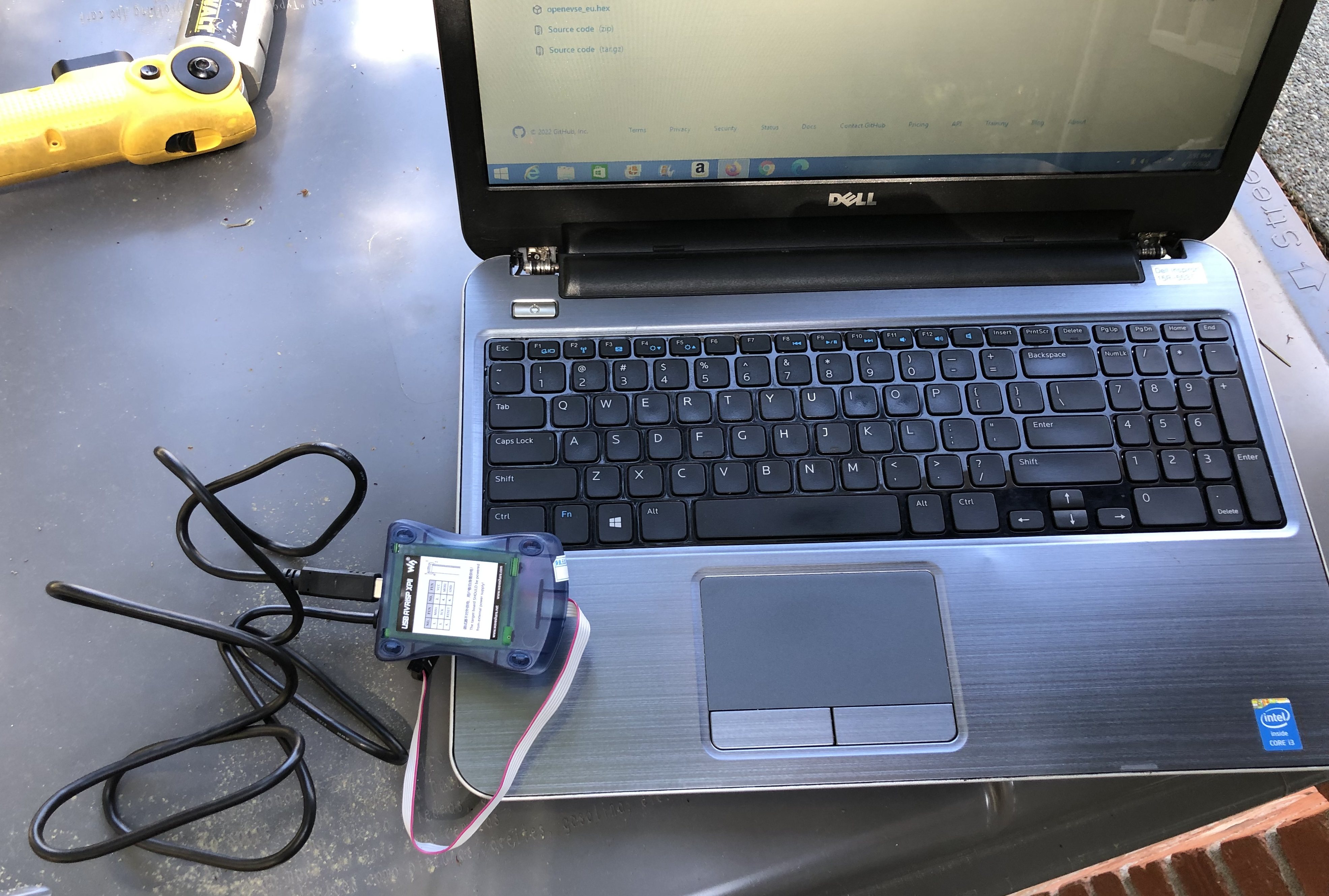

Windows notes (Apr2022)

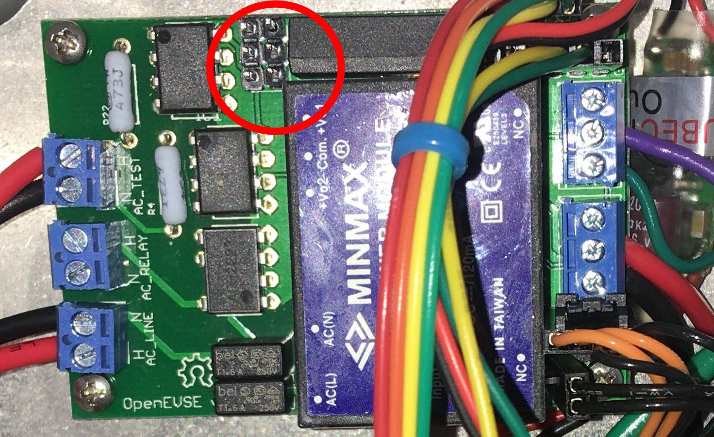

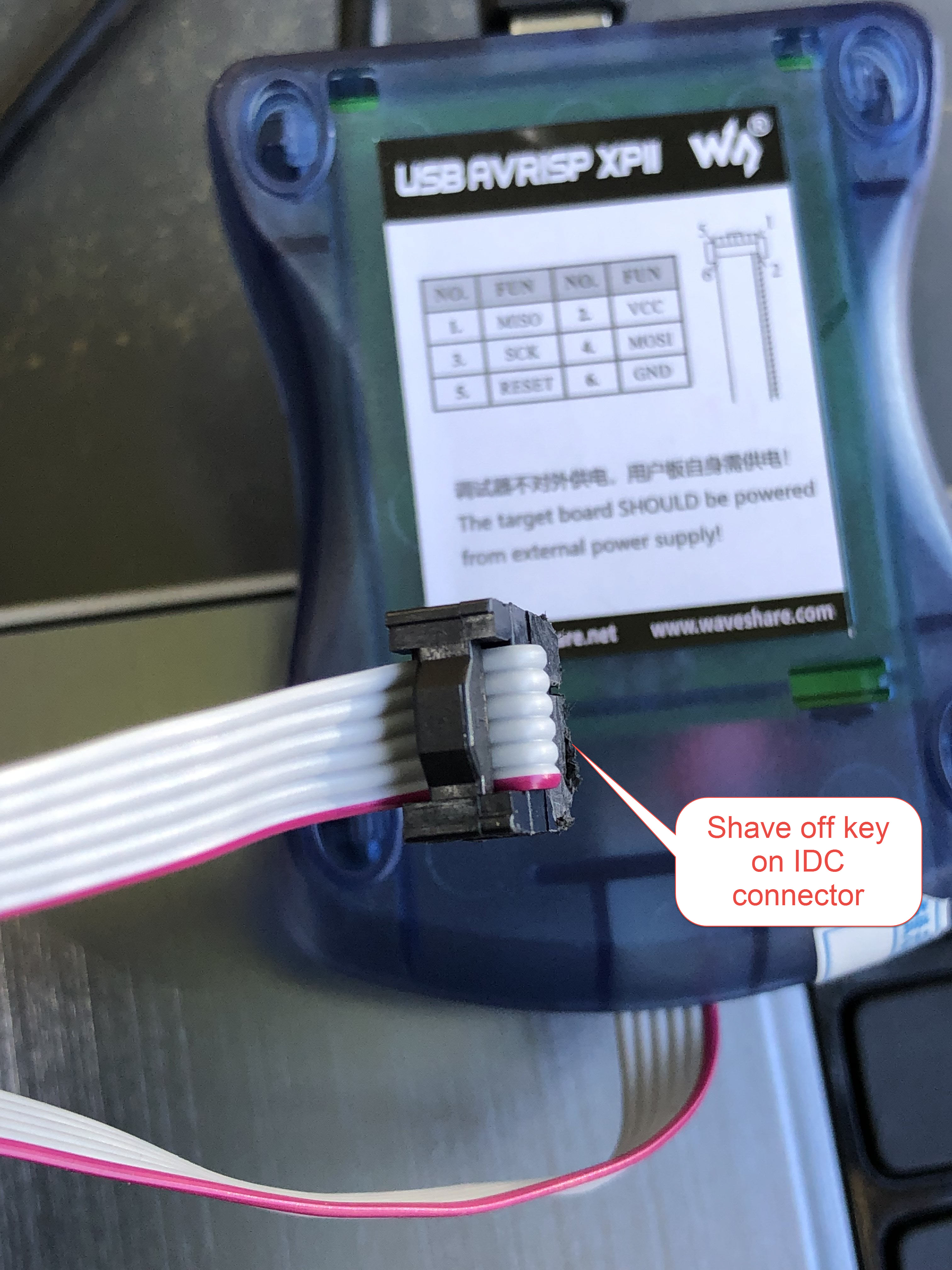

The Waveshare USB AVRISP XPII is a clone of a long-ago discontinued Atmel AVR ISP mkII. Above, in 2019, I successfully used it to update the OpenEVSE controller's firmware, under Ubuntu Linux. At that time, I had the controller on my workbench. Today, I wanted to update the firmware again (from 5.0.1 to 8.2.0) with the EVSE still mounted outside, using my all-purpose auto diagnostic laptop which runs Win8.1, but it took a bit of reading to get that working.
Waveshare USB AVRISP XPII (Atmel AVRISP mkII clone), and Win8.1 laptop.
Waveshare USB AVRISP XPII with ribbon cable's IDC connector's key shaved off

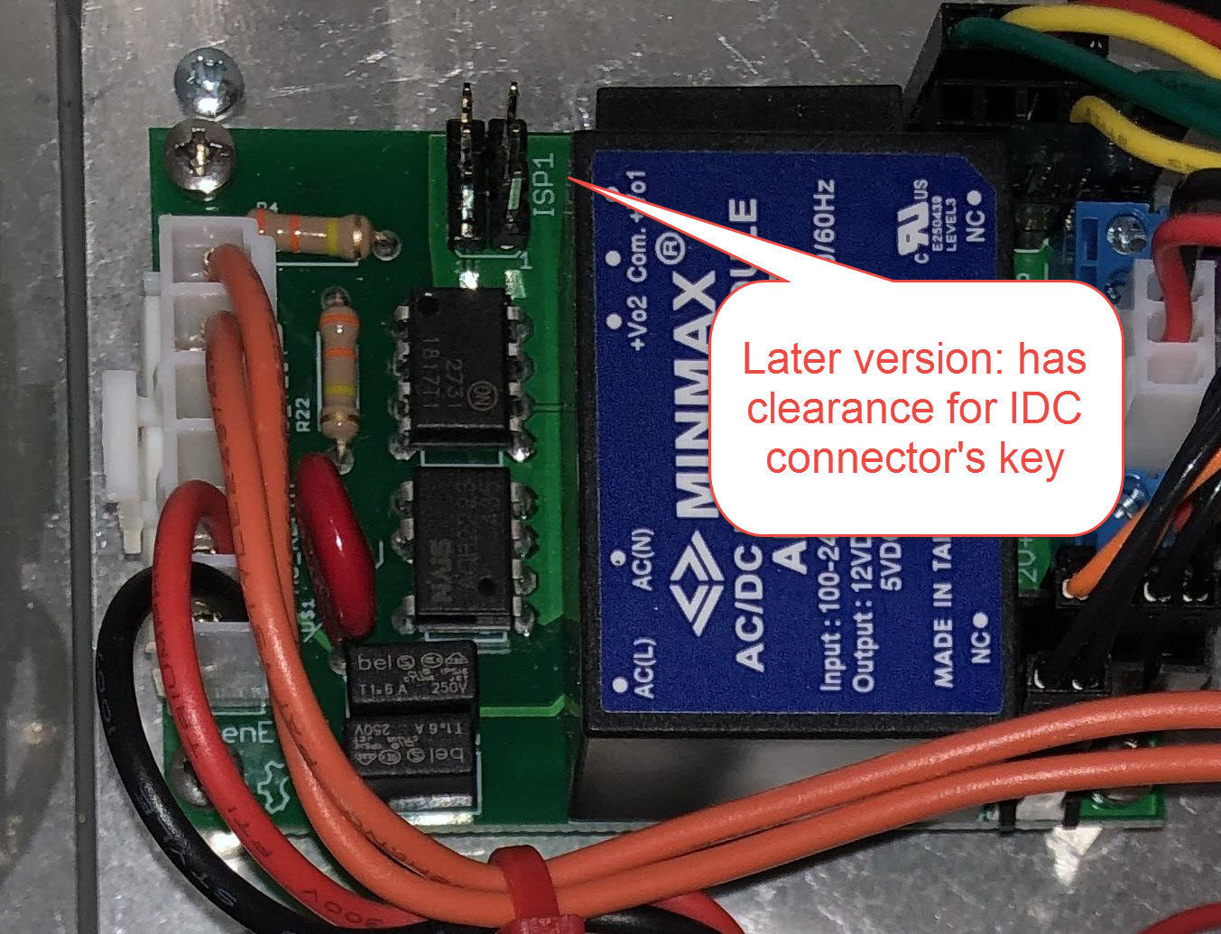

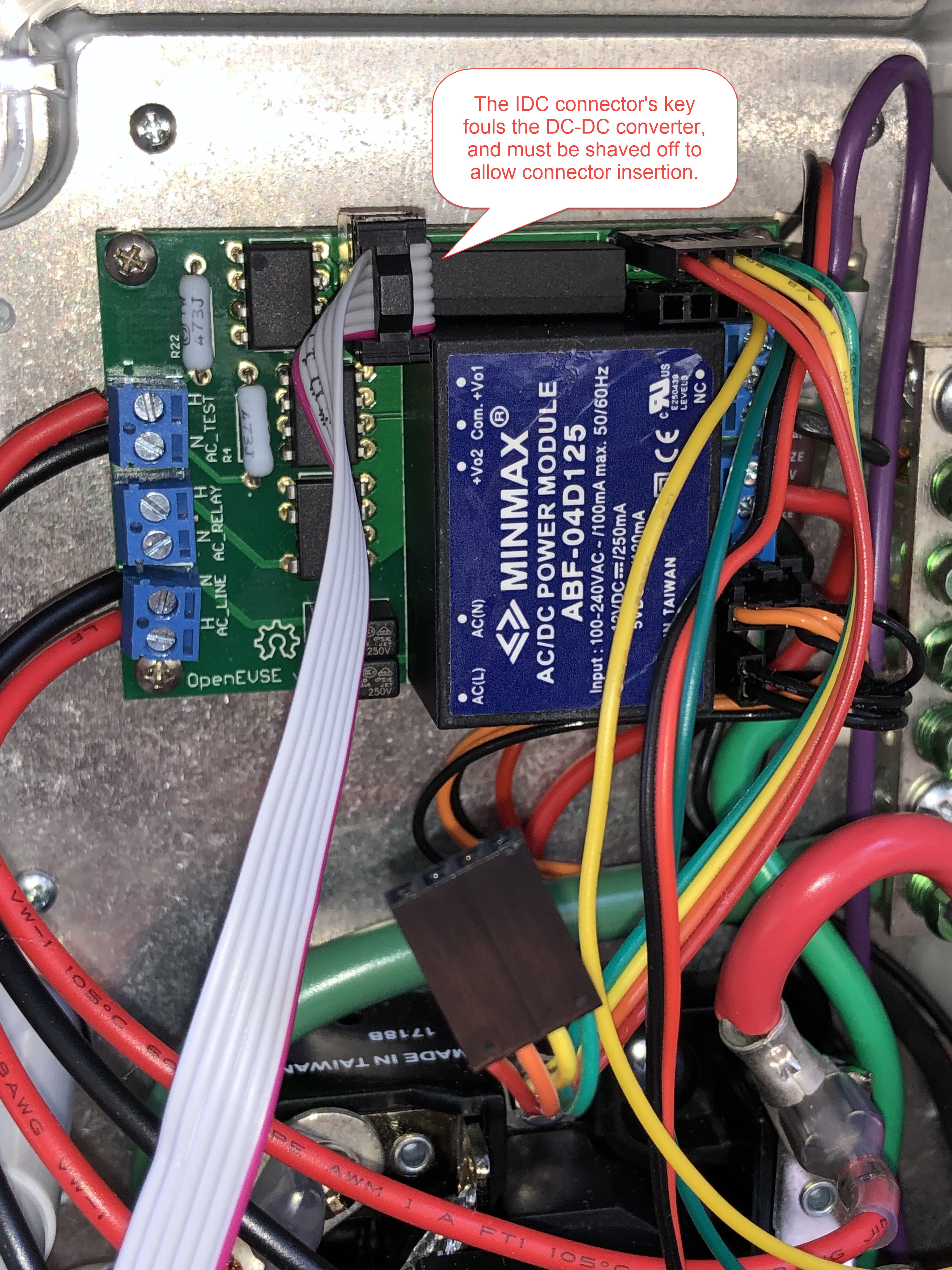

Later OpenEVSE controller, showing the DC-DC converter has been moved to allow room for ISP IDC connector key.
No room for the IDC connector's key.

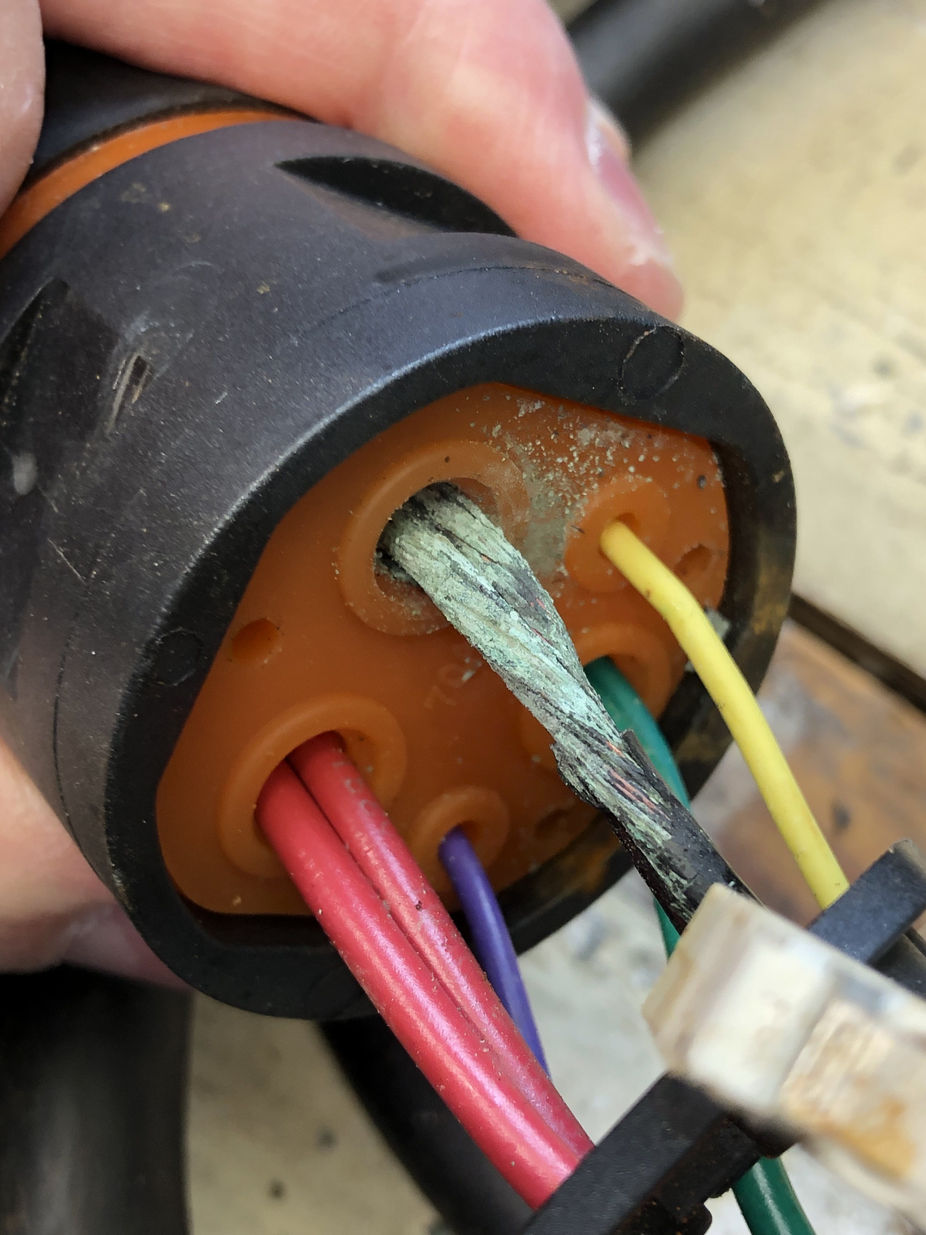

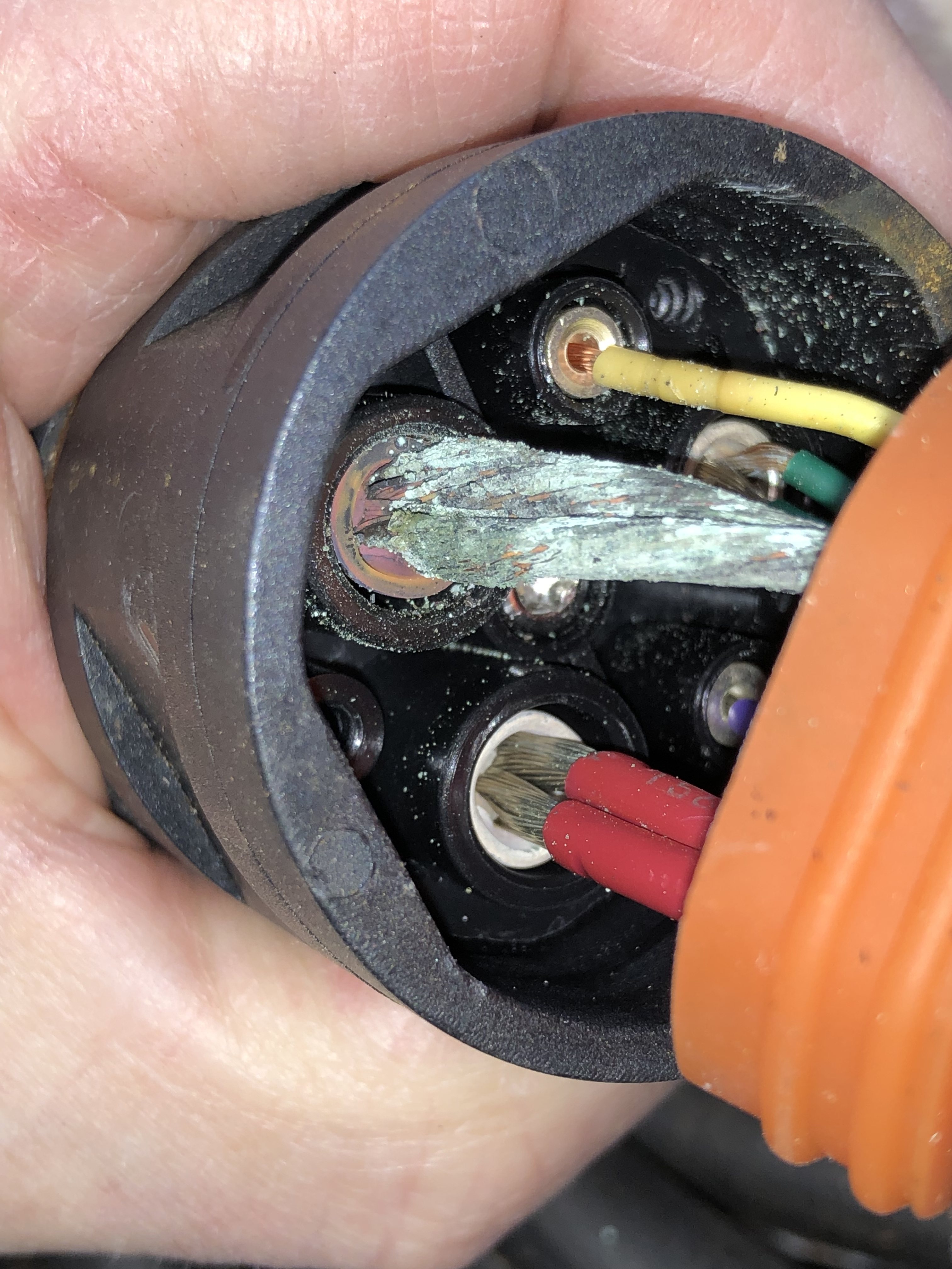

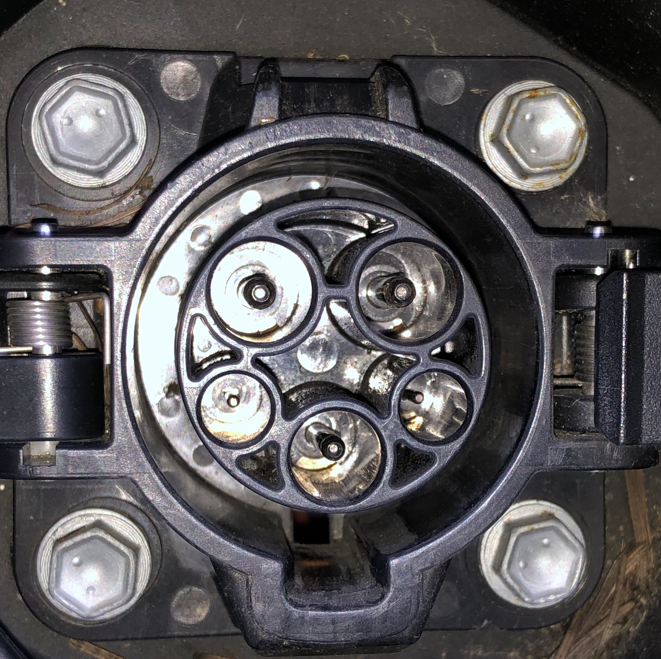

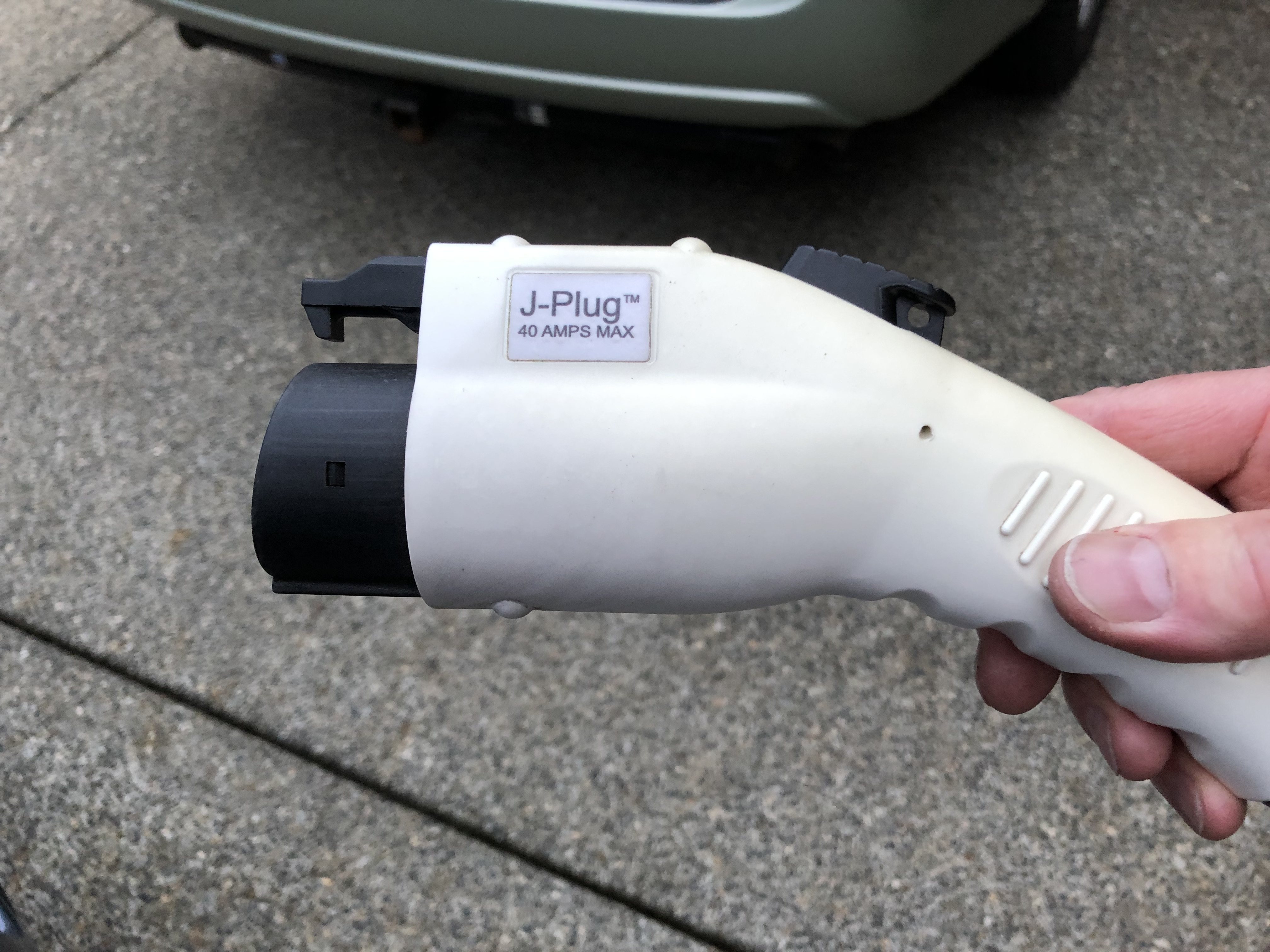

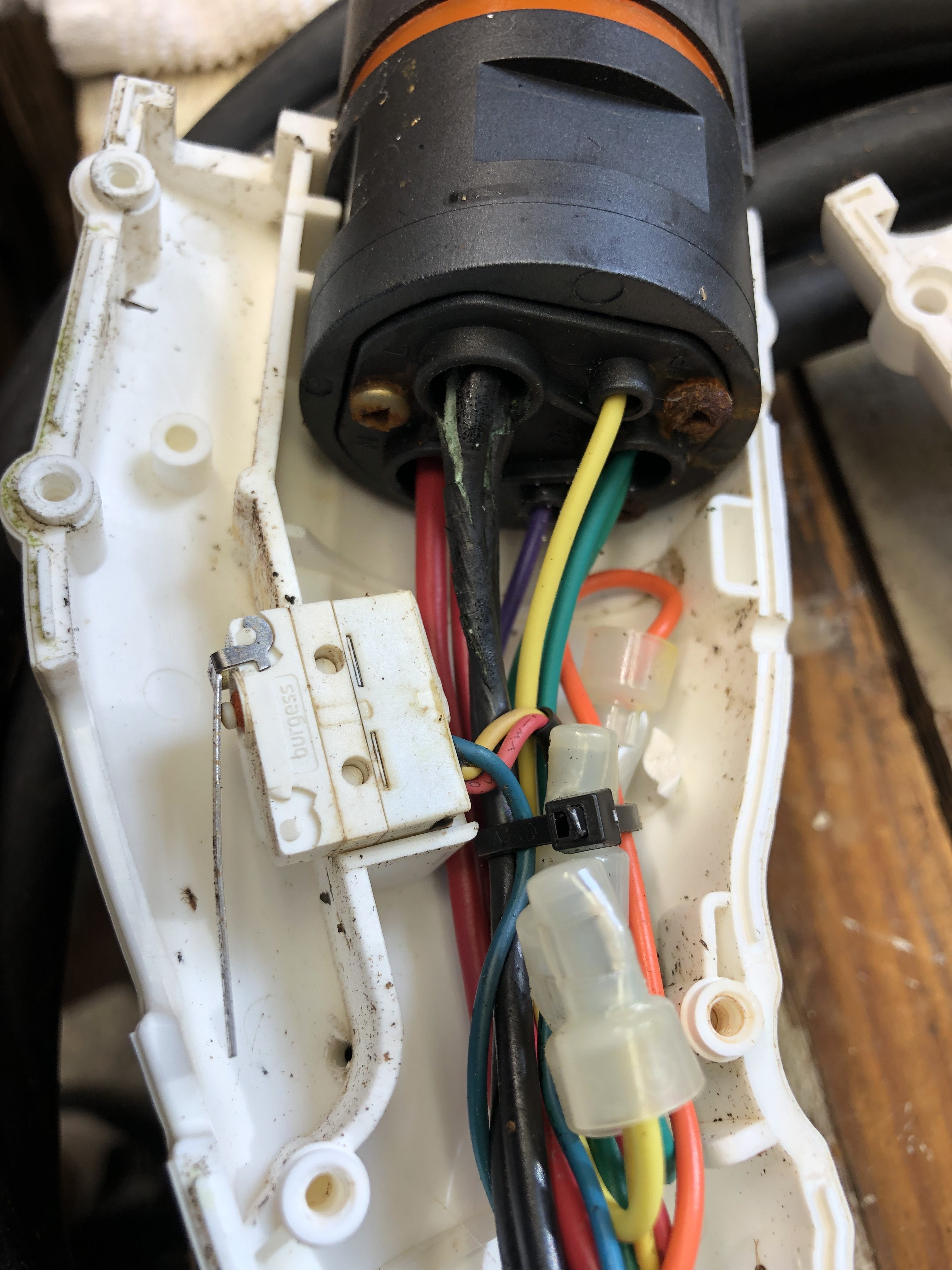

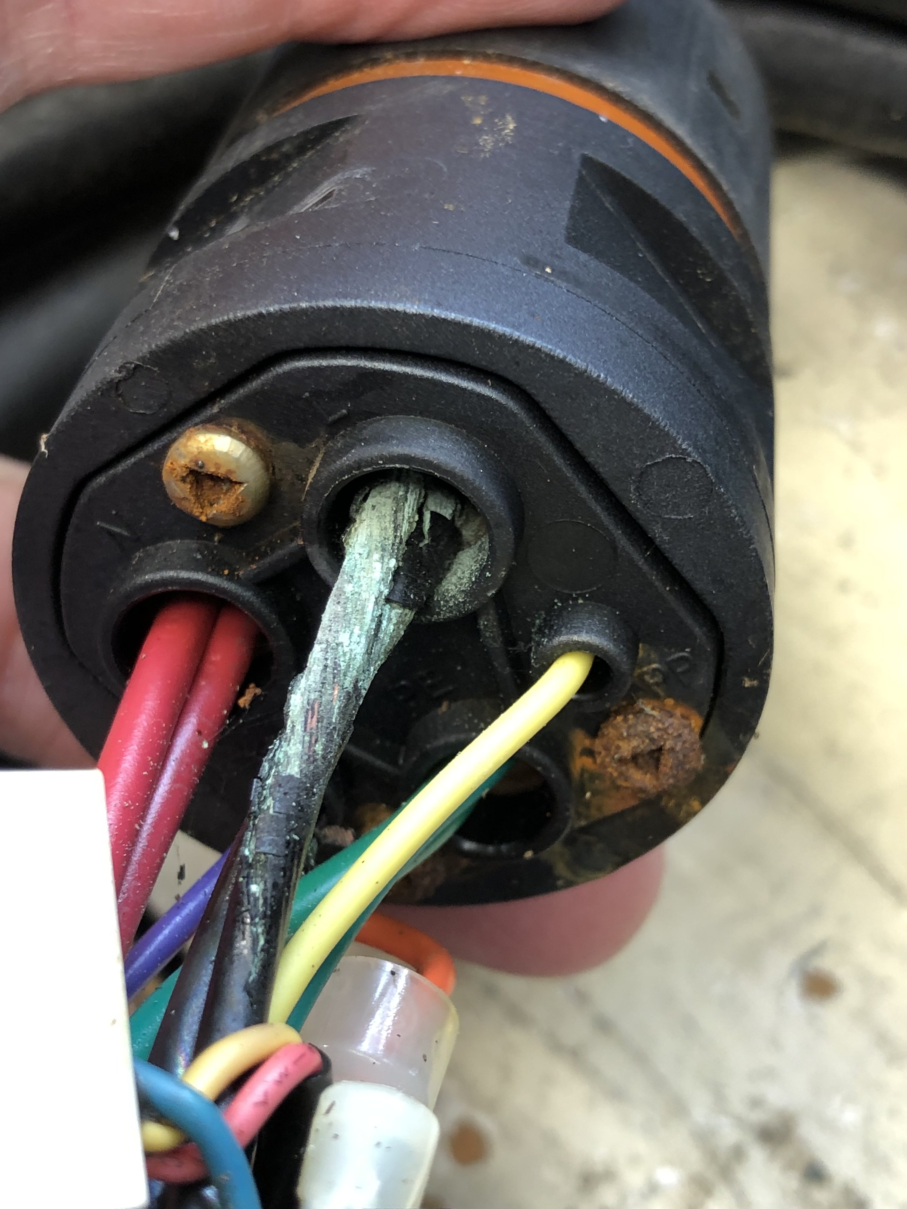

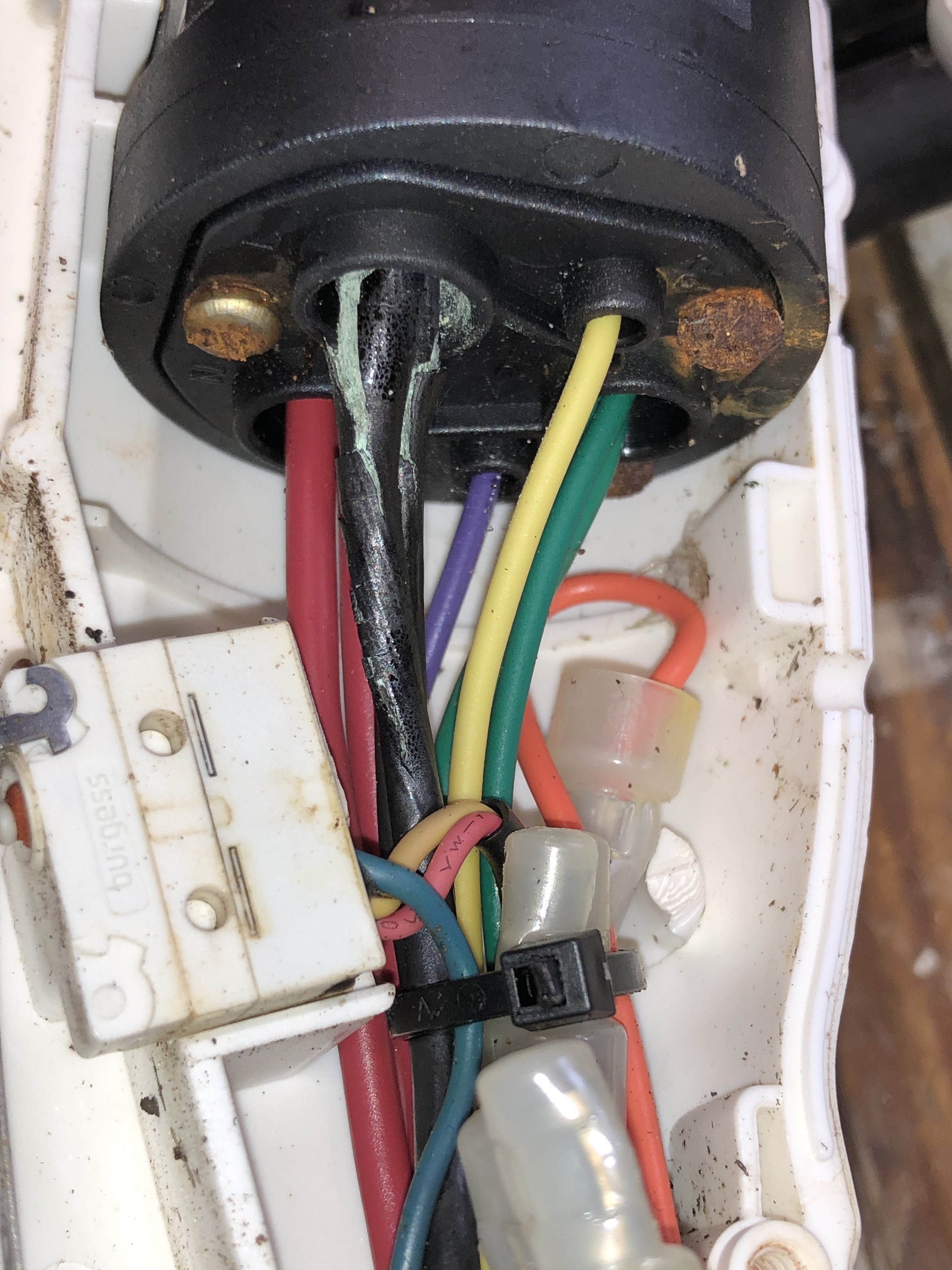

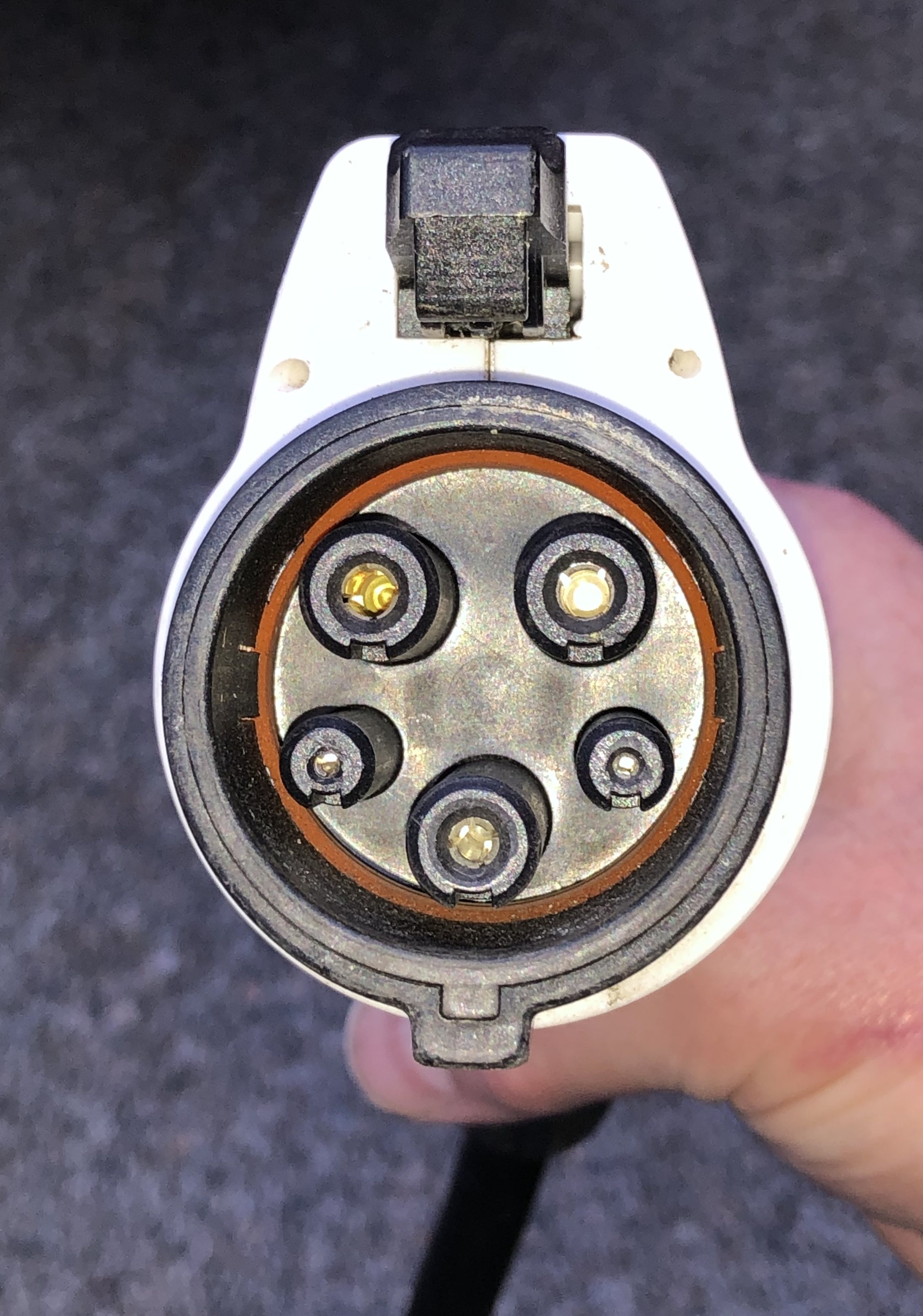

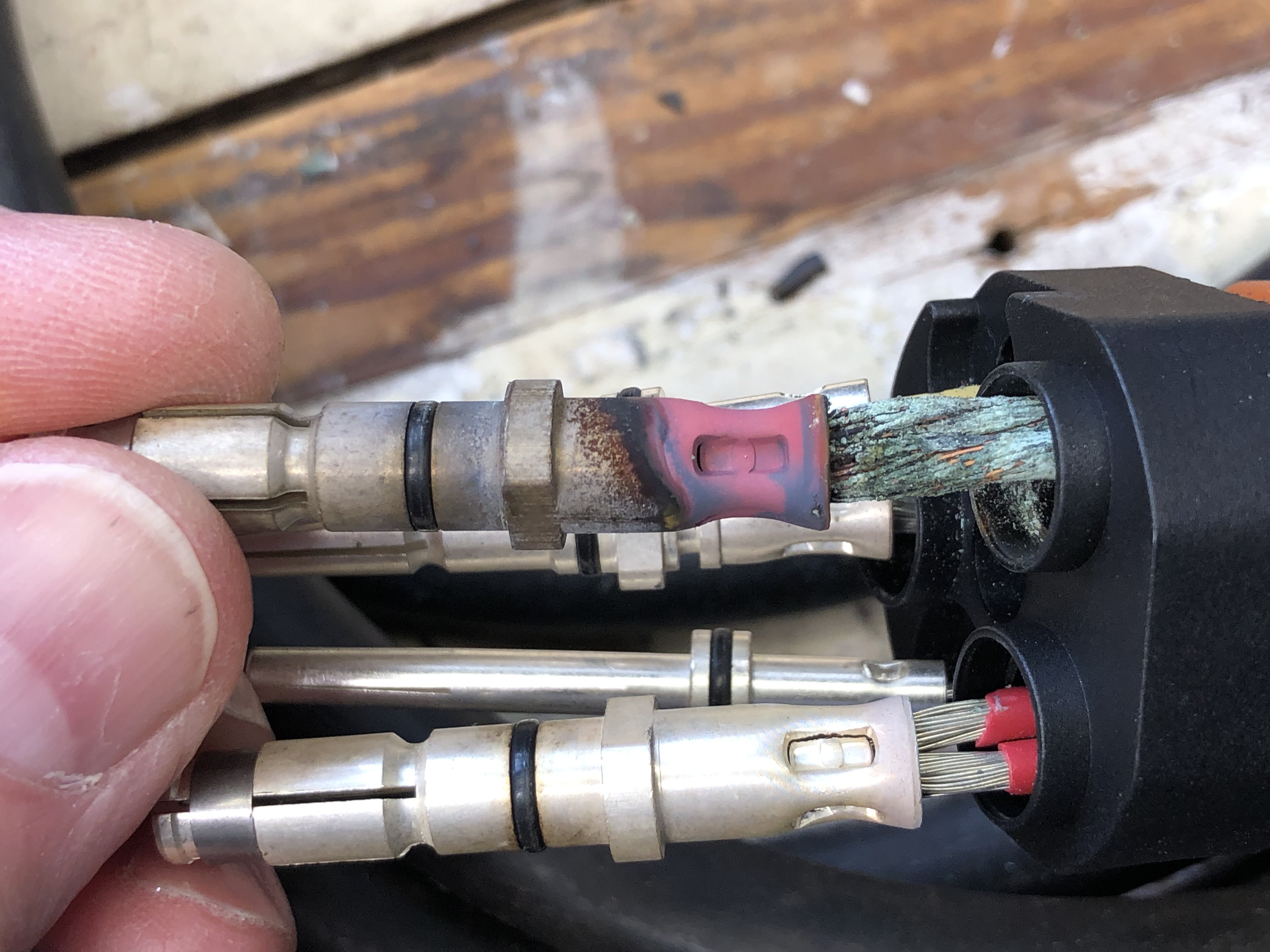

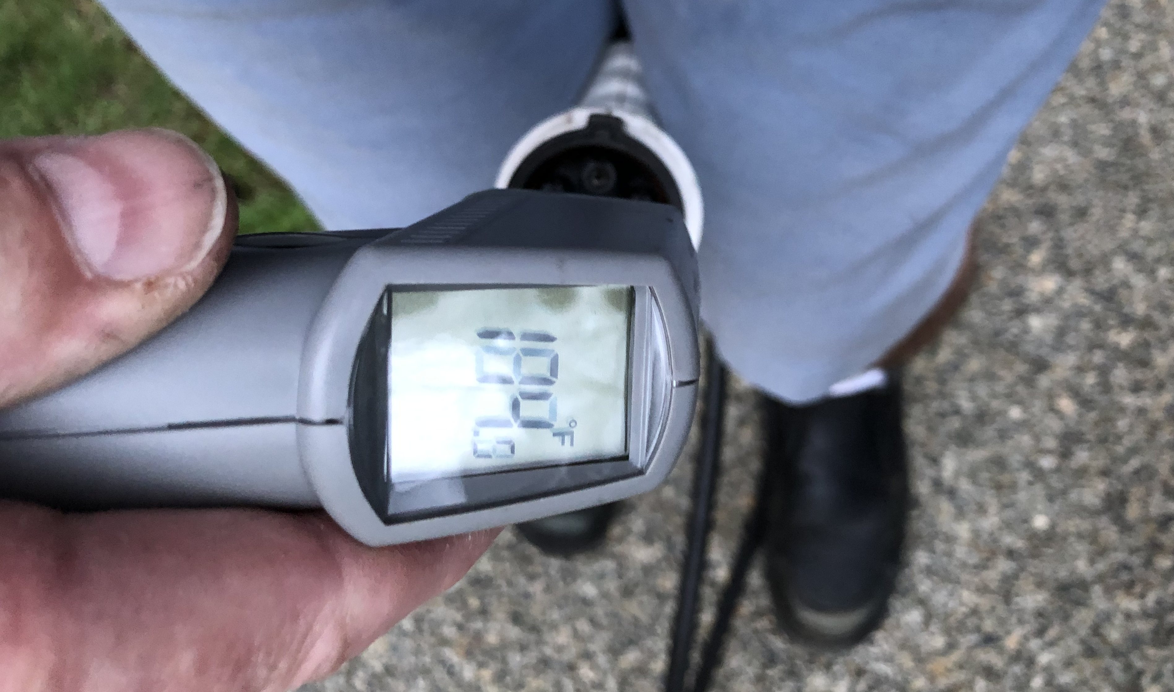

J-1772 nozzle ("J-Plug" by QC Charge) failure
The EVSE in the preceding post is Order #4254 06Aug2017 "Model P50A Advanced - 40A", and was shipped as a v4 hardware design; as of this writing, they are shipping v5.5, which has a different hardware layout but the same or similar components.
I use this EVSE primarily with a 2014 Toyota RAV4 EV, which can actually draw 40 amperes; most non-Teslas cannot get close to that, and the 2014 RAV4 EV has a Tesla onboard charger. I have this EVSE configured for 40A max (240v) on a 50A supply circuit, with a ~20' supply run from the breakers panel to the EVSE's inlet socket.
I normally plug in when I arrive home. The vehicle has its own charge timer, which I have configured such that it calculates when to begin charging so that the vehicle is fully charged when I am about to depart the next day. So, I'm normally handling a "cold" nozzle: cold when I plug it in, cold when I unplug it, because it finished charging at least an hour before I am ready to depart.
Recently, I had occasion to need to charge during the day -- an unusual situation for me -- so I set the vehicle to ignore its charge schedule and "charge immediately", and I plugged in. I was starting from around a 50% SOC. I unplugged at around 85% SOC because I needed to move the vehicle. Immediately, I noticed that distinctive "hot electrical/hot plastic" smell we come to recognize. I found my cheap Raytec IR thermometer and was able to obtain a momentary reading of 200°F ! To me, that is a hair-raising temperature for an electrical connector. By the time I got my phone camera ready to document, the highest reading I could obtain on the nozzle was 189°F.
J-Plug overheated!
J-Plug overheated!
OpenEVSE J-Plug, 40A
J-Plug's sockets look fine, no melted bits or discoloration.
RAV4 EV's J-1772 inlet socket.  Pins look good, no melted plastic.
I see no discoloration/corrosion or melted bits on either the nozzle or the vehicle's inlet nozzle.
I asked the mfgrs of the OpenEVSE Advanced v4 unit about a safe connector temperature, and received this reply:
OpenEVSE Support wrote:
The contacts should not get very hot, The wire insulation for EV charging is rated to 105C or 221F.
A good contact on this issue is Tony Williams at QC Charge. He is an expert in the RAV4 and coincidently his company manufactured the plug/cable on your station. https://qccharge.com/
Aha. This is one of Tony's nozzle/cables.
I ordered a replacement nozzle/cable from OpenEVSE Store, this time the 48A version, and replaced mine. While the finished lengths of the cable (the end with the ring terminals, etc) are for the v5.x hardware and are not optimum for my older v4 hardware, I was able to get it installed without major compromise or having to re-terminate the leads. I have yet to have an opportunity to charge from a low-enough SOC to get to 40A draw yet, so I can't say if this cured the high temperature problem at the old nozzle.
[two days later]
I disassembled the old nozzle, and found a failed crimp connection from one of the high-current sockets to its twin 12ga wires:
J-Plug failed crimp connection
There's also evidence of moderate corrosion of two of three fasteners. I'm surprised corrosion-resistant hardware wasn't utilized, as I live near Seattle, and it's not reasonable to expect charging in only dry conditions, when everything outdoors is wet most of the year here.
