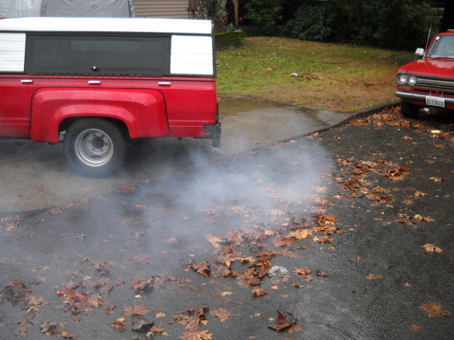

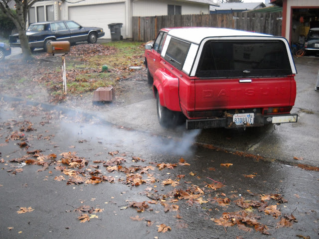

Does it smoke like this engine?
http://nissandiesel.dyndns.org/viewtopic.php?f=4&t=3848
The head appeared to be fine on this engine even though it smoked something terrible when I started it in the morning when it was cold, it also had this funny smell all the time even after warmed up and it didn't smoke so bad anymore.
I believe that the SD25 and SD22 have different heads, I don't know if they interchange, they might but I don't know for sure.
The thread about the engine above, I overheated this engine.http://nissandiesel.dyndns.org/viewtopic.php?f=4&t=3848
