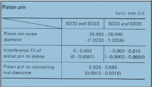

One of the cylinders in my sd22 has low compression. Pulled it apart and am doing a refresh of the pistons, rings and liners. The OEM pistons have the steel insert supporting the first ring and was hoping to reuse them. I measured them at 2.756" from the piston crown and they were all within the wear limits. Actually surprising as the machining marks were still visible. One of 4 pistons have a crappy small end bushing in the end of the con rod and so that can be dealt with. But I also noticed that the piston pins move in the piston bosses. If I look a the manual it says there is an interference fit and that you have to heat the piston to 80 degrees Celsius to get the pins in. I can tap the pins out with a hard faced mallet and they have a place where they can move easily within the boss. With 0.0001 thou maximum interference is this usual to see the piston pin loose. If so is it reasonable to reuse them or are they at risk of ? I would measure them but I don't have anything that measures to that accuracy in an inside dimension as it is unlikely that the pin is worn but the piston is deformed. Chinese pistons look like the next course of action, or could you get the pin plated and the piston honed to restore fit. I would like to retain the steel retainer as I was thinking of fitting a turbo, or at least playing with the idea of it. Any knowledge would be much appreciated.

I would mic the pins just to see, but I think your correct that the pistons are starting to wear. You may want to check your rod length too, or put a dial indicator on the deck and see that the pistons are all coming up to where they need to be. I think there is a spec on that somewhere.
No process that I know of for putting sleeves/bushings etc into the bosses. Your likely stuck having to get pistons and pins. They usually come as a set. If it was going back naturally aspirated I might roll the dice on them as they are, but being as how you may add a turbo not sure how long they would last. IMO that is.
