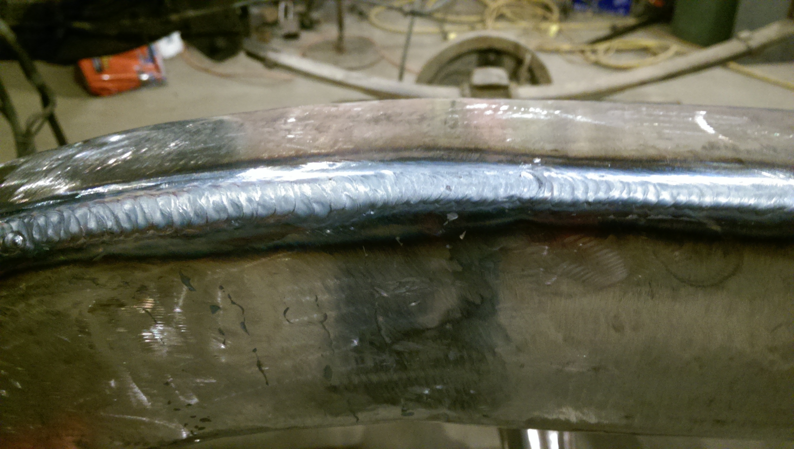

ya that would lead to quappelle valley i guess lol. I have many updates since then! doing that river crossing looks like spelled the end of the rusty frame rails haha
broken frame
broken frame

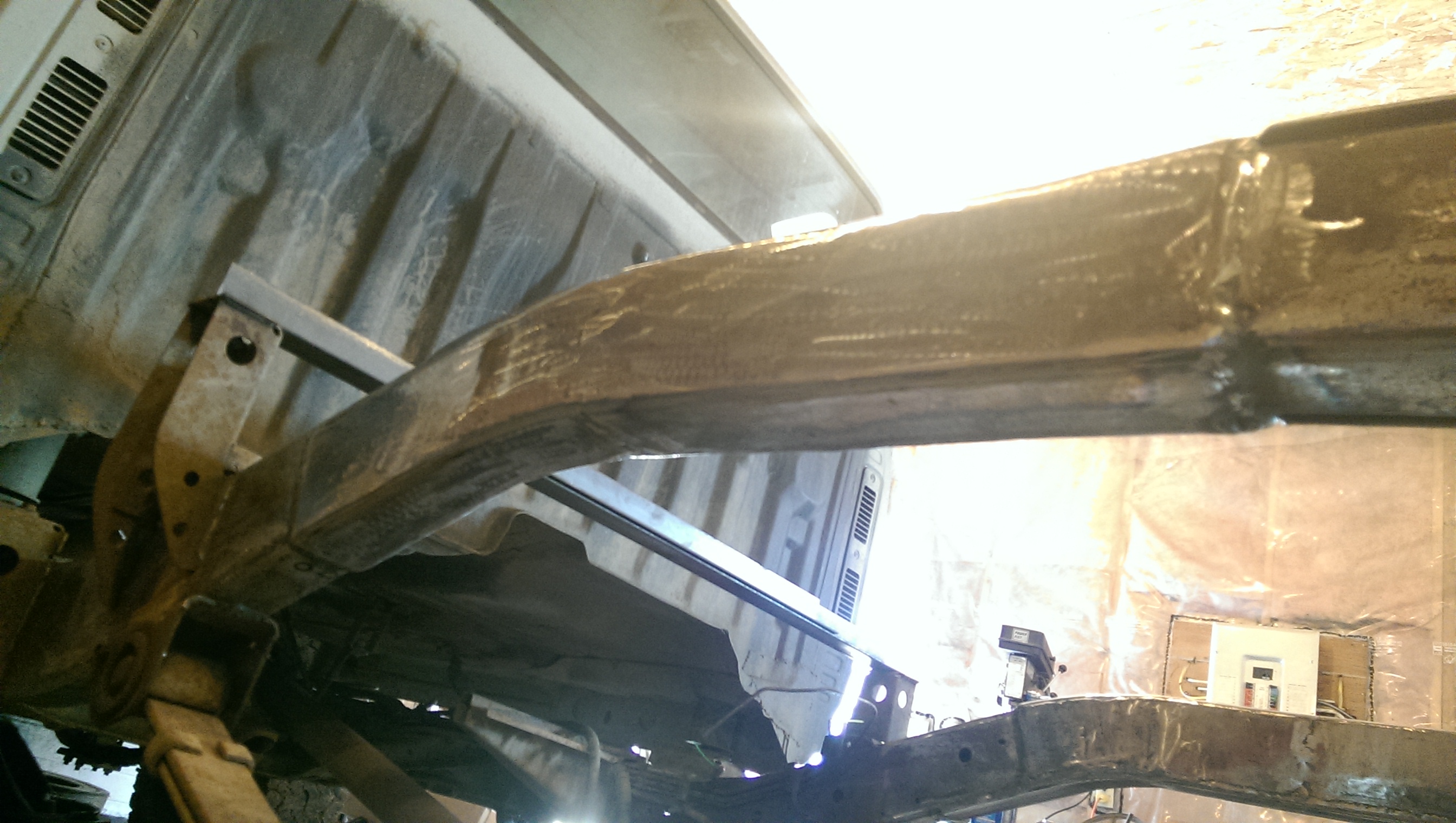

#83
Post by ehtrain »
used some 3x4 rectangle tube and cut the seem out
