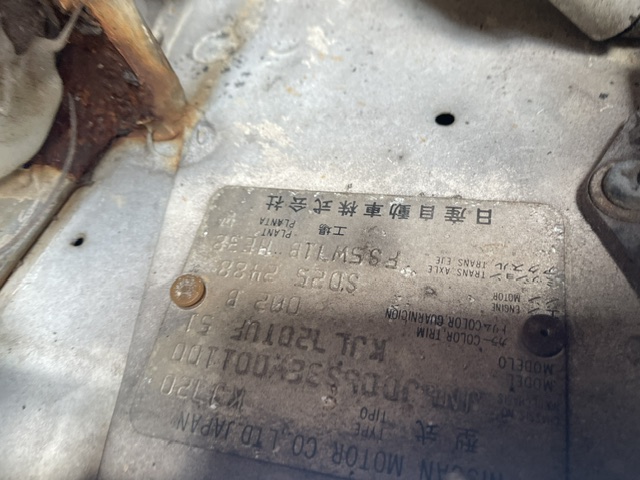

OK, I'm learning. I discovered that the truck came factory with an sd25 diesel. The old man swapped the engine to an sd22 because the sd25 blew up. He rigged his own glow plug system, which wasn't working properly and added a manual shut off. The reason it wasn't starting was because the injection controller motor was never hooked back up and the pump was always in the run position. The problem is, I think he swapped the sd25 controller onto the sd22, and the rod is not long enough to reach it. That is why it was never put back on. (This is all my theory of what happened to the truck.)

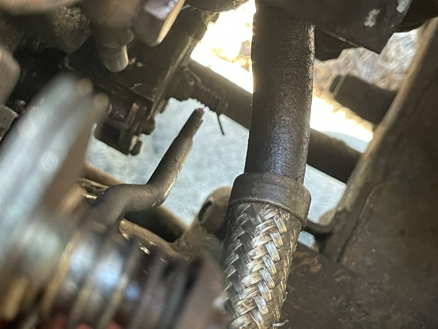

So, am I missing something, like another piece at the end of the rod that connects to the injection pump controller? Or is it the sd25 controller and the sd22 rod is not long enough?

Raptor6717 wrote: 1 month ago OK, I'm learning. I discovered that the truck came factory with an sd25 diesel. The old man swapped the engine to an sd22 because the sd25 blew up. He rigged his own glow plug system, which wasn't working properly and added a manual shut off. The reason it wasn't starting was because the injection controller motor was never hooked back up and the pump was always in the run position. The problem is, I think he swapped the sd25 controller onto the sd22, and the rod is not long enough to reach it. That is why it was never put back on. (This is all my theory of what happened to the truck.)

A compromised diaphragm can be a big issue, the engine can try to run away(rev uncontrollably), this is not good, my 720 diesel truck did that once to me but I could not figure out why, it never has done that again since and that was years ago, maybe the throttle got stuck and has never did that again, I was standing on the brakes slowing it down and things got better.
As for the rods, I have seen/own rods that do not work as they appear to be too long or too short, one of the symptoms for me has been the engine will not shut off or it will not start, the arm on the injection pump is adjustable, but keep in mind that even the smallest adjustment can cause the same issues, it will not start or it will not shut down, I just went thru this issue, my fusible link was not making good contact, the battery was not charging properly and the battery got low, all of a sudden it would not start, I had to remove the arm to start the engine, this was new, by that time the battery had only a couple more starts before the starter would not turn the engine over, I charged it, but before that happened I had adjusted the injection pump arm so it would start, it would not shut off after that adjustment.
