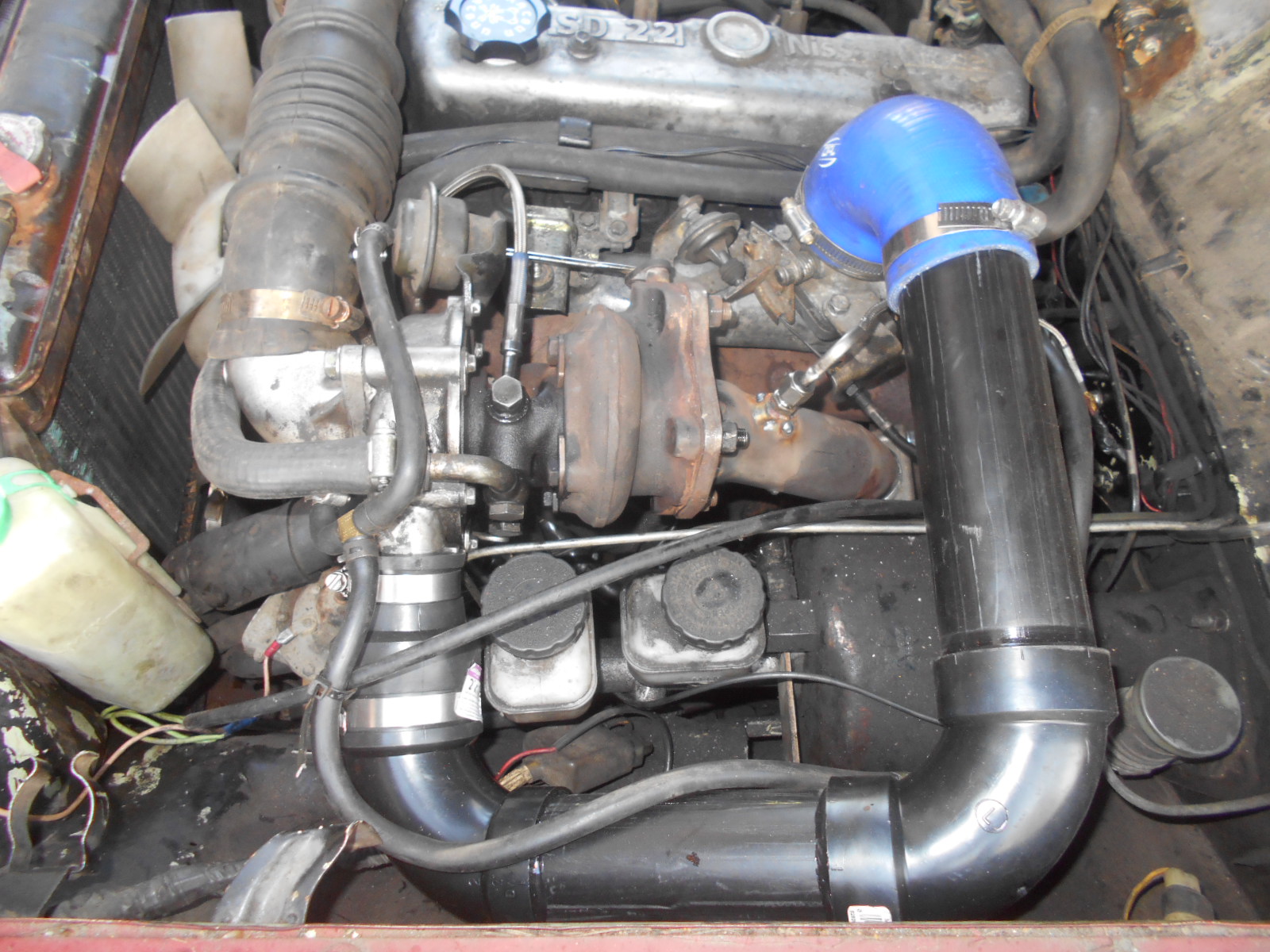

In my case I have a lot more to deal with as you can see in the attached photo below, I have to remove the alternator to even get to the starter thru a hole below the turbocharger, it takes half a day or more to R&R the starter, not something I look forward to.
