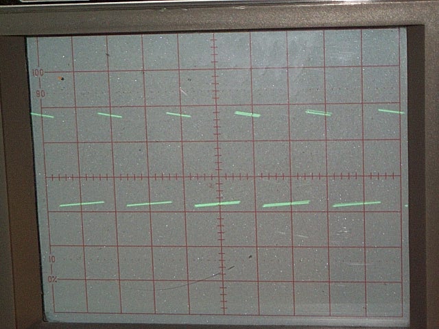

By far, the most common problem we see with the CC is cracks/leaks in the small vacuum lines. Doesn't exactly sound like your problem, though.
In the shop, I'd diagnose this by putting a portable scope on the speedo sensor head wires and running it on the lift, seeing the waveform and frequency coming out of the head. Is your needle steady? If the speedo cable is introducing frequency shifts up and down (binding cable = wobbly needle), the CC works erratically.
I can see a vacuum leak making the rig's setpoint fall from where you set it, but not the reverse (set at 55, car accels to 60).
If the frequency of the signal from the sensor in the speedo head is steady, and the lines are not leaking vacuum, I'd go for the ASCD controller. Haven't (yet) heard of a bad ASCD controller or sensor. Maybe yours will be the first.

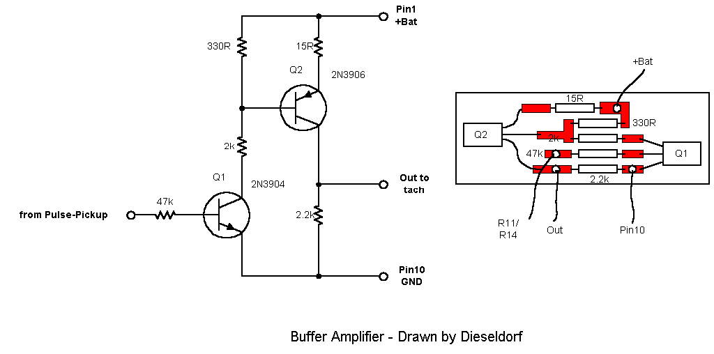

I hacked the EGR Control unit and reverse-engineered part of the schematic.
The control unit has a two stage VR-Sensor amplifier, among other circuitry.
At the amps output, there is a nice 10V square wave signal available. I thing the signal could be used as-is to drive a engine-tach. Since the IP pulley has 6 holes it will deliver 3 pulses/crank rotation. Thats exactly whats needed for a 6-cyl. engine tach. Further experimentation is needed. A two transistor amplifier may be used if the tach is loading the circuit to much. Most of the parts used in the control unit are ready available or may be substituted. The T1 transistor, is a general purpose NPN and the IC1 chip is a Hitachi general purpose quad-opamp. That chip is kinda hard to get but may be substituted with an LM324. I will use this circuit to build my own GP and EGR control unit. I will post/edit more info as available.
Here is the circuit, click on the image to re-size:
Update:
despite the fact, that the IC1 output has about 650 Ohms output impedance and would drive a tach directly, I added a simple two transistor buffer circuit for safety reasons. This buffer will not affect (load) the rest of the EGR circuitry and is short-circuit protected.If anything goes wrong with the tach connection, it will not damage anything. With close to 100mA@12V output, it will drive ANY tach.
The pics above shows the diagram and layout. To build it, I used a proto board from Radio Shack. Cut off a piece from it so the final size was 1-7/8" x 5/8". That small PCB fits inside the EGR controller plastic case. As shown in the diagram, there are 3 connections to the main module. The power connections were made directly at the main connector. Pin1 is the B+ and pin10 is GND. Pulse pick-up wire is soldered to one leg of the R11 resistor, where it connects also to R14 and pin1/IC1. The tach output wire is fed through a small hole drilled in the plastic case, next to the connector. I insulated the bottom of the PCB with insulating tape and inserted it in a small plastic bag.

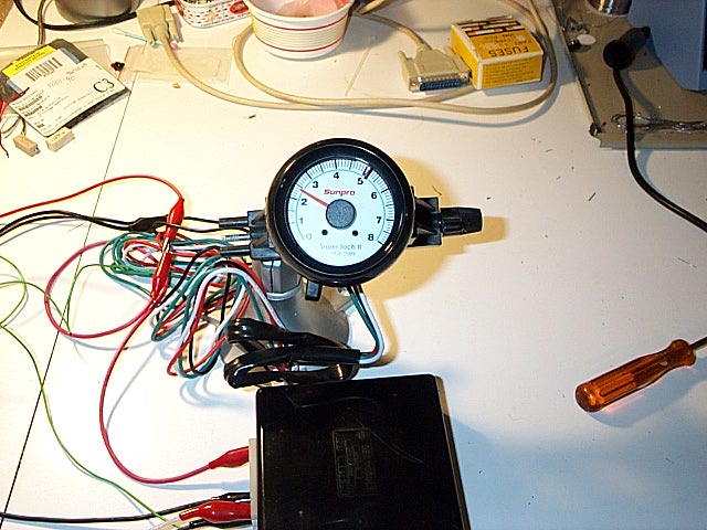

I used a SUN-PRO super tach II ($27.64 @ Amazon.com) to test the set-up. A 120Hz 200mV sine wave from a generator was providing the speed-sensor signal. As seen in the pic, the tach shows 2400 RPM, exactly as it suppose to be. Buffer-Amp Diagram PCB with connection wires PCB bottom side Buffer output signal 12Vpp Tach connected to EGR unit Tach displays the correct engine speed, success!

Great work, Chris, and even better: the pictures and recipe!
A single-page printable version of the things I want to know while fabricating (click on it for the larger, printable version):
From the scale, I assume that the resistors are generally 1/4W?
Going by the size, is the "15R" resistor 1/2W?
For others, since I just had to go look this up, I'll contribute that the resistance value suffix 'R' indicates nothing in this case, so the resistor on the collector of Q1 labeled "330R" is 330 ohms, and the one on the emitter of Q2 ("15R") is 15 ohms. I have not seen the 'R' notation suffix before, but then I rarely had the opportunity to diagnose equipment with the benefit of actual schematics or official test points, and I am well out of that field now.

all resistors are 1/4W, including the 15 Ohms. I used 1/2W because that's what I had in my inventory. The R labeling is now internationally used and means the decimal point. A 3.3Ohm can be labeled 3R3 and so on.
