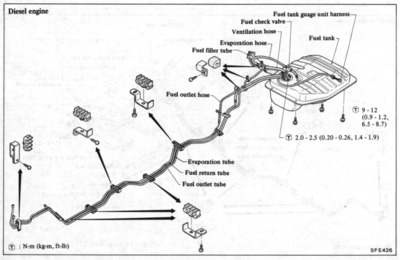

My '82 Wagon has the same. From the '82 FSM, page FE-6 (Wagons):
If you click on that and look at the fuel lines ends, you'll see
If I had Nissan FAST loaded here (the 'doze box broke here, I may not fix it), I'd see what the hose diagram has to say about it.
Yeah, it's a fuel tank vent line. Though the FSM calls it an "Expansion hose" and what they call the "Ventilation hose" runs to the top of the filler neck.
- The tank's vent line goes to hose;
- To a short section of nitrile line;
- Fuel check valve (probably a liquid/gaseous check, so no liquid departs);
- Nitrile line;
- Steel line to the firewall (it ends short of the other two lines, where they go forward to the fuel filter area);
- Nitrile line again;
- Steel line to left frame rail, loop down, back to right rail area;
- Nitrile line;
- Steel line into right frame rail.

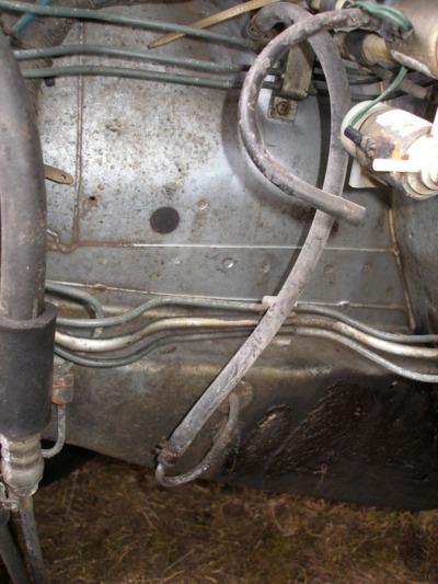

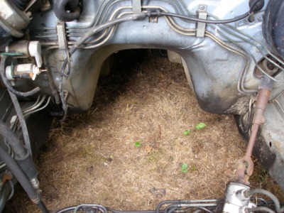

I took some pics today of the '81 Wagon in Mark's backyard. In the first pic, you can clearly see where the steel line from the tank end ends, and the connection to the steel line loop to the left frame rail area (right side of the pic) and back to the right frame rail.
The second pic shows the transition from the steel loop line to the right frame rail line that disappears.
