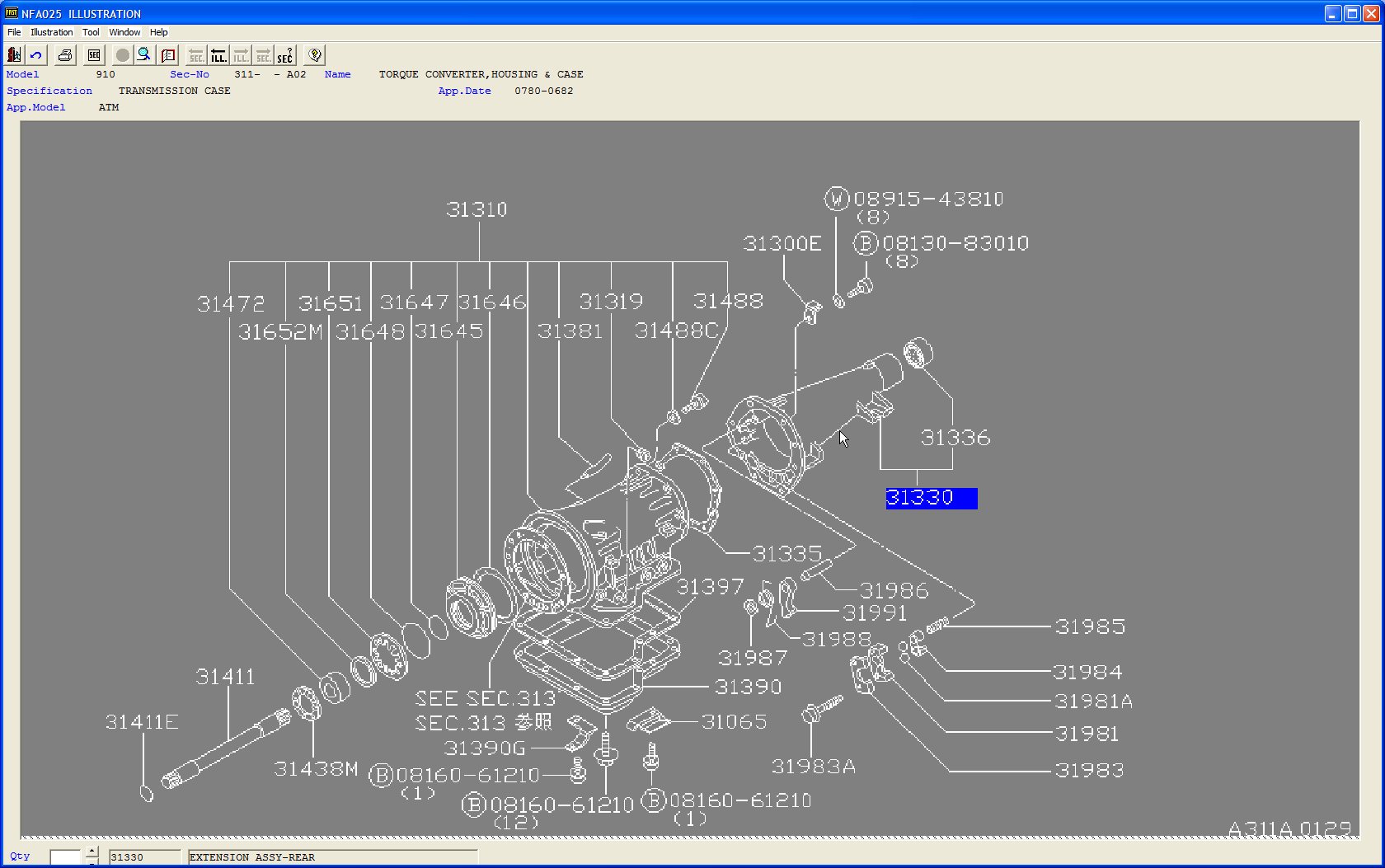

The 1981-82 extension housings are the same, gas & diesel. 1983-84's are different, though.
1981-82:
1983:
Notice how much longer the '81-82 extension housing is? When the OD section was added in '83, they shrunk the extension housing to make it all fit in approximately the same overall transmission length.
I have three of the later ones, but no early ones.
