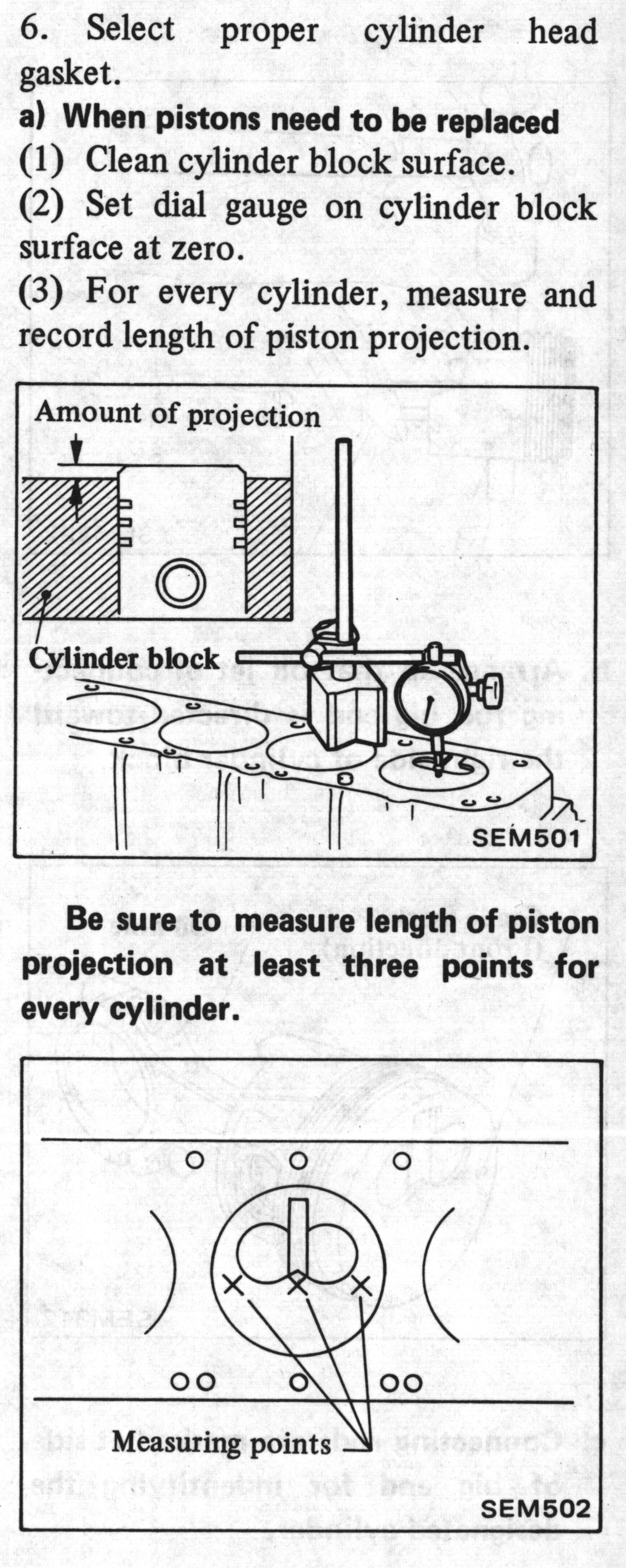

There's a couple of things going on WRT head gasket thickness.
- Compression ratio
- Combustion chamber squish area
- Piston and carbon can hit the head or the end of the pre-combustion chamber
- If the deck or head is shaved, the cam timing will be retarded
- Single notch = 0.0441"
- Dual notch = 0.047"
- Triple notch = 0.0504"

Thanks Al, that is the criteria to determine head gasket thickness. Do you agree that in production slight tolerance differences in the engine blocks is why these engines required the different head gasket thickness's?

When we're talking .004" being enough difference to warrant a different gasket, I'm not sure just where that variance comes from. I'm assuming that the deck height to crankshaft centerline distance versus the connecting rod centers plus gudgeon pin to piston crown is the variance in production, and honestly I would not have thought that in 1980 that this would add up to a range of .008" and would need three gaskets to adjust for.
I'm thinking that perhaps most were shipped with the single-notch (thinnest) gasket, and that if the block was ever decked (increasing piston projection) that the other two thicker gaskets were available to bring the combustion chamber volume back in spec (and keep the cam timing closet to spec).
That may also partially explain why only the single-notch gaskets are likely available now: the most used for a simple off-n-on head R&R.
