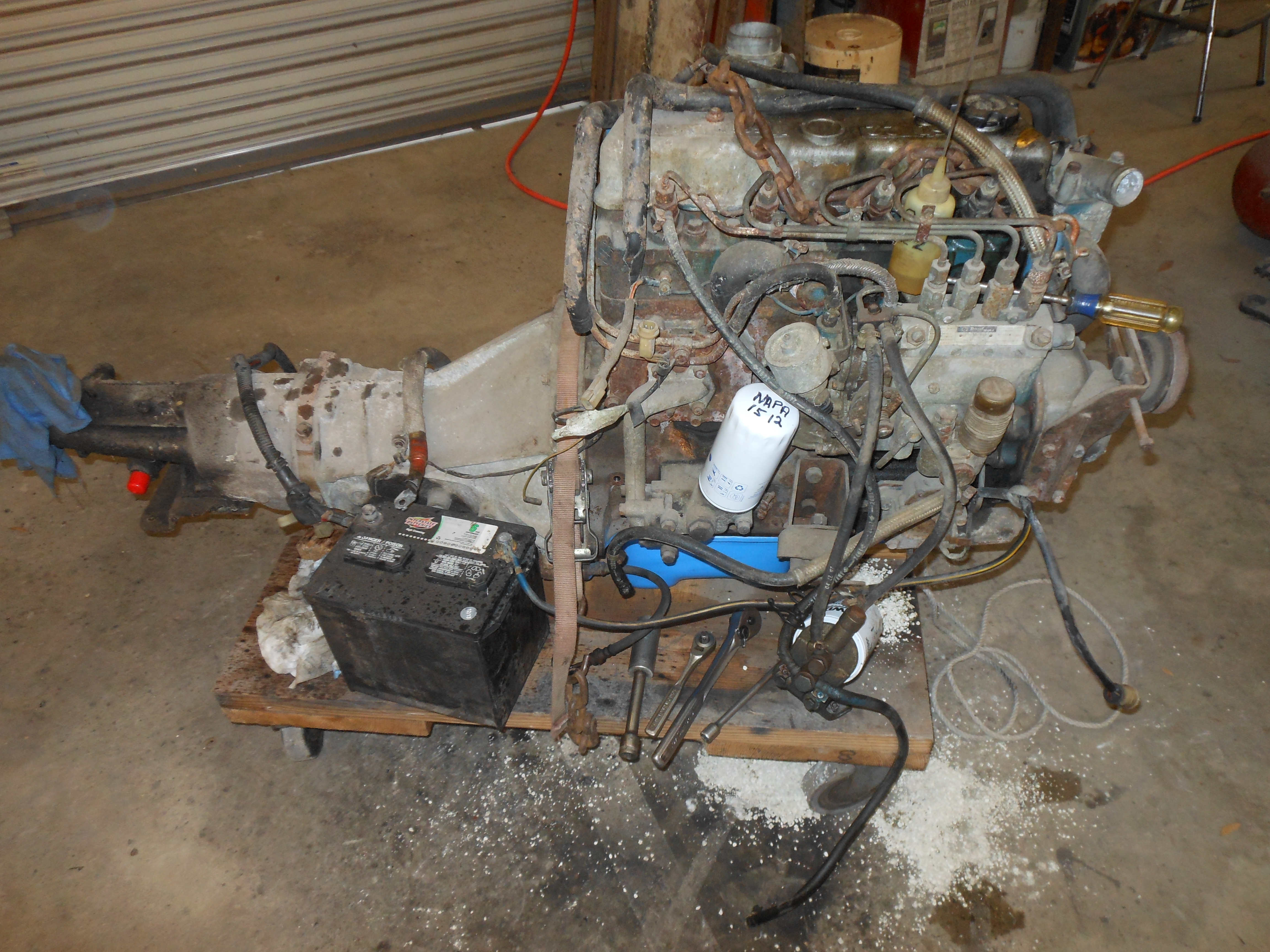

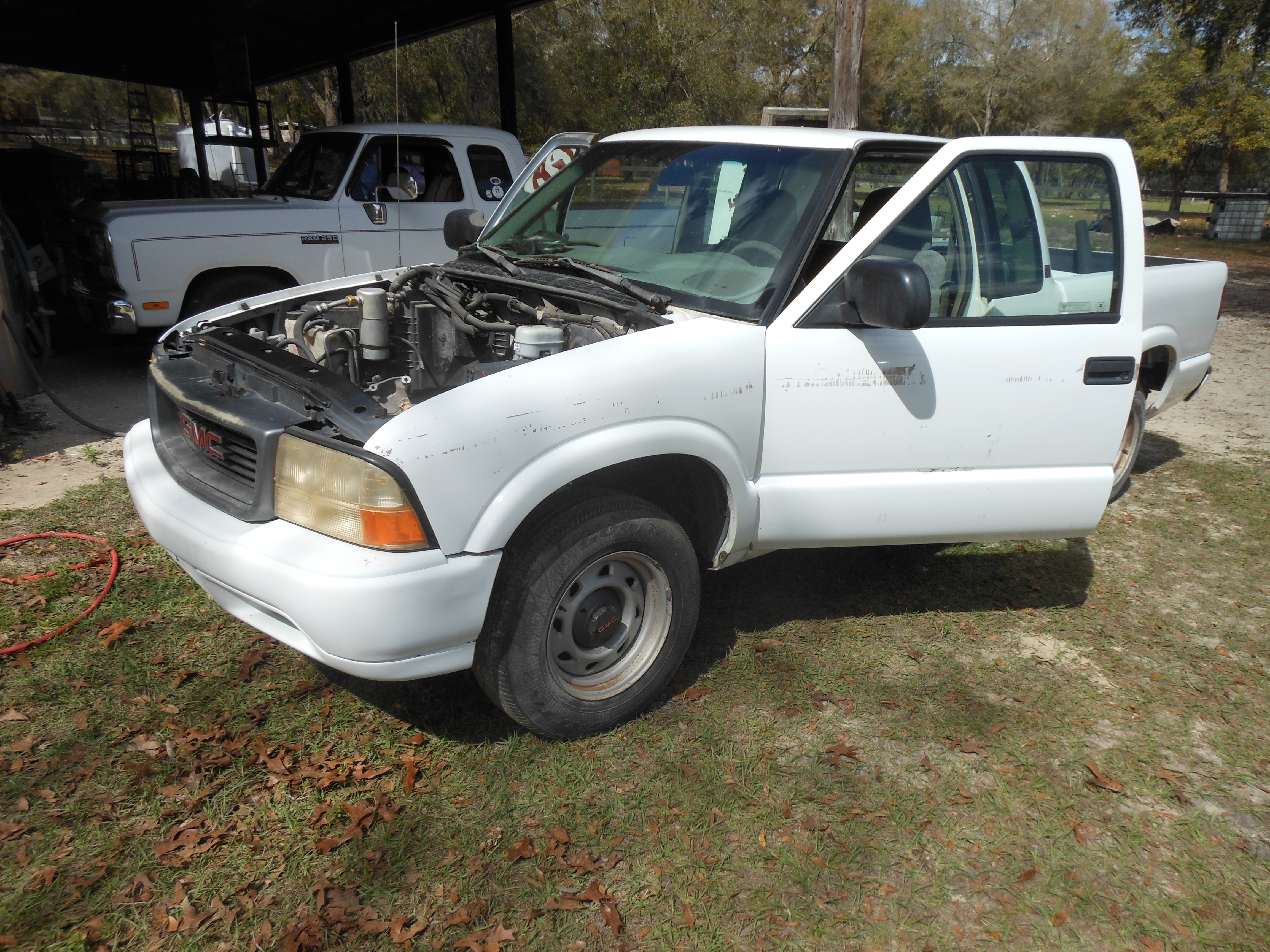

Yup, I am aware of the run away issue. I have a piece of light plywood ready to block the intake. I picked up the NGK 1232 glow plugs and will check out the Chrysler/Nissan type for later use. I have them installed but it got late and I will try to crank it sometime tomorrow. I have a tandem trailer to do seals and
bearings on in the morning. I am looking forward to seeing smoke and fire out of this thing. I connected with a Nissan mech at the local dealer who looks as
old as I am and speaks of a number of transplants. According to him, I should consider putting a small Kabota turbo on this engine. I have thought about this
very thing. I will have to look into something that will get me no more than about 10 lbs of boost. Anyway, First things first. If anyone out there can put a
degree gauge on the block of your truck I would like to find out the degree of angle through the drive train to the rear end. I couple years ago I got done with
a 32 Ford extended cab street rod pickup and have the angel at 5 degrees for the old 327 and the five speed stick in it. I am trying to post a pic of the engine
and the Sonoma pickup that I hope will be the engines new home.

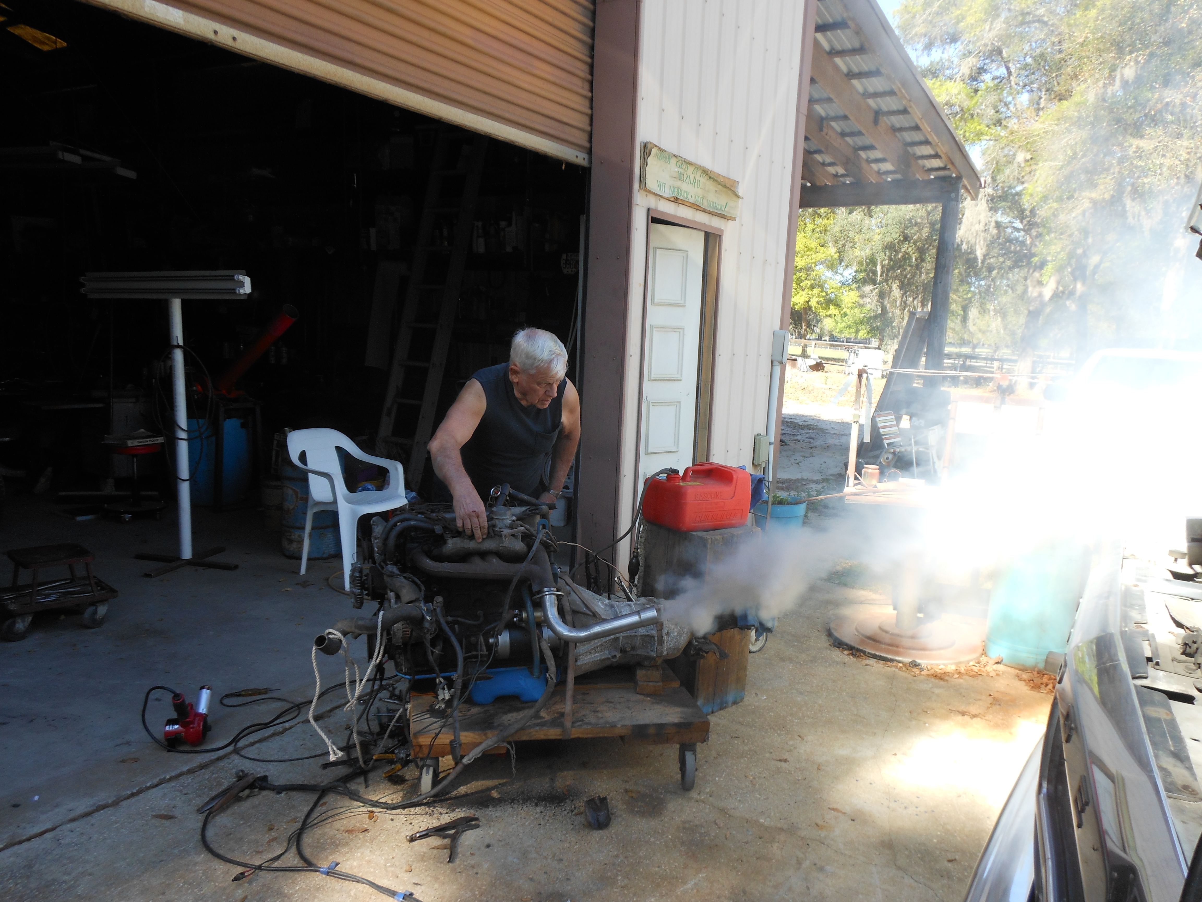

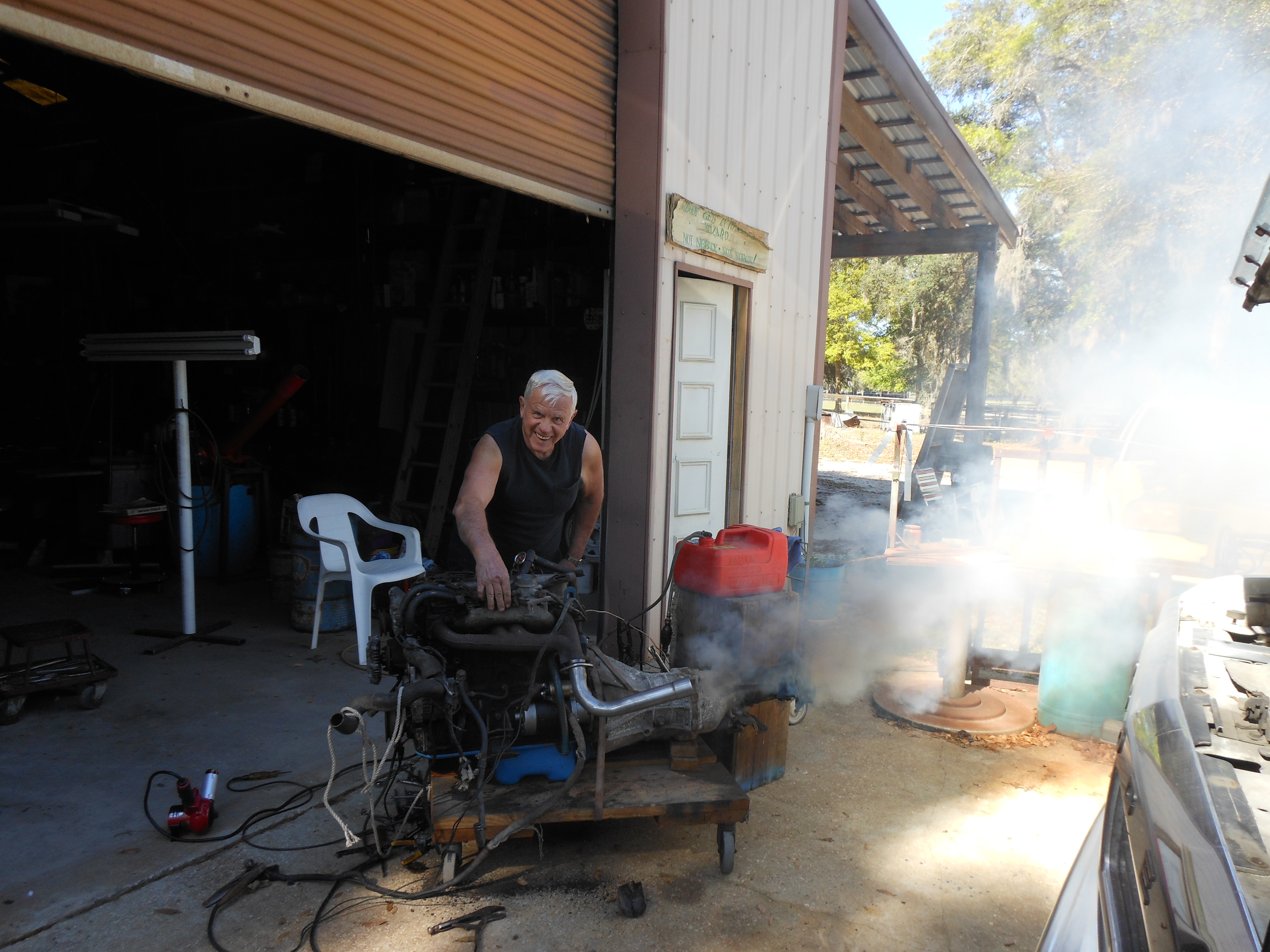

OK, Here we go again.
Finely, I got smoke and FIRE. This afternoon as soon as the back yard temp got right I went out and got everything hooked up and with the new glow plugs in I hit the switch. It cranked a bit and lit up. Once running it did not hesitate or burp at all, it was firing on all four.. When I hit the throttle I was surprised at how responsive it was. When you check out the pics you will see the smoke and a big grin. Again I am glad you guys are hanging with me on this. I sure value your feed back. I don't know what rear is in the Sonoma yet. I do know it had a 4.3 V6 with an automatic. So it will be a tall rear for a manual 5 speed. When I go to the junk yard for the clutch linkage I am going to check to see what they want for the rear that is in that truck. When I was building my 32 Ford pickup I used a ford (273 ratio) 8 inch rear out of an Mavrick which had a 289 with an automatic. A whole bunch of people told me it would never work. That the rear was too tall. That I would always be slipping the clutch. Being an old coast to coast truck driver from back in the day, I wanted to have tall gearing in order to run the highway without having my old 327 cranking its guts out. Well, all those guys were not too good with their assumptions. My 327, Chevy 5 speed and the 273 rear work perfectly ! ! ! I could not be happier. Even with the flat front and flat windshield I can get just over 18 mpg while cursing at about 65 mph (as long as there is no head wind). We will be taking the 32 down to St Petersburg, Florida this Saturday to a car show. Oh, by the way, it will not be going south on a trailer. Wayne, do you know why there are different lengths of control rods? I would have thought they would not differ for the same engine (SD 22) ? ? ? If you guys have a chance to measure the length It would help me in making one. Wayne, With all the problems I see you having with the turbo, I think I will just leave it alone. Eighteen years ago when this Datsun was on the road I drove it with and without loaded trailers and it never heated up. I am in hopes of using it to pull a my ultra light camper so I am not going to mess with it. As long as I get the gearing right I will be happy with it. Happy Saint Pattys Day.

Re: Need help with not being able to get fuel to injectors.
All three pics are worth a thousand words! In that second pic you definitely have a great big grin on your face. It is really good to see that you found the right combo to get it started.
In the morning I will try to remember to measure the rod on the control motor. I'm assuming you have the control motor, just not the rod that goes between the IP lever and the control motor. I was able to get the control motor to operate all three positions/stops for the IP lever.
Initially the control motor wouldn't stop reliably at each location. I used a rotary double pole switch and some information about the control motor wiring/testing I found to wire the switch. I recently found a whisker from one of the stranded wires was sticking out where it had been contacting another wire. As soon as I removed that whisker the control motor stopped correctly at each of the three positions.
Now that I have the control motor operating as it should I am going to get a four position ignition switch and see if I can get it to operate the control motor properly. The switch positions needed are 1) off (motor and vehicle not running), 2) accessory (stop position on the control motor), 3) run (will be run for the control motor and IP), and 4) start (will be the over-inject for the IP). We will see tomorrow just how much rain we get (forecast runs from 55% to 90%). if it isn't too wet I just might do some junk yard hopping to see what I can find for an ignition switch.
