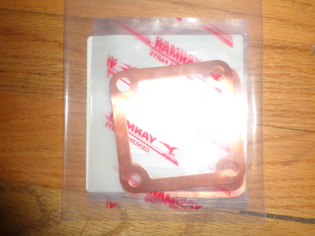

My copper gaskets came today, now I am waiting for the straight rubber turbo piping I ordered as I don't have any more that size.

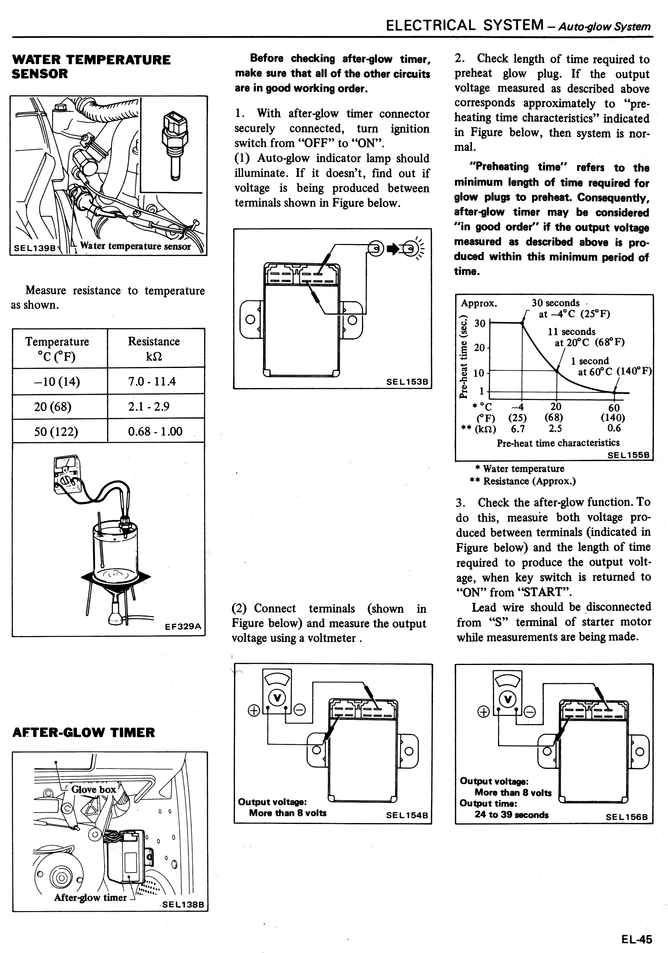

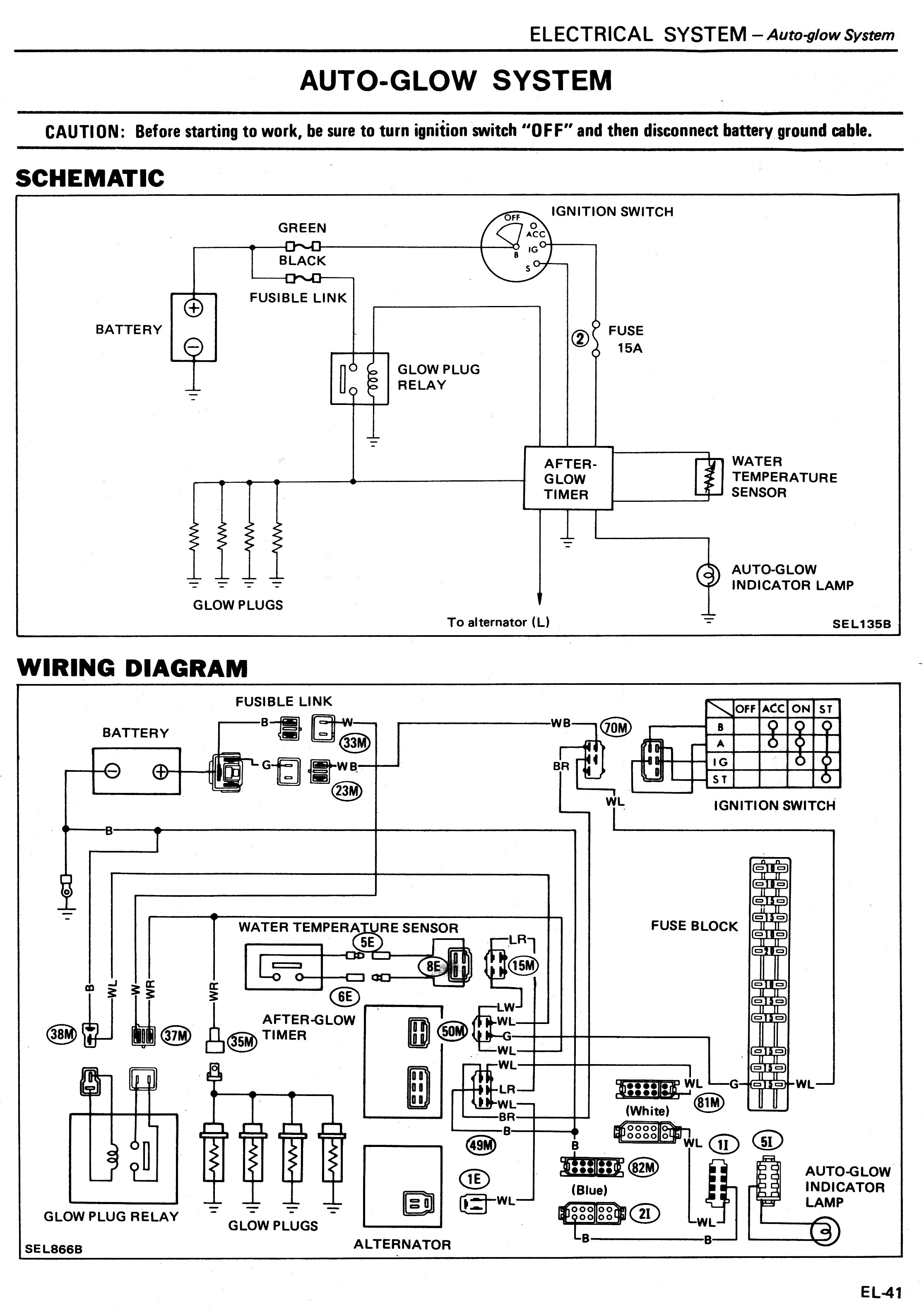

Years ago, I scanned the entire Electrical section of the 1982 Datsun 720 Pickup Factory Service Manual (FSM), and put it online for reference when discussing this kind of thing. Refer to pages EL41 & EL45 of the 1982 FSM, EL41 GP system schematic:
In that section of the FSM inclusive, the GP controller (located on the right upper kick panel, and for some reason called the After-Glow Timer by Nissan) is shown to control both pre-glow and after-glow functions. Nissan reuses a lot of their diesel technology. On my '83 Sentra diesel, the afterglow relay had failed, and I installed another relay to fix the GPC. Having my own dash indicator to show me what was actually happening at the GP bus -- as opposed to the OEM GP light, which is fun and all but isn't really telling me what the GPs themselves are doing -- helped a lot with that repair.
The OEM GP system is a good design; the wiring and relays, not so much. I know you guys enjoy the fabrication part of owning your trucks, but you might consider doing some diagnosis first.
I checked three FSMs just now (1982, 1982-83, and 1983), and none of them specify the exact time you're to test for:
[Paul: I checked the relevant section of the 1985 FSM, and your truck w/SD25 has a completely different afterglow system, involving a dropping resistor and a separate relay; it runs your GPs at a lower voltage constantly for afterglow, instead of cycling them after the engine starts or while cranking or whatever the SD22 after-glow system does.]
I must have given away my Sentra diesel FSM, so I can't check it for after-glow time specs. However, it's clear from the above that the system is supposed to after-glow. In my Sentra, it didn't due to a definite relay failure. It would not surprise me to learn that the after-glow relay in other Nissan diesels of that timeframe suffered similar failures. We know the one in Philip's 720's DPC Module sure did.
Without those time specs, it's kinda hard to test, ain't it?1982 720 FSM EL45 wrote: " . . . the length of time required to produce the output voltage, when the key is returned from "ON" to "START" . . . " [starter wire is disconnected for this test! ALS]

The Glow Plug Controller (GPC) on the 720 diesel is on the right kick panel, adjacent to the glovebox. See the FSM manual link I posted. It requires its own head temperature sensor, the location of which is shown in the FSM and is right next to the water temp sensor for the dash gauge.
However, there are aftermarket GP controllers too. You have to match your GPC scheme/setup to the type of GPs you're running. The SD25 84-on appears to have used fast-glow GPs (can burn out if left on too long; they are various voltage-rated, like 6v). The GPC for this type of GP runs 12v (nominal) to 6v GPs, which heats them up fast. Faster, that is, than the way GPs worked in almost all other diesels up to that time.
The fast-glow types get hot, fast, then the GPC either turns down the voltage (turn off relay 1/full voltage; turn on relay 2, voltage to the GPs through a big, fat dropping resistor: that's the SD25 system, and my '83 Sentra's system) OR cycles the GPs on and off (ON for two seconds, OFF for five, or similar).
All old MB diesels were the slow GP type for decades, up till around 1980. Same with VW diesels. And the SD22. You could leave the GPs running nearly continuously, and they wouldn't burn out (well, YMMV). But it might take two minutes of pre-glow before you could crank the starter and get the engine to fire.
Once the fast-glow setup was introduced, everybody switched to that system. My '82 GM G30 and my '84 F250 both used the same GPC, with the same afterglow cycling system. A common failure was for it to stick in the ON position and fry all the GPs. It was early tech back then. VW & MB went to the cycling afterglow system and didn't have that problem.
I am guessing you could run either type of GP system on your engines, but the GP and the control scheme have to match.
The intake air heater, AFAICT, was introduced on early DI diesels that have no GPs to aid in starting, and on later diesel engines that needed to be absolutely sure not to cold misfire for emissions reasons. They're not needed for starting, and you're going to need a lot of battery to run the GPs, the intake heater, and the starter all at once.
Think about how Nissan set up the engines for use in all climates. I don't see the intake heater as a necessary improvement, though I'm not saying that it doesn't improve cold idle, but it's not needed for starting. It also draws a lot of amps that you're going to pay to create, it's not free.
If you run SD25 fast-glow GPs, you can't leave them on too long, they'll self-destruct because they're not 12v GPs, they're probably 6v or 8v or similar. I was manually overriding my Sentra's GPC and fried two GPs, twice, by running them 20 seconds instead of the OEM 8 secs. I was trying to overcome a very worn-out engine. I ended up giving away the car, running & driving, because the engine was worn out and the rest of the car wasn't worth another CD17 IMO.

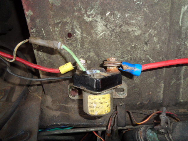

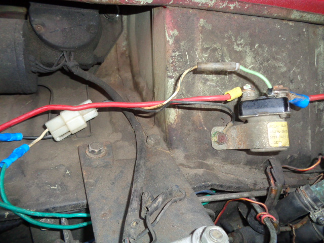

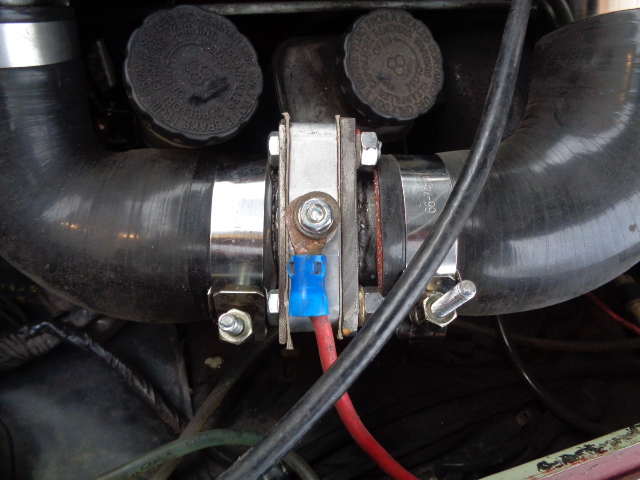

OK, so this is what I did, first I mounted the Air Heater Element in line between the turbo and the throttle body, I used a cereal box material for gaskets when I mounted the fittings onto the Air Heater Element.
Then I mounted the relay on the firewall.

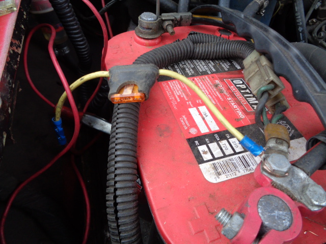

Next I wired the relay to the Air Heater Element and the Battery, I put a 40 amp fuse near the battery.
I also used the relay plug when I wired the toggle switch to the relay.

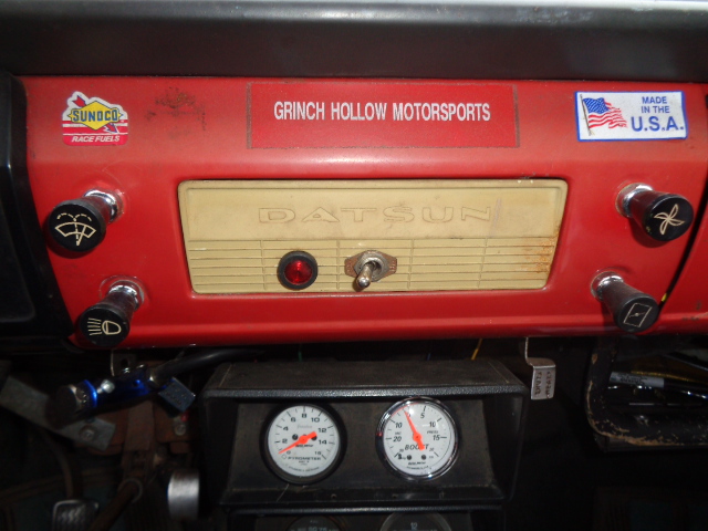

I then ran the wires into the cab(3 of them), one wire is the ground wire for the light telling me when the heater is on, it goes to the ground wire on the relay plug, the next wire goes from the relay plug to the toggle switch, the last wire goes from the toggle switch to a keyed power source, I wired it so when the heater is on the light is on but it is done in the switch, I used the window washer plug in my engine bay harness to power the relay, I did this because that plug has power with one click of the key, it also has power after the second click when the glow plugs also have power, I did it this way so I can warm up the Air Heater Element first, then turn the key one more click to power the glow plugs, then when the glow plug light goes out I can start the engine, then once the engine is running smooth I will turn the Air Heater Element off, the light is fairly bright(red).
The toggle switch and light are in the radio delete plate, the reason I put them there is because I had a radio delete plate with a hole in it for a toggle switch already, I just drilled another hole for the light, I put my good radio delete plate in a storage tub I have for plastic parts.
I started it once when the relay was wired to the battery and Air Heater Element, it was 43 degrees outside and it started fairly smooth, but I need to start it below freezing to know this is going to actually work this way.

I started this engine this morning, it was 34 degrees on my property in my back yard in the shade, there was ice on my windshield that was no where near melting and a half hour later it is still frozen, I powered up the Air Heater Element about a minute before powering up the glow plugs, then I cycled the glow plugs twice and then started the engine, it started right up without any issue, it missed a couple times and then ran smooth, I turned the Air Heater Element off right after it was running smooth, it has never started this easy even in the 40s and that block was below freezing as it was 28 degrees last night and the sun had not shined on the truck yet.
It warms up fast when it starts warming up, in the last hour it has warmed up to 41 degrees and the windshield is now melting and the neighbors roof has thawed also, but it was cold when I started it and everything was still frozen.
The Air Heater Element likely would work better under the throttle body as it is closer to the cylinders and the warm air doesn't have to get by/thru the cold throttle body/butterflies, cold turbo tubing to get to the cold intake manifold to get to the cold cylinders, I am positive closer is better, but when I started it today with the Air Heater Element where it is it started when I would not normally even tried to start it without plugging the block warmer an hour earlier as I have tried before in the 30s and could not get it started, this has made a difference for me.

Using this grid heater here, for me, where I was told "At -10 IT WILL NOT START" to have it start is a plus.

They messed with the coolant temp resistor on the D21 in order to increase "quick glow times" etc and finally just gave up.

There have been no cold(below freezing) days since my last post, the low was 39 degrees last night, it has been abnormally warm lately, we had a high of 62 degrees a couple days ago, and it supposed to start raining this coming week, it is called the pineapple express by the weather people, warm and wet, what it becomes east of the Rockies may be something else entirely, some might call it hell.

I have a spare LD28 GP unit and after-glow resistor for it, if that would work for you. The plug on the resistor is burnt, so you have to hard wire it. PM me if interested.
