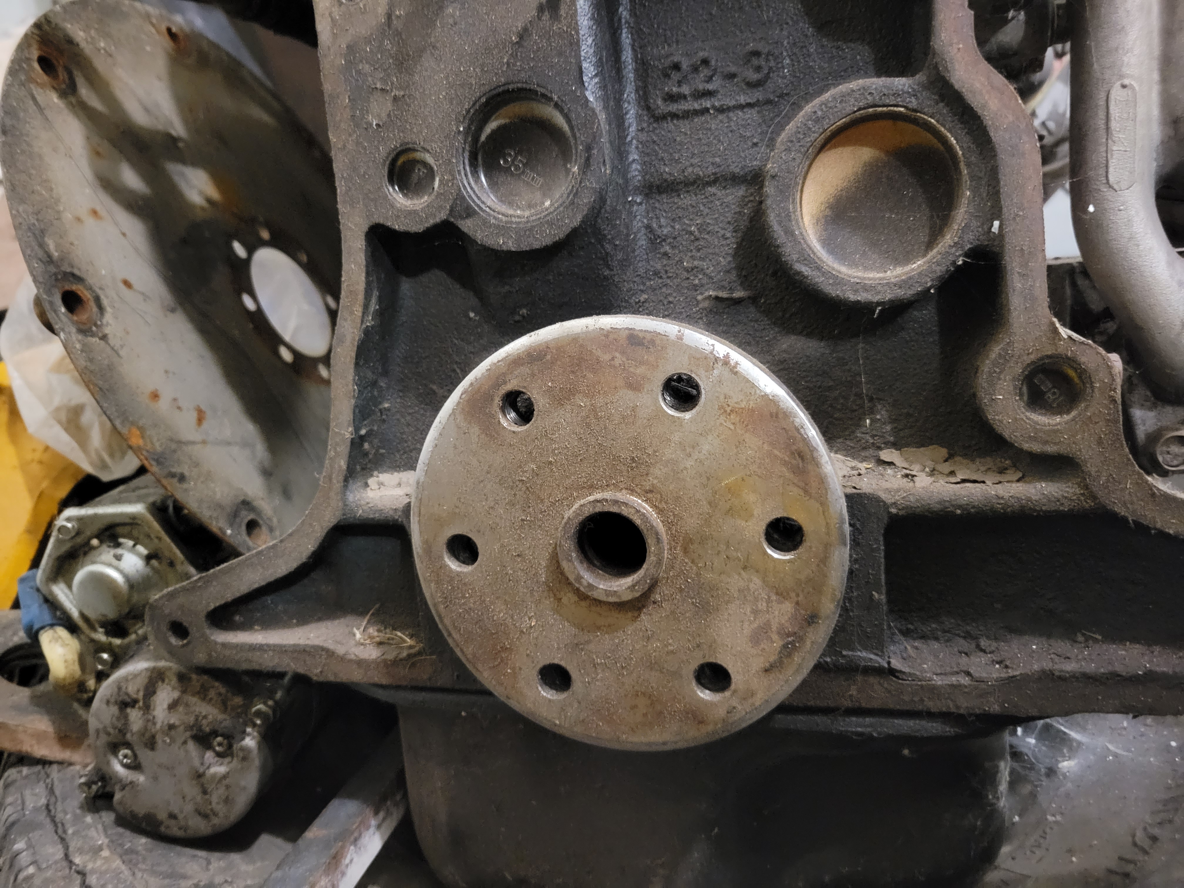

waynosworld wrote: ↑3 years ago Here is why I am confused, the backside of the flywheel on the left is from an SD22 engine, the mount pattern is large, the one on the right is from an SD25, it has a small tight pattern, the flanges on the cranks are completely different sizes.
I know of no way to mount an SD22 flywheel on an SD25 engine, otherwise I would have done it myself, I just checked and it appears I scrapped that SD22 flywheel without the ring gear.
[/quote
That is odd. My engine (SD25) appears to have the spaced out pattern similar to the SD22 flywheel in your photos. It must be something with the special use engines. From what I'm seeing my method may still work. I'll try to post some photos.

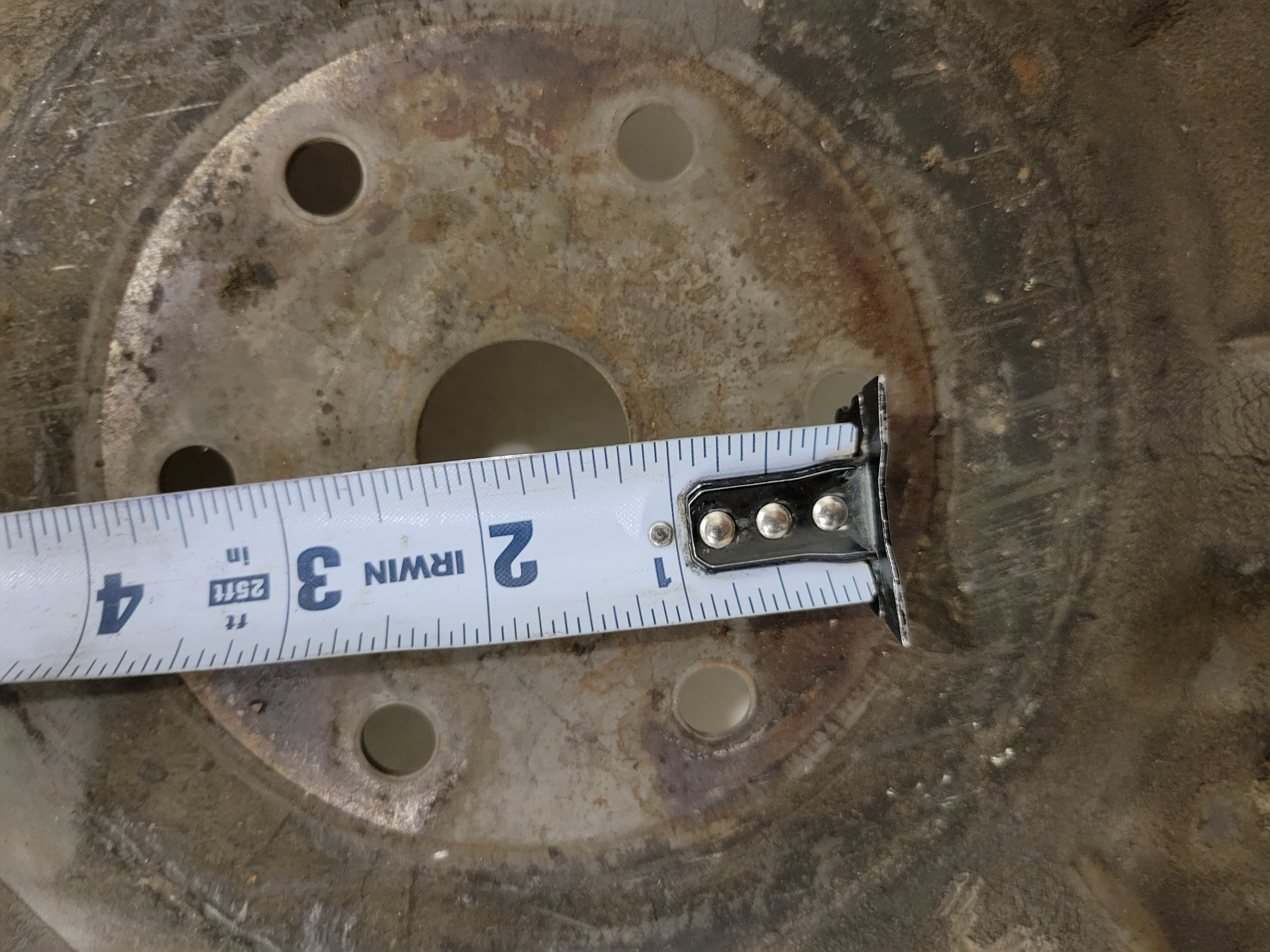

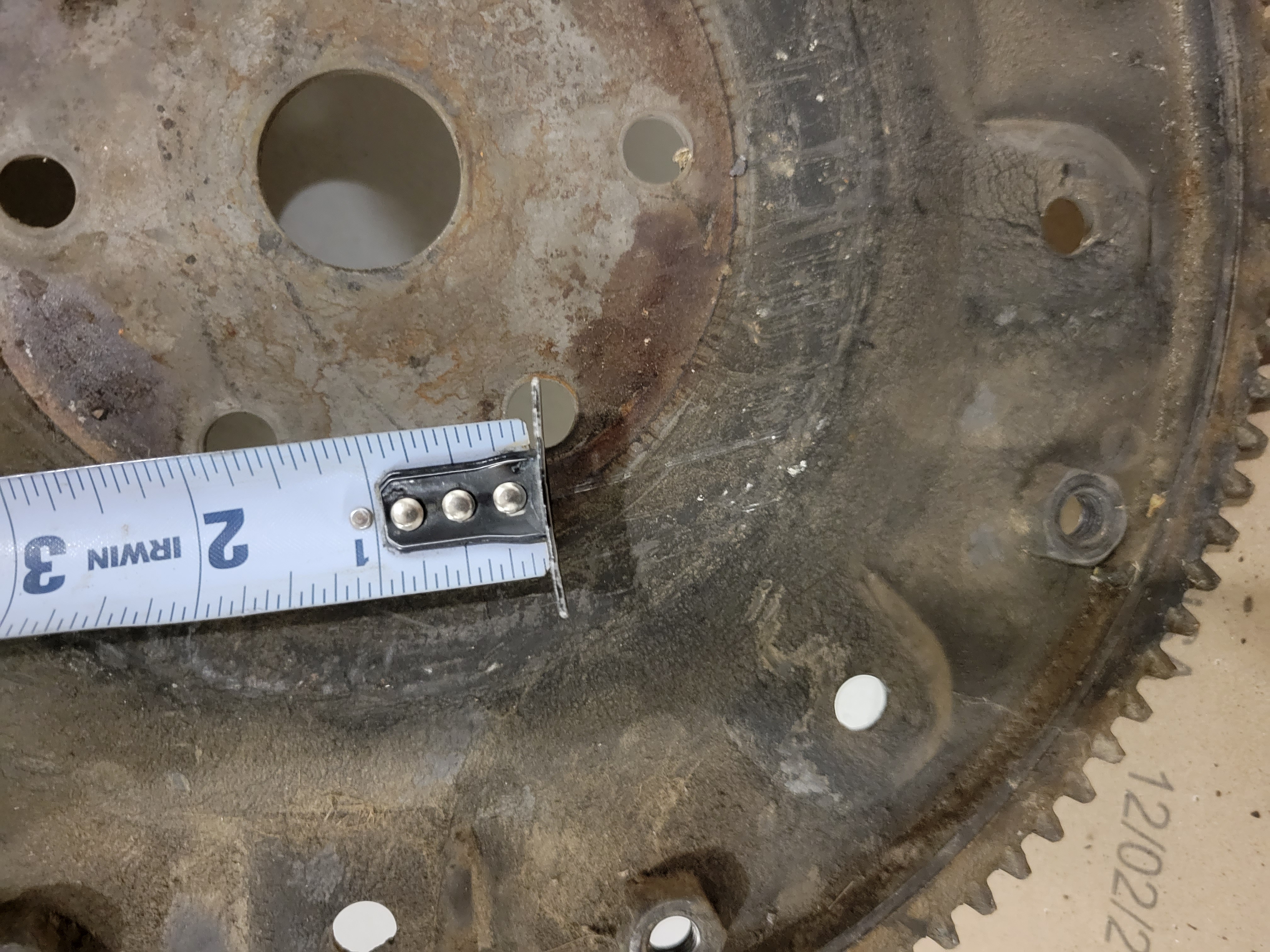

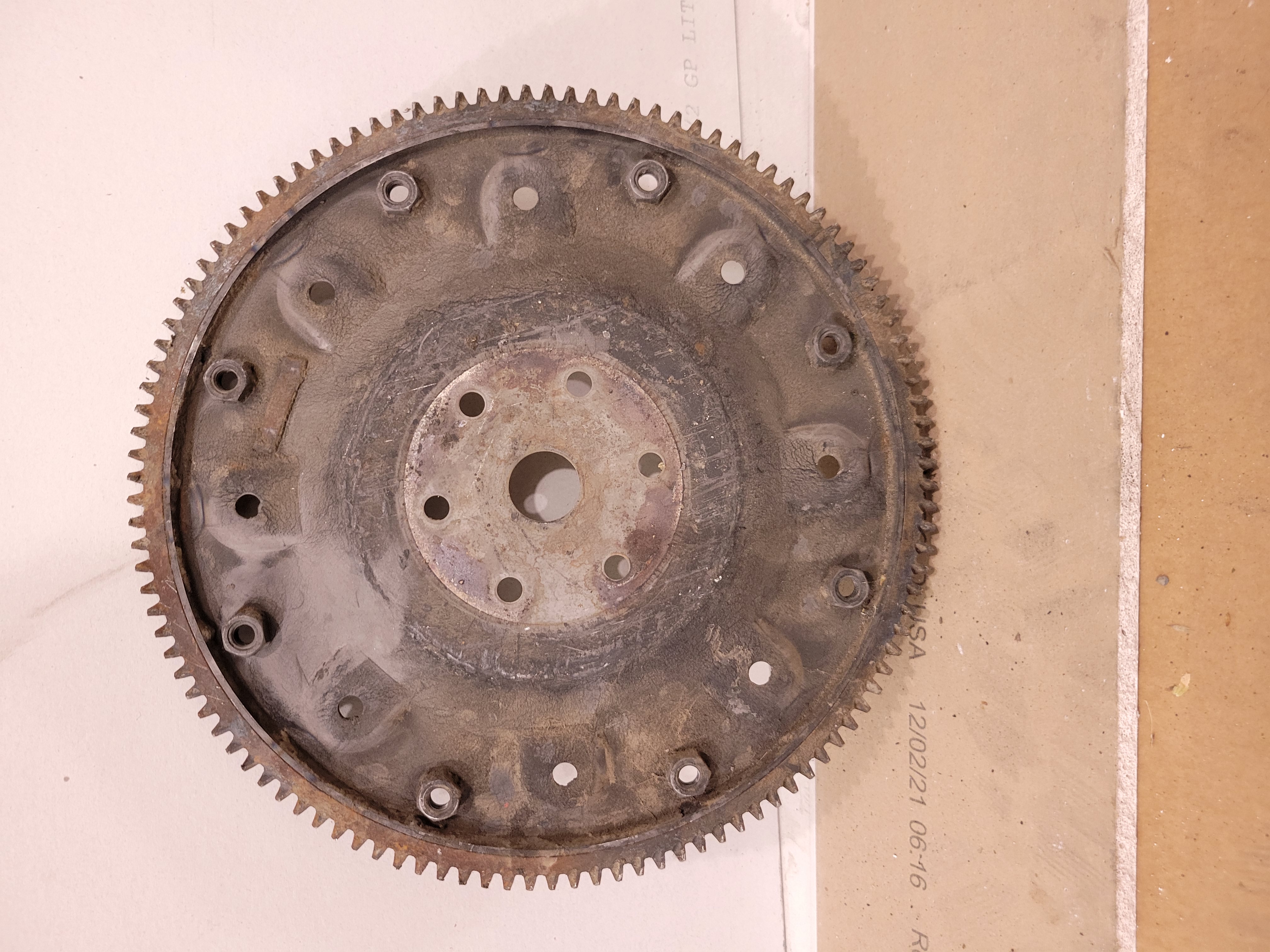

Here are the photos. This is off of a SD25 that cMe out of a Dautsun forklift.

I just read this again, I looked at your reply with the measurements, I am confused yet again, so do you have any flywheel for this engine that will fit, can you use the one you measured?
Your measurements appear to be at angles, yes you centered one end, but the other is at an angle and it is hard to tell the true measurement, I would not send out a part/flywheel without exact measurements center to center including the flange size.
I found an extra SD22 flywheel that appears to be close, but it is an automotive flywheel.
Could you have an automotive flywheel modified to work with what you want to do, if it was taken to a machine shop could it be turned down and drilled to do what you have in mind?

The measurements were just for reference to show that the holes were fairly wide in comparison to the prior SD25 flywheel shown. The flywheel I have won't work for my application. I have been trying to find a Stationary/marine flywheel so I can be sure my housing/starter/flywheel combination will all work together. Trying to make an automotive flywheel work has been sort of my backup plan but it's looking more like the only option at this point.
