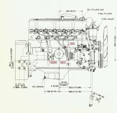

On the picture "I don't know how to upload so I sent it to you Al" I've indicated those 3 reference points. I am a bit confused because you say towards the rear of the engine from the oil level dipstick on.If you locate the oil level dipstick and follow it down to where it meets the block, then move toward the rear and look just above where the engine mounting bracket mates to the engine block, you should see a plug, or a fitting with a plug. Due to the IP injector lines, it is not very accessible from the side, and various coolant hoses run above it.
Can you maybe indicate on the picture where I should look.
Thank you

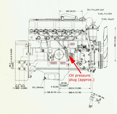

While I haven't seen your picture, it would be nearly impossible to take a picture on one of mine because of the obstructions. If you look between the oil dipstick and the oil cooler/filter mounting, you should see a raised boss in the casting. That is where my oil sender is mounted. Hope this helps.
This is Pascal's picture:
I can see why you're confused: the US-spec LD28 as fitted to the Maxima has the oil dipstick positioned forward of the motor mount, and not back near the starter as shown in your diagram.

Hey I found it!! Thanks
At the location where you point there is a bolt sitting, So there I will install an oil pressure sender with the thread is 1/8" x 28 TPI. I hope that the bolt sitting there has the correct thread and has not damaged the thread of the engine.
