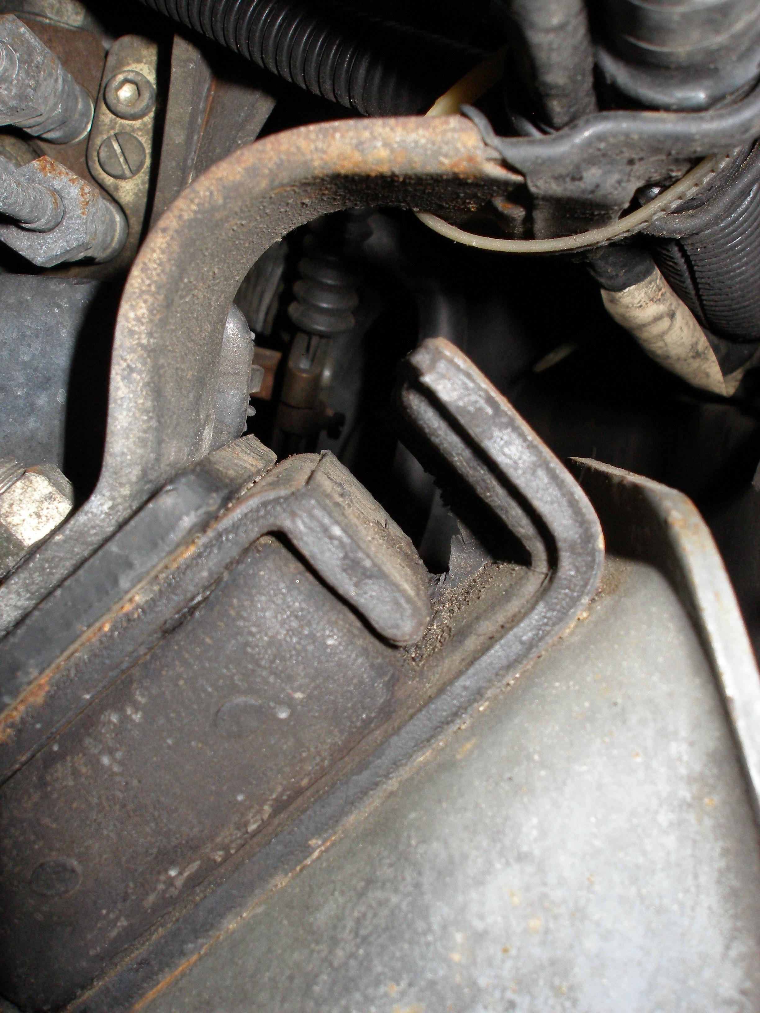

Finally able to get under the car to snap some pics. Could anyone compare to their car and see if mine have collapsed? New mounts are $50 each, special order and I'd rather not go thru all that process unless my motor mounts truly need replacing.
Here is the driver's side motor mount, from underneath the car, rear looking forward thru the power steering lines, frame rail to the left, engine to the right. Judging from the metal brackets it looks like it has collapsed but I don't know what it is supposed to look like:
My guess is that the rubber block should be somewhat more vertically centered in the U-channel outer housing, the part that bolts to the frame crossmember.

It is a common problem, probably due to the awesome torque of the LD28 or the slight chance of the passage of 25 years of time. Too bad that Nissan didn't use the same vendor that made the hoses, for the mounts.

Mine on the '82 look much the same as yours. You did better taking pics than I.

Thanks for the in-car photos. Pics of the new ones would be great if not too much of a hassle. Otherwise a visual comparison of the new to old ones would be worthwhile. So far, our in-car mounts look identical. I can't help inferring they are collapsed by looking how they are sitting in place with the metal parts of the frame and engine sides practically touching.asavage wrote:I have at least two spare new OEM trans mounts (for AT) and one motor mount (aftermarket, LD28, but I don't recall which side). Want me to try to remember to take pics of them?

The LD28 motor mount is the same for both left & right sides: 11220-W2500, for all years.Carimbo wrote:Pics of the new ones would be great if not too much of a hassle.
This is one of the transmission mounts: 11320-W2500. It fits all MT LD28s, and AT LD28s to Jun-82. (All ATs (gasser & diesel) from Jul-82 have a completely different rear crossmember and twin/smaller/softer(?) mounts)

Thanks again, Al, the pictures are worth a thousand words. By comparison, the ones in our cars are too far displaced along the y-axis, and the isolating rubber too far compressed. My fan blades are taking a toll, and yours... well, I hope it doesn't get that bad before you get a chance to change your motor mounts.
The tranny mount photo was helpful also-- looks like mine should be changed also.

New mounts arrived today, installed them before dinner! Would have been faster but the passenger side mount did not want to come out, engine would not raise enough on that side. The hangup was the damper. Unscrewed it and the mount practically fell out by itself. Damper damps, BTW.
Here are some comparative photos:
This shows the driver's side new mount installed-- compare to some of the above photos from my or Al's car:
Paint on the rubber is flaking.
Side by side comparison:
Old mount overlayed on new; shows offset difference of isolated to frame:
Old mount overlayed on new; shows thickness difference:
Results: More space between fan and bottom of shroud; not equidistant to top however.
