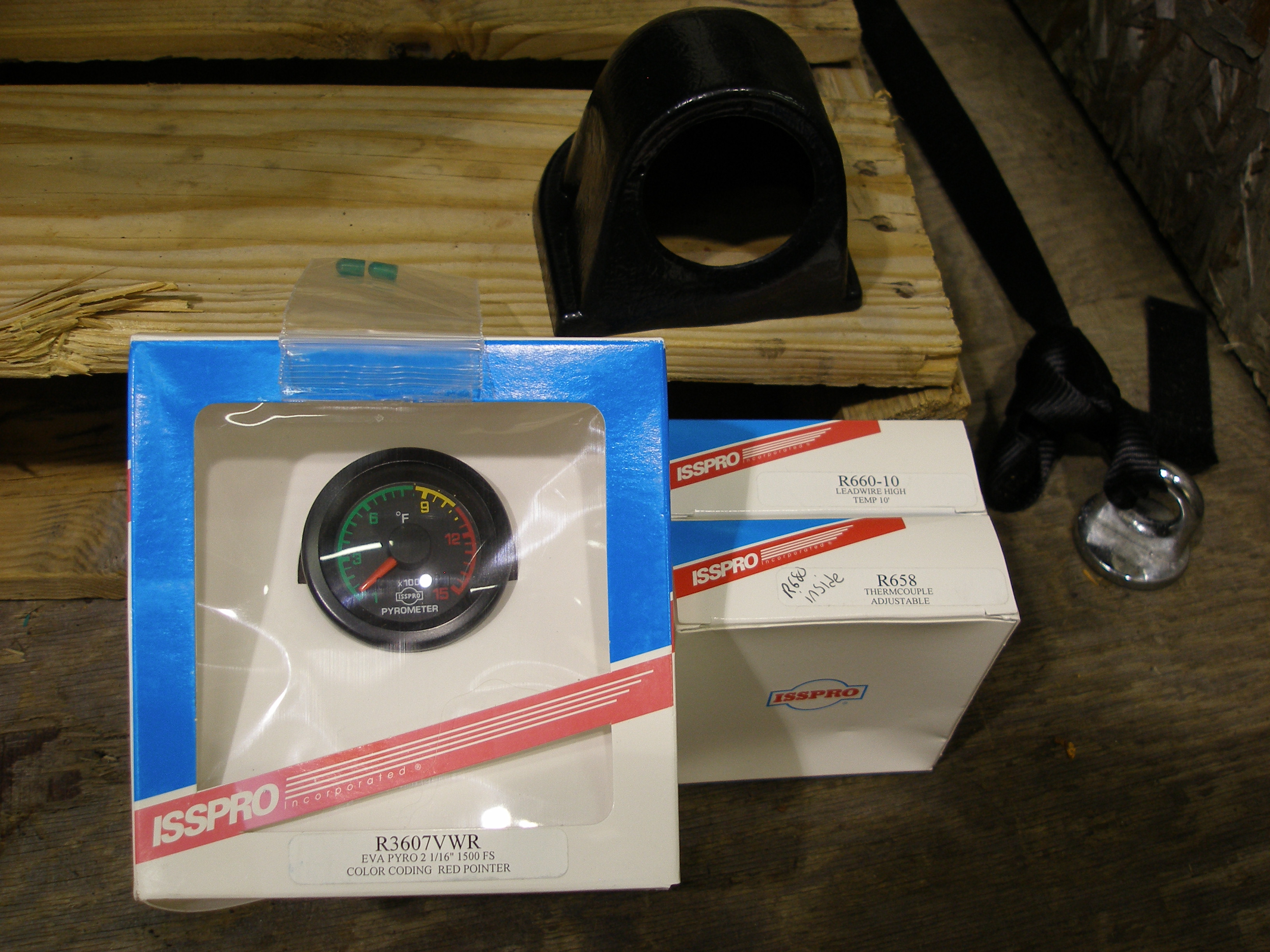

This is the pyro I bought a couple of years back for my '84 F250, and never got around to installing. The little green "pills" in the ziplock are bulb covers to color the illumination lamp green to match the Maxima's dash illumination
I'm not sure I'm going to use that cheap-ass gauge mount. I've kind of resigned myself to having to mount it above the glovebox. On the dash top is just too high and in my line of vision for seeing other things, and I don't see a good/easy way to mount it anywhere else that I can actually see it without looking completely away from the outside, where I should be watching.

Is a headliner console behind the sunvisors possible? Maybe flex in a 3/16" mounting board between the headliner trim above each door to avoid any cutting or holes... Or solder/braze some brackets onto a 4" strip of 16ga steel, soften the edges, flex into place and trap behind the headliner trim. Decorate to suit - maybe spray glue some fabric onto the whole mounting strip to match the headliner. Put the bulky stuff (the pyro gauge) in the center between seats so you don't hit your head.
I assume pillar mount a'la the ricers doesn't appeal or fit well.
The meter looks pretty deep - 2 1/2"+?
Cheers, Rufus
Cheers, Rufus

a a-pillar mount can be modded from a 80's honda civic, so I hear. But a-pillar mounts are pretty ricer'y and I just plain out dont like it, you could mount the gauge on top of the drivers side hvac vent, but it would interfere with the defrosting of the drivers side window
My '82 Wagon is a test mule; the plan is to eventually gut it for the engine for a transplant to some entirely different kind of Wagon, non-Nissan. It's rusty too. I keep it in working order but never really wash it or clean it much, and making the gauges beautiful isn't very high on my list, but I appreciate the ideas.
The main dash is too high to mount gauges above it (IMO). The A-pillar is a definite possibility, though it's awfully conspicuous. I may put the tach there.
