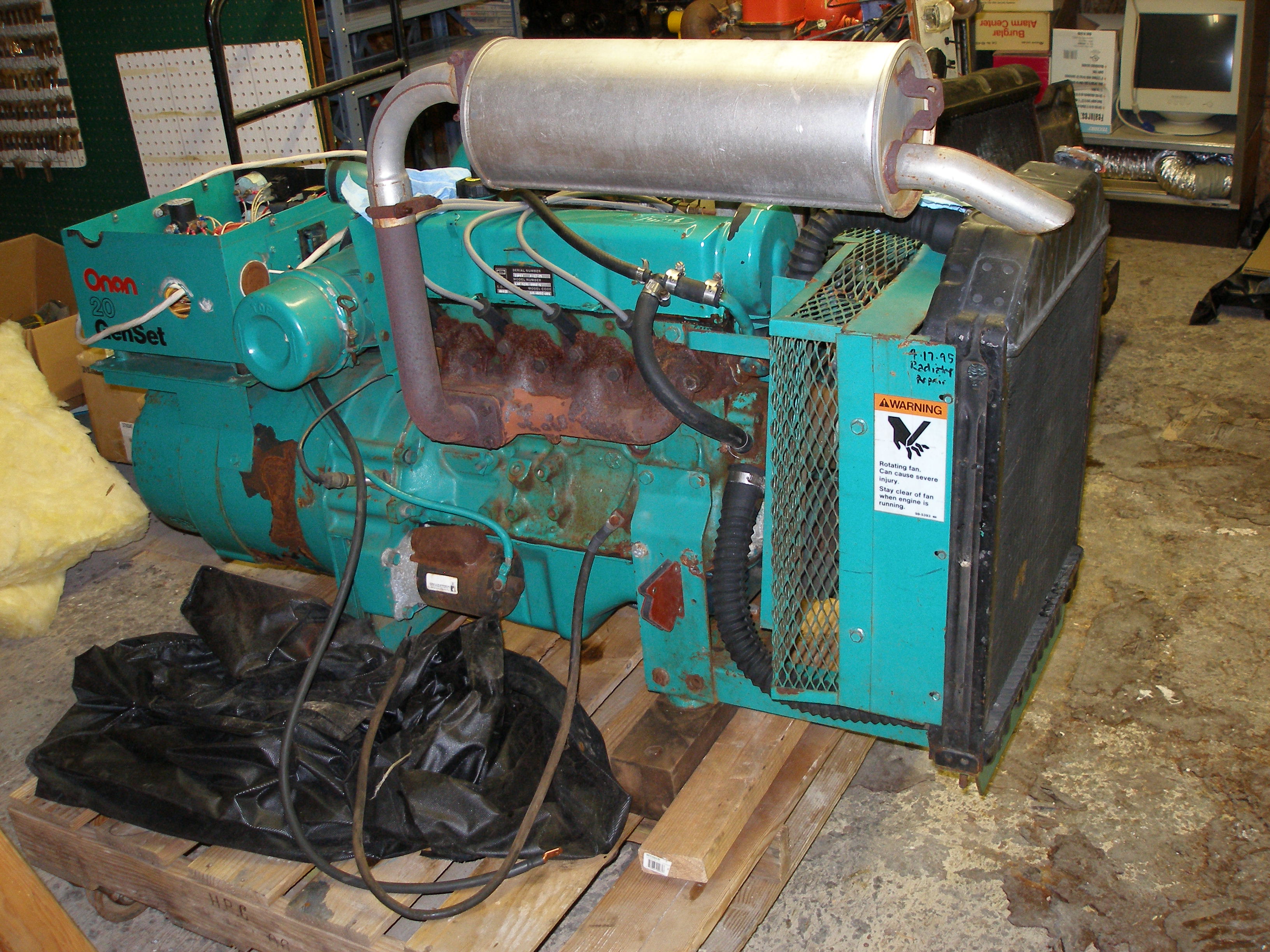

I arranged to meet Floyd on Saturday, 16-Jun and look-see this Onan. As I first saw it:
Genset
Model: 20.0 ES 3R/30422B (ie "Spec B")
Serial: K870940078 (ie Nov-1987)
Engine
Ford Industrial LSG-423I-6005-A (Pinto engine)
Special Options code 0032M
Model Code TCA-0032-JBA
Serial Number 22043 S-27-TH
Hourmeter shows 2894 hours.
Floyd says he used it for more than one day only once in all the years he's had it. Other than that, it has been run for an hour here and an hour there. It has been tarped (has a semi-custom-fitted cover, but no enclosure). He ran it last week and load-tested it somewhat, then ran the ad.
He fired it up and it ran fairly well, a few burbles and misses but sounding basically healthy. Oil dirty but full, coolant OK, no drips or leaks and not recently cleaned of old grime so nothing hidden by that. We talked while it warmed up -- temp too low, I noted, so a bad thermostat in there.
It is approx. 6' long, 30" wide, with the two skids being 20" (the wood, that is) and the skids being 23" center-to-center.
It has a 2.3l Ford industrial engine (that looks like both the one I had in a '70s Bobcat, and a Pinto!). It runs very quietly.
The battery and steel gravity-feed fuel tank come along with it, as well as the fitted tarp arrangement.

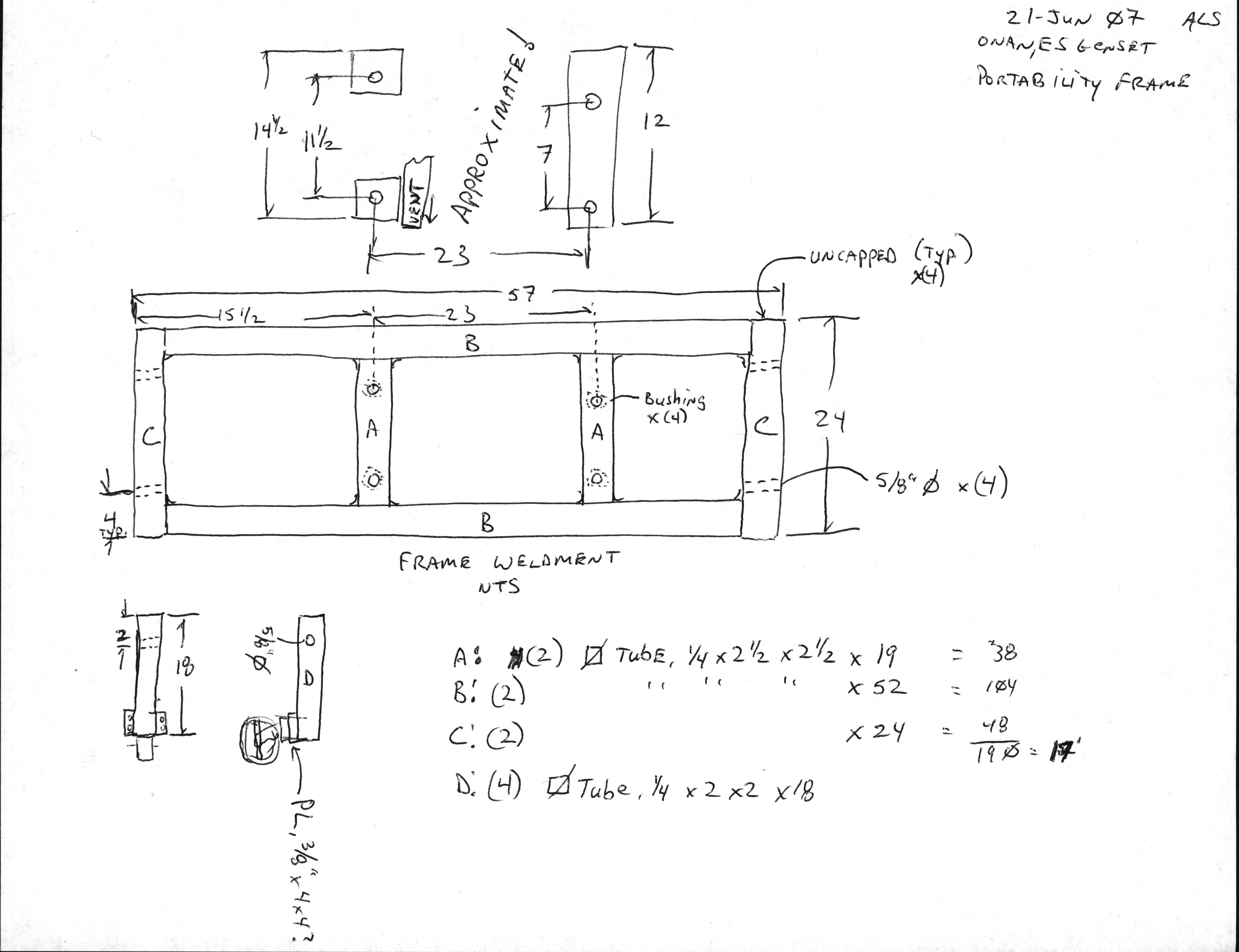

The portability frame Dad wants needs to be able to allow it to be rolled out of the garage, and in the eventuality of needing to transport it to a repair facility, to allow it to be winched on to a utility trailer (which is 52" maximum width between the wheel wells). But this genset is large/heavy enough that it's designed to be bolted down. As a compromise, I am putting a frame under it that can sit on cribbing for normal operation, but can have wheels attached for transport.
The idea is that the wheels can be removed when the frame is cribbed, to avoid tripping on them, and to reduce the generator's idle footprint (the amount of room it consumes when not being actively used). To that end, the frame is constructed such that the wheel outriggers slide into the frame in the same fashion as a typical Class III+ receiver hitch.
Over the past couple of weeks a few changes have crept in. The motor mounts holes will not be bushed -- not needed with 1/4" wall tubing, and fiendishly difficult to execute with the available resources. One SS hook loop added to each end, giving a nice place to attach a winch hook or come-along or strap (too low for a tie-down though). Outrigger through-holes are now 1/2" in outer tubes, 5/8" in outriggers (easier alignment when trying to get the pins in) and there are 1/4" G8 through bolts at the 6-1/16" mark inboard from the frame ends, so when an outrigger is slid home, it stops with the holes aligned (within 1/8", which is plenty close enough). How many times have you wished for a similar stop for your ball mount on your receiver hitch? I know I have, and I got rid of that annoying "slide in a little, slide out a little" problem using these stop bolts.

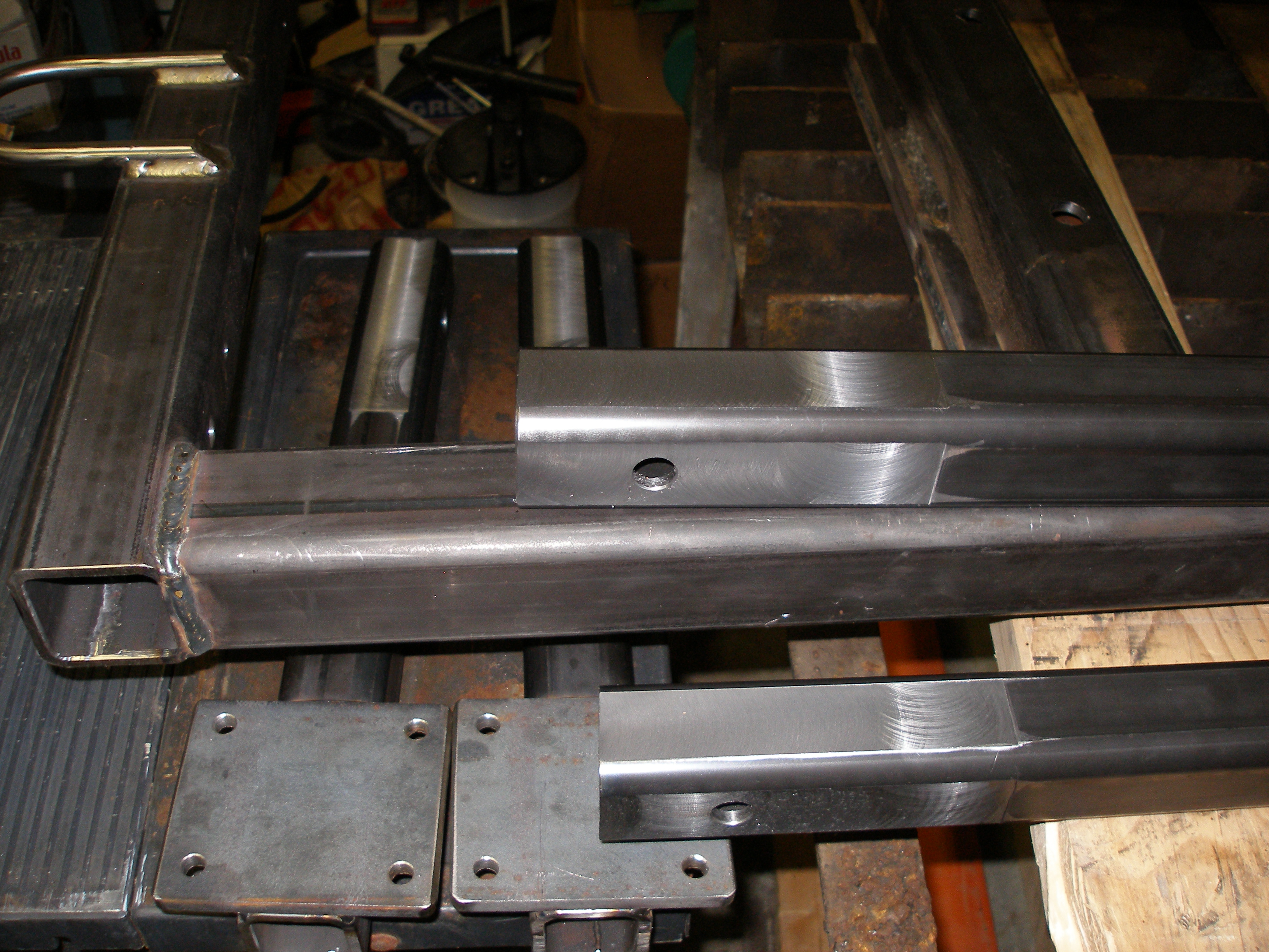

Caster pads done. Transfer punches are a joy, when you need them.
"Handles" for each end of the frame, to allow straps or chains or whatever when winching this thing around. While one could wrap a chain around the frame itself, the finish would be damaged. These "handles" are stainless steel. While the paint will come off of them, they won't look bad nor rust when it does so. They're about 6" long, for scale.

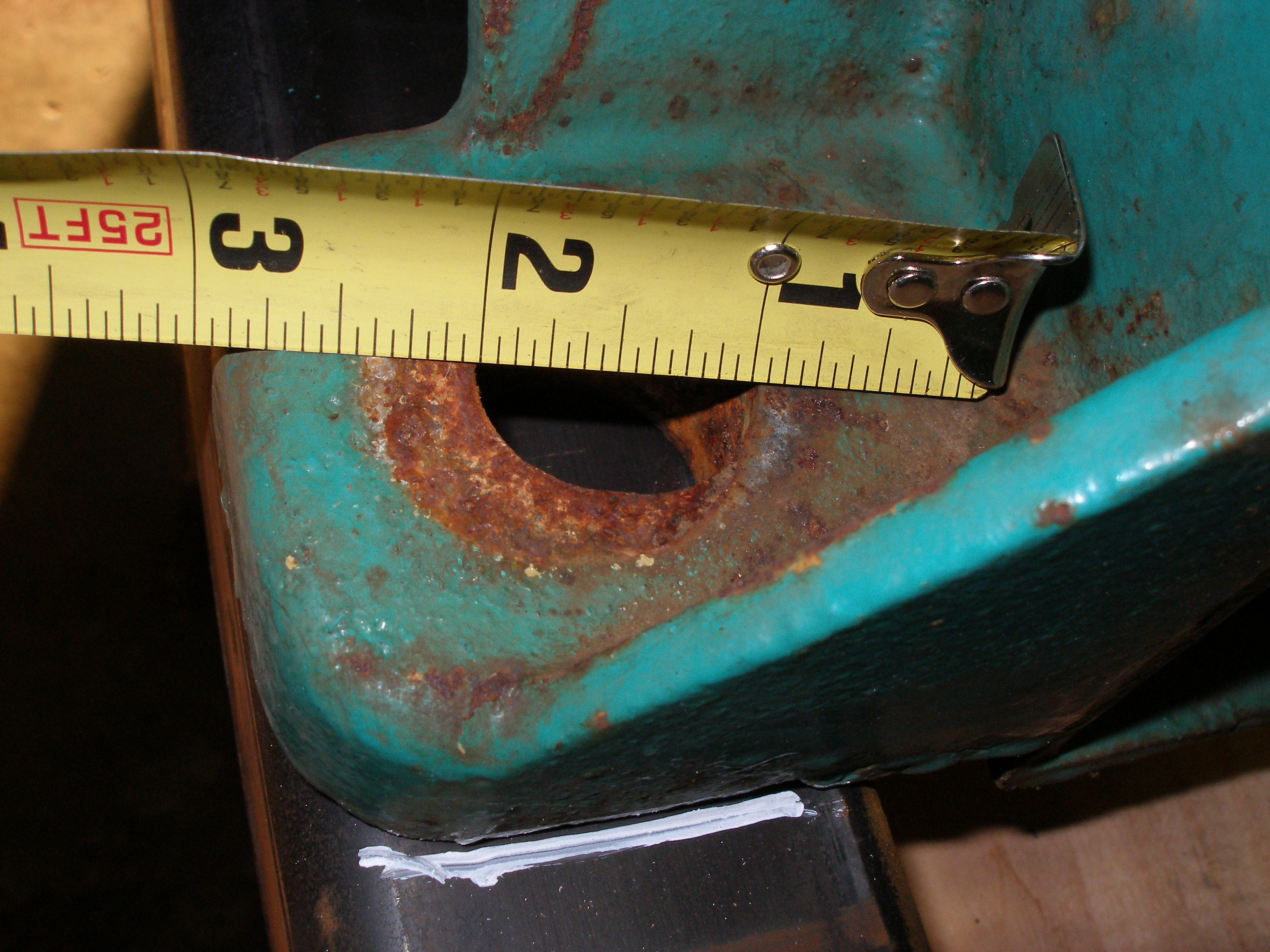

Engine mounting holes are 1" dia.
These welded on cups have to go. I cut them off with a Dremel and 426 cutoff wheels, took about 20 minutes total.
A half-hour of careful nudging and tapping got the four engine mount pads in the correct location. I then strapped the engine down to the frame and had the welder tack it all up in place, then lifted the genset off the frame and gave it back to him to take to his shop and finish the pads welding.

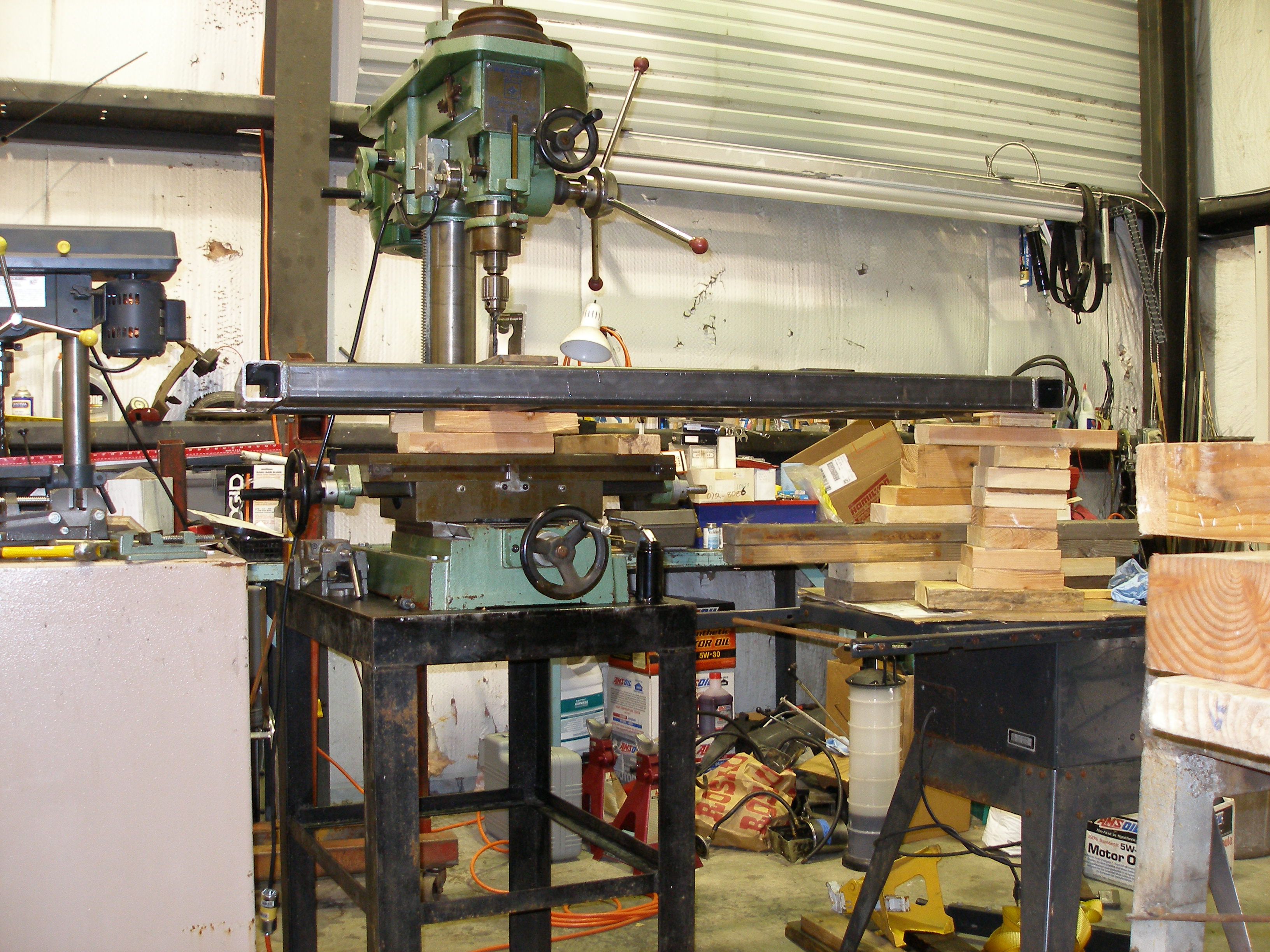

Frame back from welder for the last time. After another trial fit to match mark mounting holes center points, wrestle frame over to new 30-yr-old Jet-16 to bore four holes. This frame is now over 200 lbs and is hard to one-man wrestle -- it's grown up! Each hole requires four drill operations: 5/16", 1/2", 5/8", 3/4". Deepest hole is 1-1/4" of plate.
Lots of cribbing. Lots of setup. One hitch: Jet-16 has a 8-1/4" throat. Guess what the distance from edge of frame to hole is, for the two narrower holes? Yup: 8-1/4" exactly. Didn't plan that. I got very lucky, that I was able to bore those two last holes with this setup.
Four 3/4" holes drilled, now needs a large countersink bit to clean up.

Today, I finished taking .020" off two faces of the caster outriggers. This took a while (20-30 minutes per face times eight faces) but the result is exactly what I was shooting for.
Image Image Image Image
The cardboard deflector on the table is to keep the smoking chips off of me, as I'm cranking the table feeds.

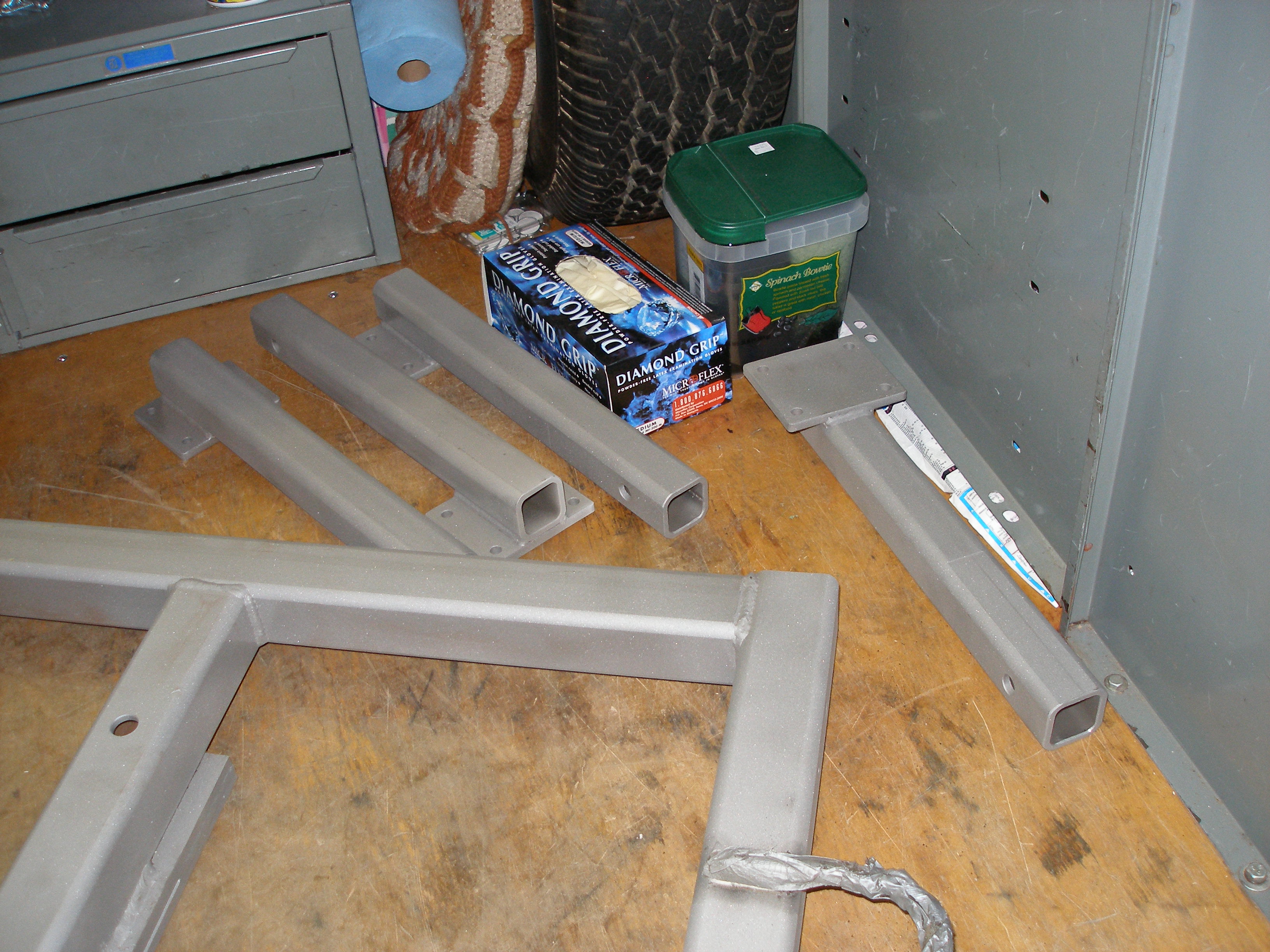

After almost a month, the shop completed the sandblasting.
It's still in the service van. Tomorrow I hope to get it to the painter, before it rusts too badly.
