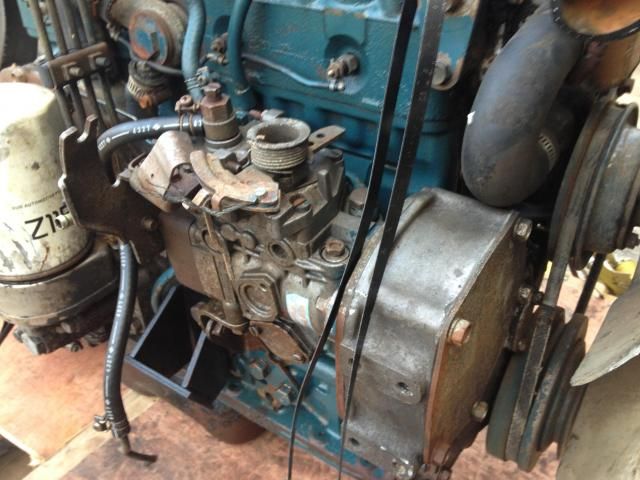

So I threw the new SD23 into the Willys. Hooked up a battery and a Ghetto fabricated fuel system (the Sierra Mist bottle) and fired her up:
I still have air in the lines, but she did fire right up for about 30 seconds. Smoked like a steam train (black) but sounded good. As a footnote JDM's return policy only allows you 14 days to return it, and yesterday was day 14.

I've got nearly everything back together and WOULD be ready for a maiden voyage, but for some reason, she only runs for about 30 seconds to a minute, then sputters and dies. If I just let it idle, it will run longer, if I give it throttle, it dies much sooner. It feels like it is fuel starved.
For kicks and giggles I installed a secondary fuel pump, no difference.
Does anyone know if there is a filter/screen inside the Bosch-style VE pumps?

Turns out that the Bosch-style injection pump does does need a secondary pump. she will run well for about a minute (if primed) without the secondary pump, but that's it.

No, that is not true, I have no pump on my VE type injection pump, and it runs fine, it has it's own feed pump.

You must have had air in the fuel filter system that had to purge itself.

This is hilarious, after telling you that you did not need a fuel pump for your engine, I had to use one to get my VE type SD22 engine running today, it would not keep running, after about a minute of idling rough it would die, and it would not rev at all while idling, and when I was opening everything up bleeding it, I got nothing, so I used an electric pump to get the fuel flowing, and it started perfect, best it has started in a long time, once it was warmed up, I removed the electric pump and started it, and it ran fine.

That's funny. While researching somewhere on the internet I had read that Bosch-style VE pumps require a secondary 7-9 psi pump at the fuel tank. I don't recall if it was a site specific to SD motors or not.
I'll look and see if I can find that source (since it was on the internet it must be true!).
I don't know much about fuel pumps, but my 64 Nissan Patrol (best small 4x4 made imho), started poorly and became fuel starved on the highway. I replaced the fuel pump, installed new lines and filter. No change. I installed a secondary electric pump at the tank, operated by a toggle switch. On cold starts and when it got starved on the highway, I'd just turn on the electric pump. Other times the mechanical pump would just pull fuel right through the electric pump like it wasn't there.
I'll try that with the SD23.

I have had a little lift pump on my SD with the VE for 6+ years now.
I posted about it here ( 7th post down)
http://nissandiesel.dyndns.org/viewtopi ... r&start=15
I have it hooked to the ignition switch in the run position.
I have it hooked to suck through the pre filter and then push through the water trap and the fuel filter.
Works very well and changing fuel filters is a breeze.
You can read the specs on it in the posting.
The beauty of it is that it will flow fuel it if its unplugged as well.
I have spoken with the fuel injection rebuild people about it and gave them the specs on the pump and they said there would be no issue using it.
It is used on Yanmar industrial diesels. Not sure who the manufacturer is on it though.
