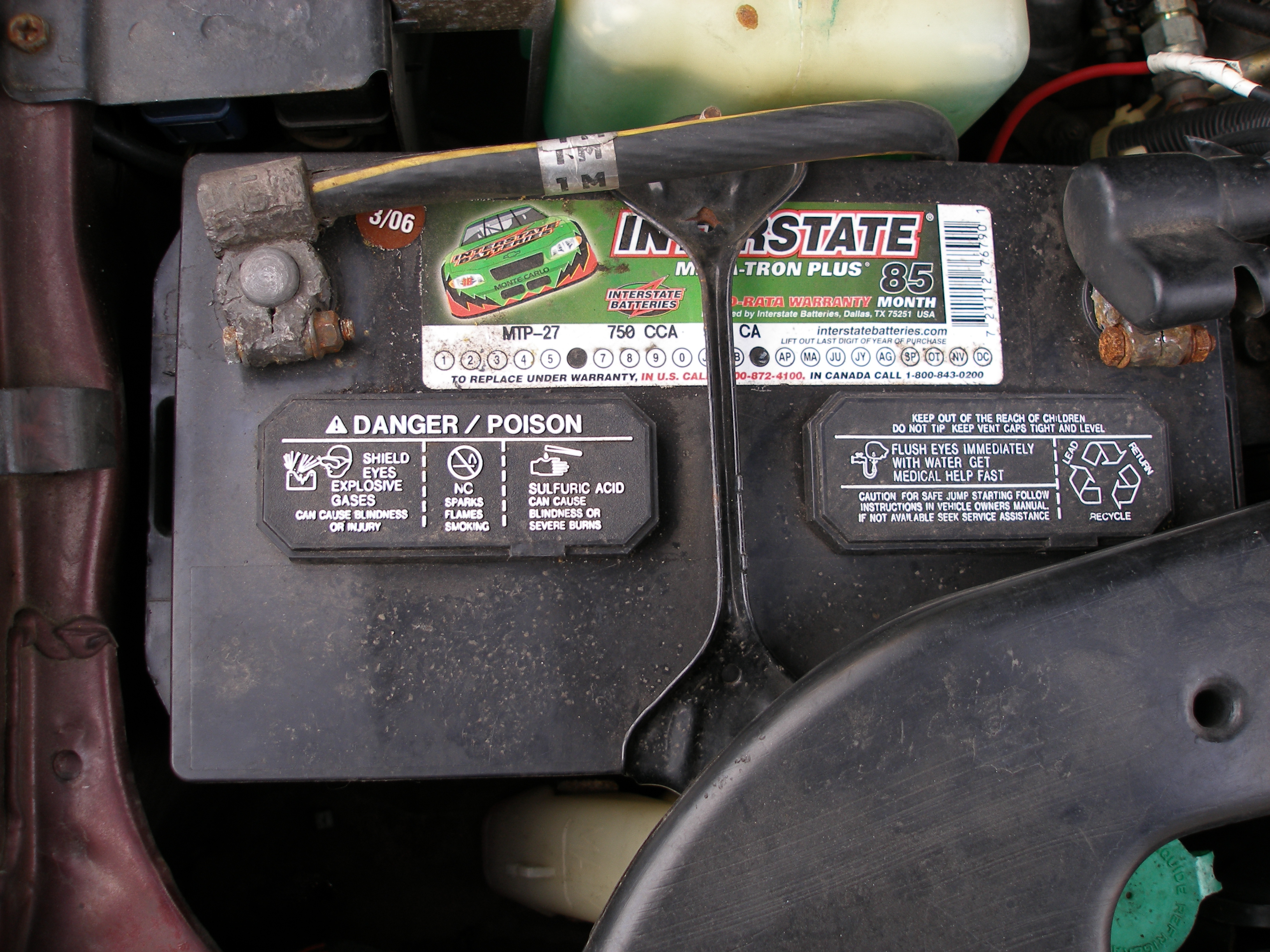

The battery terminal pic almost looks like a camera phone, it's so fuzzy, but Matt's right: that's not an OEM setup. The OEM cables are about 00 gauge (quite thick) and have relatively massive terminal ends. If the cable's been chopped, having a new terminal swedged on your cable can run $20-30, and a whole new cable upwards of $80-100. Most people buy one of those "temporary repair" terminal things that never last more than a year or two, but they are $2 and can get you by. It looks like someone used at least a Deep Cycle top post-to-5/16"-stud adapter; how the cable connects to the adapter I can't see, but the way you have them oriented looks like they may have drilled & tapped the remains of the OEM terminal and screwed the 5/16" stud on the Deep Cycle adapter into the OEM terminal? Which absolutely will not work, because you cannot thread into lead and have any real clamping force.
That Deep Cycle adapter is toast, too. They are cheap to buy, but I don't see how to make one work for you.
Whatever that picture is of, it needs to be rid of corrosion, it's not nice & shiny.

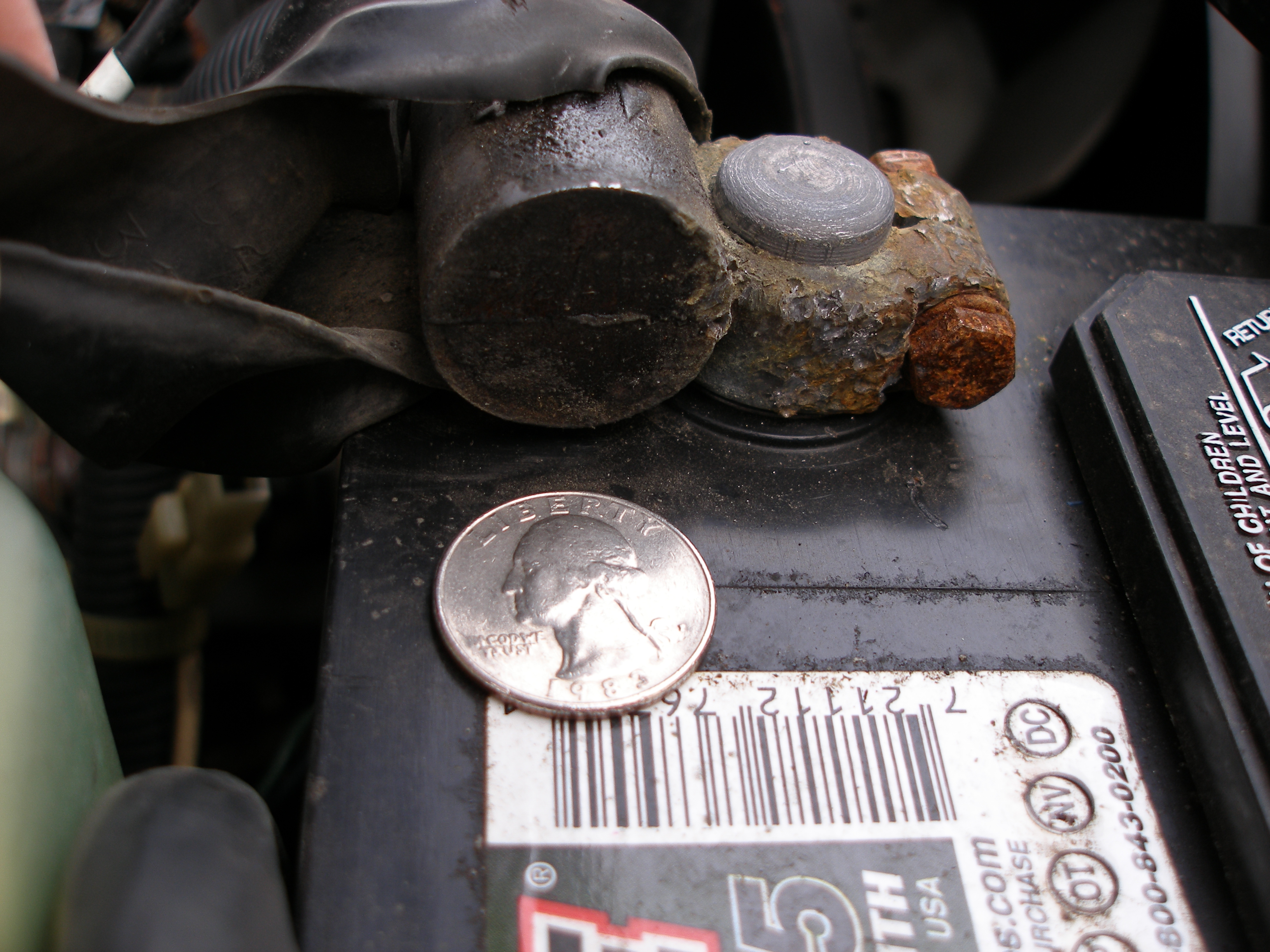

Since it's stopped raining so hard, I'll go shoot some pics of my OEM cables in the '82 Wagon . . .
Notice the shot with the quarter in it? That's the swedged end of the 00 positive cable. You are not going to find that at your FLAPS. And it really is necessary.
The last shot shows a fusible link and connector bypass (black wire from battery terminal to red wire, both 10ga, with white electrical tape) for the GP relay, a (soldered) temporary fix I did for the third owner eight years ago. Next to it is one of the troublesome 5/16" spade connector terminals that go bad.
Note that my terminals are in worn condition (lots of jump starts), but are installed correctly, in that the terminals are below flush with the tops of the battery posts. To do that requires spreading the terminals, best done with a battery terminal spreader (see this post for a picture and links). Never use a hammer or hammer-substitute on a battery terminal or post, the battery separator material breaks, the cell tie straps break, it ruins the battery.

Again, it's hard to see well, but what I see looks normal. Play with your camera a bit and see if you can get clearer shots, and we can give better advice.
