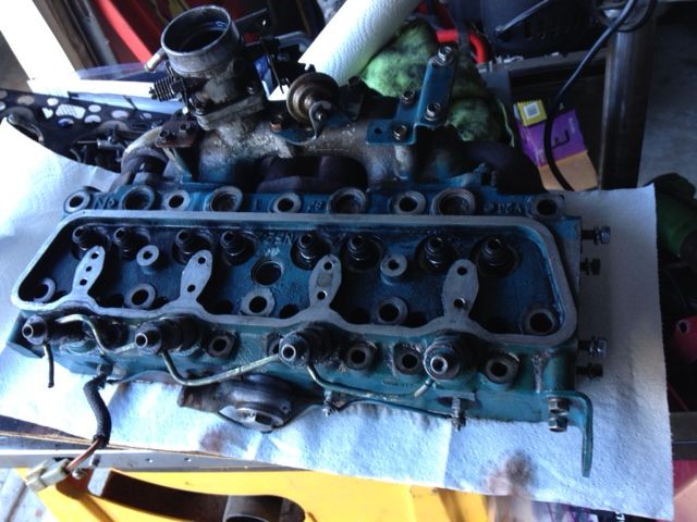

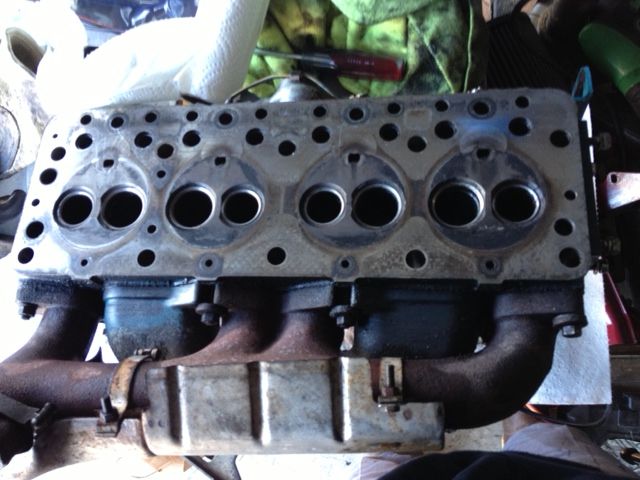

After perusing Craigslist and the internet for months for a new motor, I decided to pull the head of the existing sd22 to see why it is blowing so much smoke.
I don't know if I mentioned it before, but I'm not a mechanic...going inside a diesel is new to me. Fortunately the SD22 is about as low maintenance as a motor can be! If anyone sees that I'm doing something wrong, I'm always open to ideas or suggestions.

The whole time I've been working on this, I kept hearing an old friend's voice: His favorite expression was that "there's never time to do it right the first time, but always time to fix it later."
and he's right.
I had removed the head, cleaned 30 years of &^%$! from it. Inspected and reground the valves and seats. After doing this manually, I was REAL glad that the SD's only had 8 valves! Everything was going well, three of the valves had some pitting, but they cleaned up and after removing all of the carbon build-up, sat in the seats pretty well.
I moved on to the cylinders. There was no pitting on the walls, but they are worn. They are still within specs, but barely. The right thing to do is pull the motor and have them rebored.
That's when I realized that doing this right is going to get expensive quick. I added up the cost of a rebuild kit, machining and tools, as well as my time, and...
ordered a SD22 from JDM motors.
I had considered this earlier, but after talking with one of their representatives on the phone, did not feel comfortable dealing with them as they, frankly, seemed a little shady.
stay tuned....
