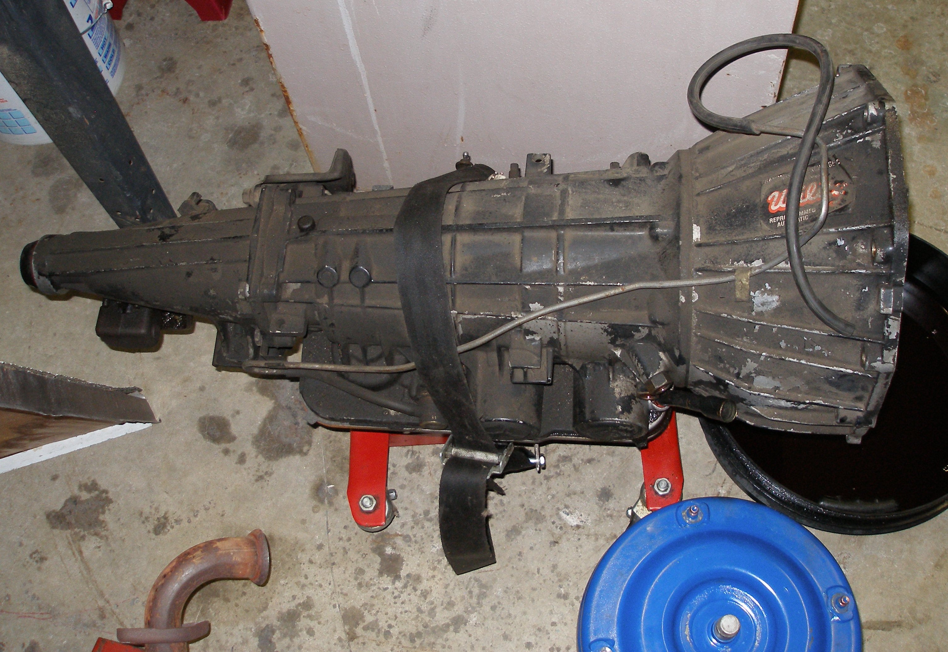

The shiny blue TC is the replacement ($200) TC I put in (Nov-06) to replace the one with the grenaded lockup clutch. It lasted fine through the trip to LA and back, but three weeks ago something else broke inside the trans.
So I picked up a generic $150 used trans, put the nearly-new TC in, new front & rear seals, filter, pan gasket. Put it in, the modulator leaked so swapped them.
Here is how I manhandle transmissions when my back is giving me trouble. Go ahead, laugh: it probably only weighs 150 lbs, and I loaded it into the trailer, out of the trailer, and onto the piano dolly myself, but that's when I was feeling better. Last weekend was rainy, and I wasn't going to clean this trans outside with rain coming down sideways, so I covered the table saw at work with plastic, then with cardboard, and cleaned it inside. No real "clean" pics shown, well inside the bellhousing got cleaned up pretty nicely, but I think I forgot to take exteriour "after" shots. These are after the car wash, though. Transmissions often do not clean up well at the car wash, and this was the case with this one.
Image Image Image Image Image Image
I have about 100 miles on this combo, seems fine, if quite different from my old "rebuilt" one -- shifts at different points, with a lot less drama than mine did. Only downside so far is a manual downshift from OD to D (4th to 3rd/direct). If the TC is locked, that downshift is damned harsh (unlike my old rebuilt one). I mean harsh harsh. But if the TC is unlocked it's fine. It's forced me to change my driving habits, as my commute has four places one direction, three the other, where I manually downshift, but not any more.
