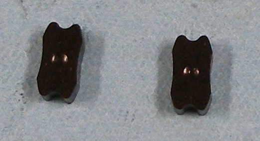

The VE IP's cam drive bumpers won't last with the added load. They don't even like WVO (ie more viscous "fuel").
Here's some from a Toyota VE-style IP I had rebuilt last year:
The entire thread is here.
