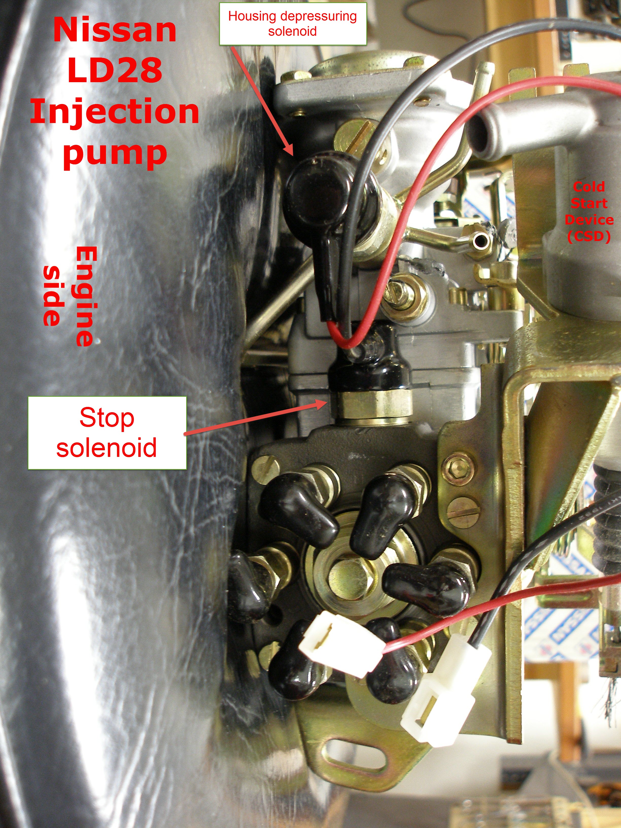

See this thread for pictures of a brand-new IP I sold years ago.
The only wired thing on the LD28 IP that goes into a large nut is the Stop Solenoid, and it's safe to remove. Just make damned certain that it's spotlessly clean all around it before unscrewing it, because any debris will fall directly into a place you don't want debris. It's sealed by a copper washer; round up a replacement beforehand.
