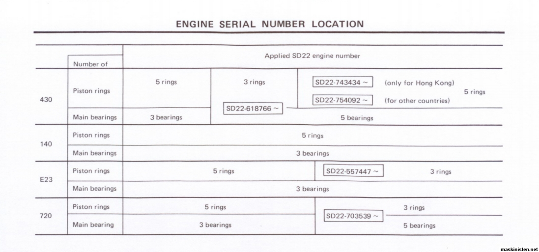

Anybody know if the SD33 main brgs are the same as an SD22's? I'm looking at an eBay auction for a set of SD33 brgs. for use in an SD22.

sd 22 mains
Post by steven.0424 »
in my manual phil it does statesd22 does come with both three or five mains sd22-703539~

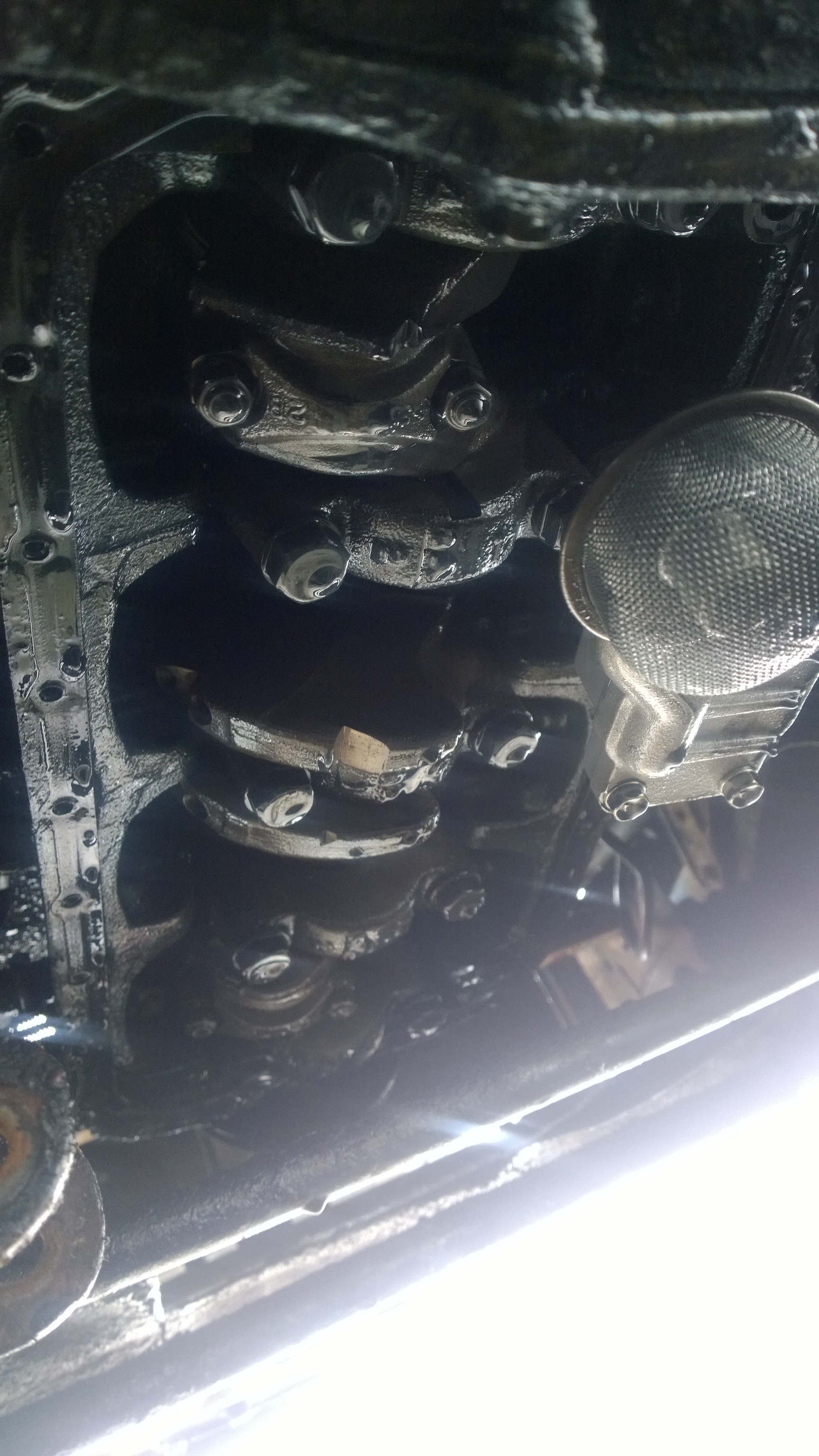

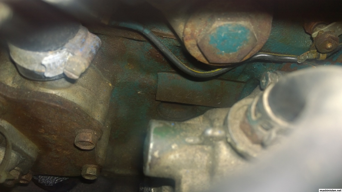

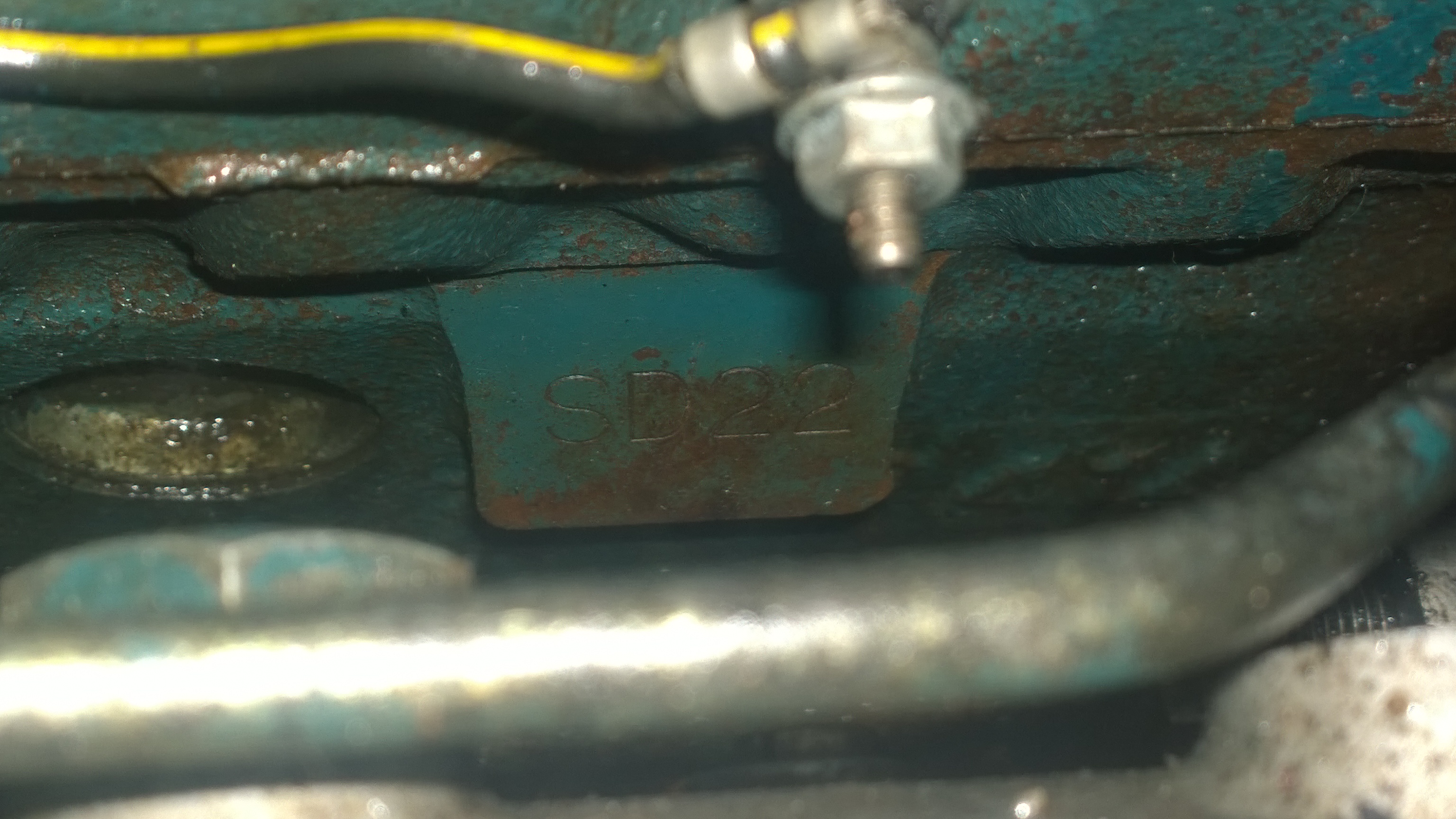

Re: SD-22 Bottom End View
Post by DieselTok »
You guys are saying that the SD22 was ONLY fitted with 3 main bearings. But here I have a 1984 SD22 from a 720 truck in my Mazda B2000 '87 truck. It says SD22 on the block and on the valve cover.
What do you say about that?
Actually, the post above yours from 8 years ago points that out.
Post by DieselTok »
Yup, I know. But I just wanted to apply with some photo evidence to the topic :)
