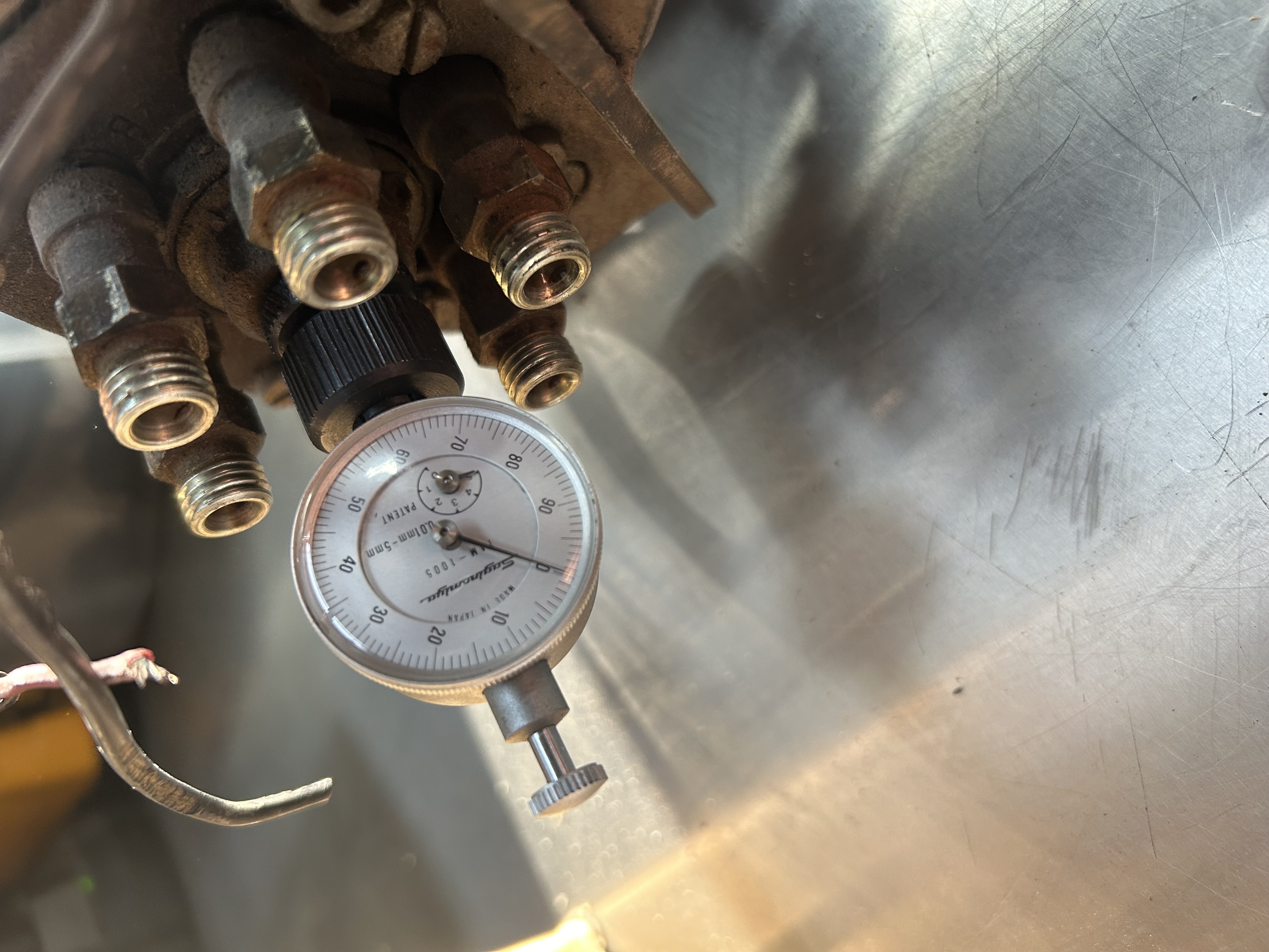

Re: IP Timing: The unavailable KV11229352 timing tool
Sharing for posterity in this old post
I recently acquired one and tested it in my spare IP. It works!
