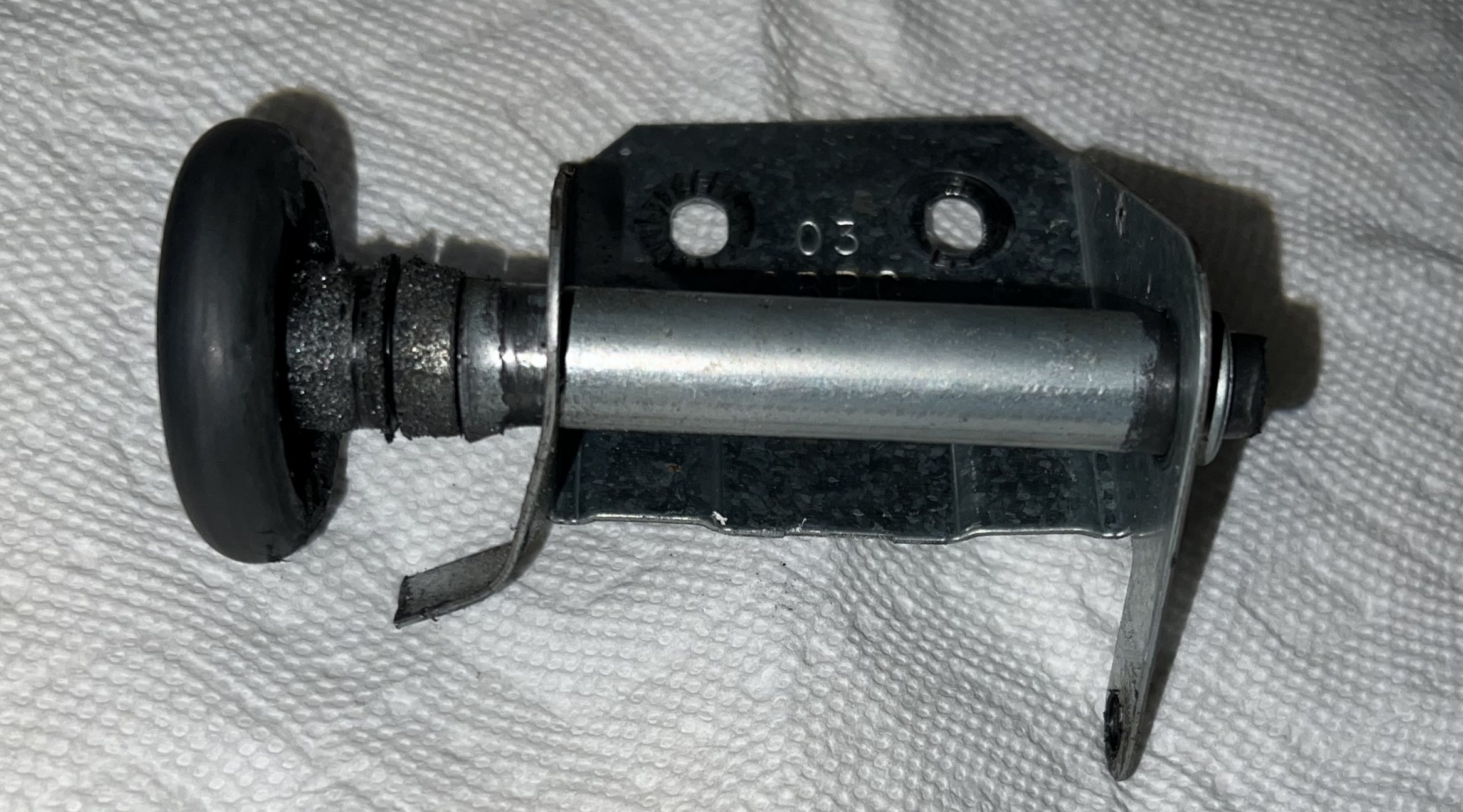

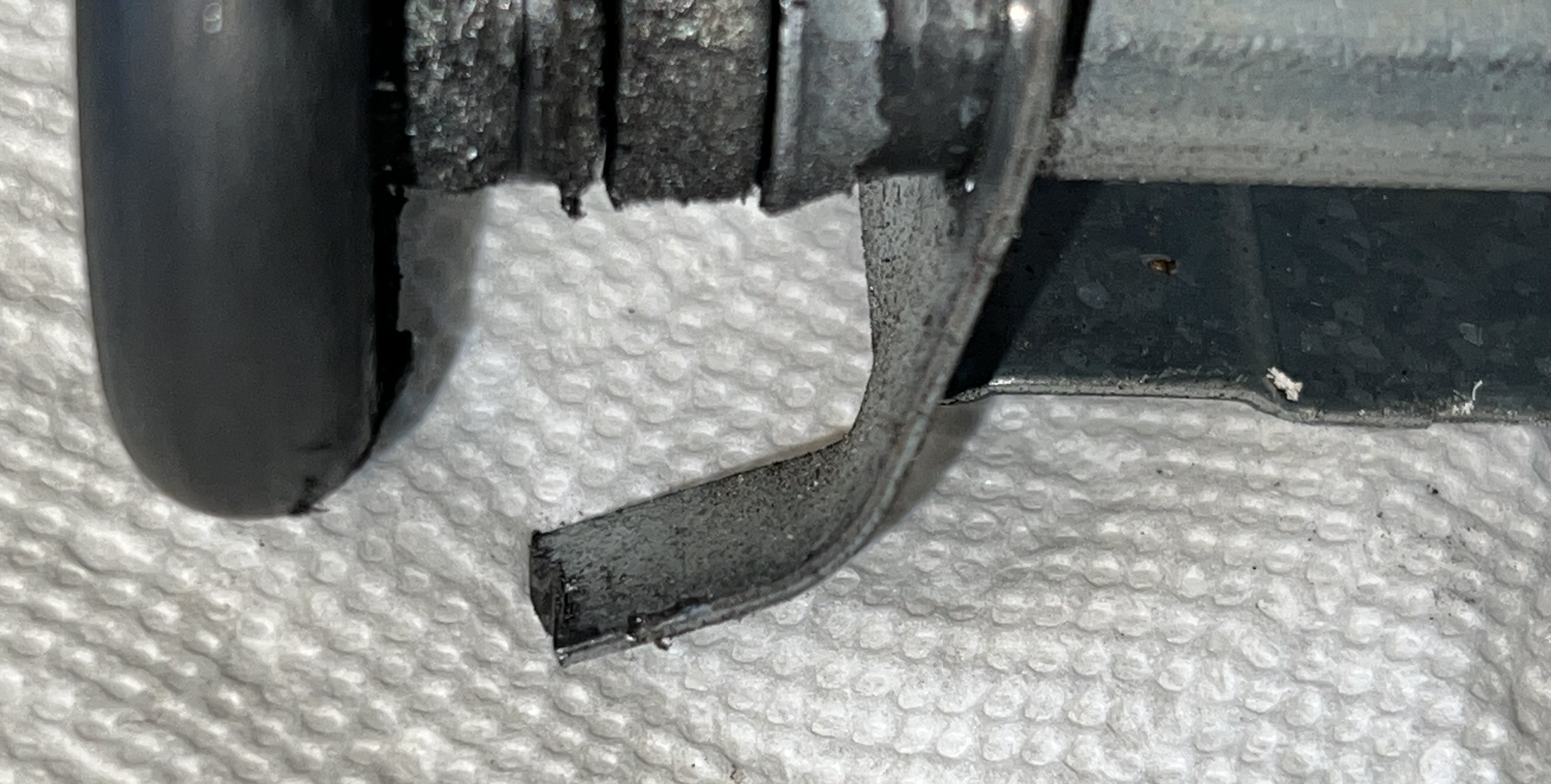

However, one hinge on the north side had a broken-off arm already. Oops. It's an "03".

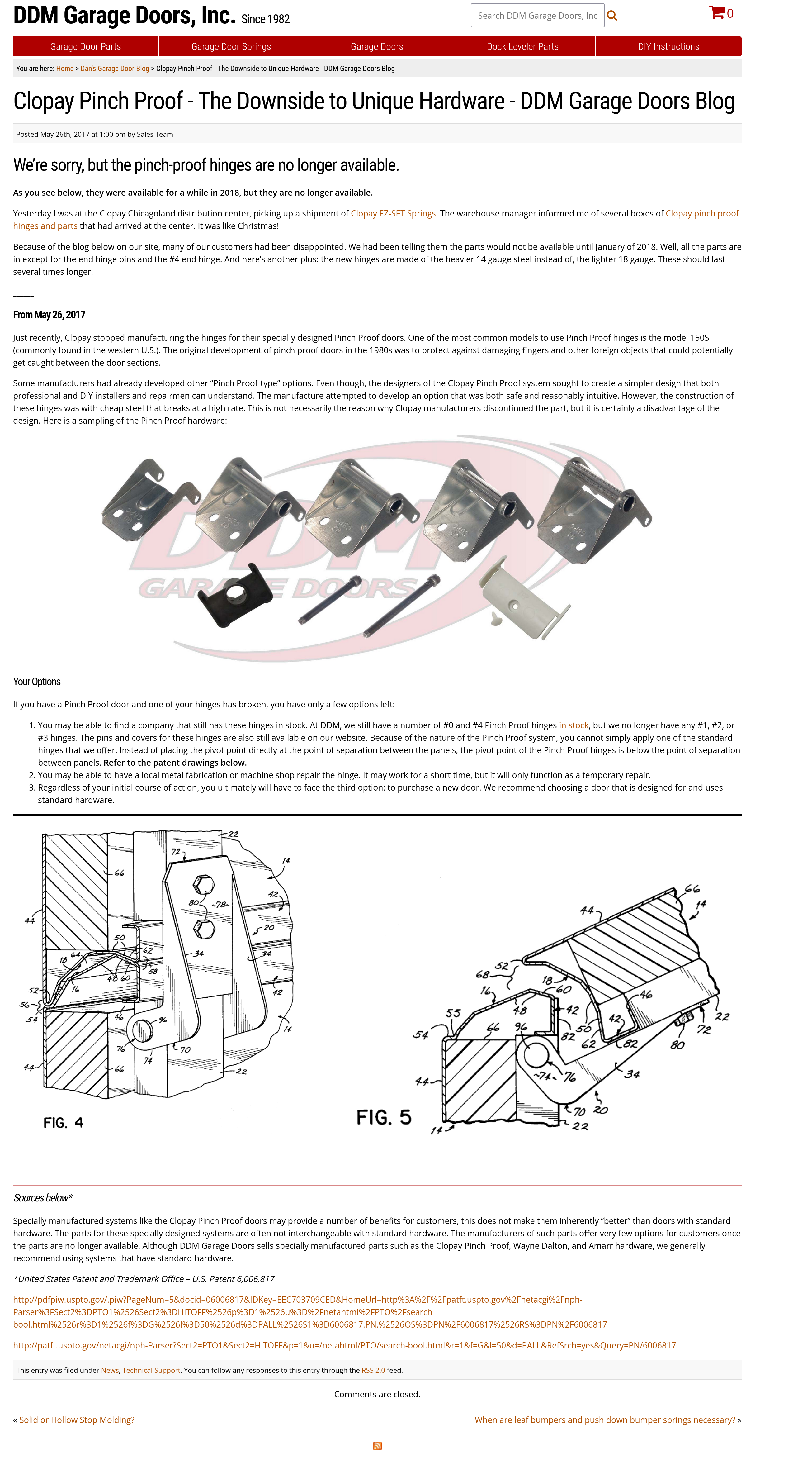

While Clopay still mfgrs garage doors & parts, they discontinued the Pinch Proof hinges around 2018.
DDM Garage Doors blog page on the discontinuance of Clopay Pinch-Proof hinges in 2018.

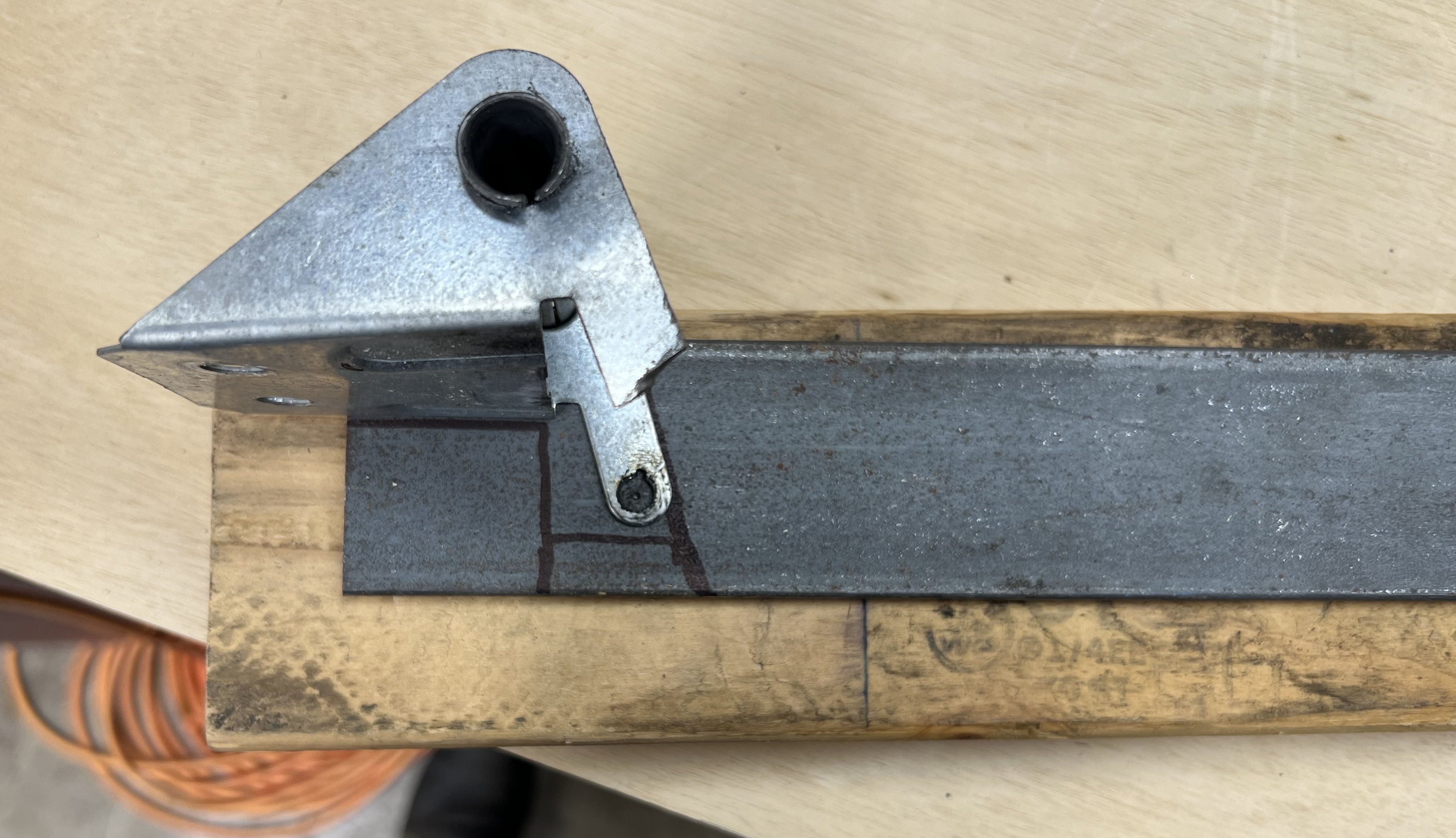

And, while there's one used "00" hinge on eBay (for $95!), I was unable to locate a "03" hinge anywhere. This fellow folded one up from scratch but while I could probably fabricate on that level, it seems like an awfully easy thing to screw up three times to get one correct, and I don't have my full workshop reassembled yet. My "03" hinge wasn't as badly damaged as that fellow's, so I went the route of remediation rather than fabrication, and had it back up and working in under 90 minutes, which is the kind of timescale I want to work on for a rental's garage door. Basically, since there's LOTS of rooms around this hinge, I just sistered (to borrow a carpentry term) a piece of 1/4 steel flatbar to the side of the existing hinge in order to reestablish a hinge pin hole.
Damaged Clopay "CBPC 03" hinge with one arm bent and hinge pin end missing.
Damaged Clopay "CBPC 03" hinge: tracing "good" hinge arm to 1/4 flatbar.
1/4" flatbar with cut lines.

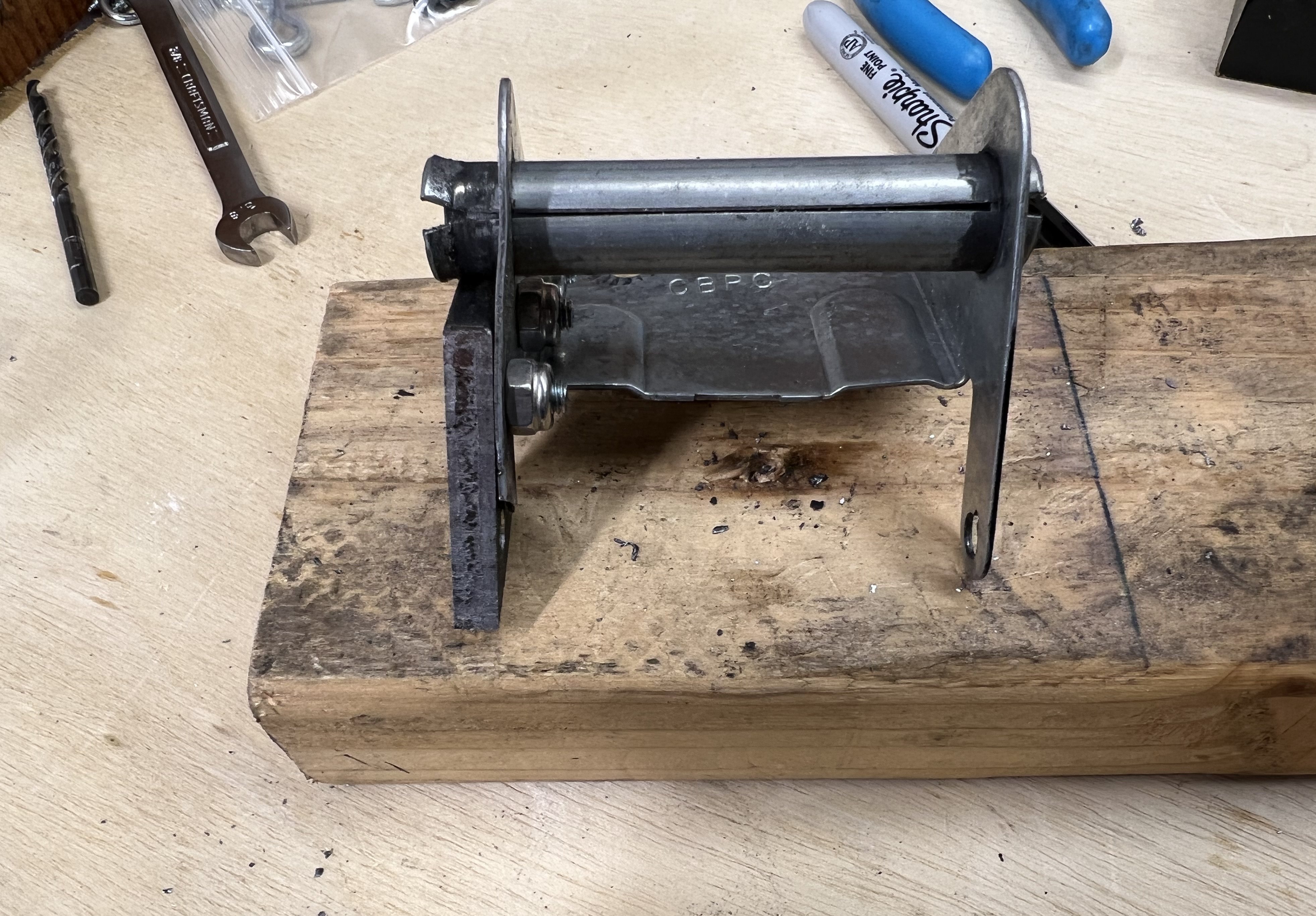

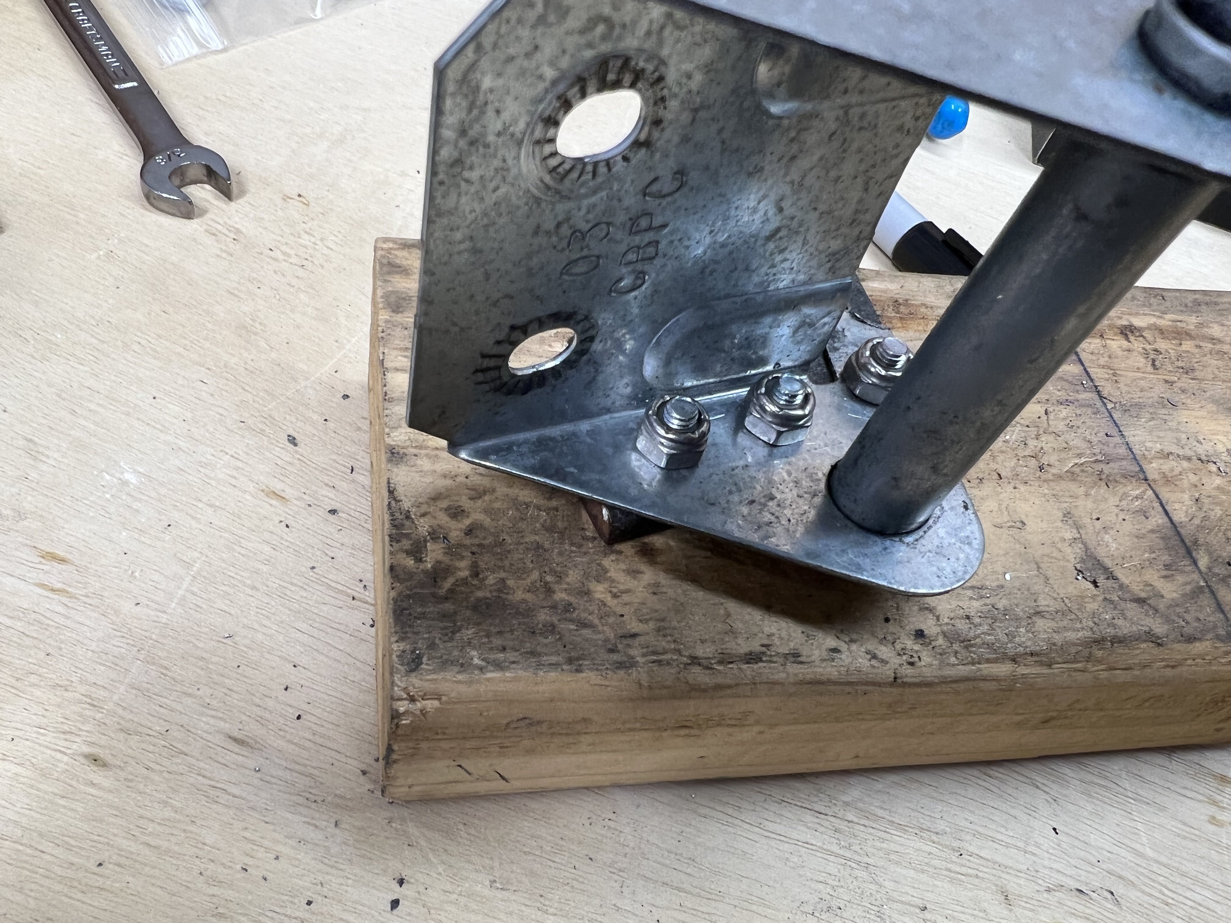

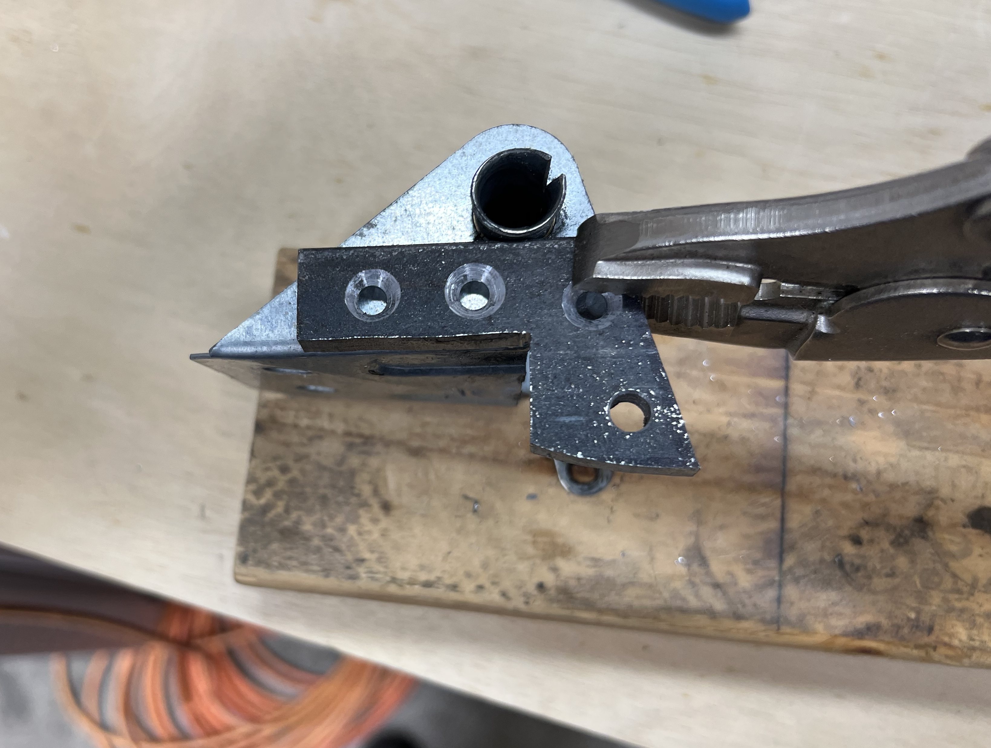

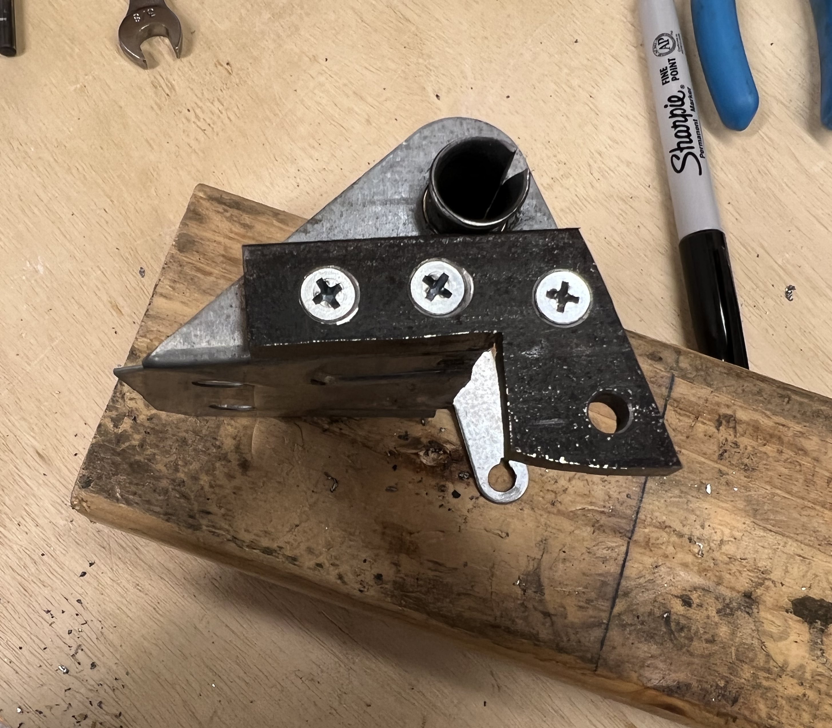

I used a Bosch metal-cutting blade in my Porter Cable jigsaw, with the flatbar clamped to a portable workbench outside, to roughly fashion a sister member. I then located three places on the hinge where I thought I could fit nylock nuts for 10-32 screws, and through-drilled the sister member to the hinge's side, then countersunk the sister member for flathead screws.
Sister member roughed to shape, three mount holes, countersunk.
Hinge with sister member mounted.

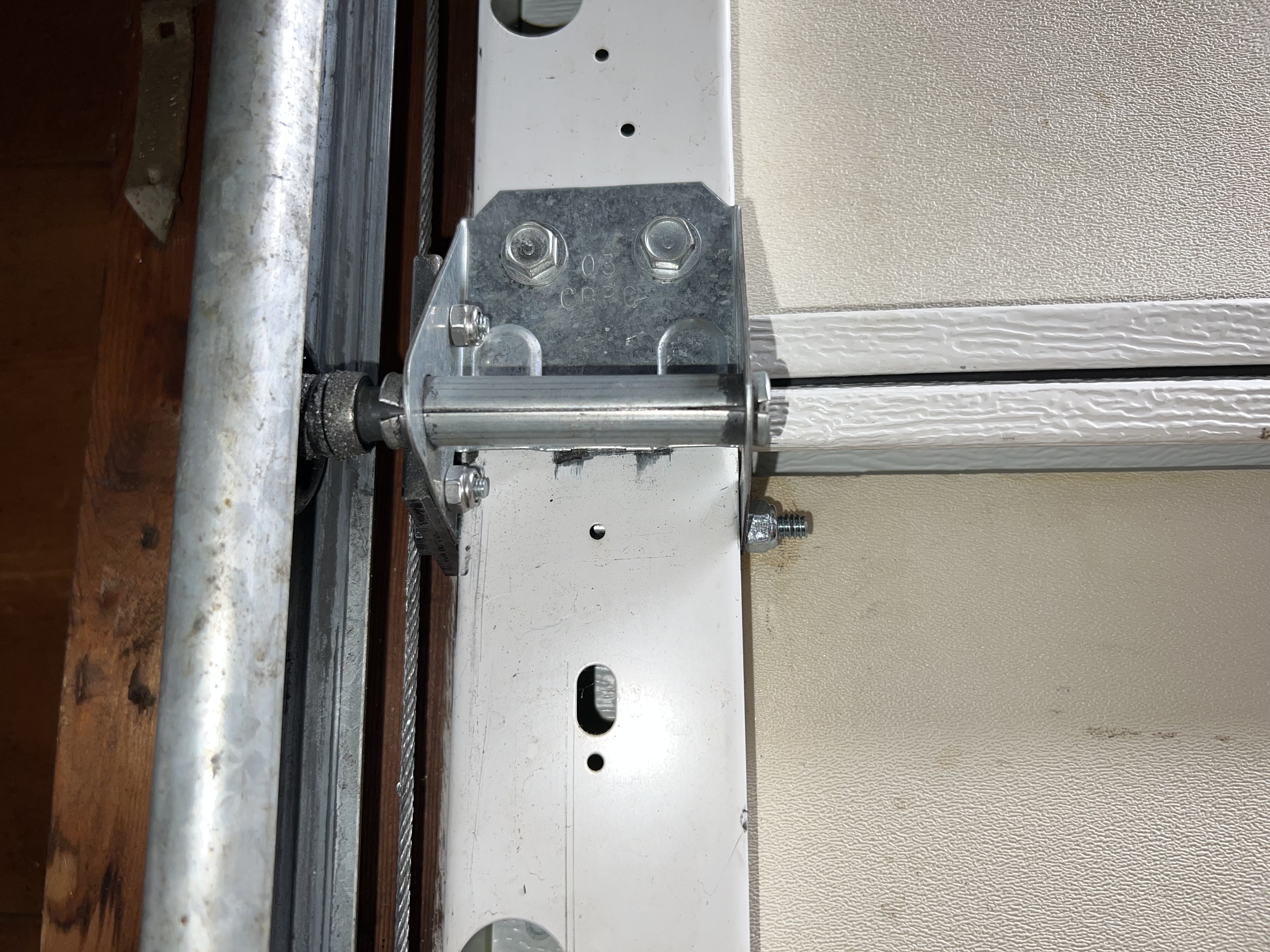

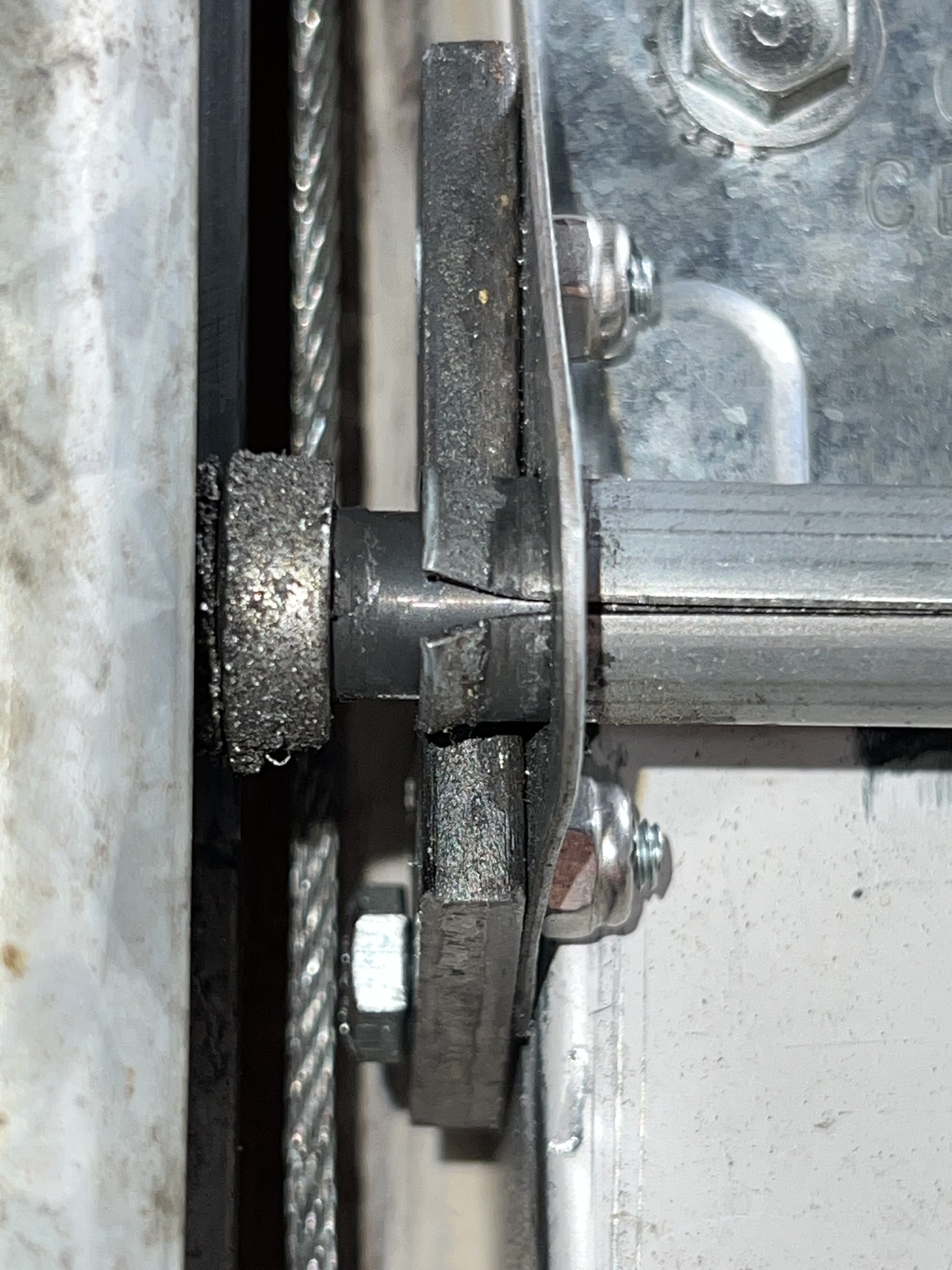

Repaired hinge mounted to door.

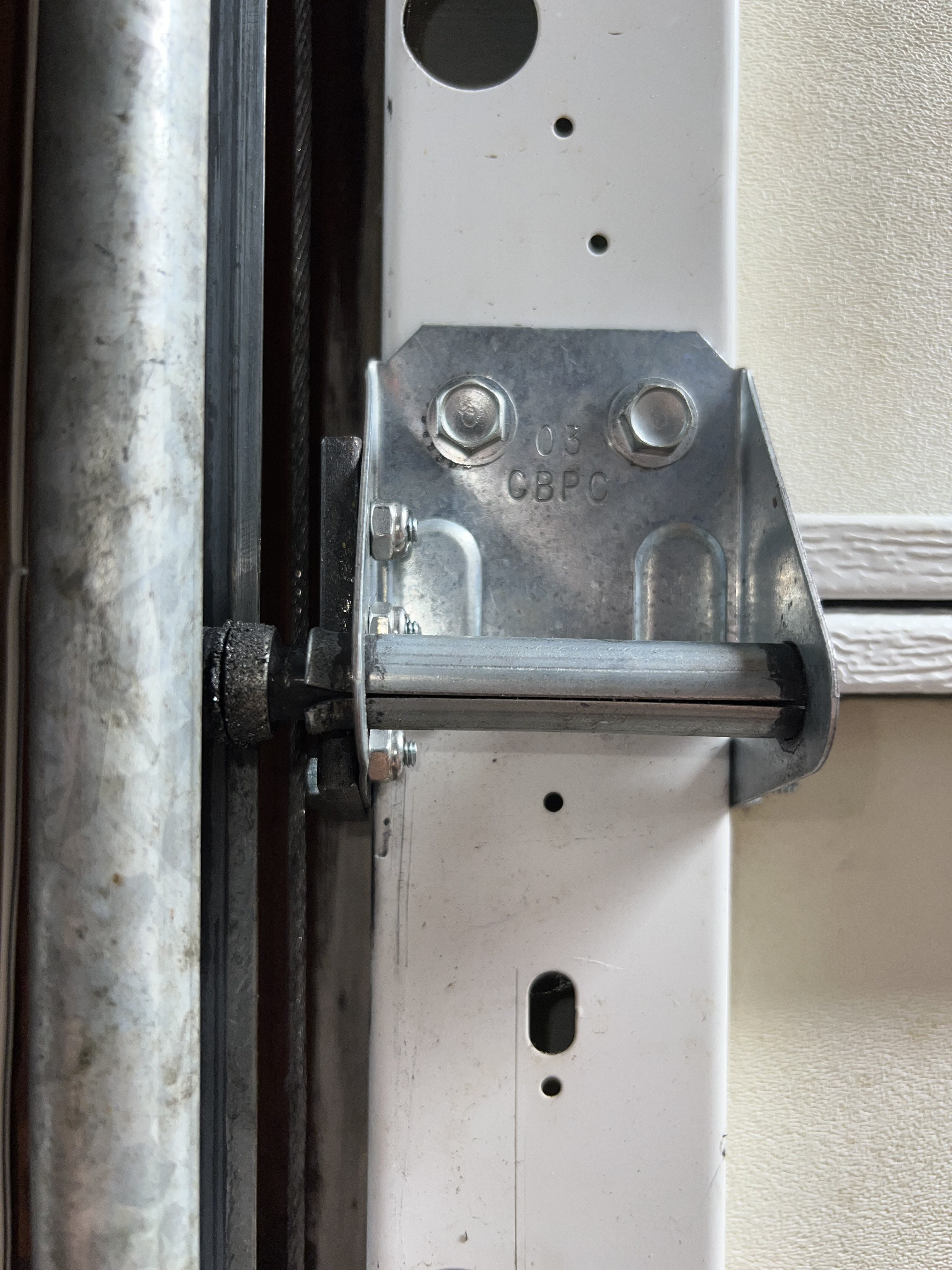

While it looks as if that bolt head is going to foul the lift cable, in reality they are 1/2" apart in the other plane, so no interference issue.
Given another hour, I could have found a grinder that I could mount outside and set up, then made the part much more photogenic. And squirted some paint on it, deburred it, etc. But this one I'm going to leave ugly and as-is. I suspect that another one of these hinges will give way, and when it does, I assume that either all hinges will be replaced (it's rumored that if you replace ALL the hinges with the newer, non-Pinch Proof type, the existing panels can be salvaged) or the entire door, suspension, and rails will be replaced. This is "good enough" until then; pretty doesn't make the door go up & down.
