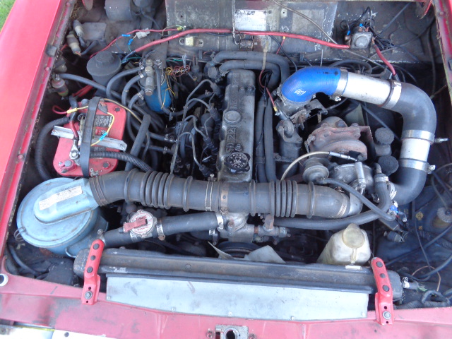

That's pretty tight engine room you have there for sure. Lot's of stuff going on. Even a piece of aluminium dryer vent tube with a couple washers for spacers hosed clamped around the closest part of the pipe would help ?
I think it was Al or maybe someone on here years ago swapped to a Motorola 120 Amp ?? alternator and ran a separate 12v vacuum pump for the booster. Had a juice can reservoir and pressure switch mounted someplace.
That said, you don't appear to have any room for anything more under there, although the pump, reservoir etc could be remotely placed ?????? somewhere.
I know the down pipe on my SD25 ( natural ) has a heat shield all the way from the flange to where it turns under the fire wall. It's a2 piece aluminum with a hose type clamp at the top holding it to the pipe.

It does not even have the heat shield between the turbocharger and master brake cylinder reservoirs in that photo, I was still using ABS tubing when that photo was taken also, I really do not like working in the engine bay anymore unless it is something simple, starters and alternators are on my hate to do that list now.
My stock head pipes with heat shields do not exist anymore with the turbocharger, made my own heat shield for the head pipe near the starter to try and keep the starter solenoid cool, but the rebuilt ones only last a week before I get clicks 50 percent of the time, if I hit my power bypass button/relay to the starter motor it usually starts right up without letting off the key in the start position, I would cut a giant hole in the inner fender but the steering column is in the way, it has just got old recently, this last alternator did not last long and I am out of functioning good ones now, I pulled the brushes out of one that did not work(tested by me on my test stand), the brushes were over an inch long, they looked great, I do not know where the diodes are or what good ones look like, but I am willing to take them apart and make good ones if I can out of parts from other alternators, I have about 7 of them now that do not work properly.

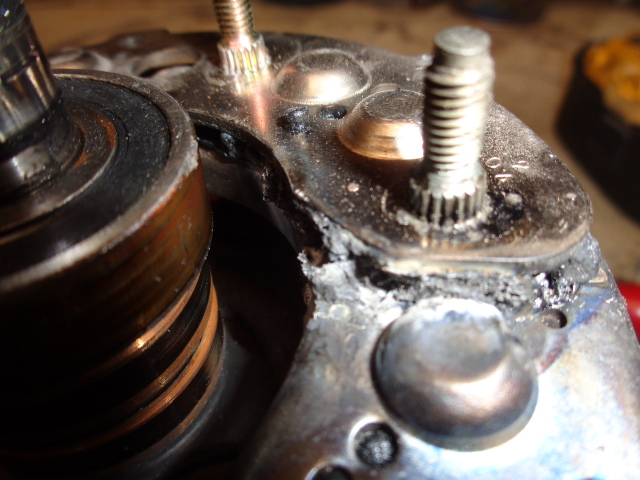

I pulled a couple alternators apart yesterday, I just do not understand them, I suppose I should have tested each one before pulling them apart to see if the light worked first as after pulling a few apart and putting them back together as none of the lights worked after that.
The first one I pulled apart looked completely smoked, sorry the photo did not focus that well but the plate looked burnt and it had what I would describe as ash between the upper plate and the lower plate, are these plates the diodes?
I looked at the brushes first, some were longer and some were shorter, but none were short, I tested them and all had connections(continuity?), there is a small flat/shallow box under the brush holder, they all looked fine(not discolored or burnt), I put together two out of good looking parts but the light(dash light) never came on so I did not test them, I made a test stand.

Diodes. Diodes blow apart (but the potting keeps them looking like they're still in one piece) on the Hitachi LR150. And the VR will often get taken out by the bad diodes, so you change 'em both. I've been into a LOT of 'em.

The six diodes are welded to the c-shaped plates and then potted in a silicone. Six stator wires are soldered to them. On the Hitachis, you replace the the whole diode assembly as a single piece.
