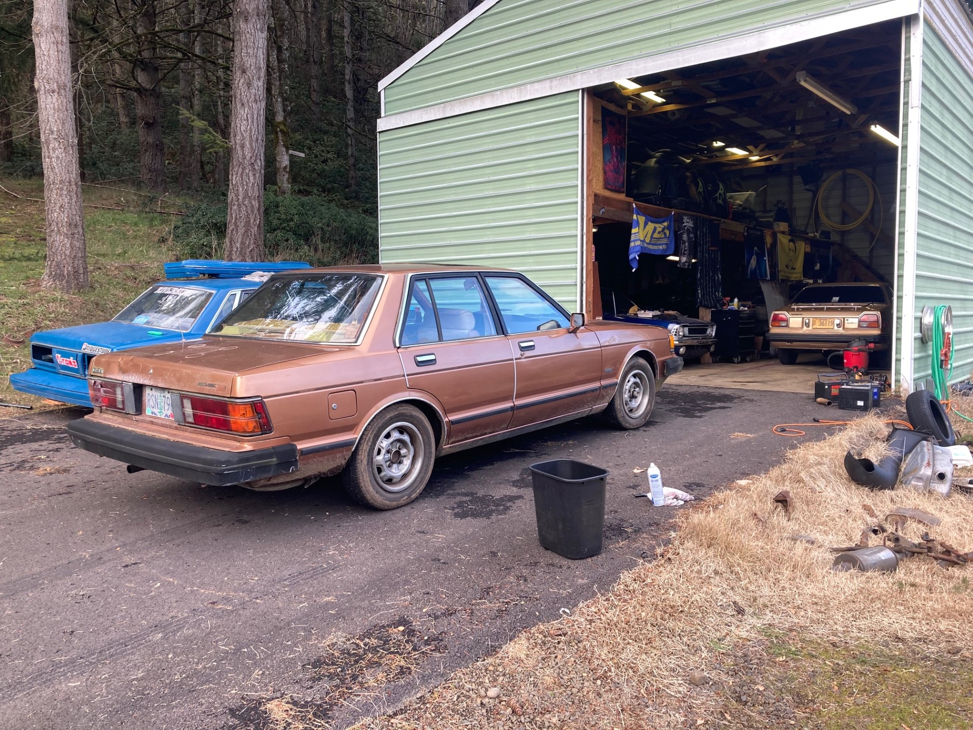

Greetings everyone, I'm here to learn and share progress on our Maxima projects. My girlfriend owns three total, 2 diesel 5 speed and one diesel automatic. One of the diesel 5 speeds is strictly a parts car at this point, the other is a daily driver, and the brown automatic pictured below is our project. Purchased in Portland, OR for $987.65 last year we were a bit overzealous in trying to drive it home with a charging issue. About 30 minutes in the car tapped out.
We've had the alternator rebuilt, it was fried. It also received a new battery. The next issue was that it would not start without a the help of starting fluid (used very conservatively). I've gathered that glow plugs are a possible culprit and have checked all fuses and relays.
The initial goal is to just get the car roadworthy, beyond the engine related issue of not starting the brakes need attention. The pedal moves only a little bit and you have to stand on it to get the car to stop.
