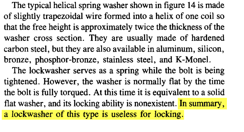

Split lock washers are useless (says NASA, 1990)
I am tired of re-locating this info, so I'm plunking it here.

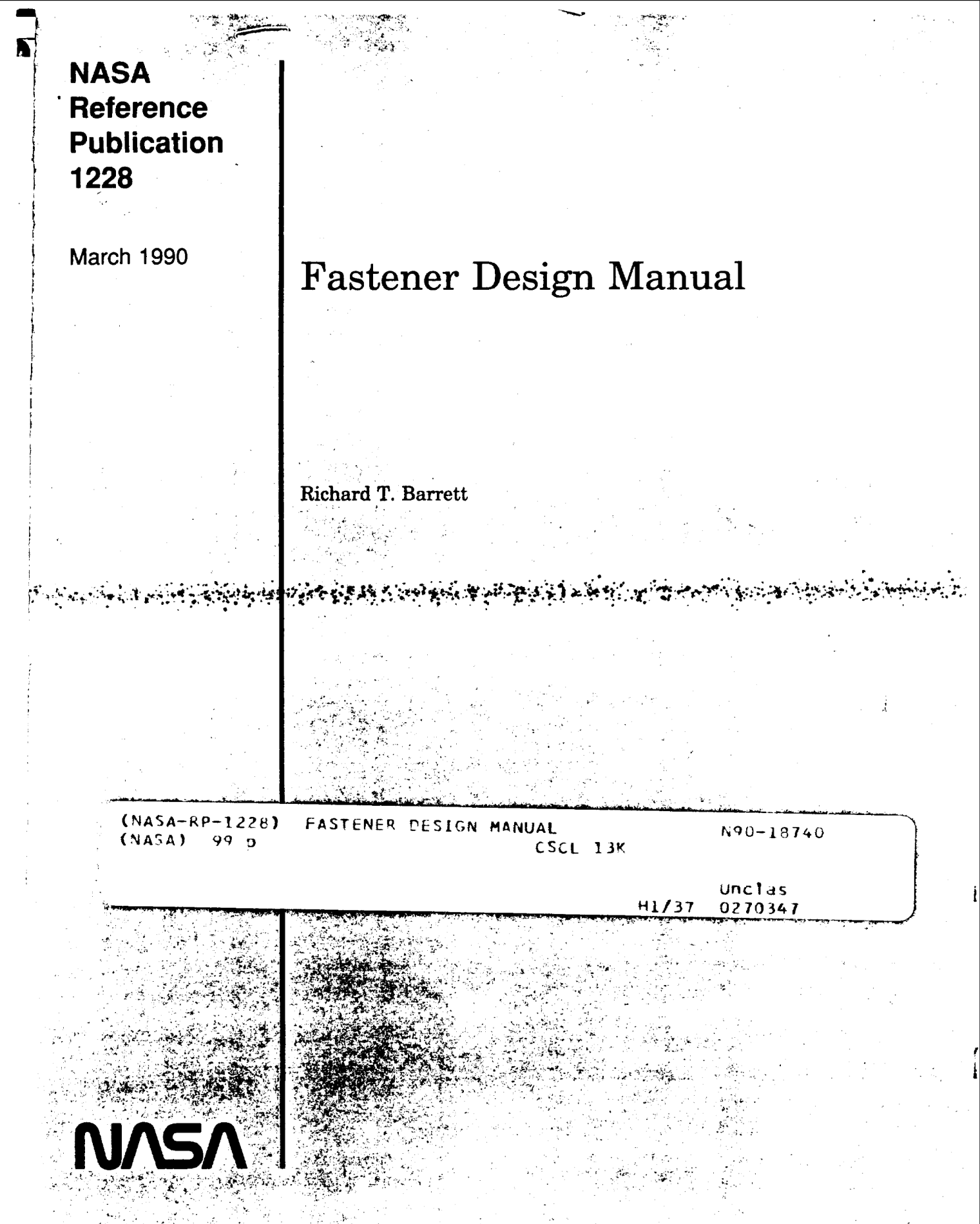

Fastener Design Manual - NASA Technical Reports Server (NTRS):
https://ntrs.nasa.gov/citations/19900009424
leads to:
https://ntrs.nasa.gov/api/citations/199 ... 009424.pdf
Screenshot from 2024-05-15 09-14-05.png (700.43 KiB) Viewed 4654 times

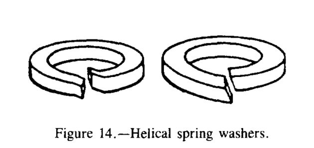

On pages 8/9:
Screenshot from 2024-05-14 05-55-37.png (259.53 KiB) Viewed 4654 times
Screenshot from 2024-05-14 05-56-16.png (48.08 KiB) Viewed 4654 times
