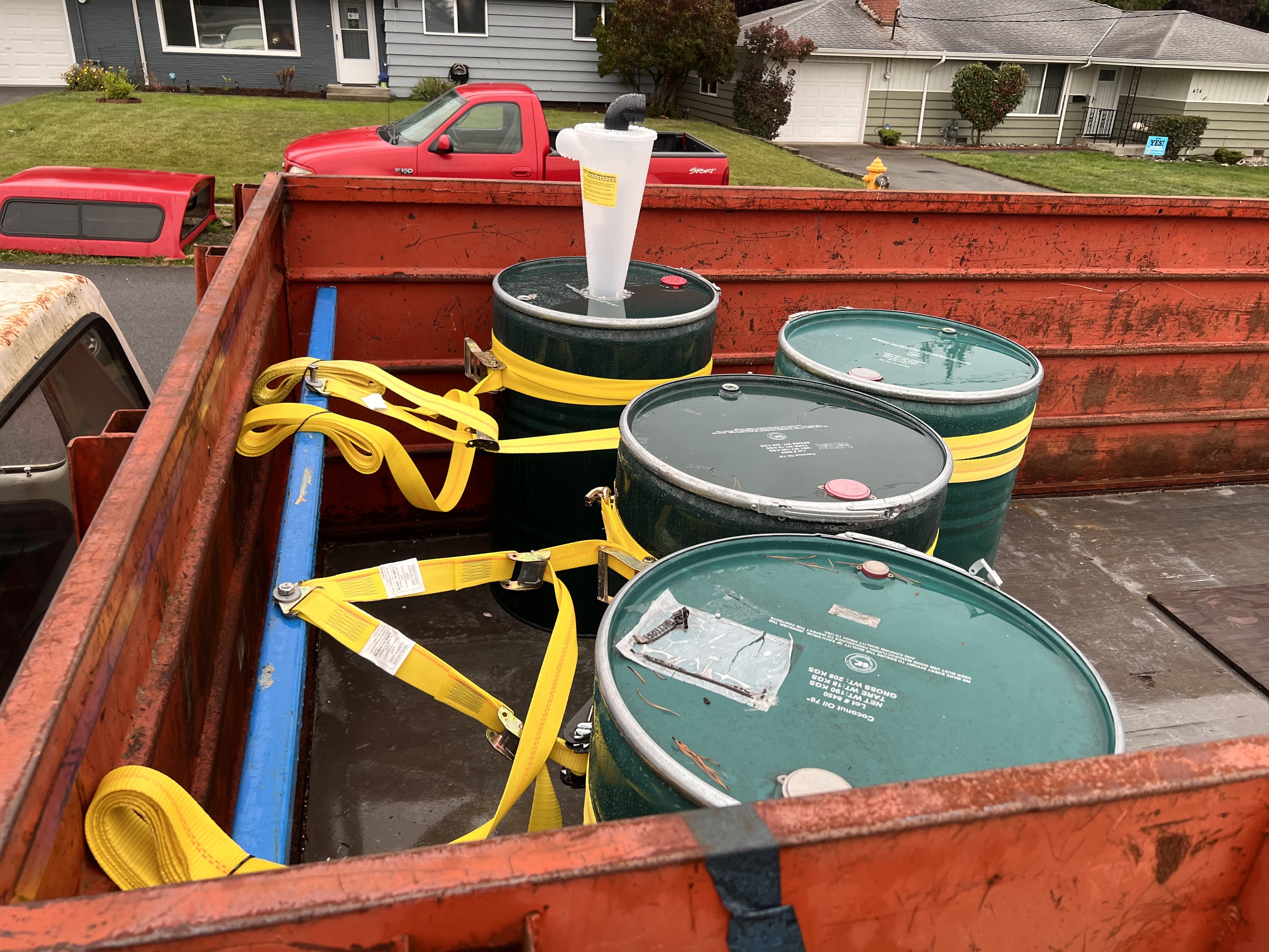

Idea from a YT vid.
Kevin used a couple of the larger cyclonic separators in series, 3" manifolding, and three generic shop-vac style powerheads in a neighbor-friendly enclosure:

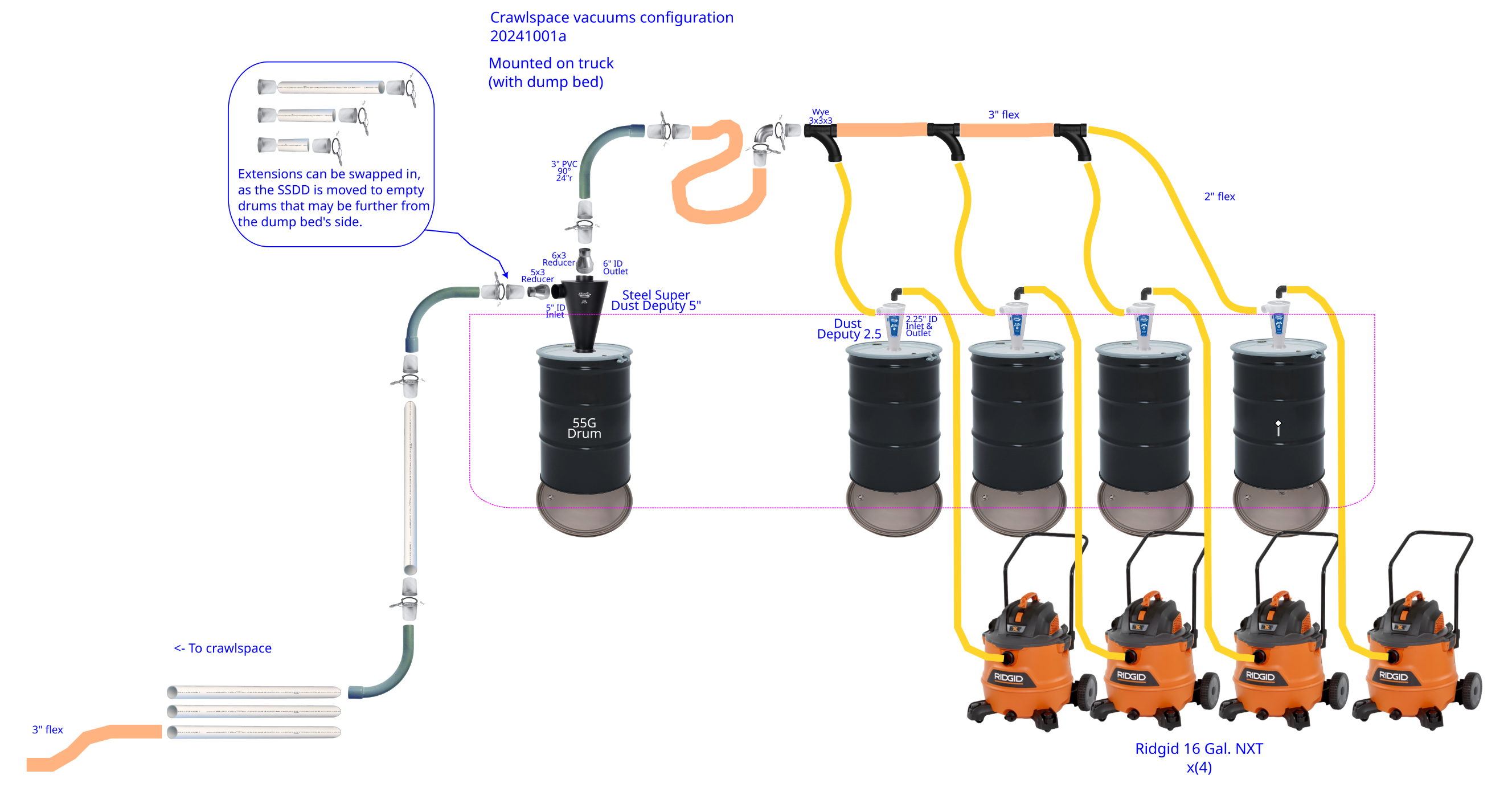

My current plan:

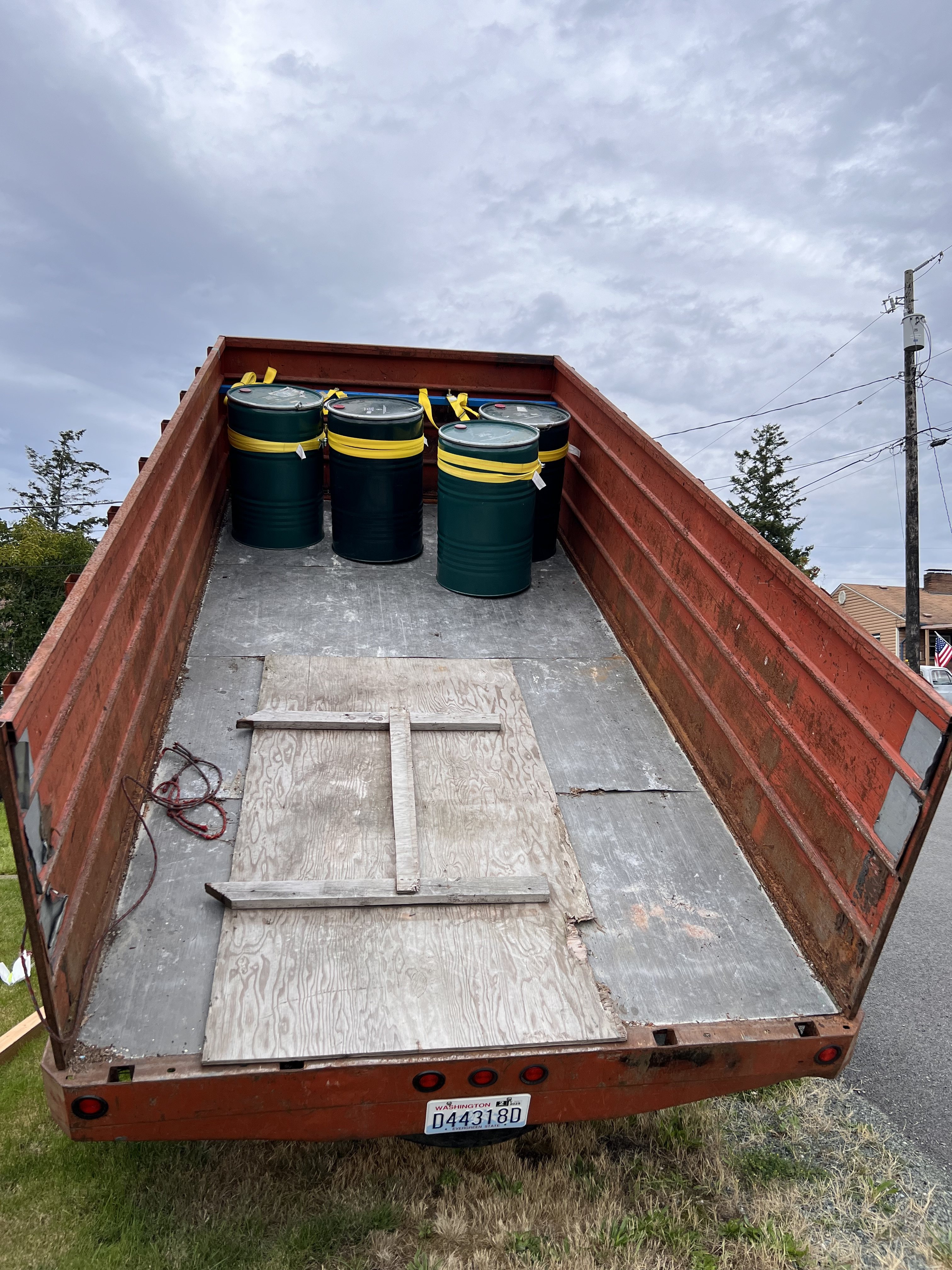

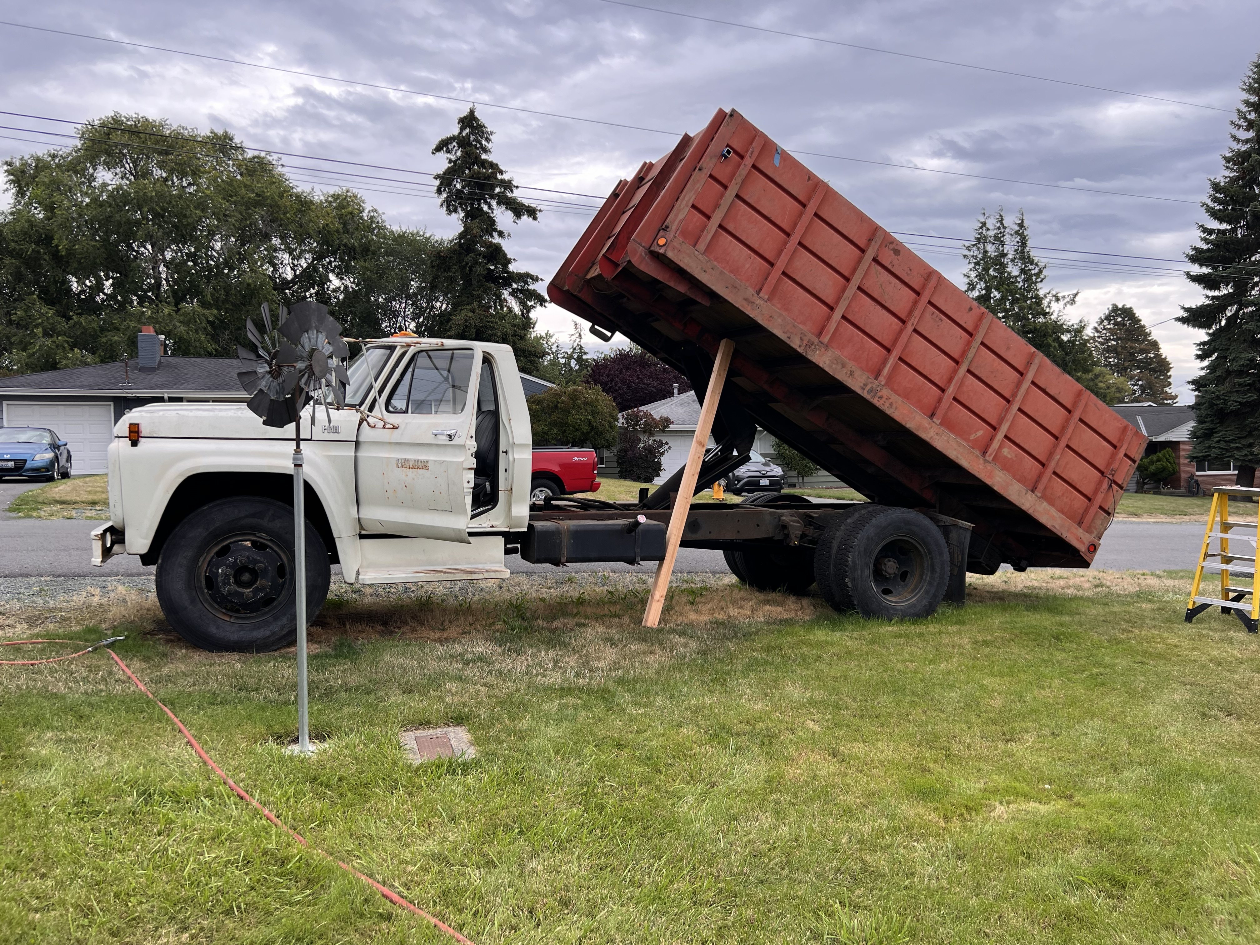

Dirt is collected in drums that are situated on a dumping truck. Drums are open on the bottom and restrained by straps near their tops. When the bed is raised, the drums should rotate close to parallel with the truck's bed, allowing the dirt to empty from the drums, but the drums remain strapped from the front of the bed. After lowering the bed, the drums can be placed upright again. I have enough room for around (24) drums, and I have that many stored for use.
The cyclonic separators are attached to drum lids, which can be moved to empty drum(s) as the drums fill.
The primary separator is steel and larger than the secondary separators. Almost all of the dirt will separate into its drum, and that drum will have an ultrasonic level sensor, installed in the lid, to warn when it's near full. Normally, it lights a red strobe; depending upon how reliable this sensor is, it might be used to turn off the vacuums.

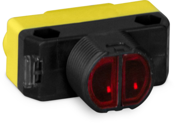

Infrared Dust Sentry Bin Fill Level Indicator
https://www.oneida-air.com/dust-deputy/ ... -indicator

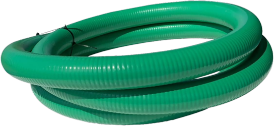

Suction Hose, 3" Gloxo (stiff)
3x20
https://www.amazon.com/Gloxco-Suction-T ... B0989BKCQ3

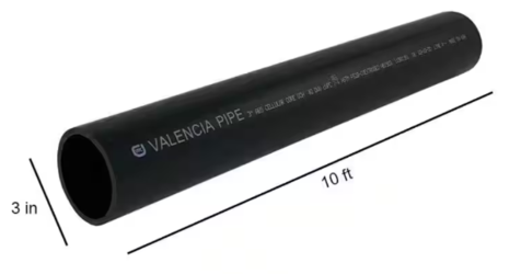

Duct Pipe, 3" x 10' ABS DWV
https://www.homedepot.com/p/IPEX-3-in-x ... /309282460

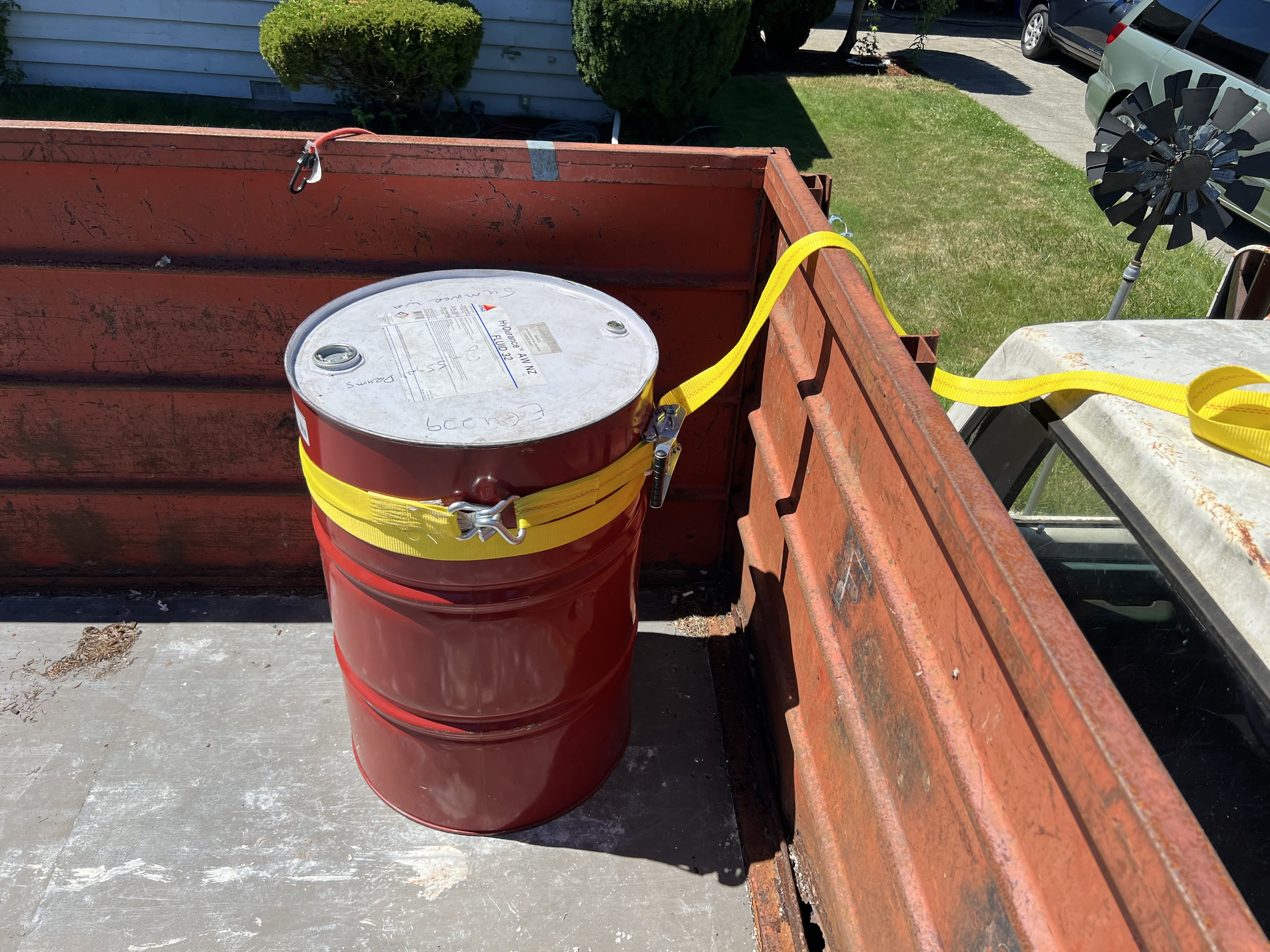

View of drum restraint system, and one of the secondary separators installed:
Spare drums awaiting their bottoms removed:

My current plan:

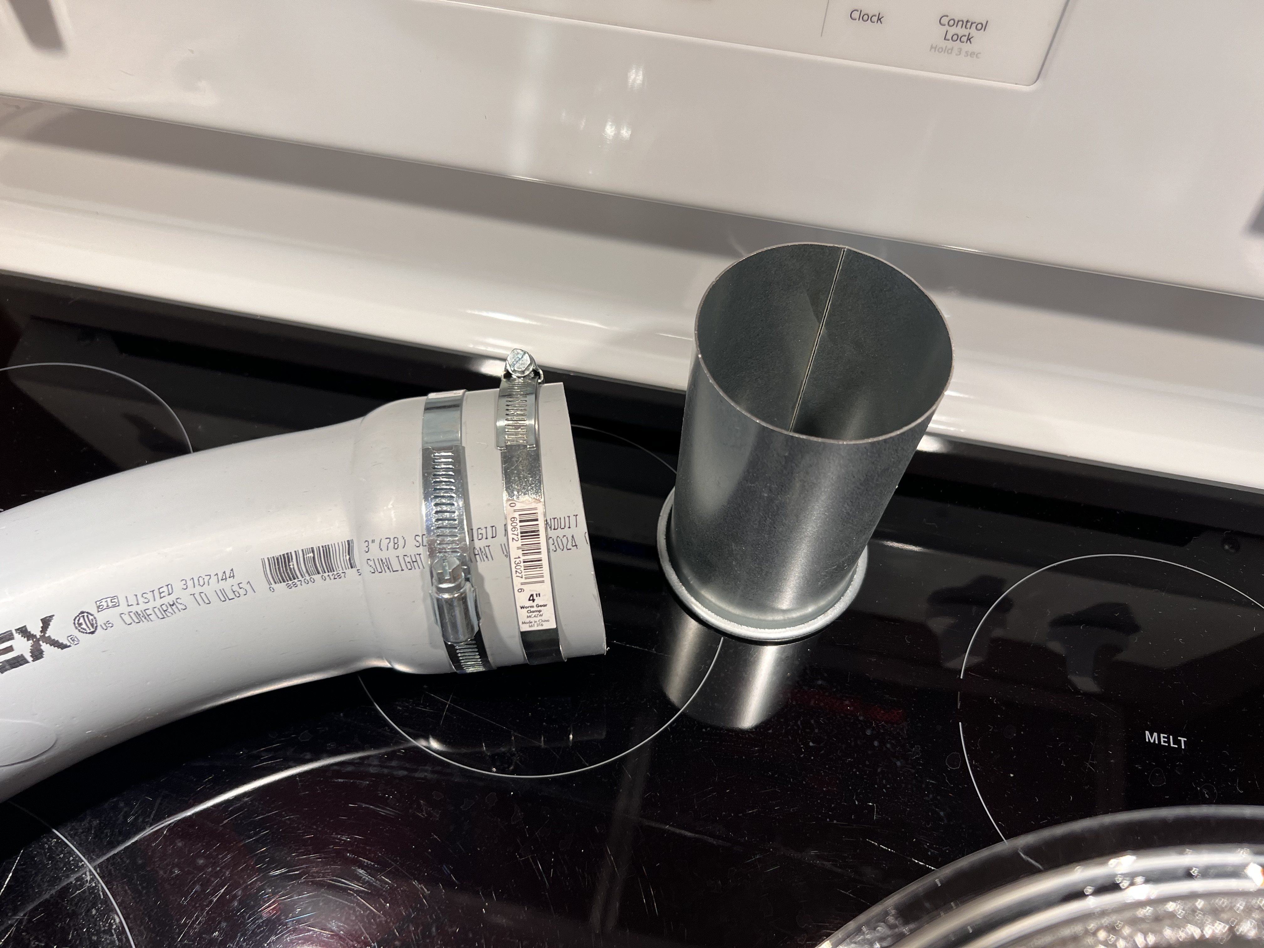

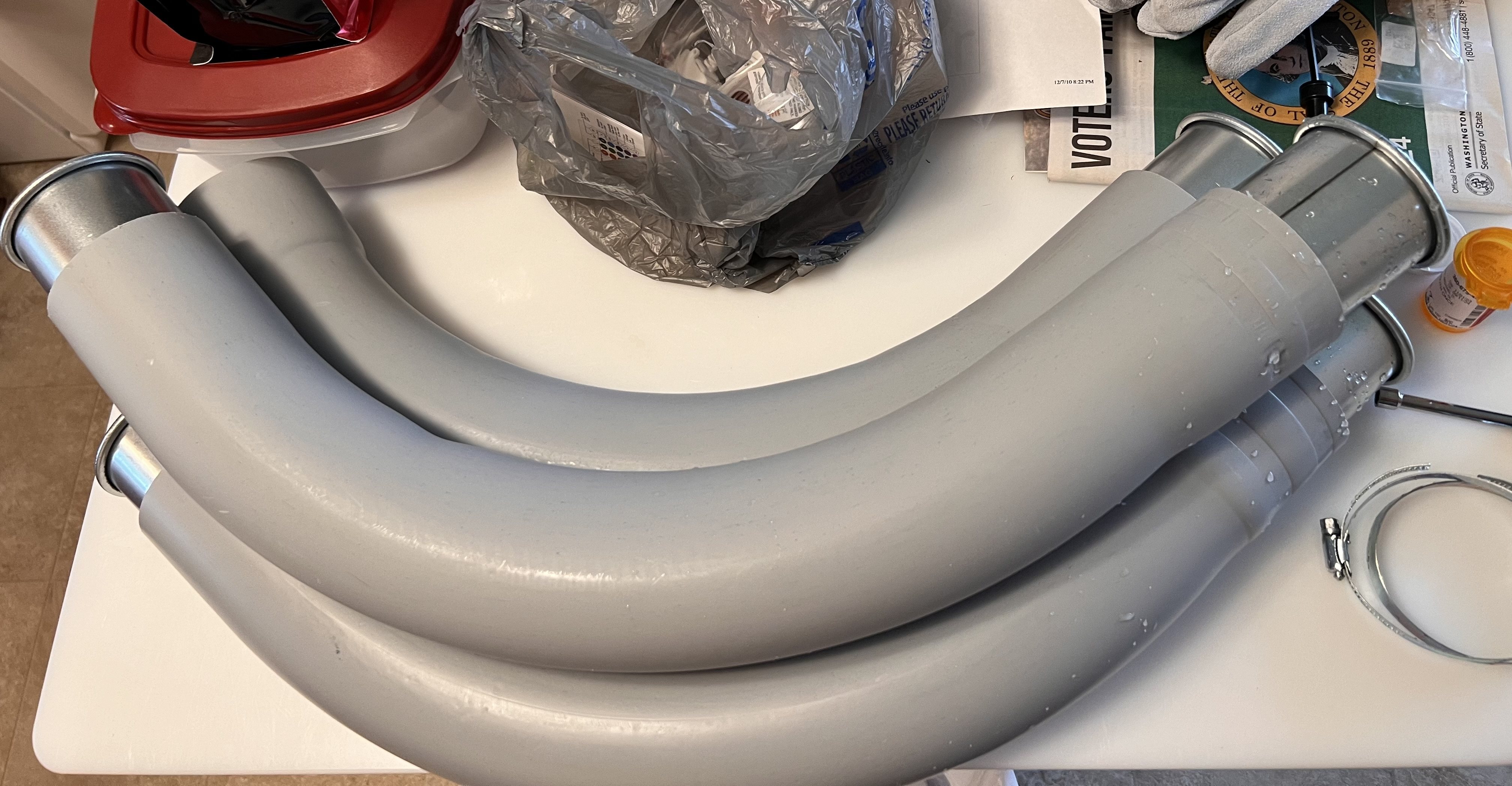

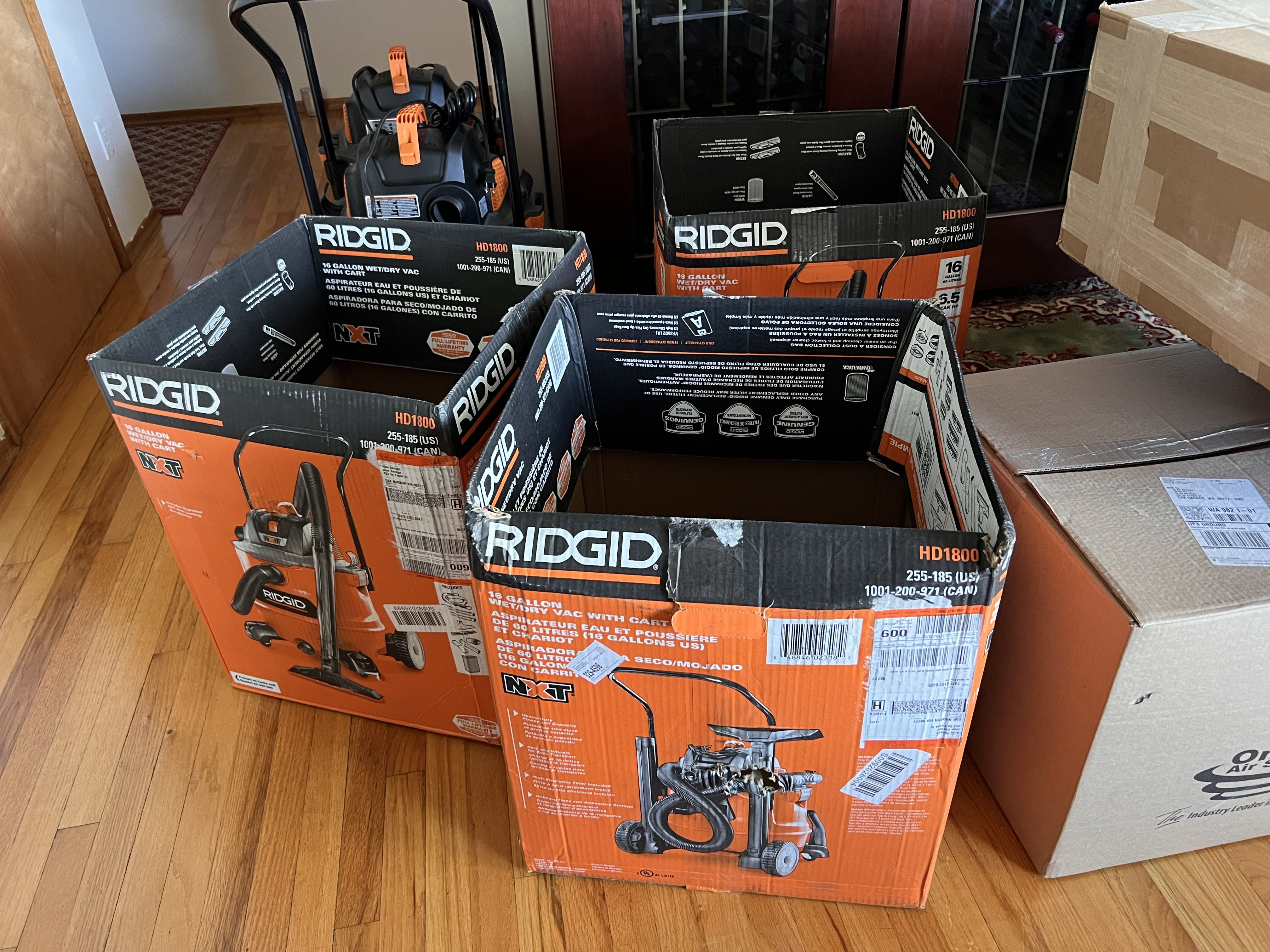

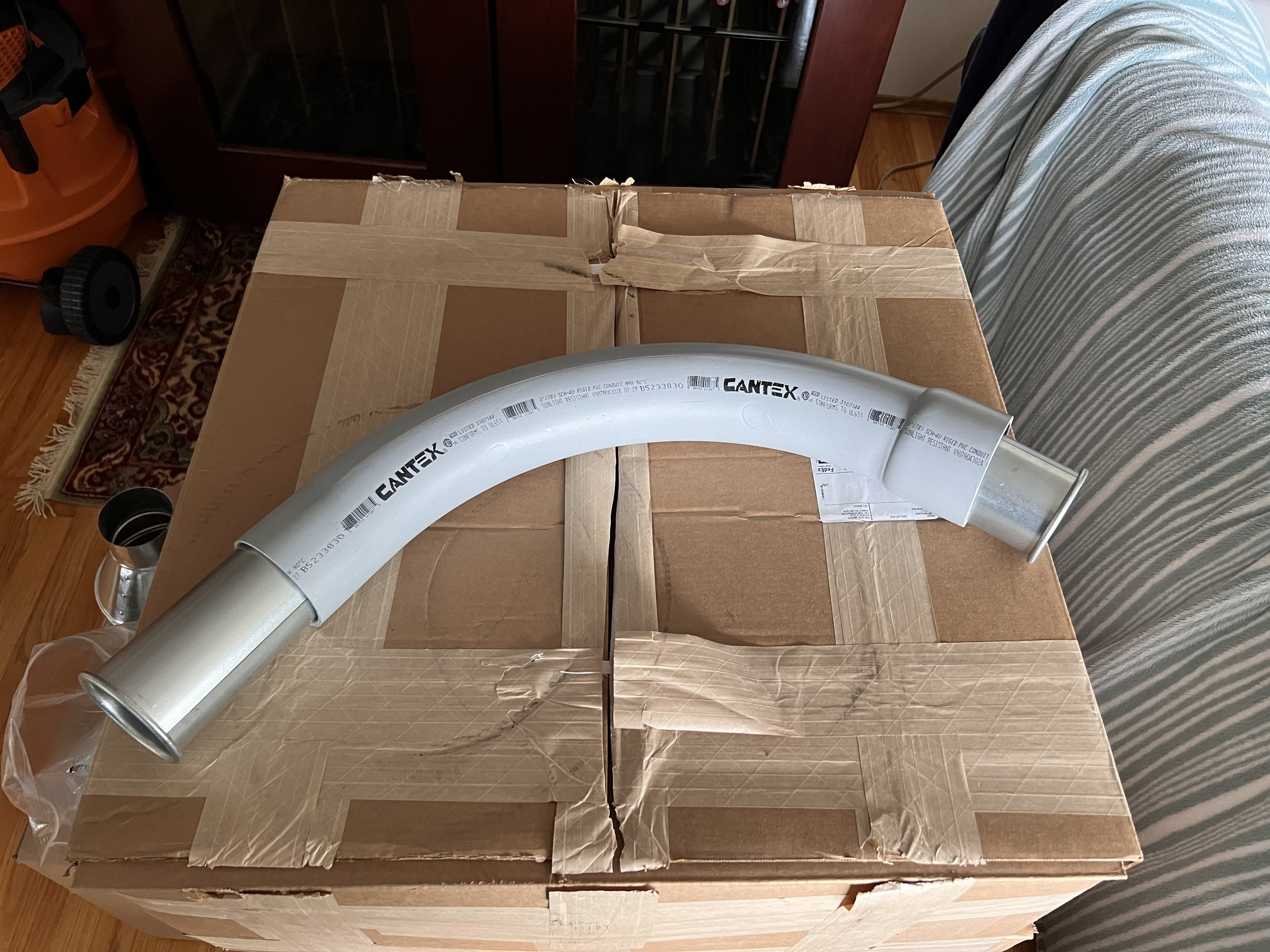

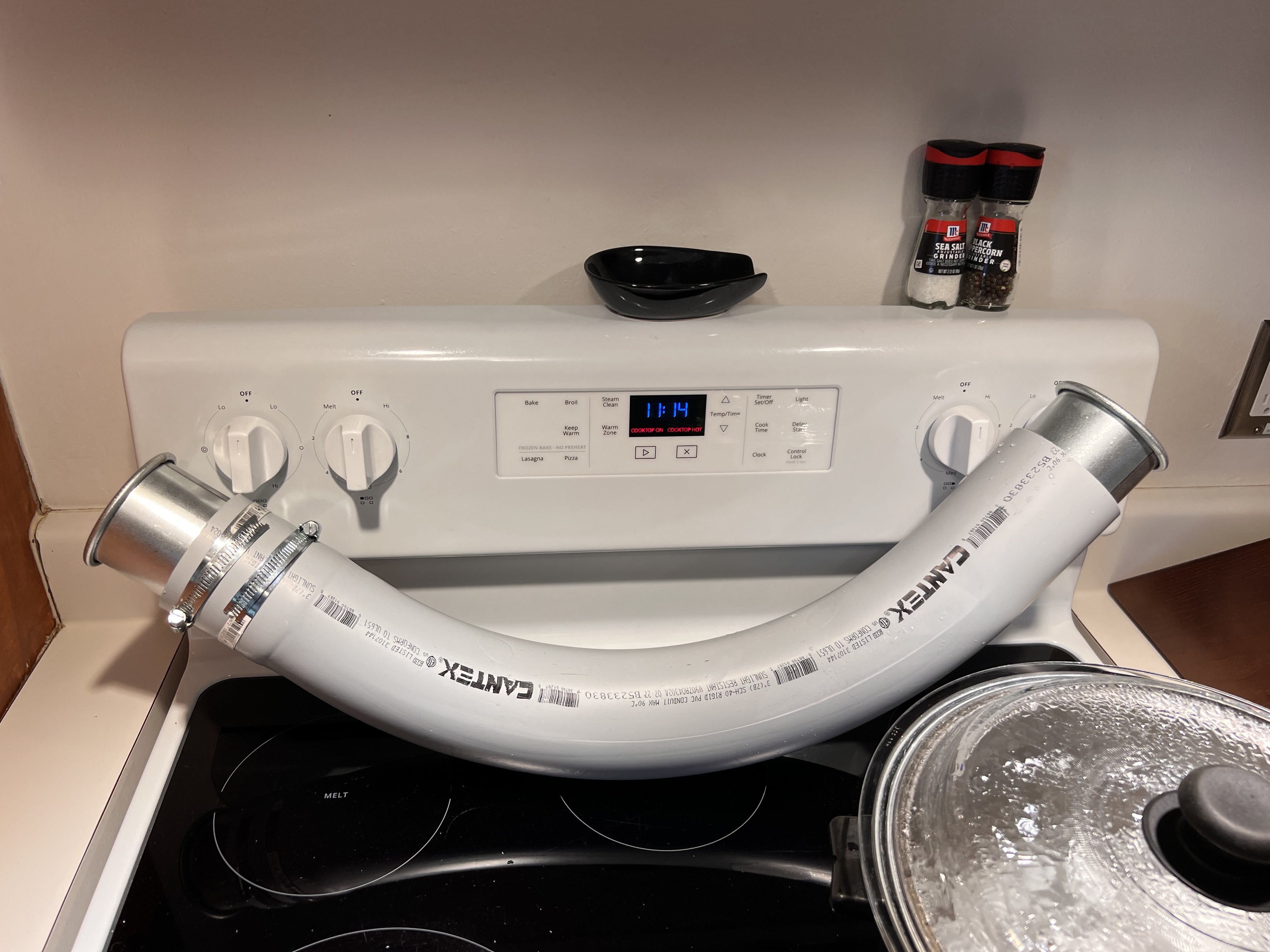

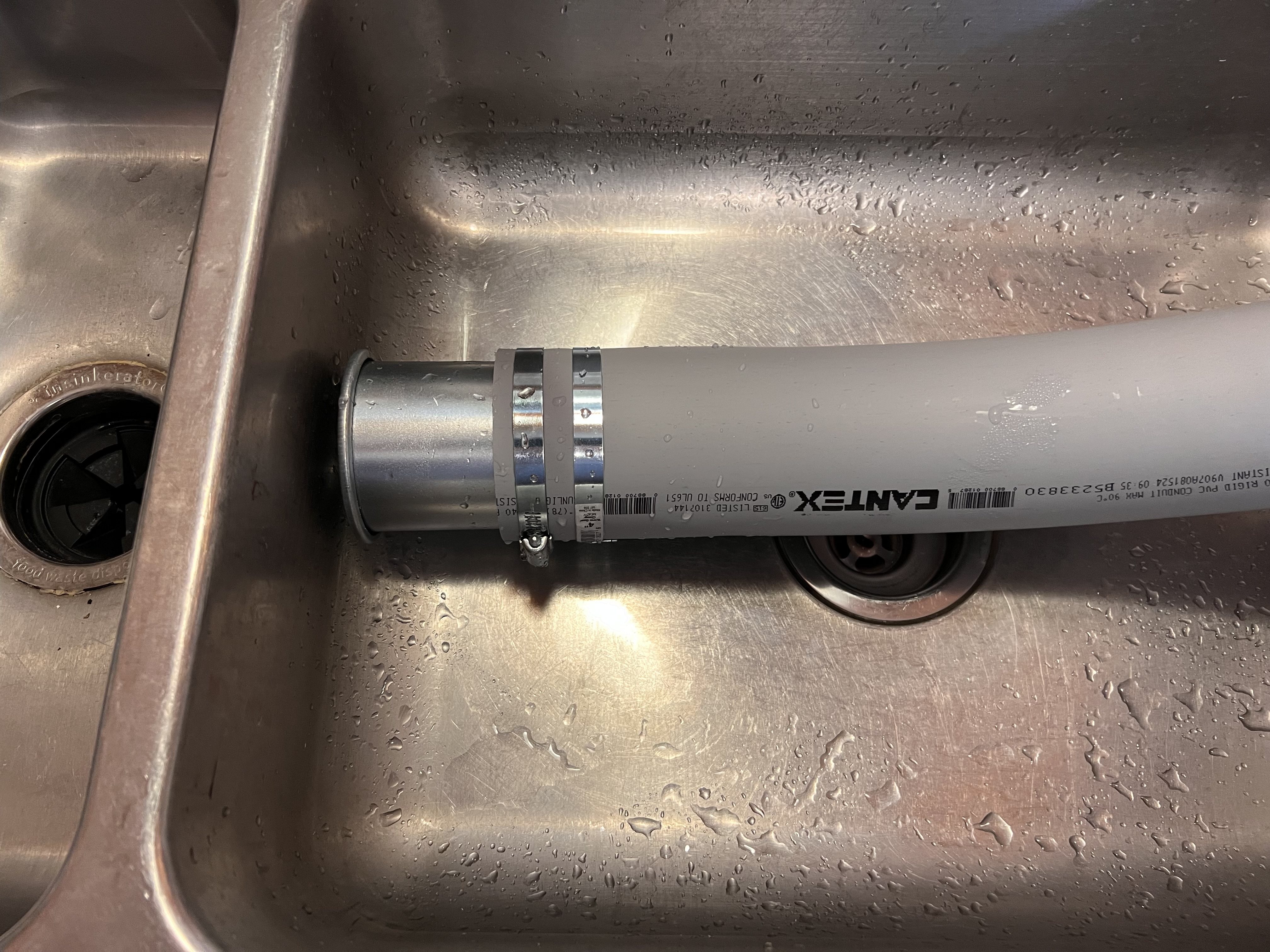

The vacuums have arrived. They don't come assembled, and judging from the condition of the boxes they (mostly) arrived in, they must be made of reasonably good stuff. The first one took 20 mins. to assemble, but after that only about 10 mins. ea.:

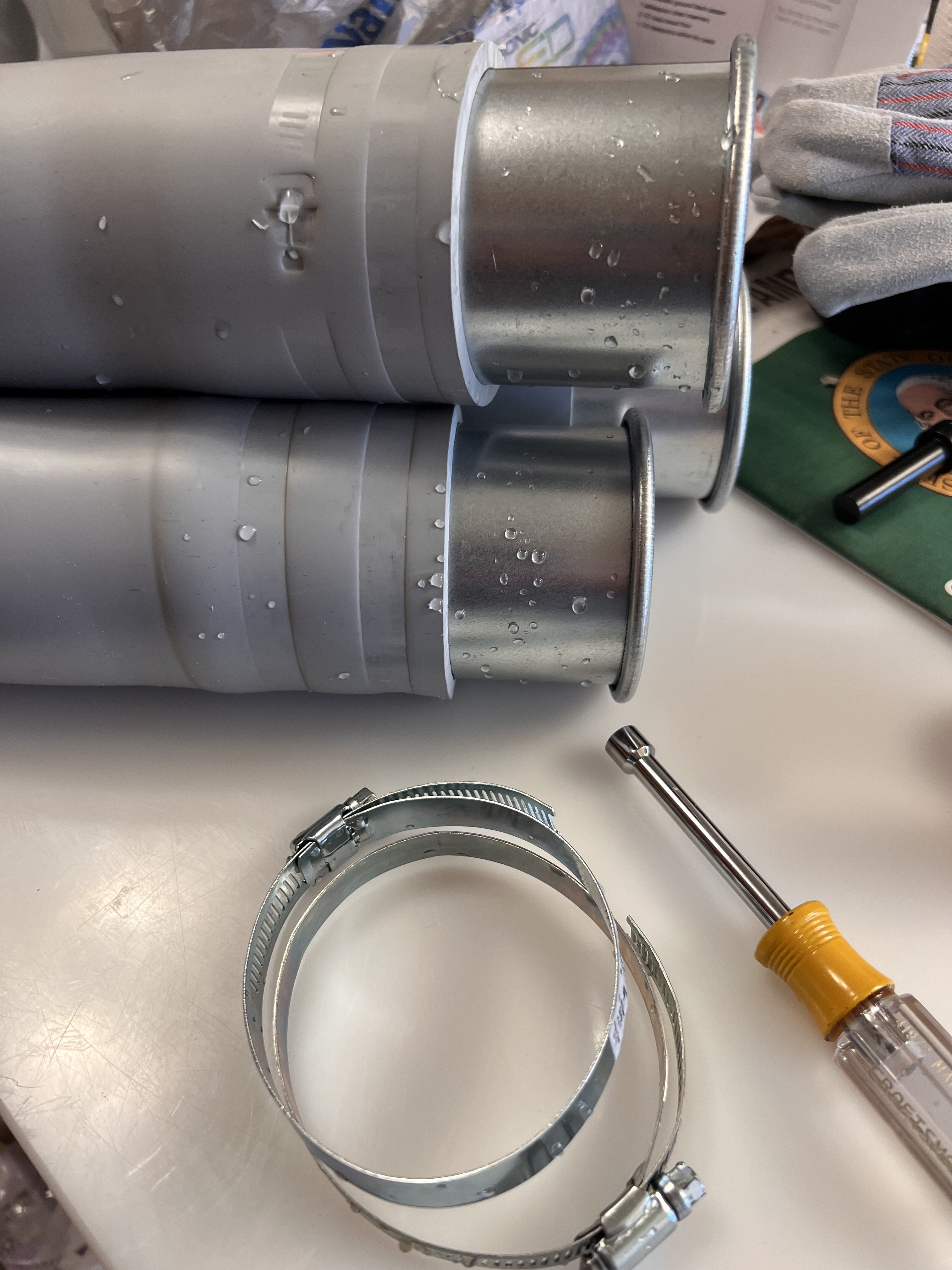

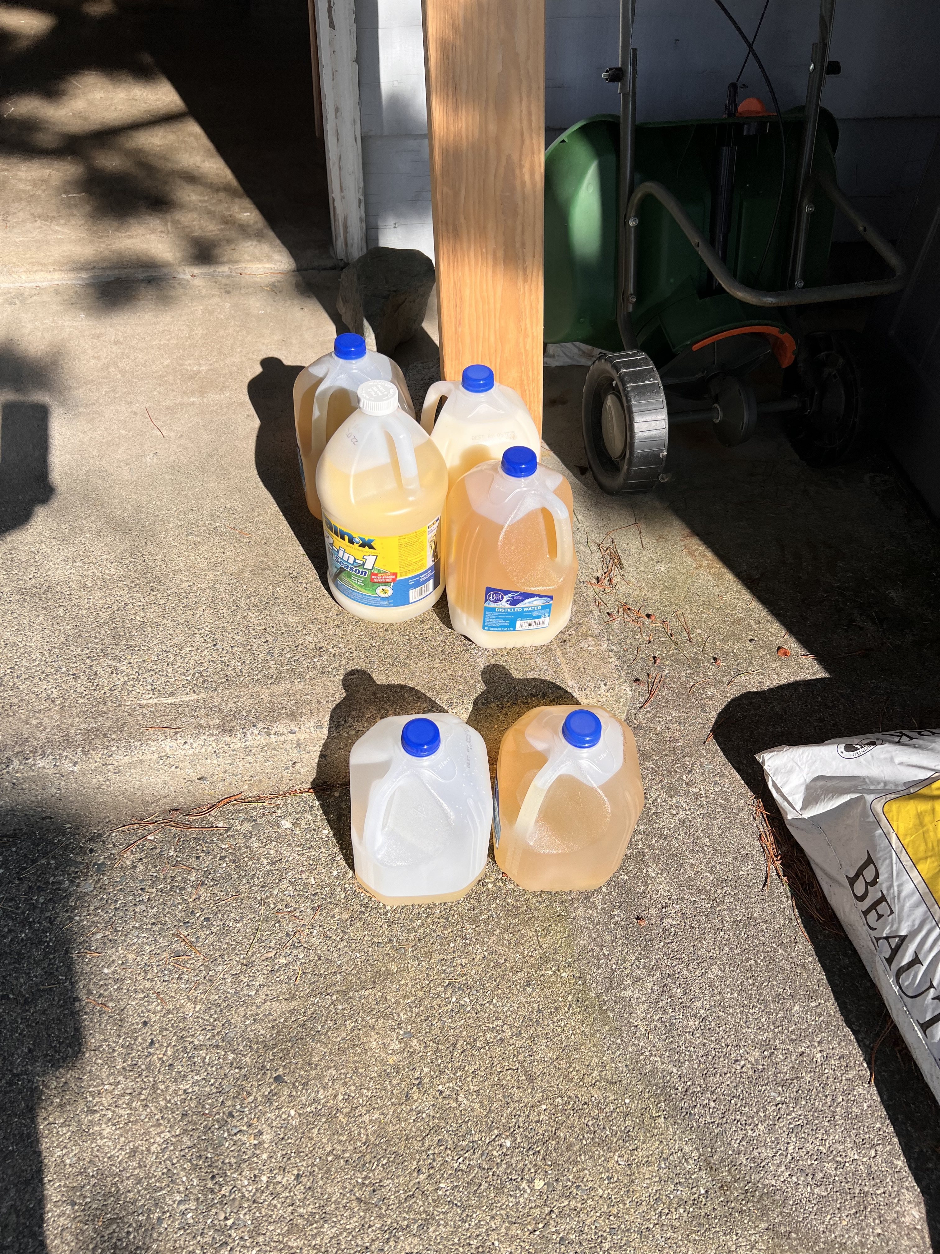

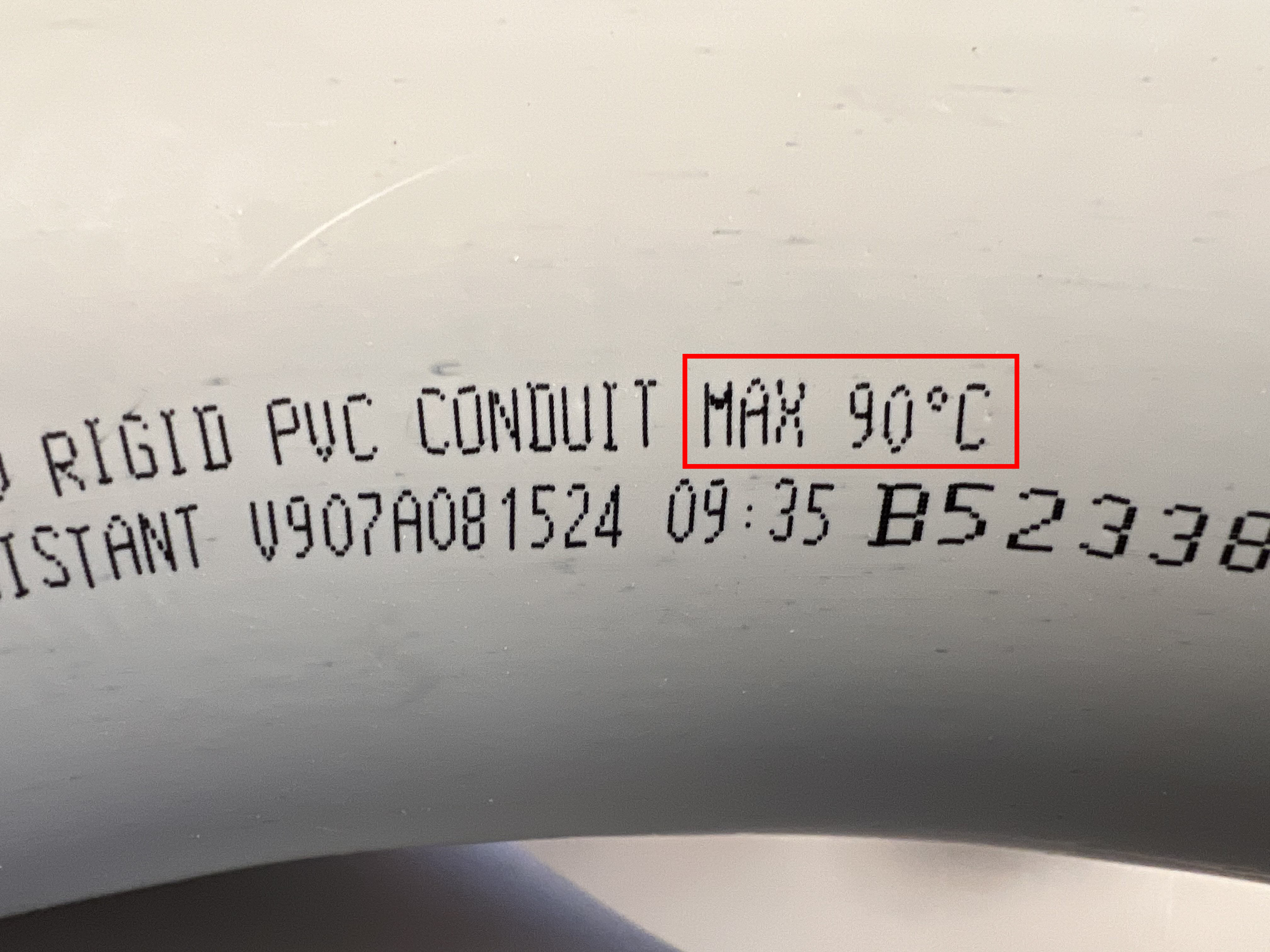

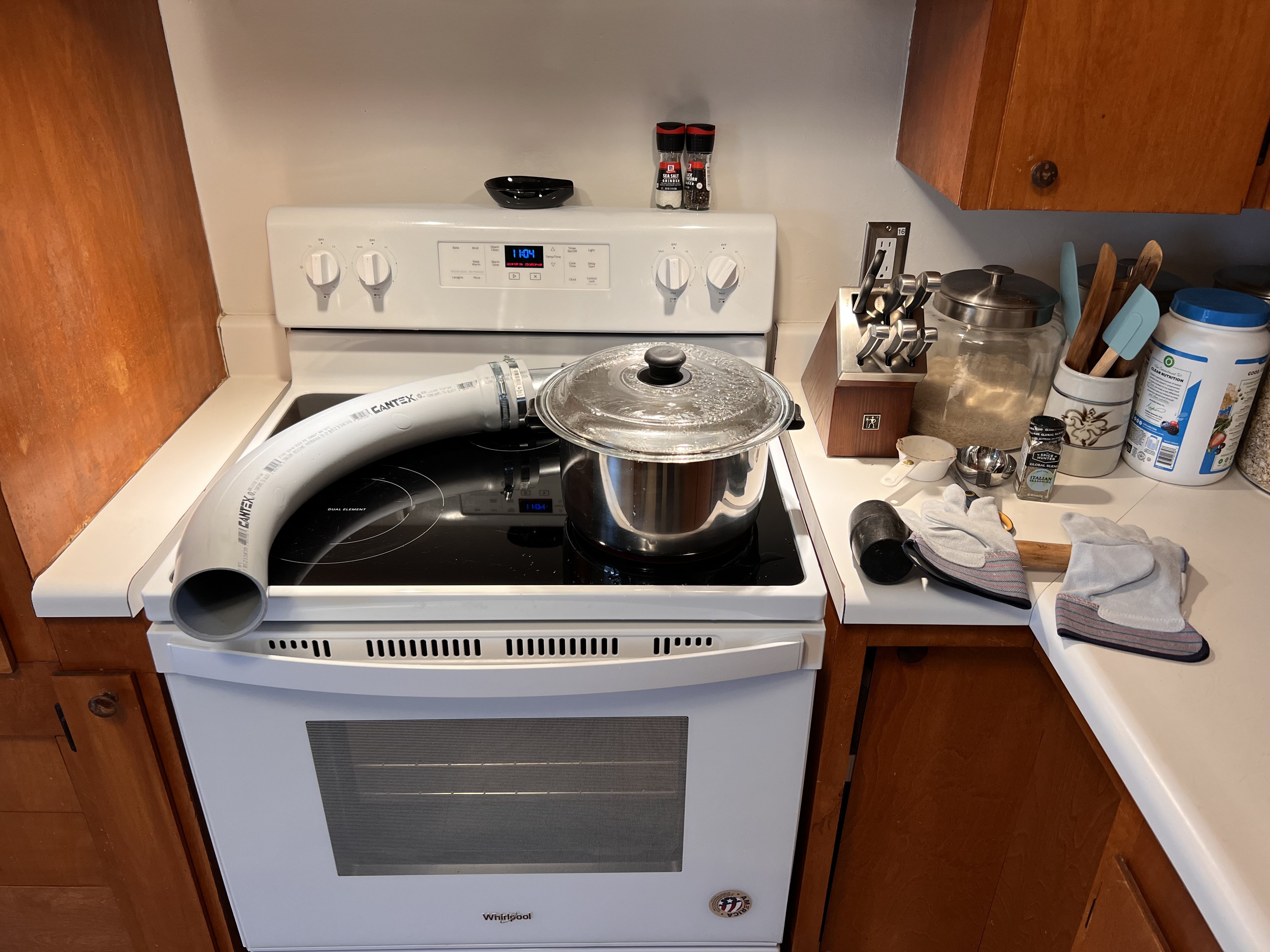

I learned last night that common PVC is hand-formable (within reason) at the temperature of boiling water (100°C). I mated some of the Quick Change "machine adapters" (couplings) to the 3" PVC 90° elbows, using hot water, hose clamps, and leather gloves. Fun stuff! Most internet references to forming PVC use hot air guns or hot sand, but for re-forming ends (not making bends from straight sections), hot water is a lot more even and controllable, plus you can't make nasty fumes by accident using boiling water.
The couplings don't slip-fit on either end of the Cantex 3" 90°
But . . .
Dip an end into boiling water for 60 secs. (30 is not enough) and one can just hand-push the coupling into the straight end, which was a no-go fit at room temp.
The bell-end is very loose on the coupling, but after 60 secs in boiling water, the bell-end snaps back almost to its original straight-pipe dimension. From there, the hose clamps make the fit tight. Re-dip in the boiling water for a bit, then pull out, re-tighten clamps a bit, then cool with cold water.
I'll probably put a bead of silicone around where the coupling meets the PVC, but I doubt it's necessary. These fit tight.
But . . .

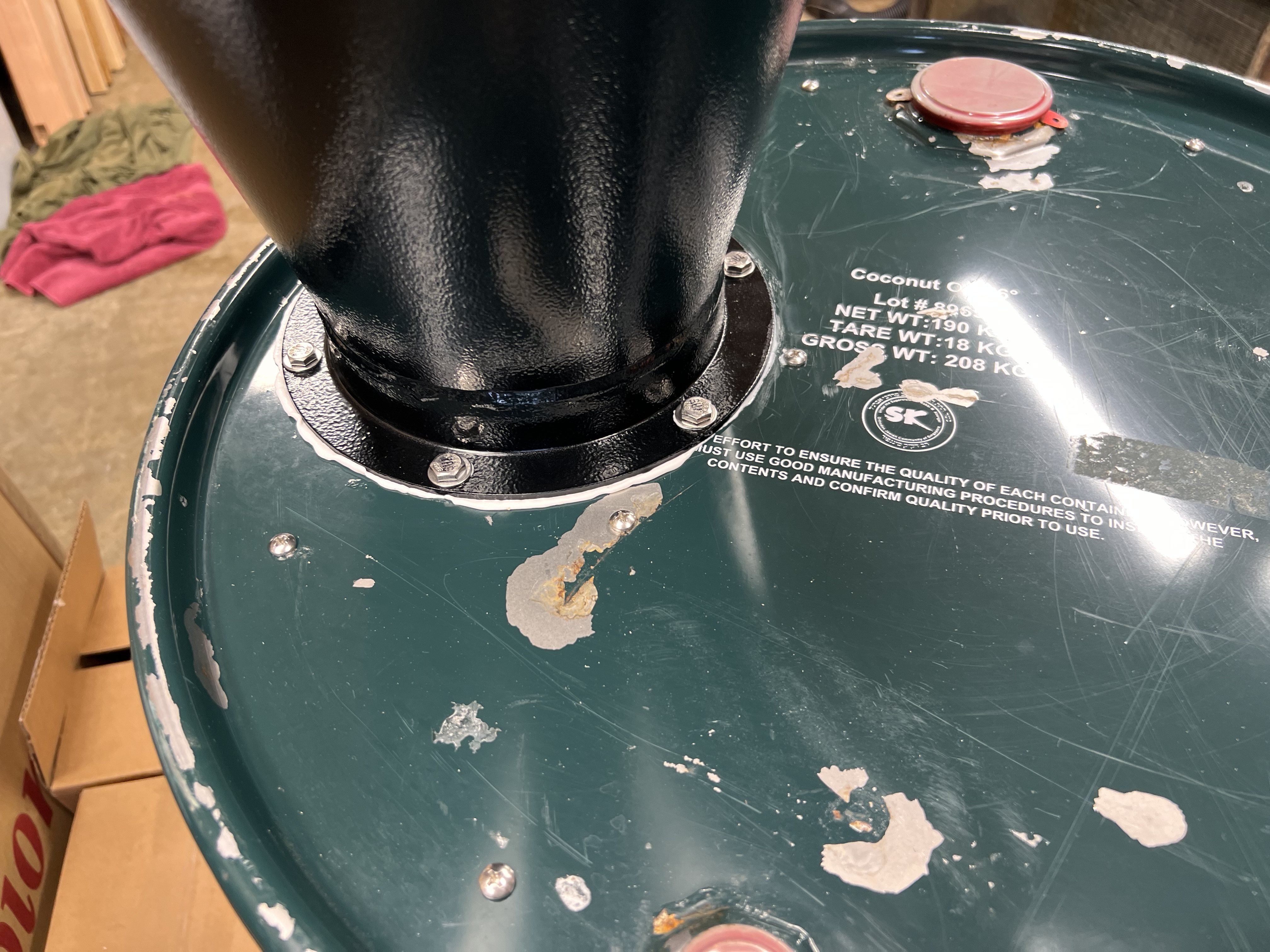

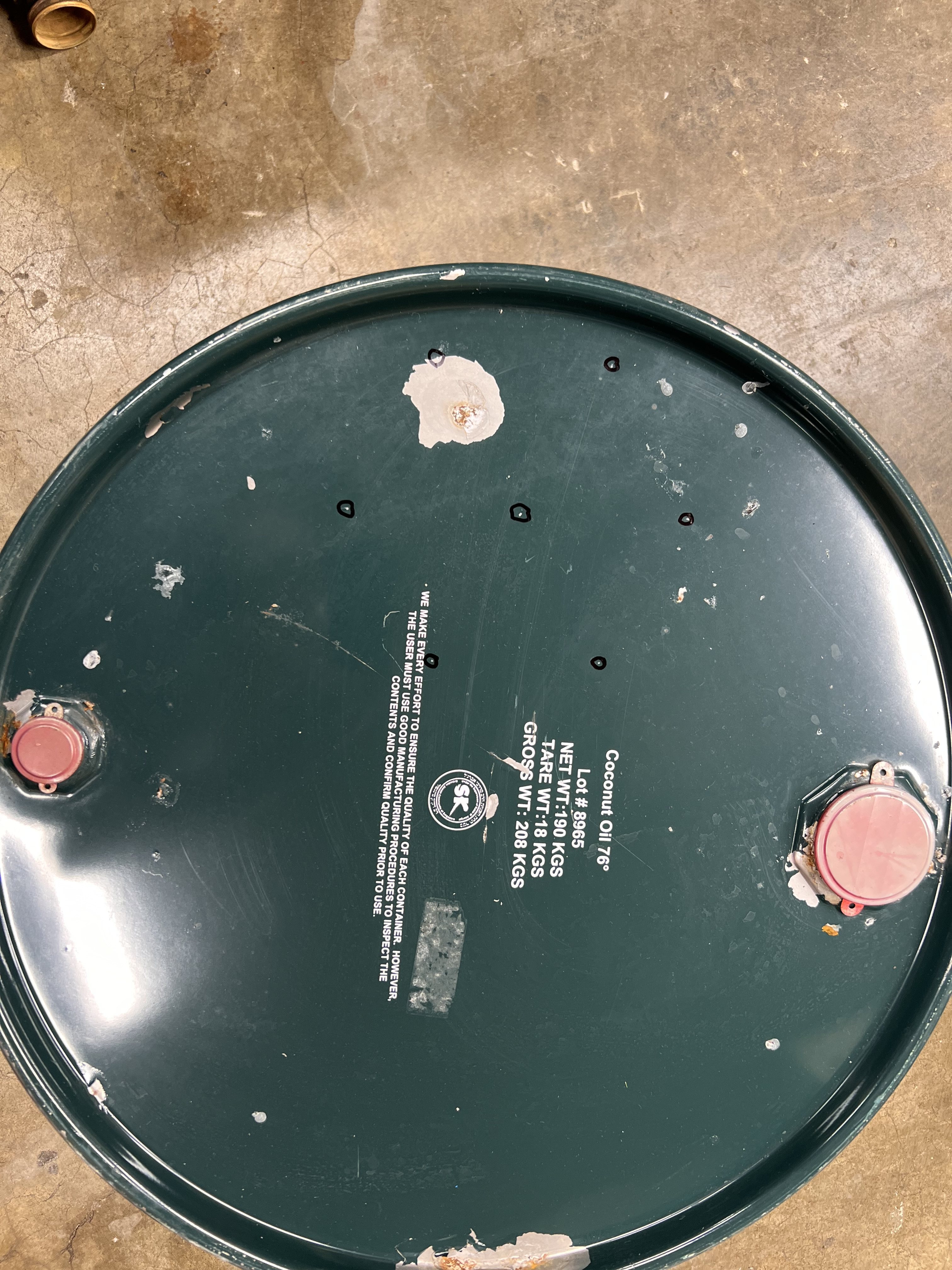

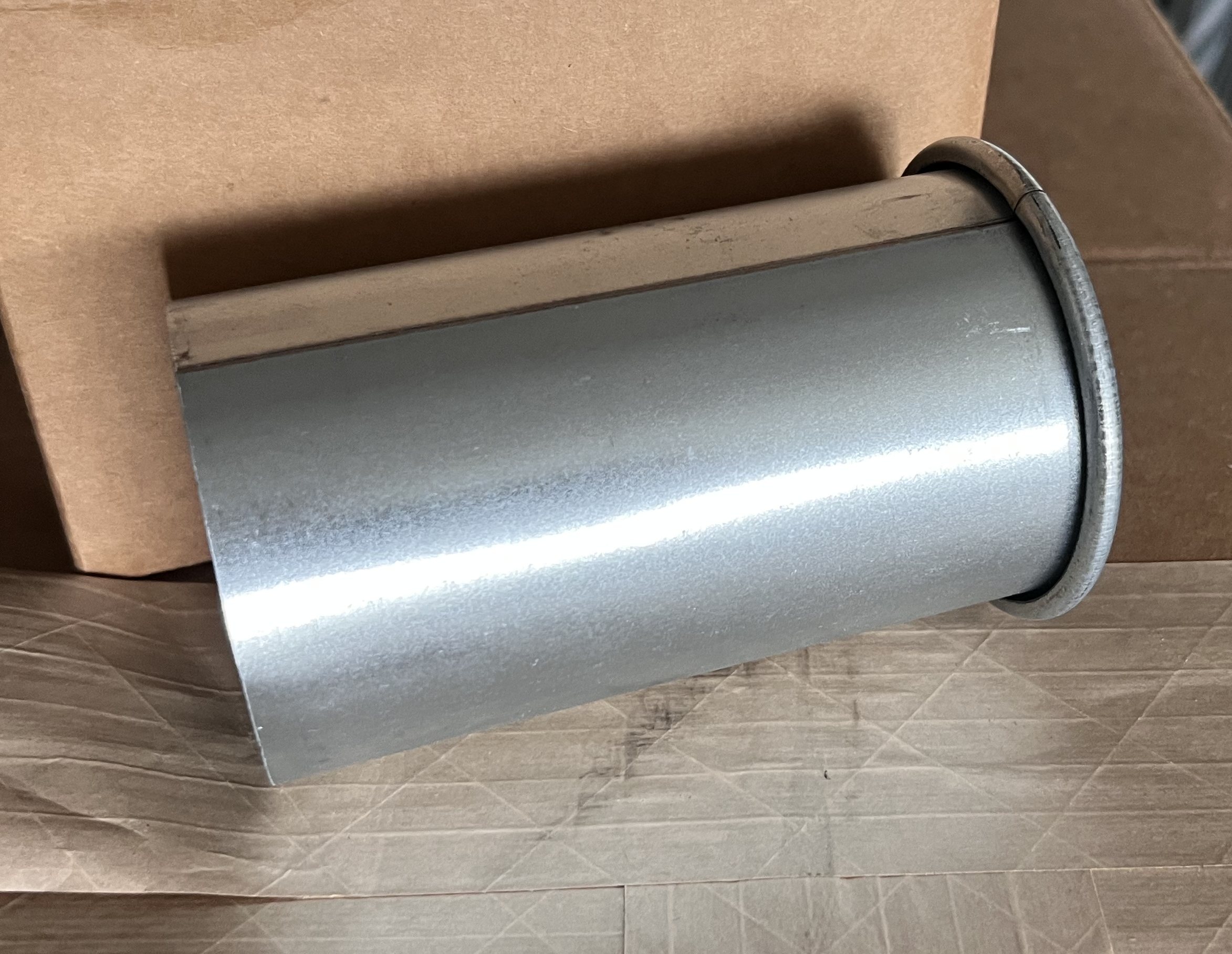

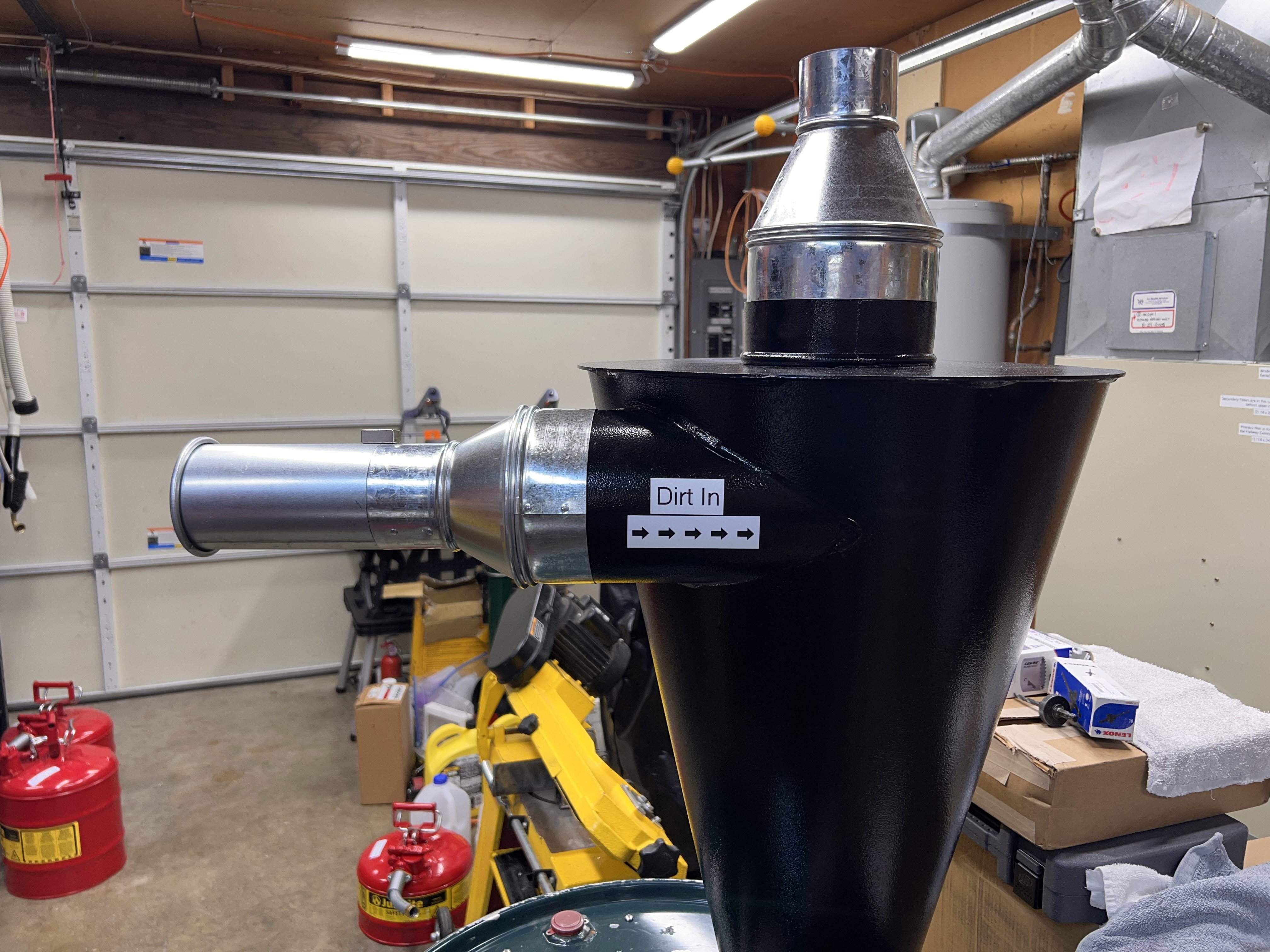

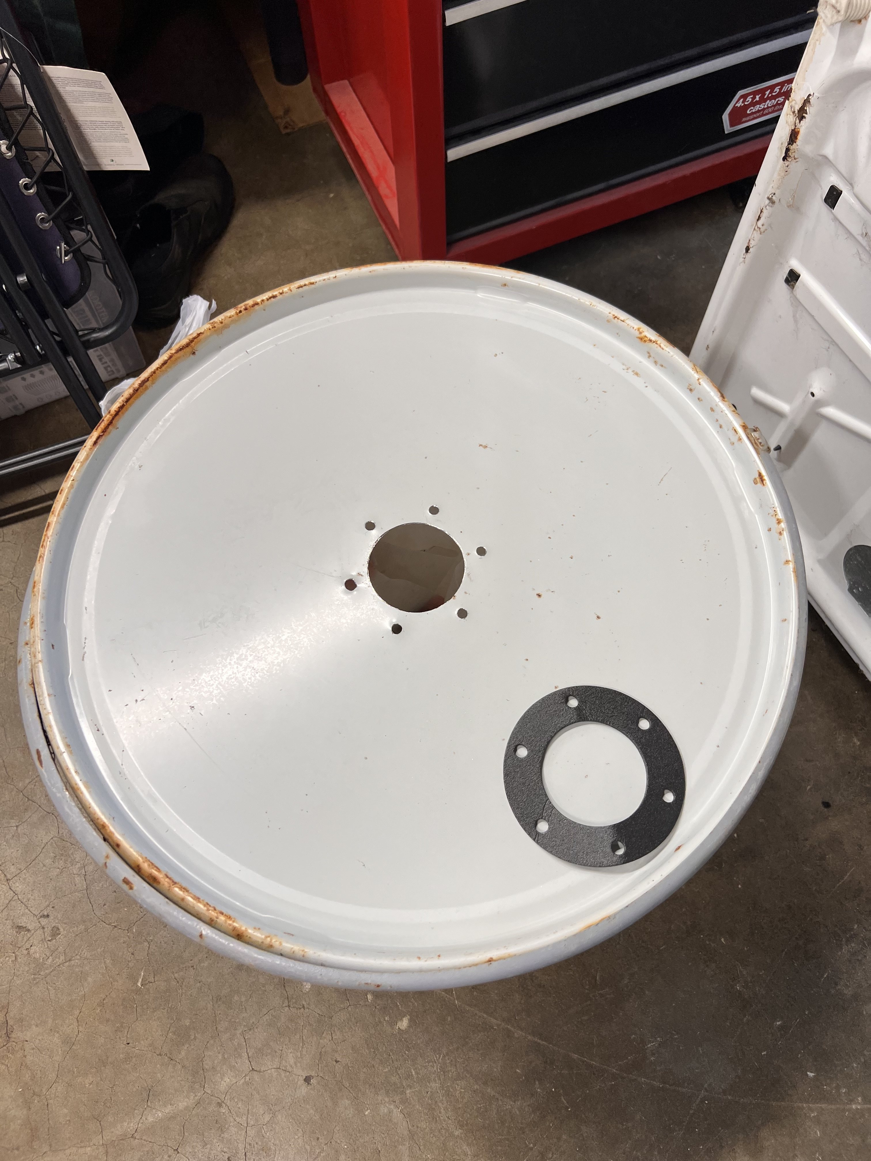

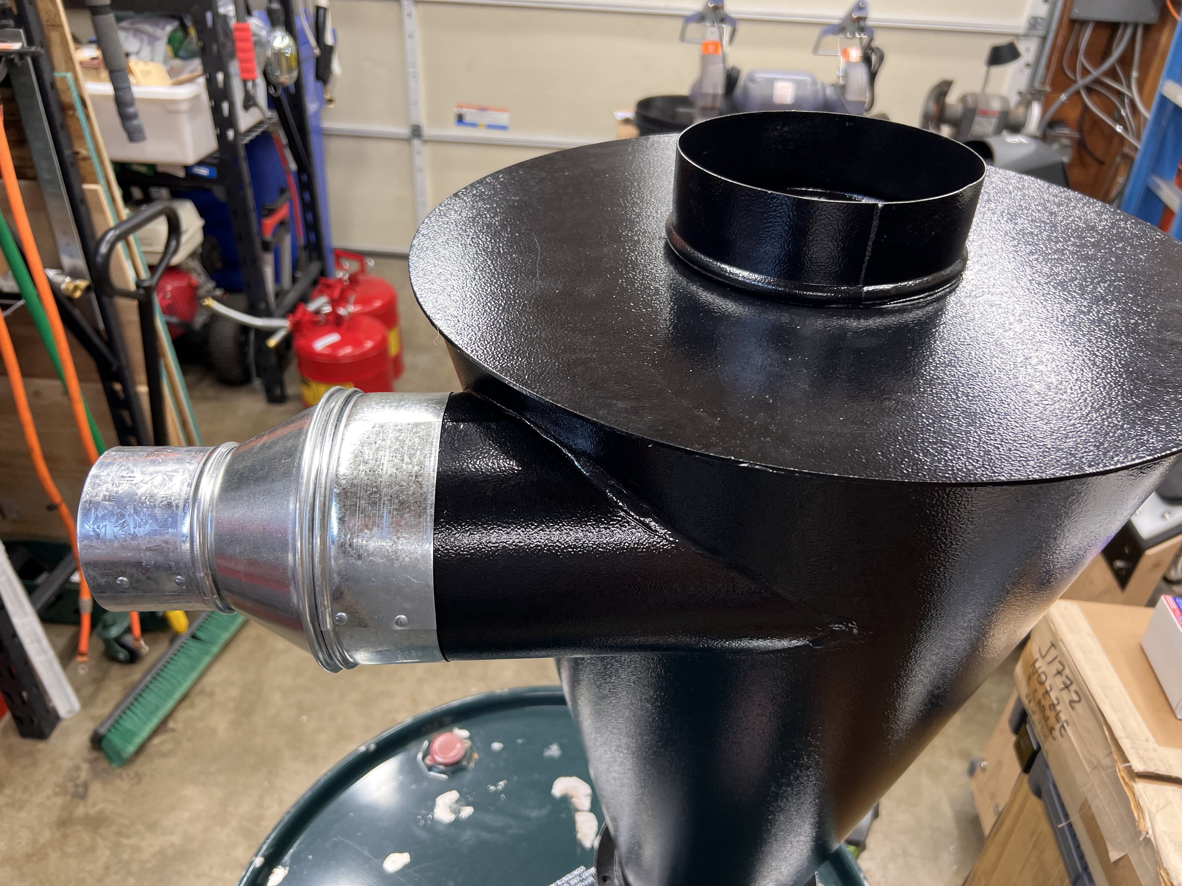

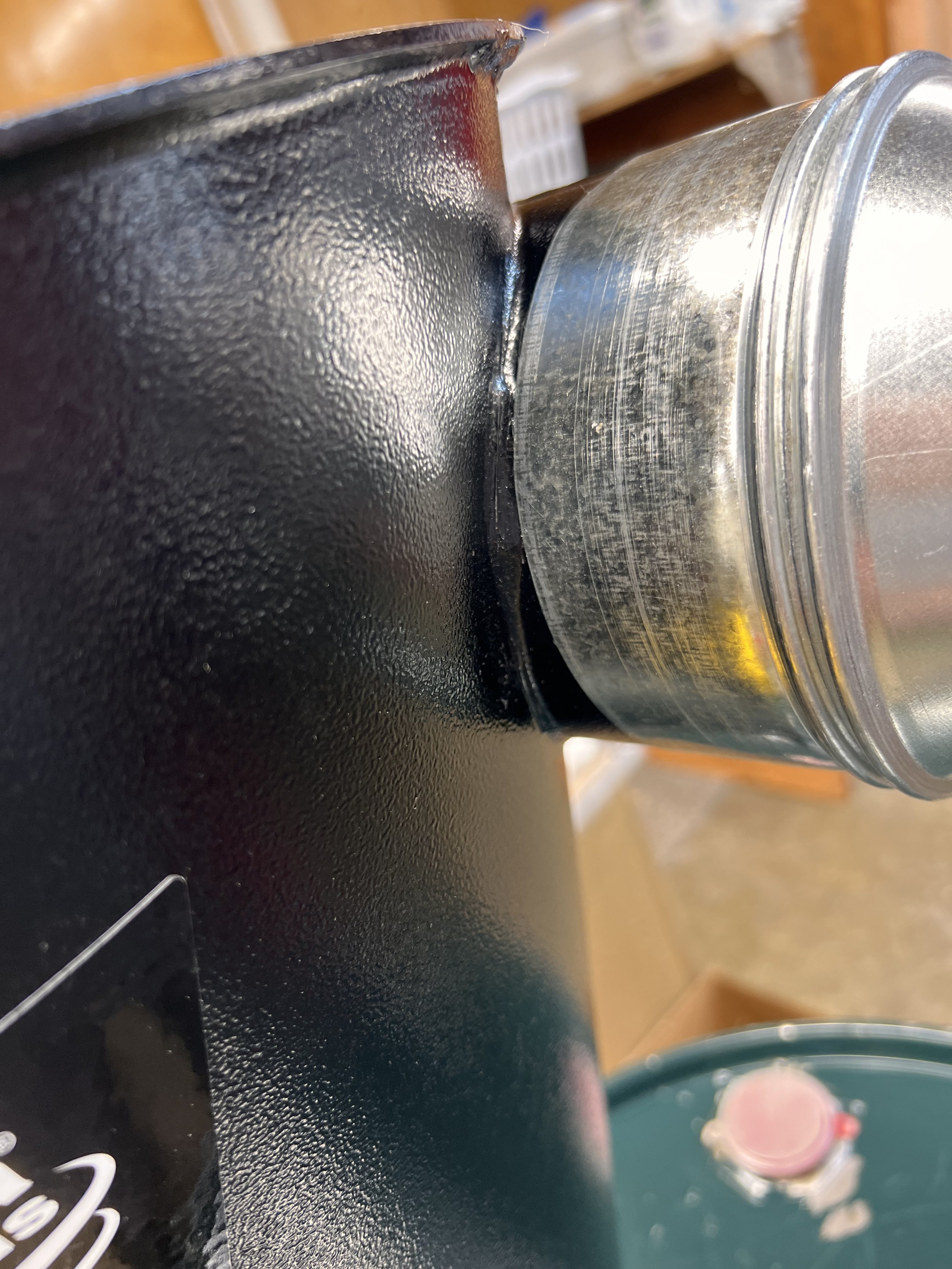

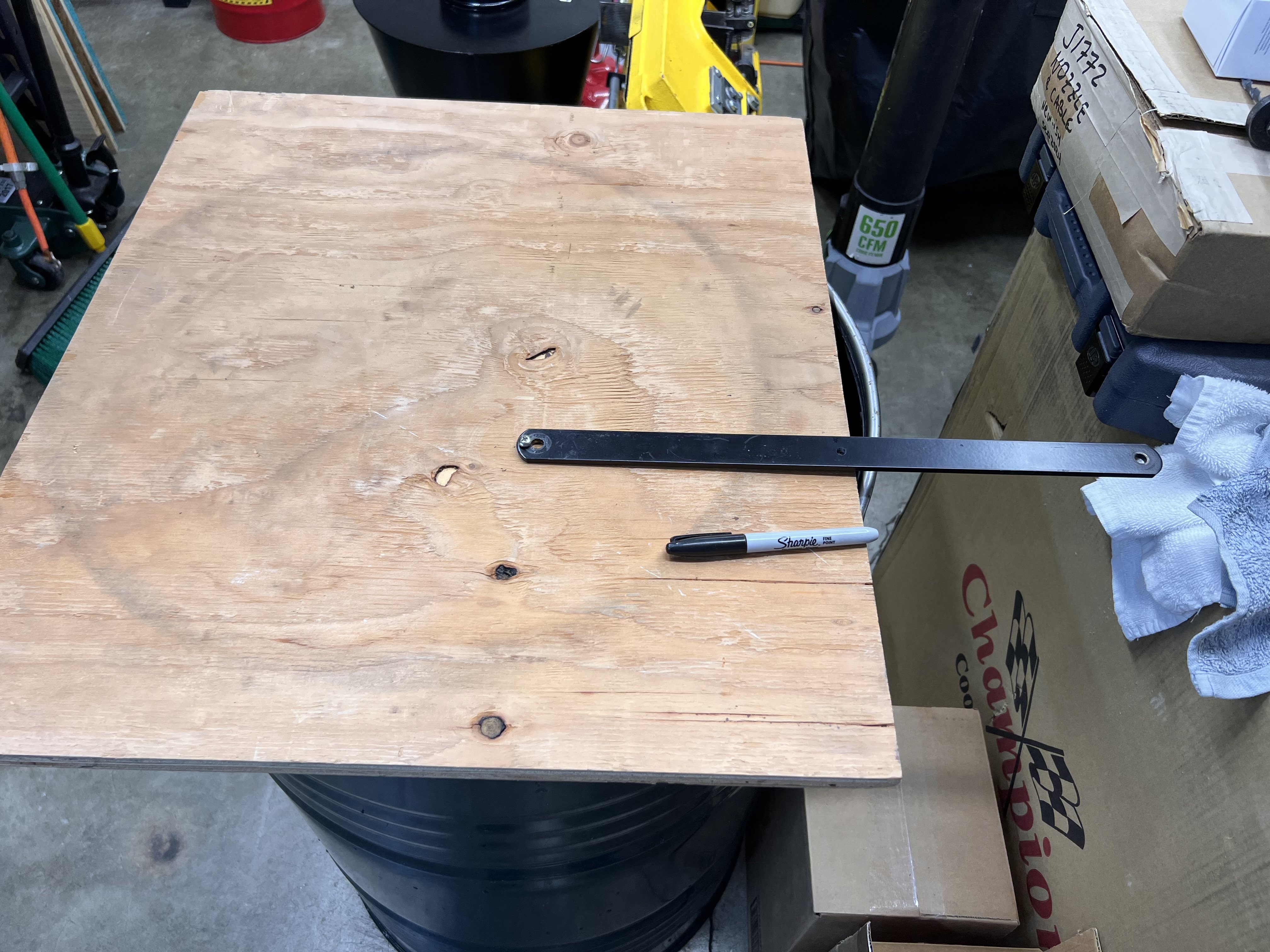

The Steel Super Dust Deputy (the large one) arrived last week. It has a 5" inlet (the one on the side), and a 6" outlet. I'm going to try feeding it via 3".

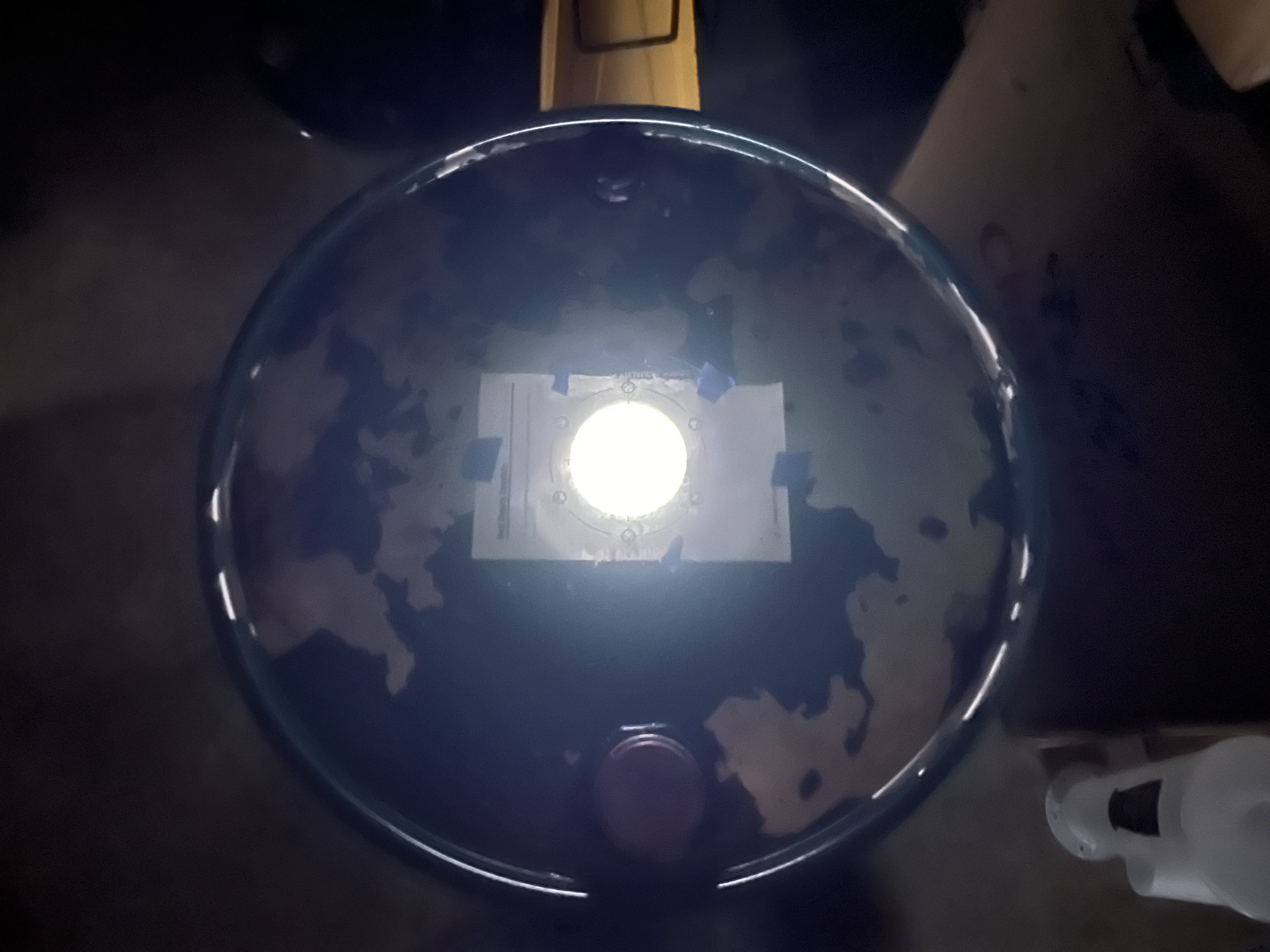

I mounted the SSDD to one side of the lid, because I think that positioning will allow the inlet 90° to be supported partially from the truck bed's side. Due to the weight of all the pipe etc., I'll likely install a brace from the lid top to the inlet area, to reduce lid deflection.

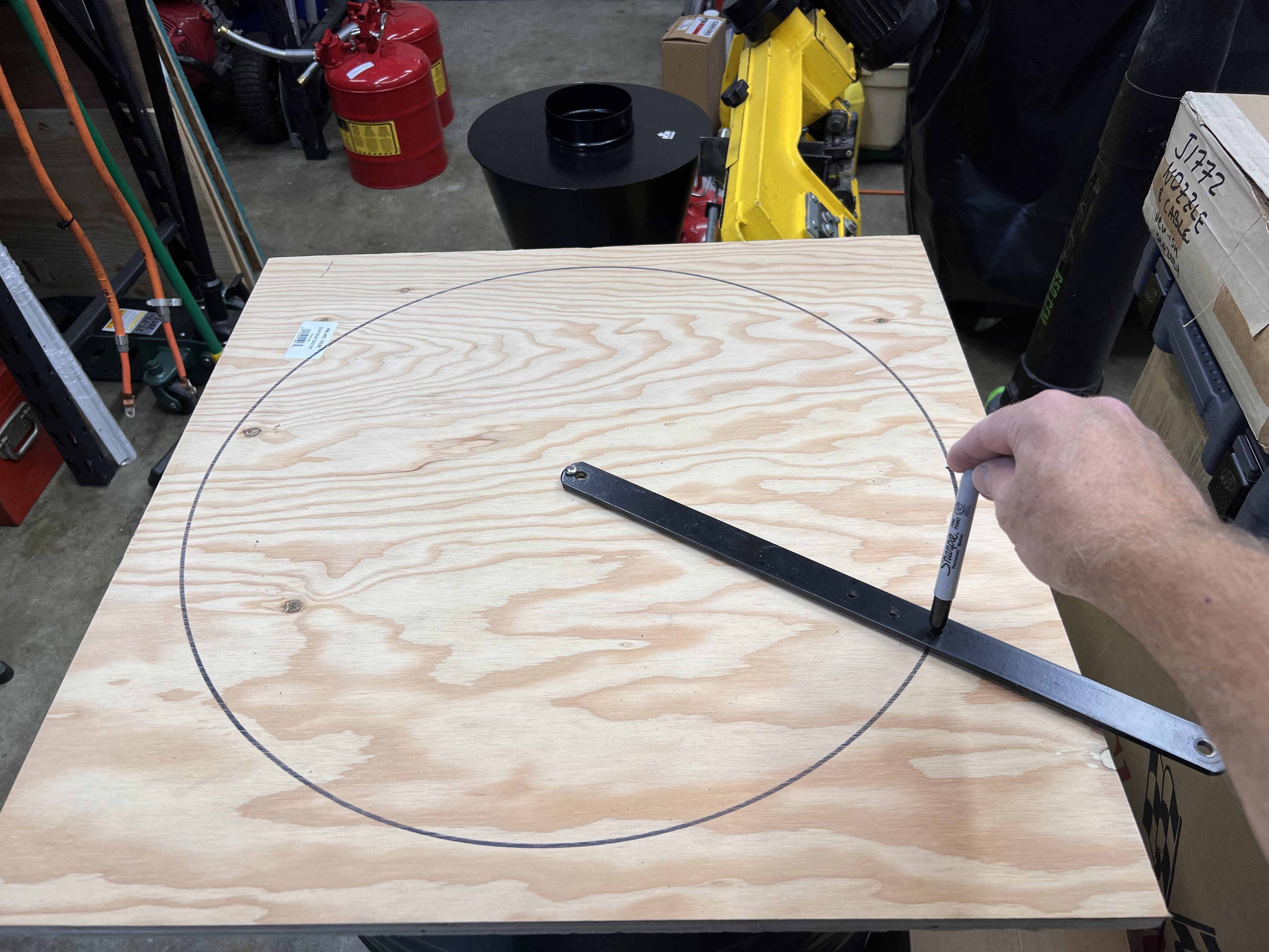

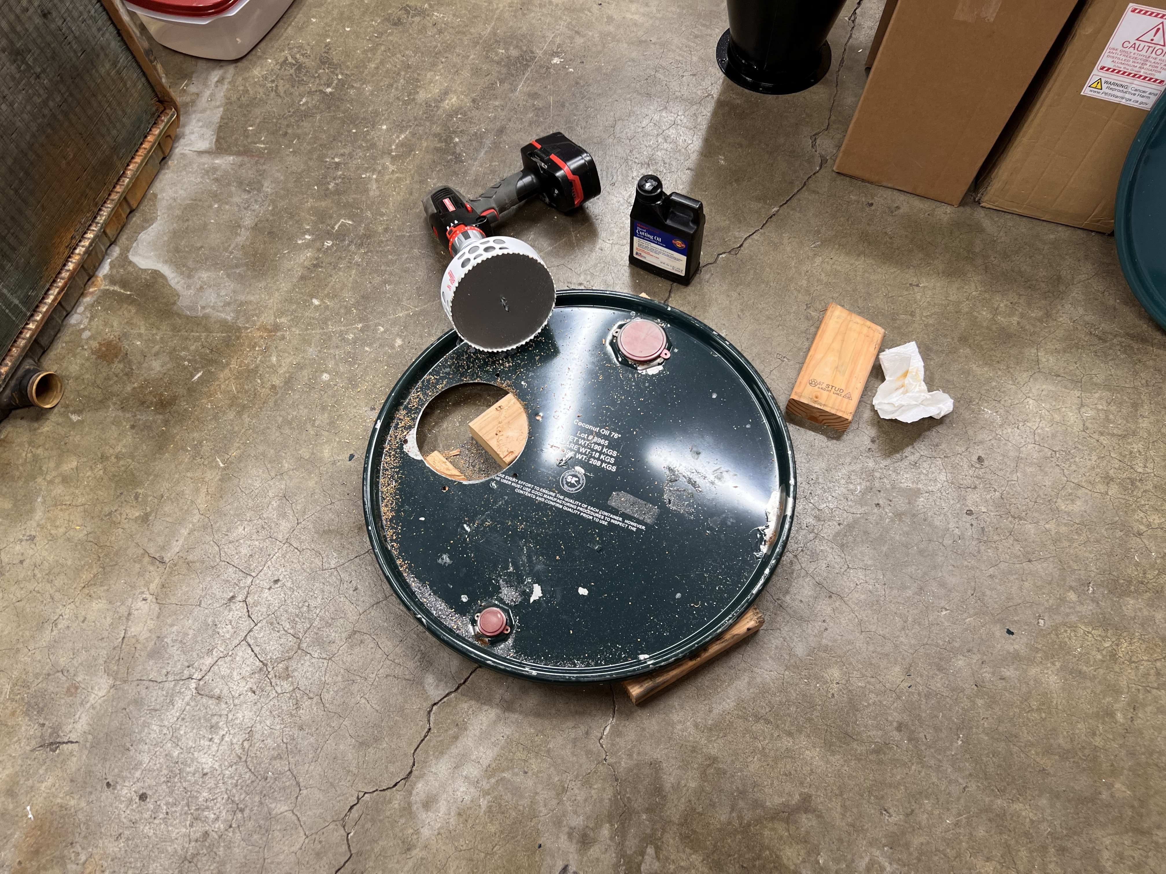

I had a 6" hole saw (lucky!).

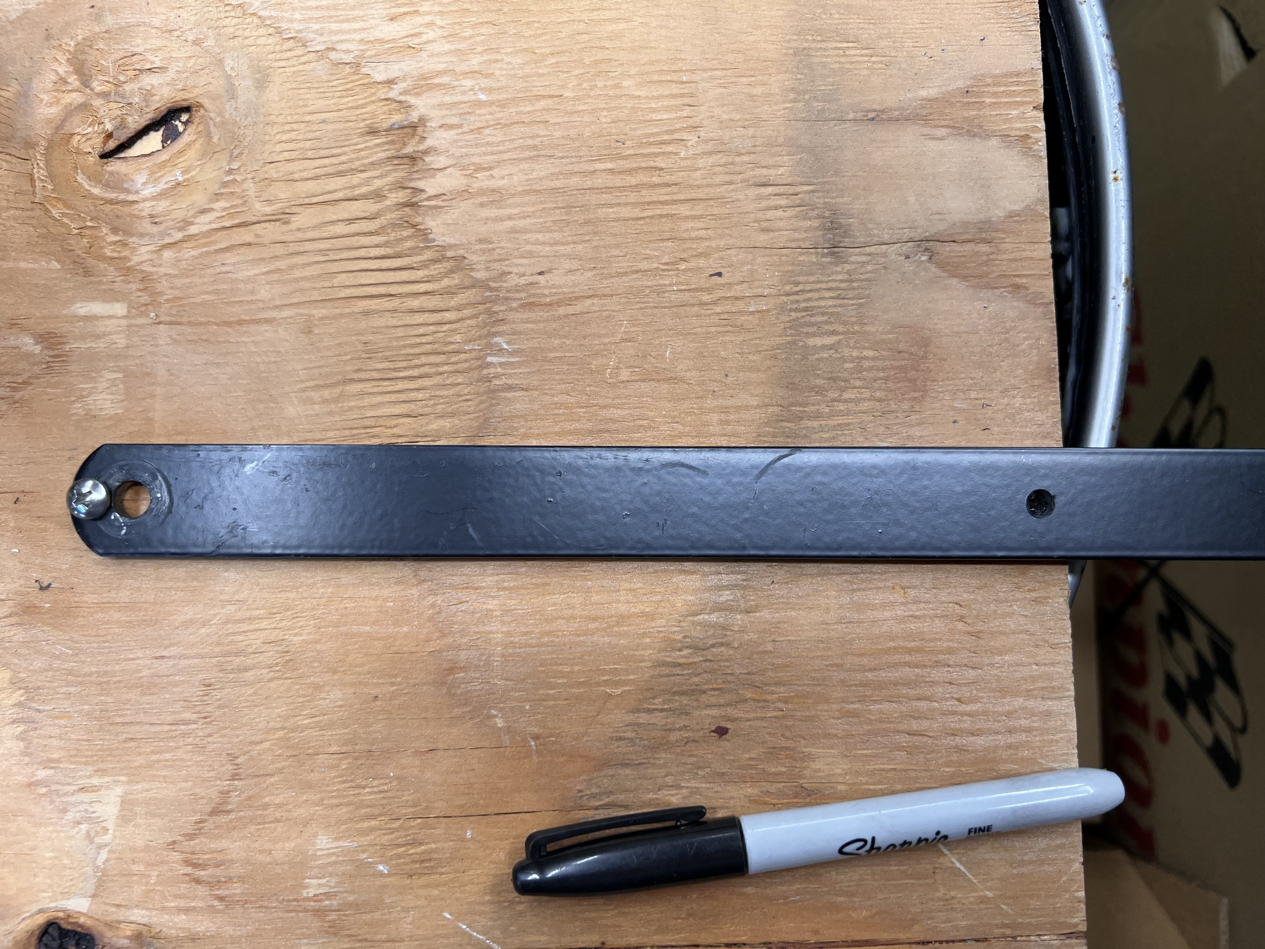

A lid reinforcement seems like a good idea. Of course, I swung the pen at the wrong radius the first time, because math is hard.
The 5x3 reducer fits snugly on the inlet.

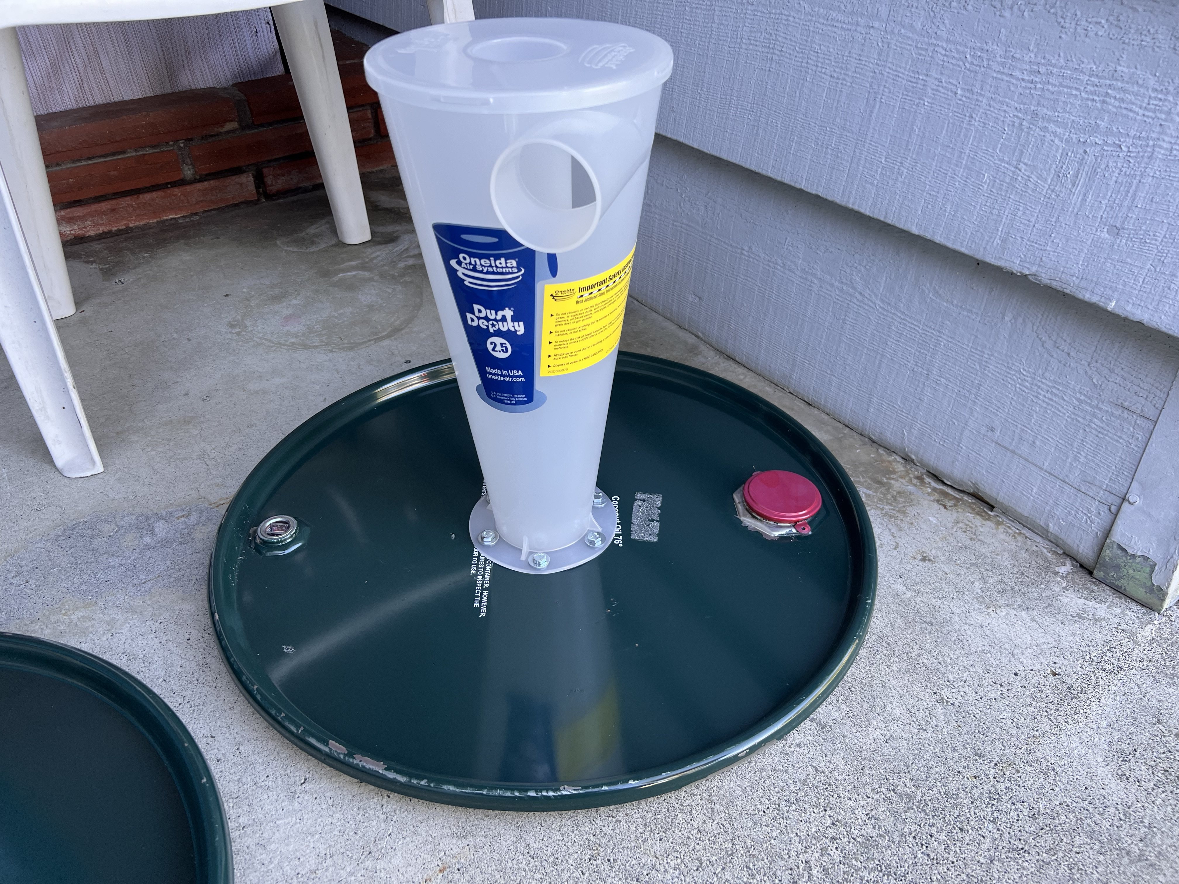

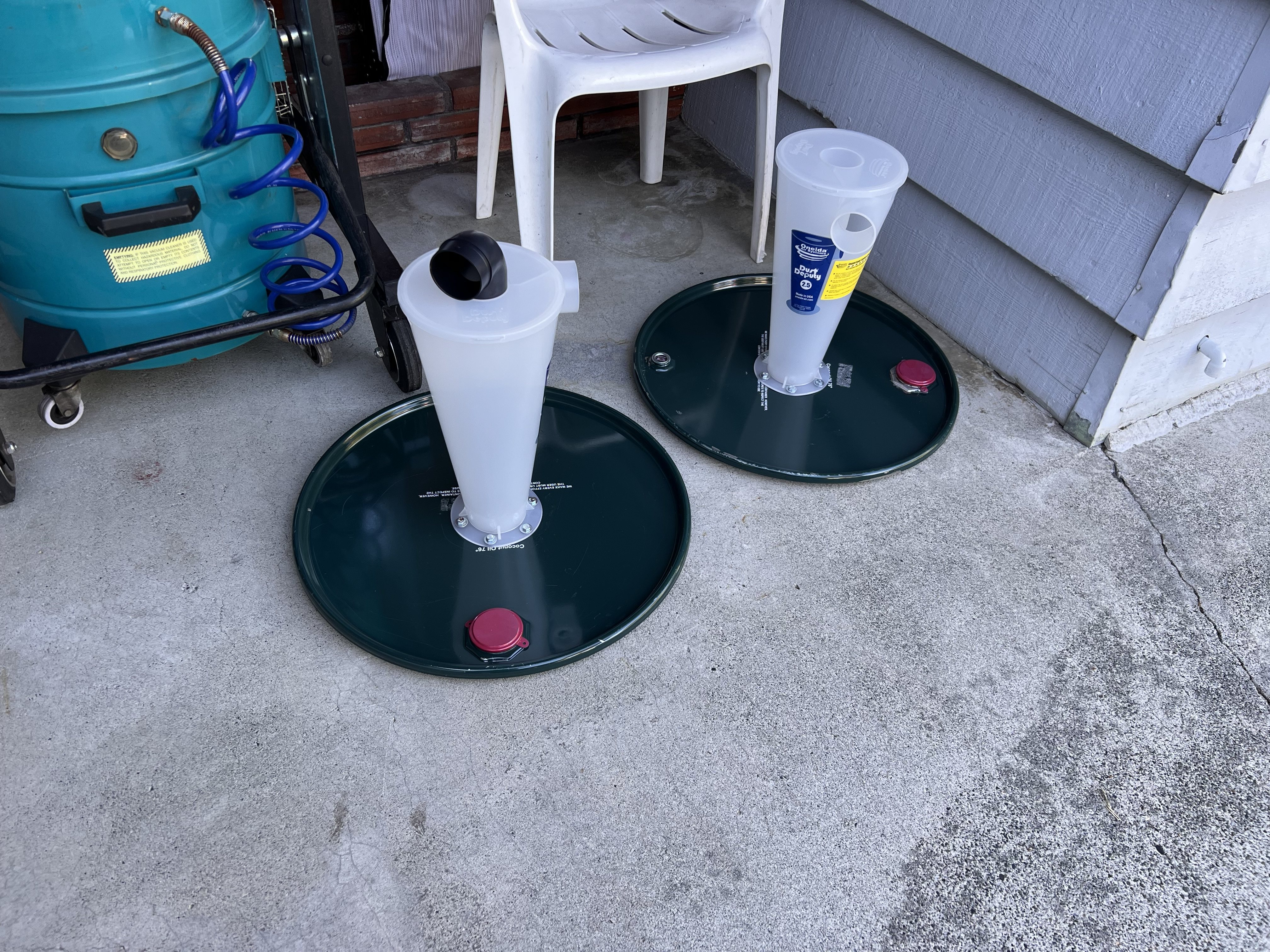

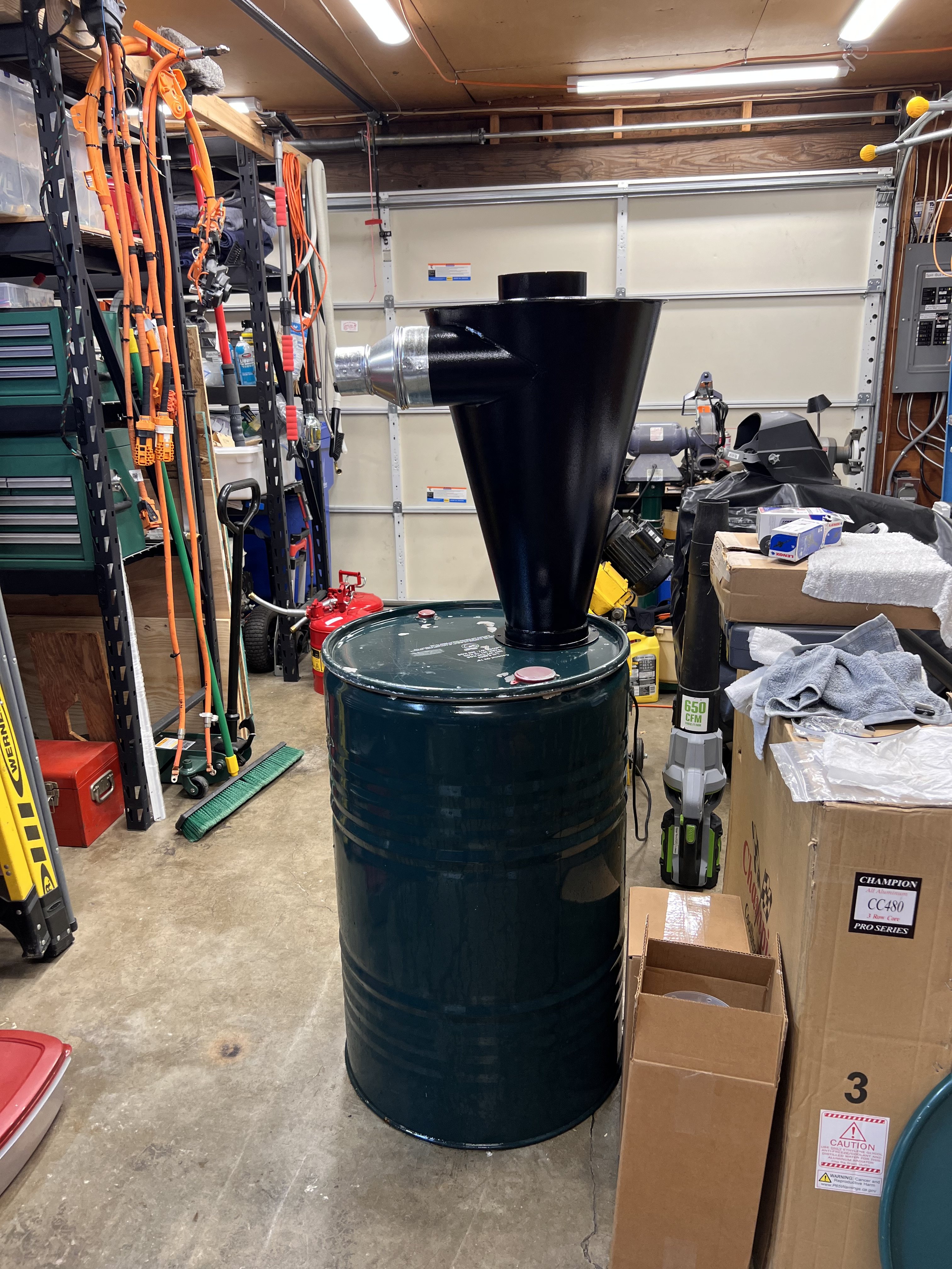

I had mounted two of the "standard size" Dust Deputies on drum lids a couple of months ago; I have two more to mount yet.

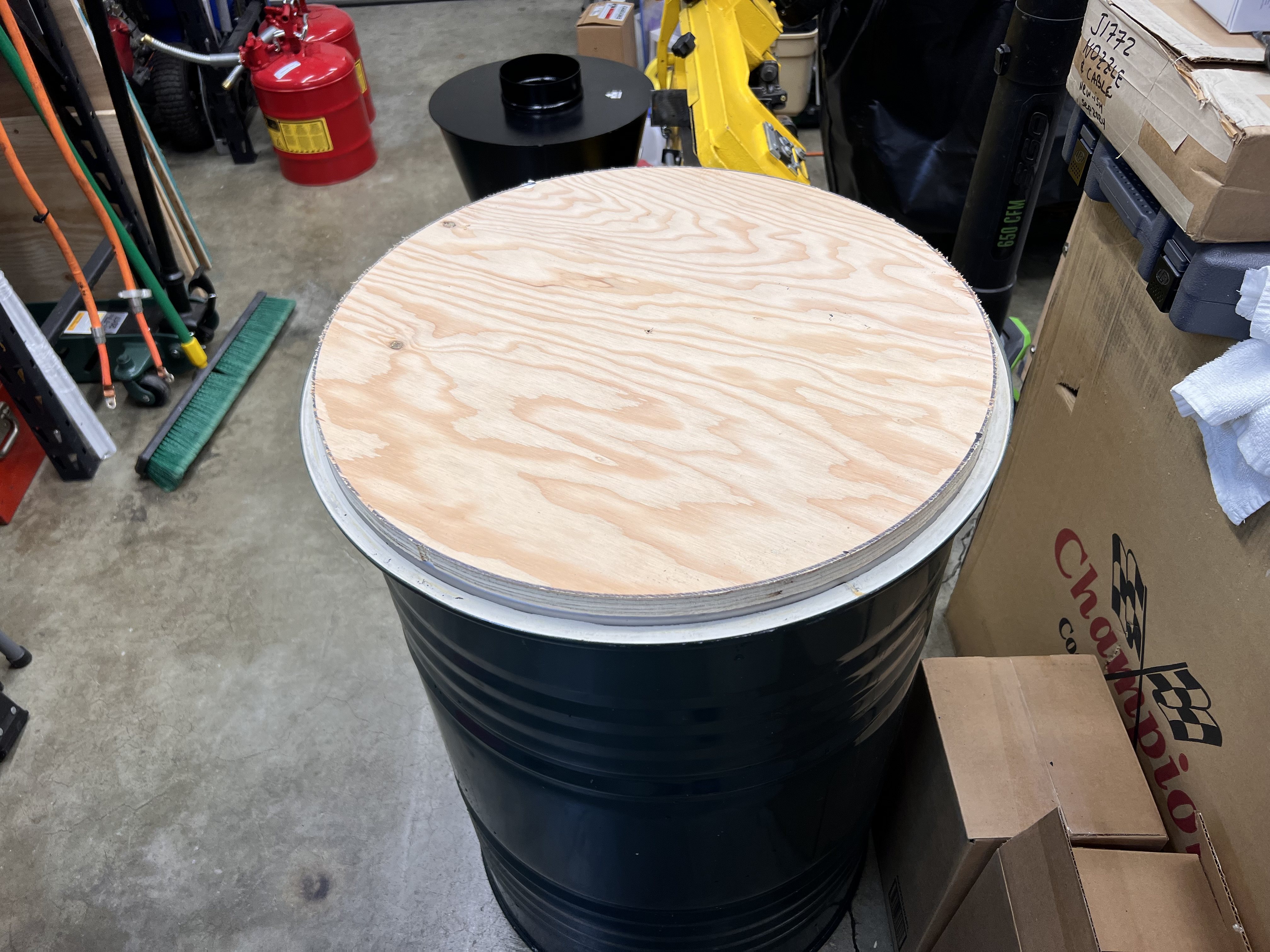

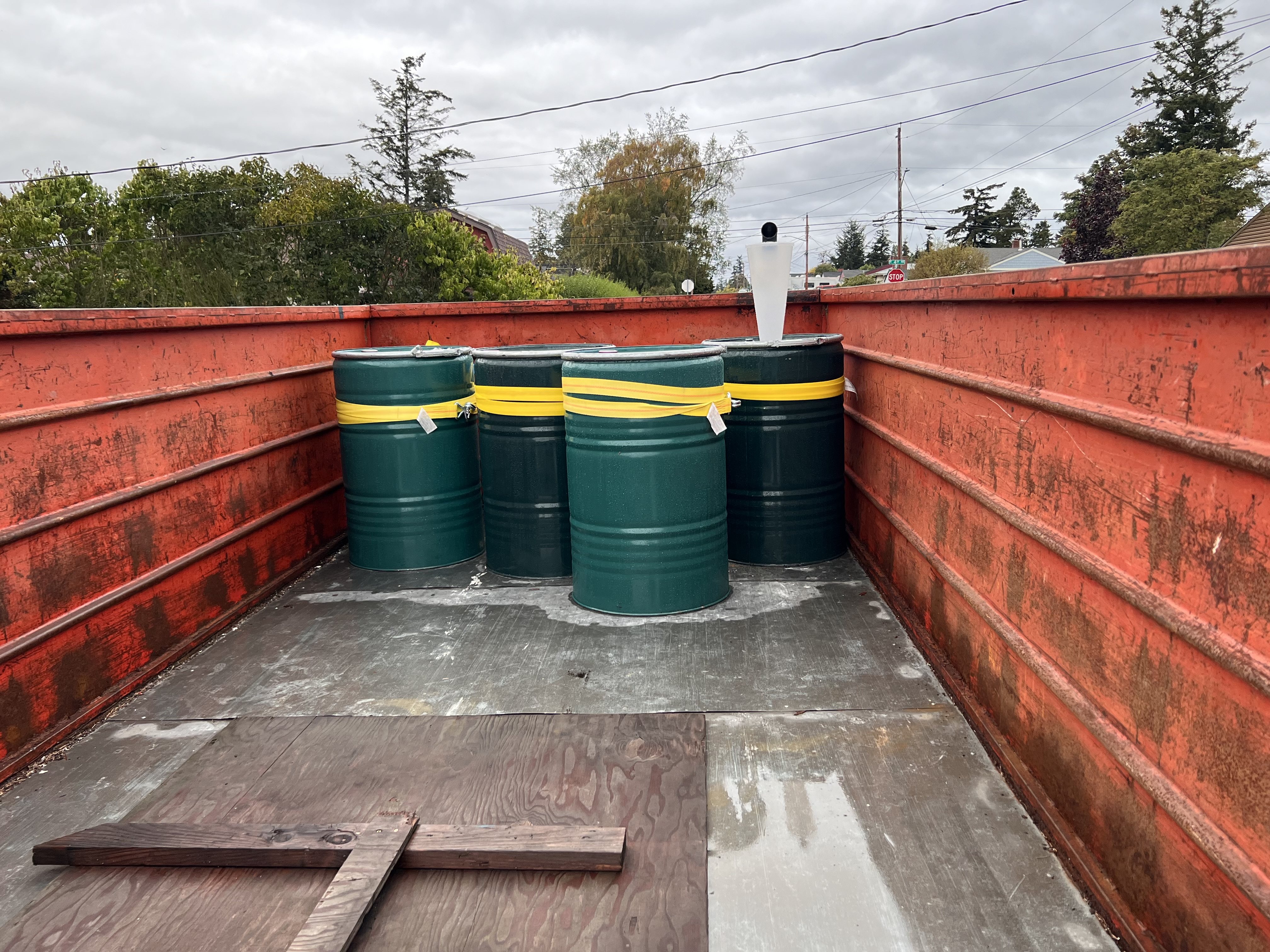

The drums are (will be) open both top & bottom. The drums sit on lids w/gaskets, but those bottom lids are not clamped to the drums.

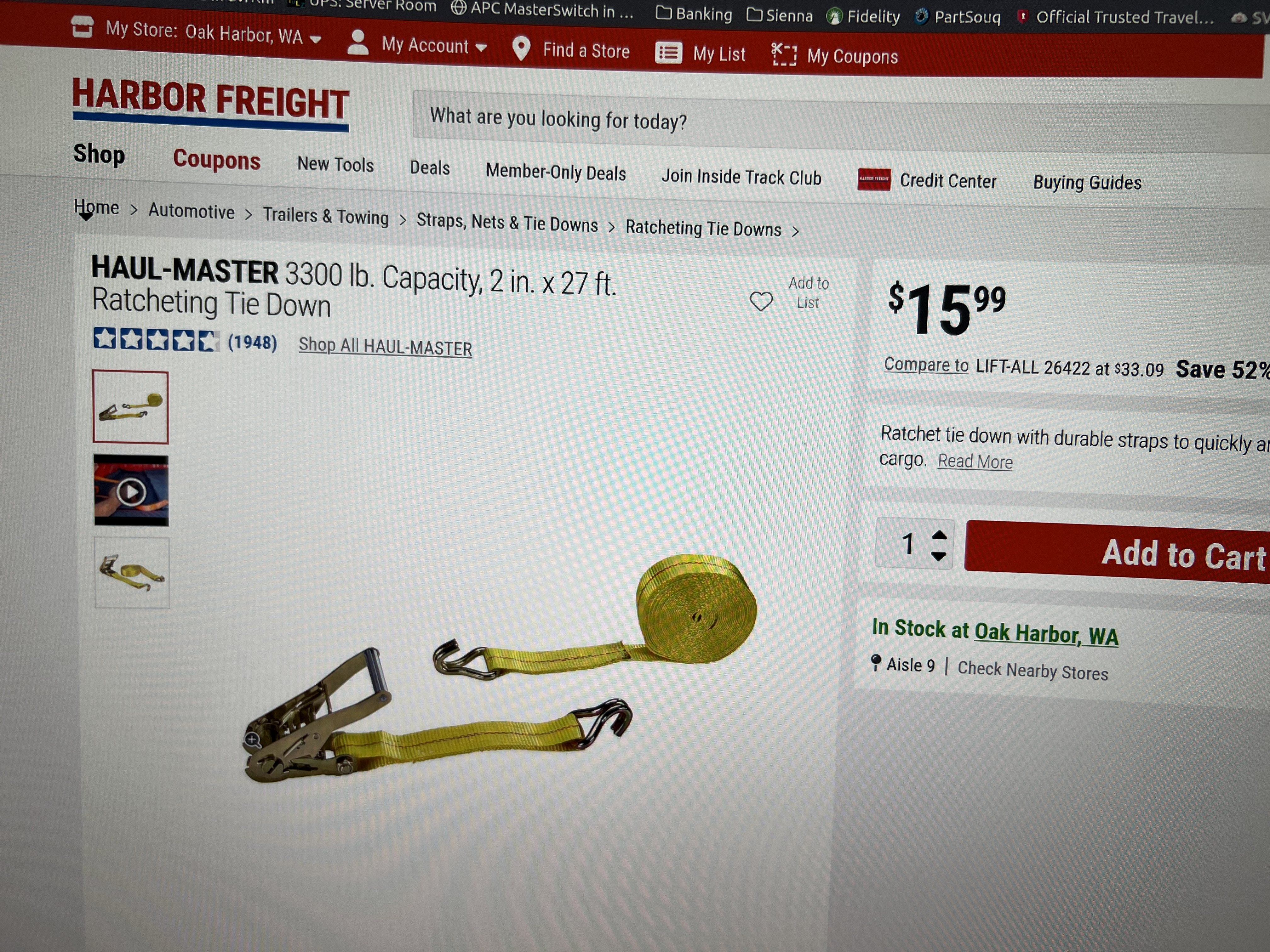

When ready to transport, all drums will have top lids clamped in place. The idea is to restrain the drums near the top; when the bed is raised, the tops can't slide down, but the bottoms can. All drums should end up laying sideways, bottoms facing the rear of the bed.
When the drums are full, their bottoms will kick out, allowing the dirt to slide out. Empty drums don't:

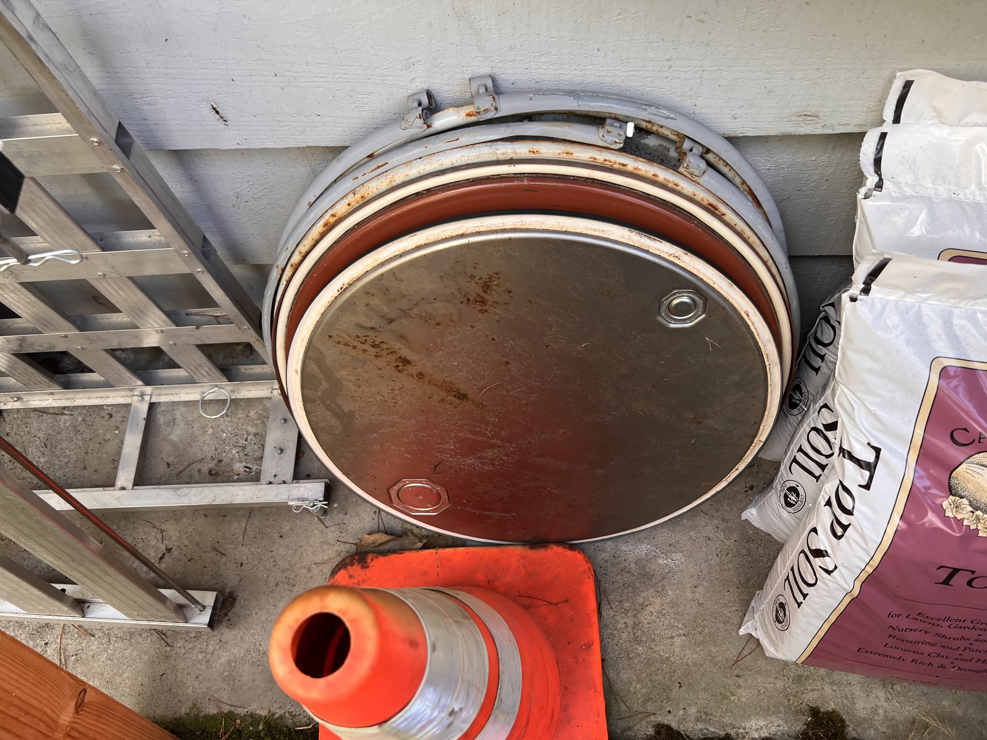

Re: Crawl Space excavation via vacuum

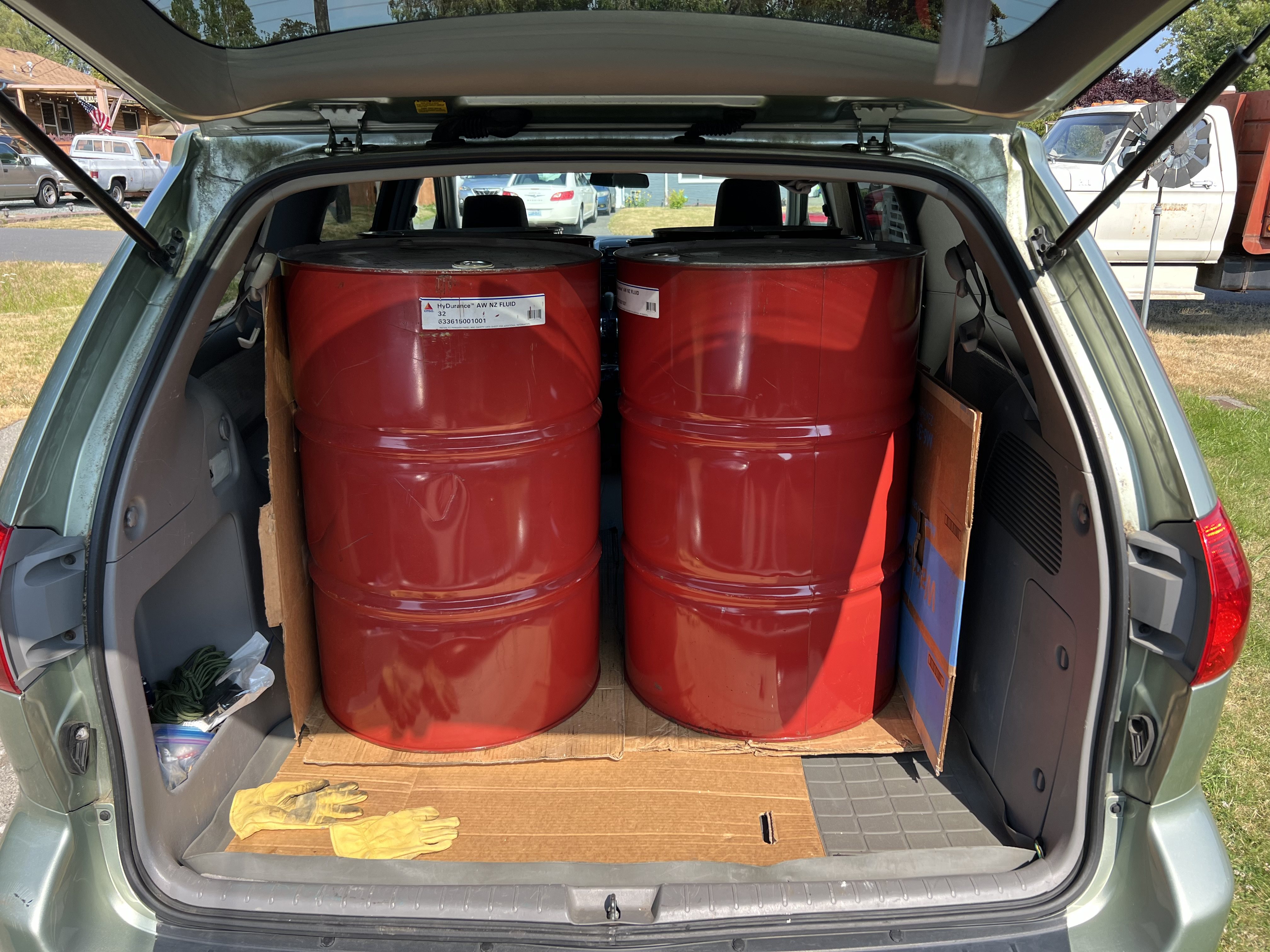

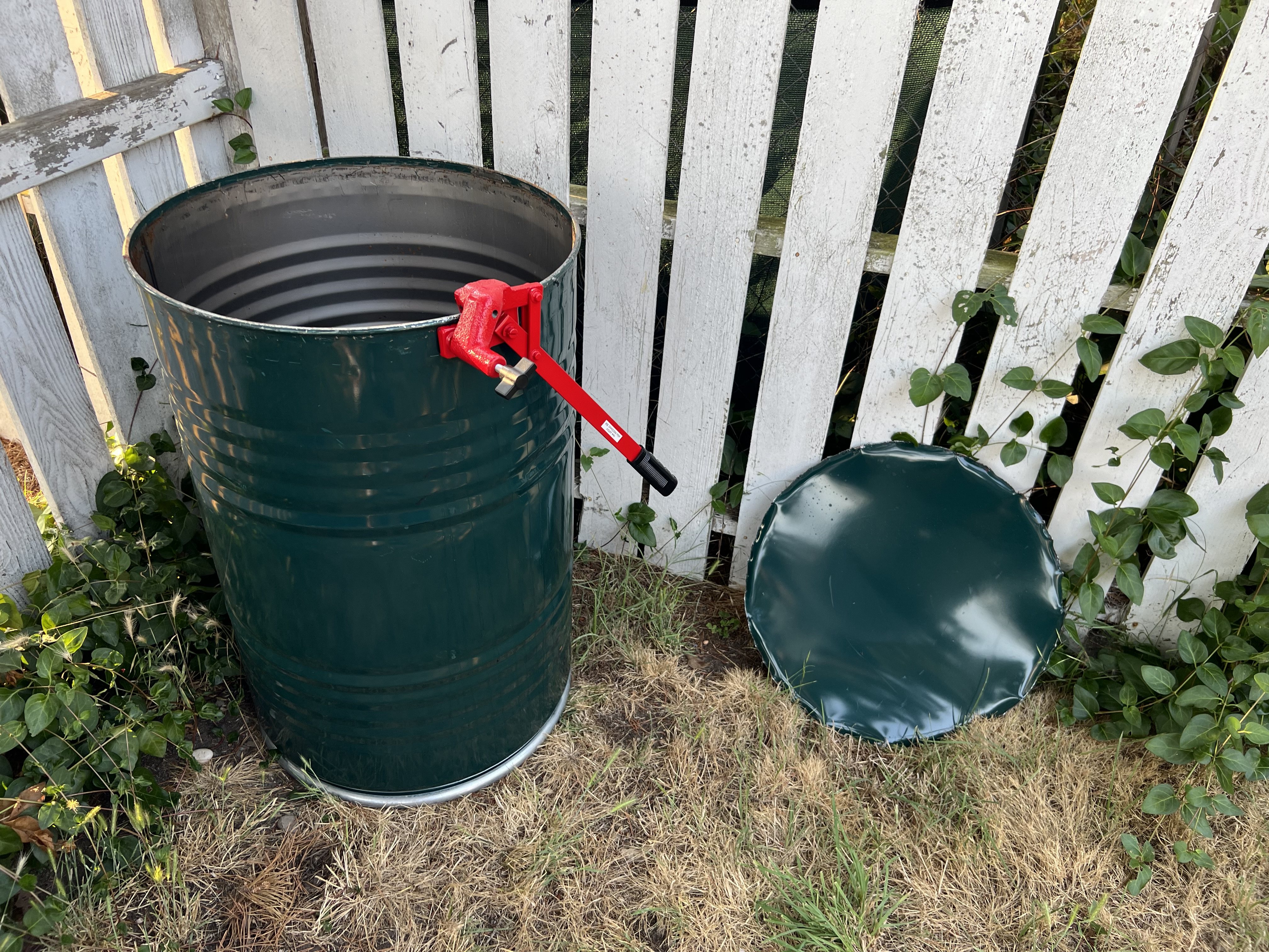

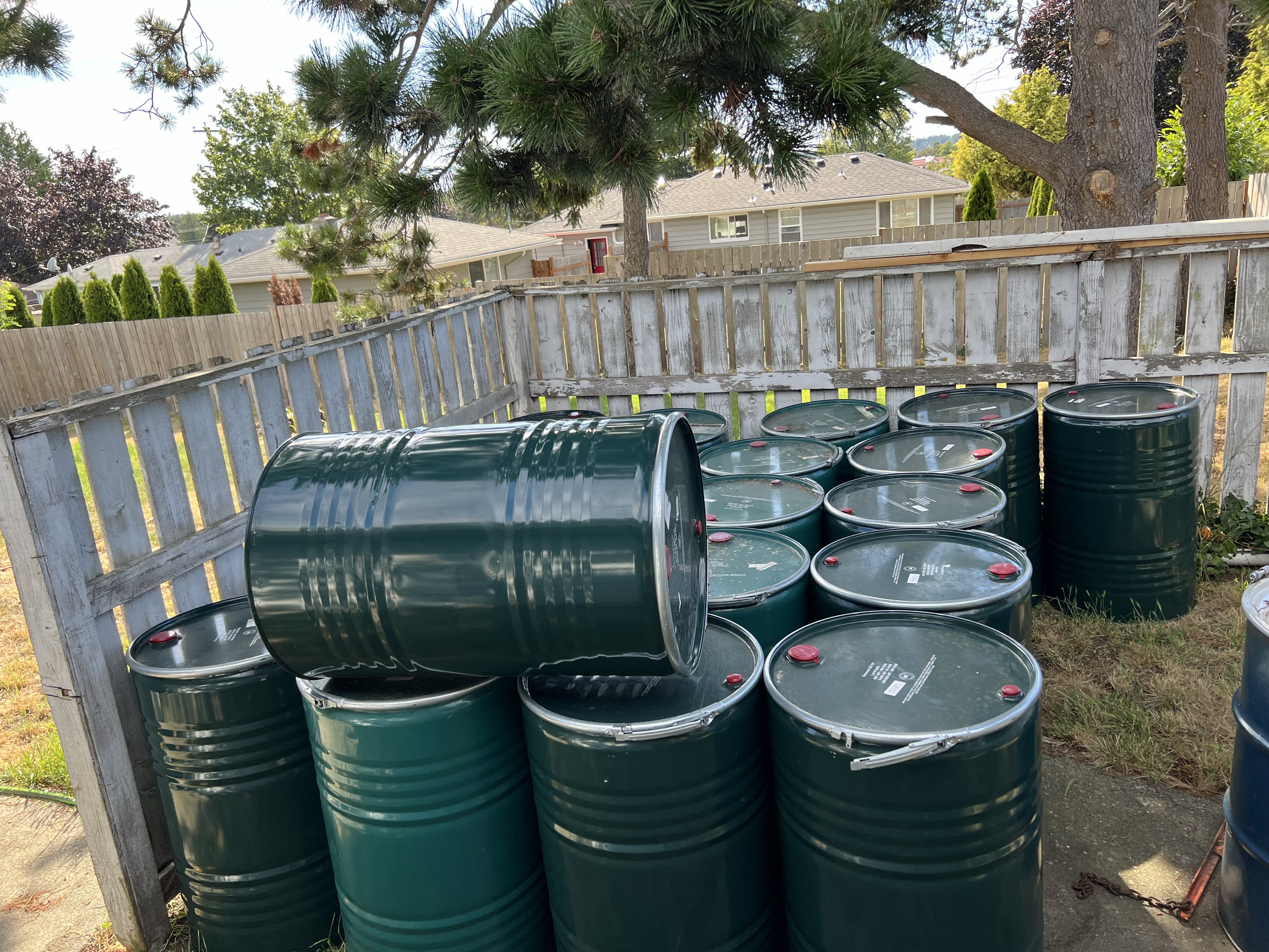

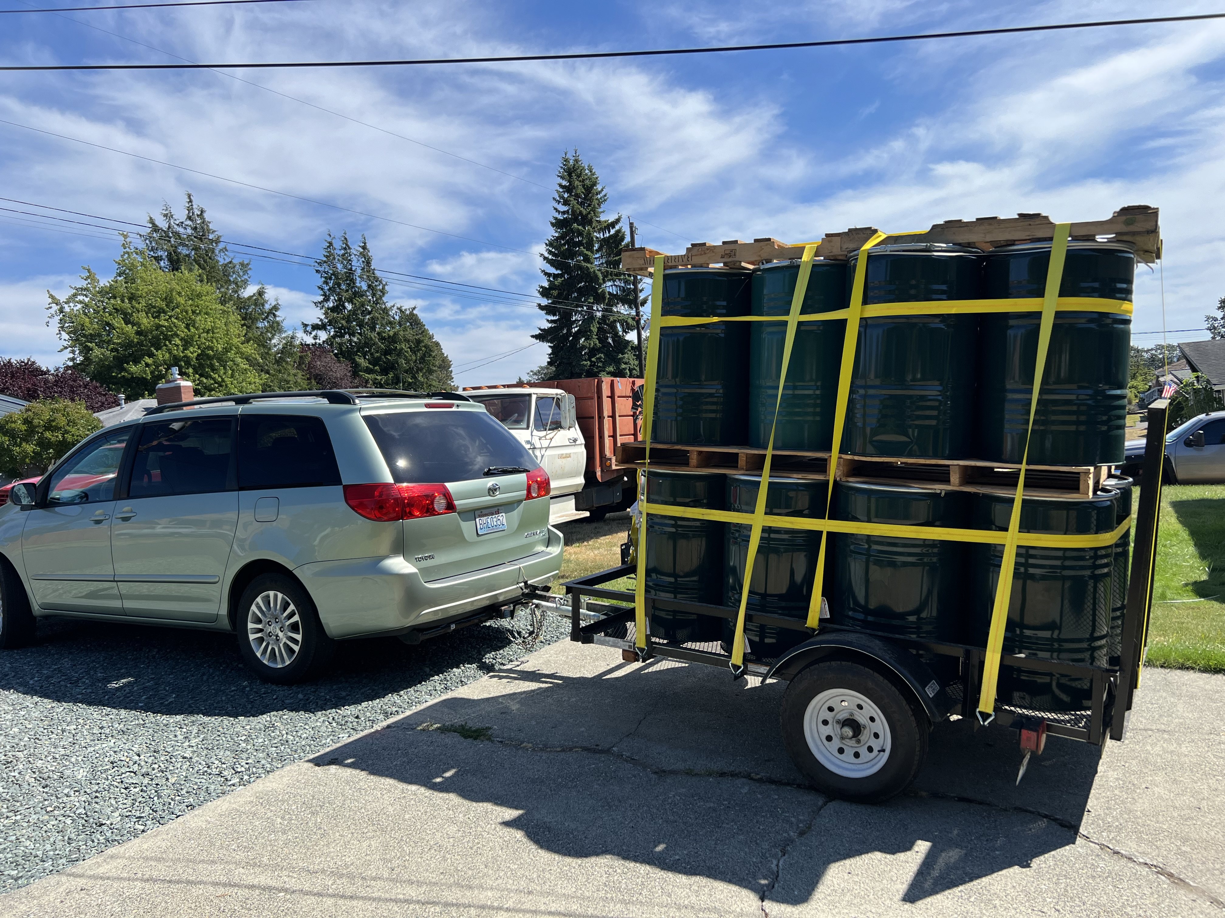

I wanted (24) drums, they had to have removable lids with gaskets, and be reasonably clean. I had to drive a long way to get drums that met those conditions.
I could get another six in the back of the van.
$25/ea = $500. $76 of fuel.
I ended up reselling the red ones (contained hydraulic fluid) because they didn't have removable lids and lids have a cost; it was cheaper to buy drums already equipped with removable lids, though I did have to drain off residual coconut oil.

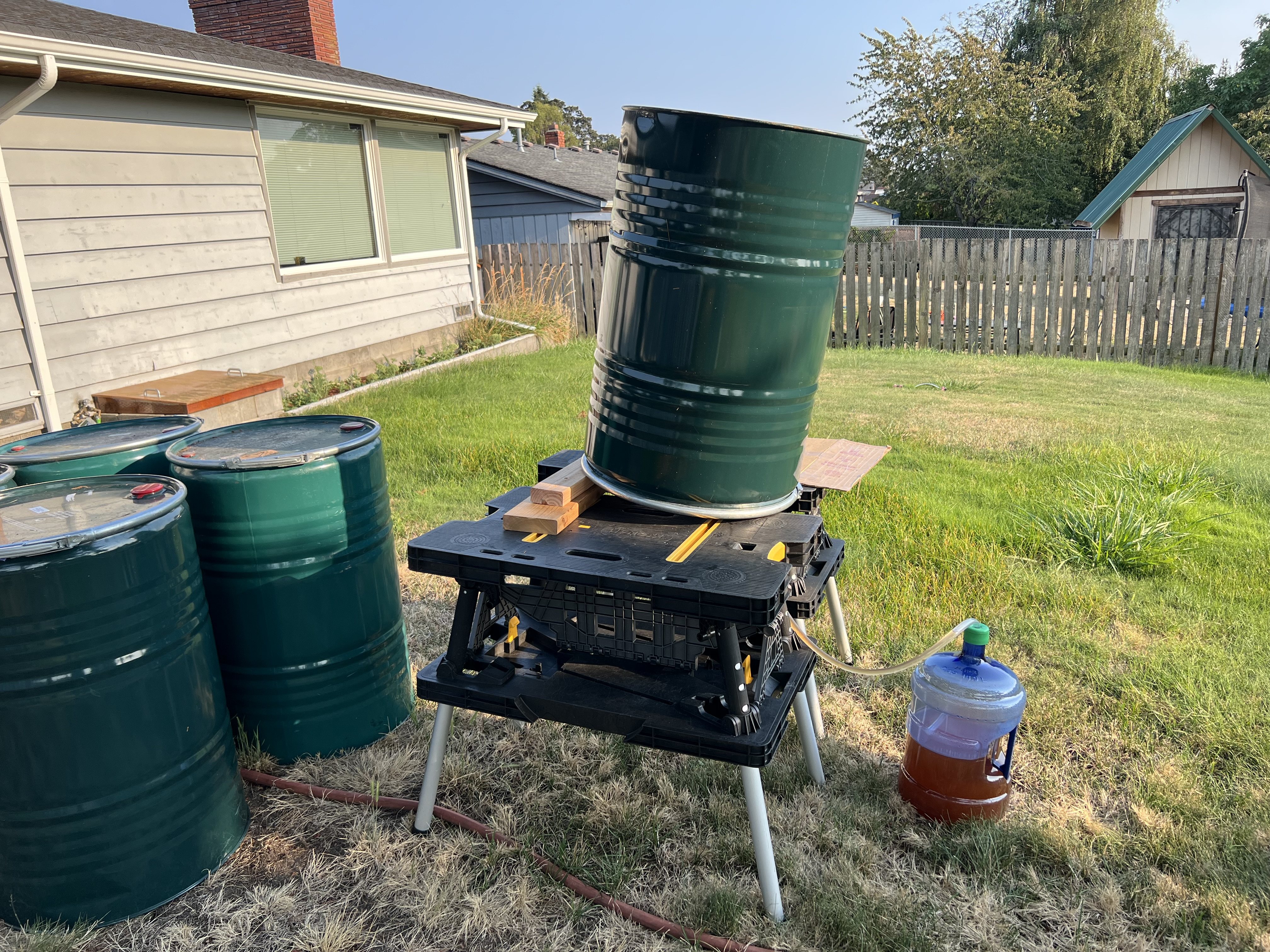

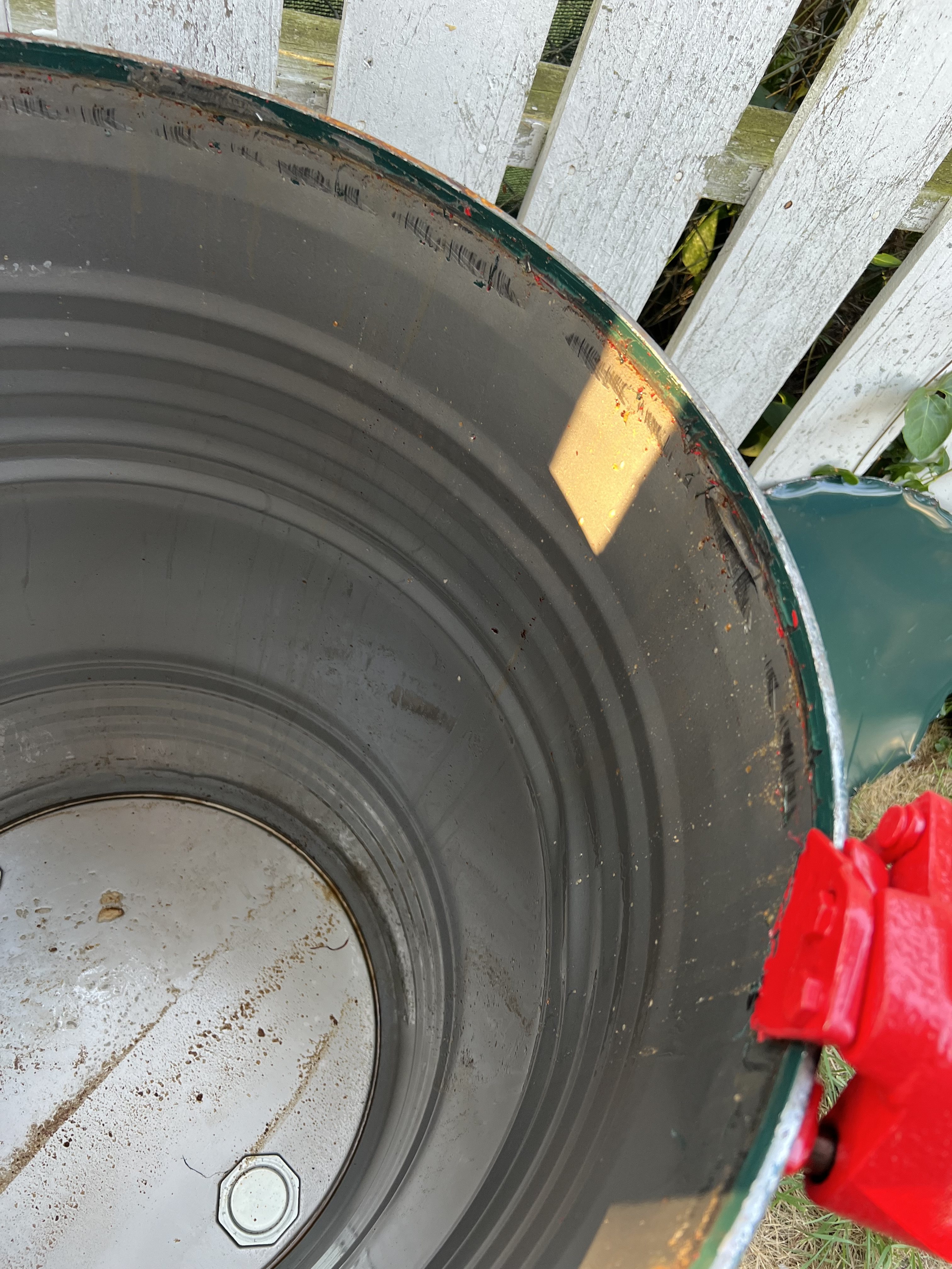

I'll need to remove bottoms from drums, so a "drum deheader" was acquired. This one is a Tri-Lite (Tripp Lite)/Wesco 13-216B
I need two lids for each drum. Seattle Barrel Co. sells "reconditioned" lids for about $10 ea ($240). Beware: there are two different common sizes of lids, and mine are the less-common "fruit barrel" size, slightly smaller diameter.

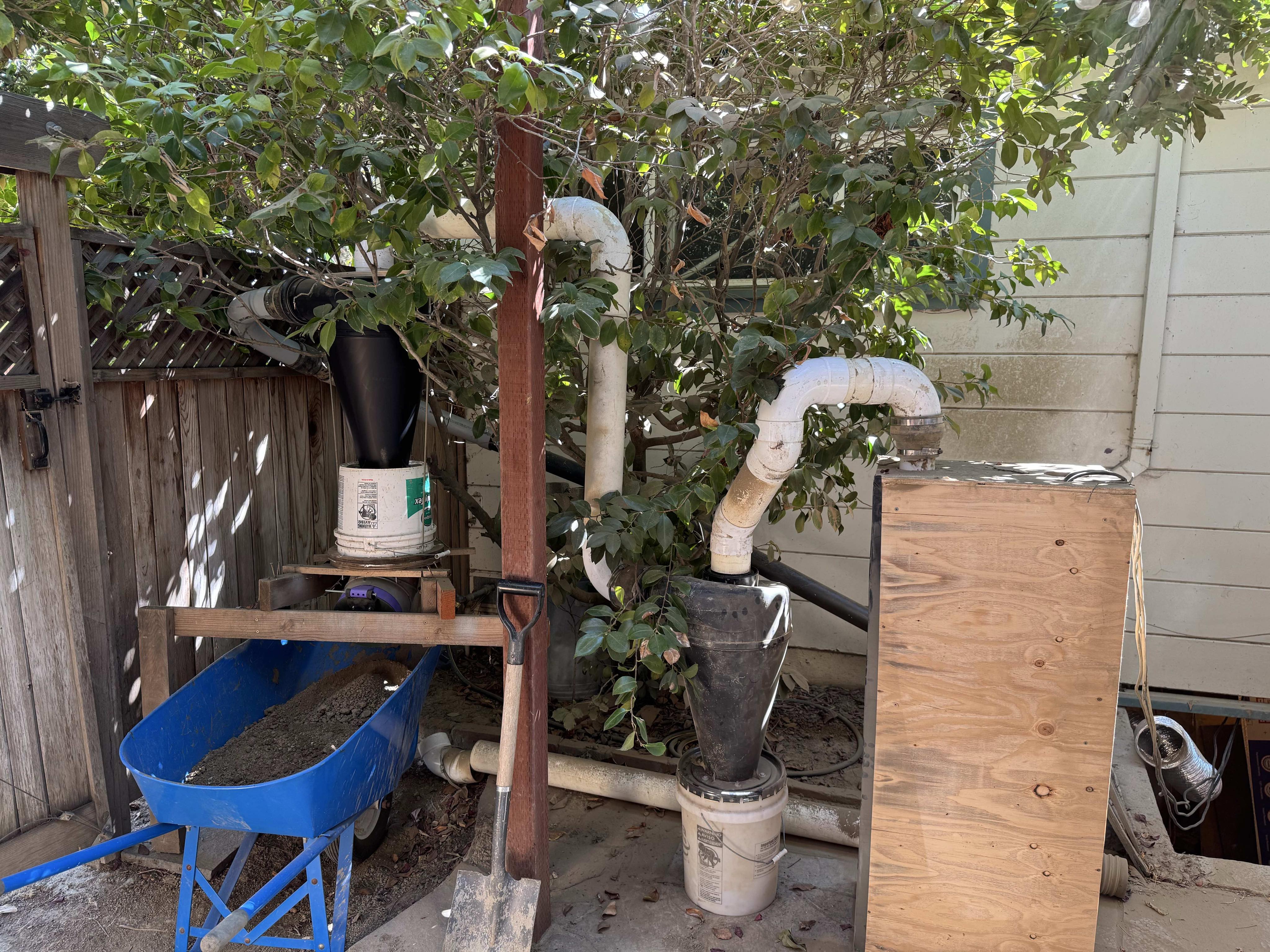

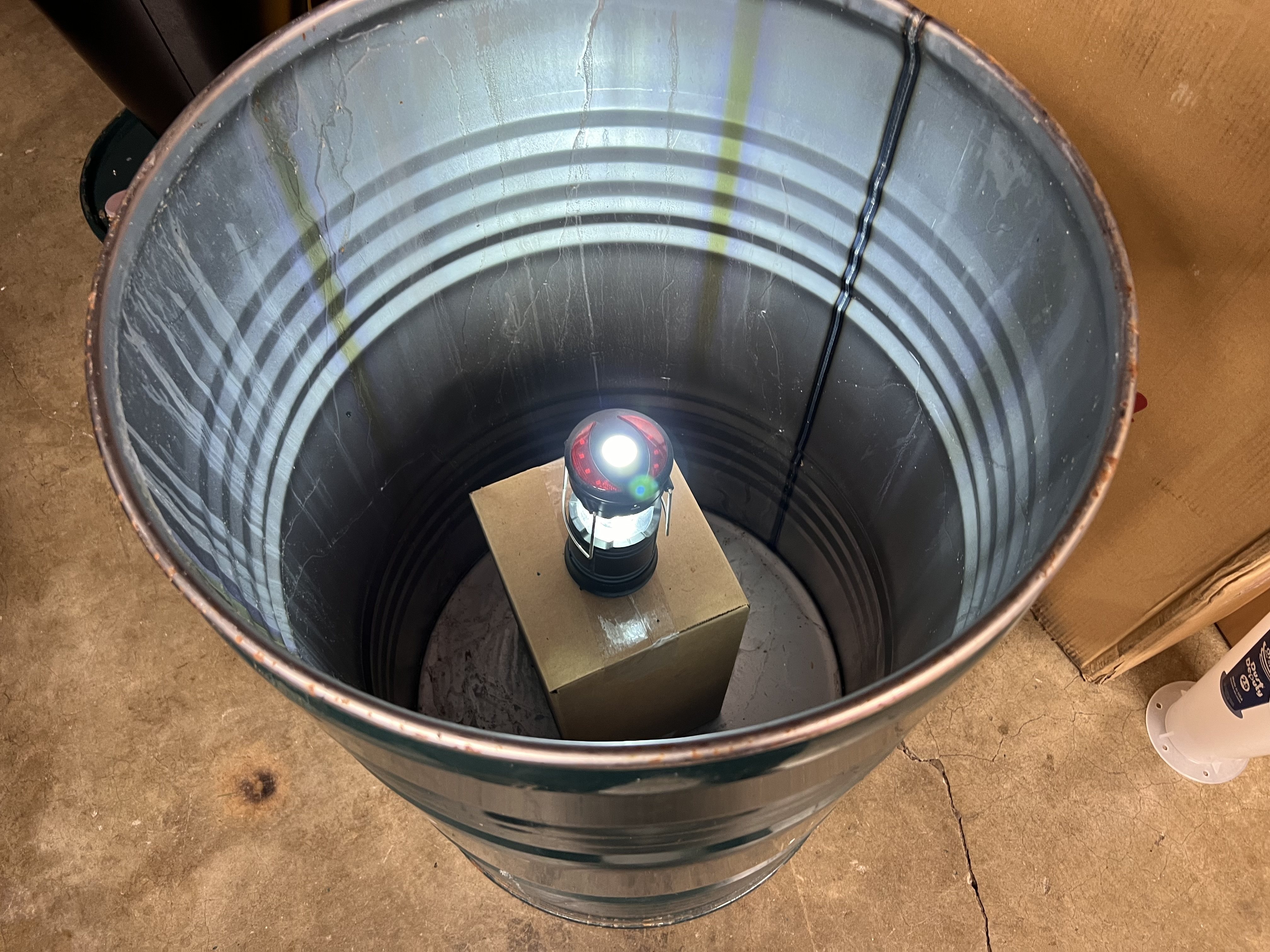

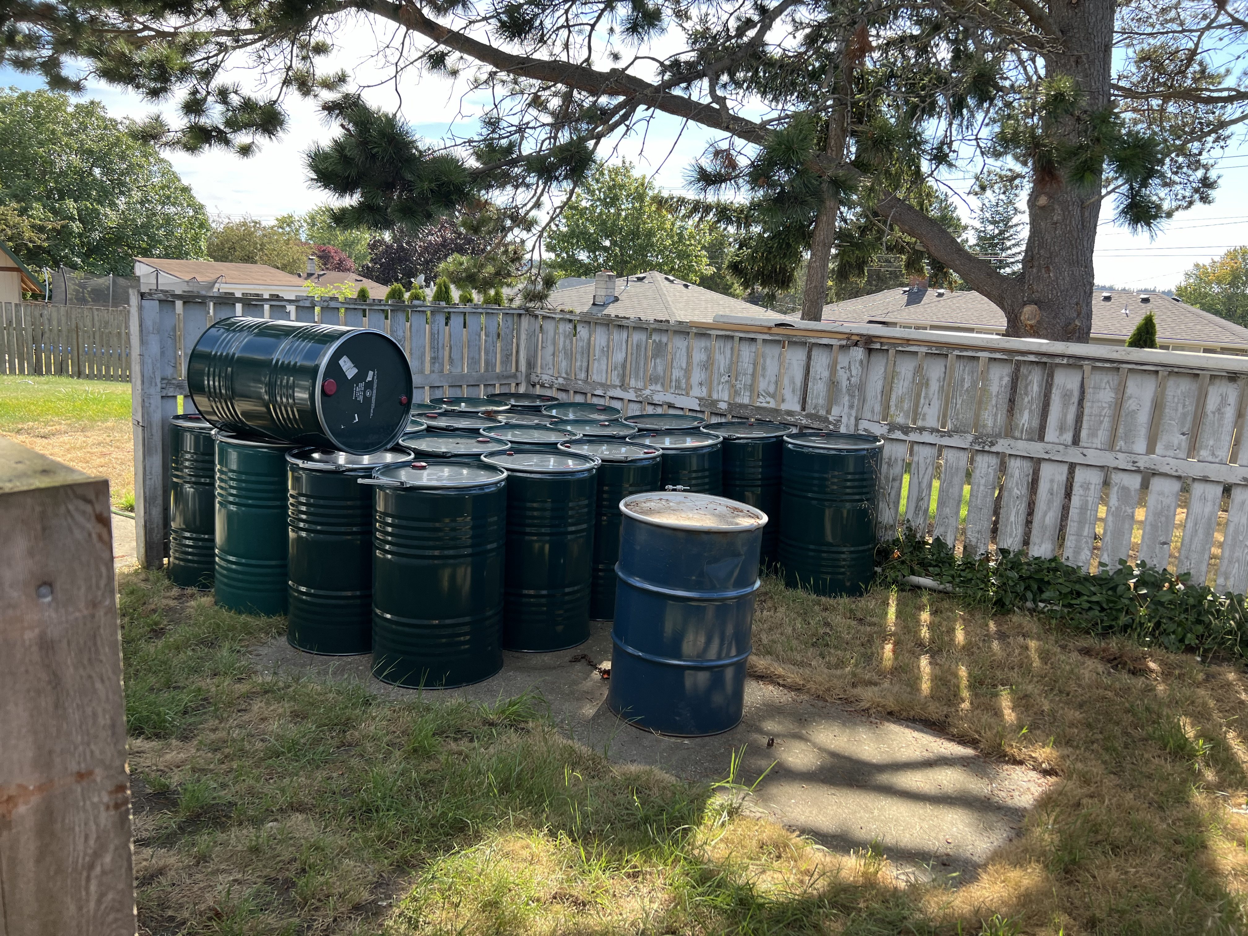

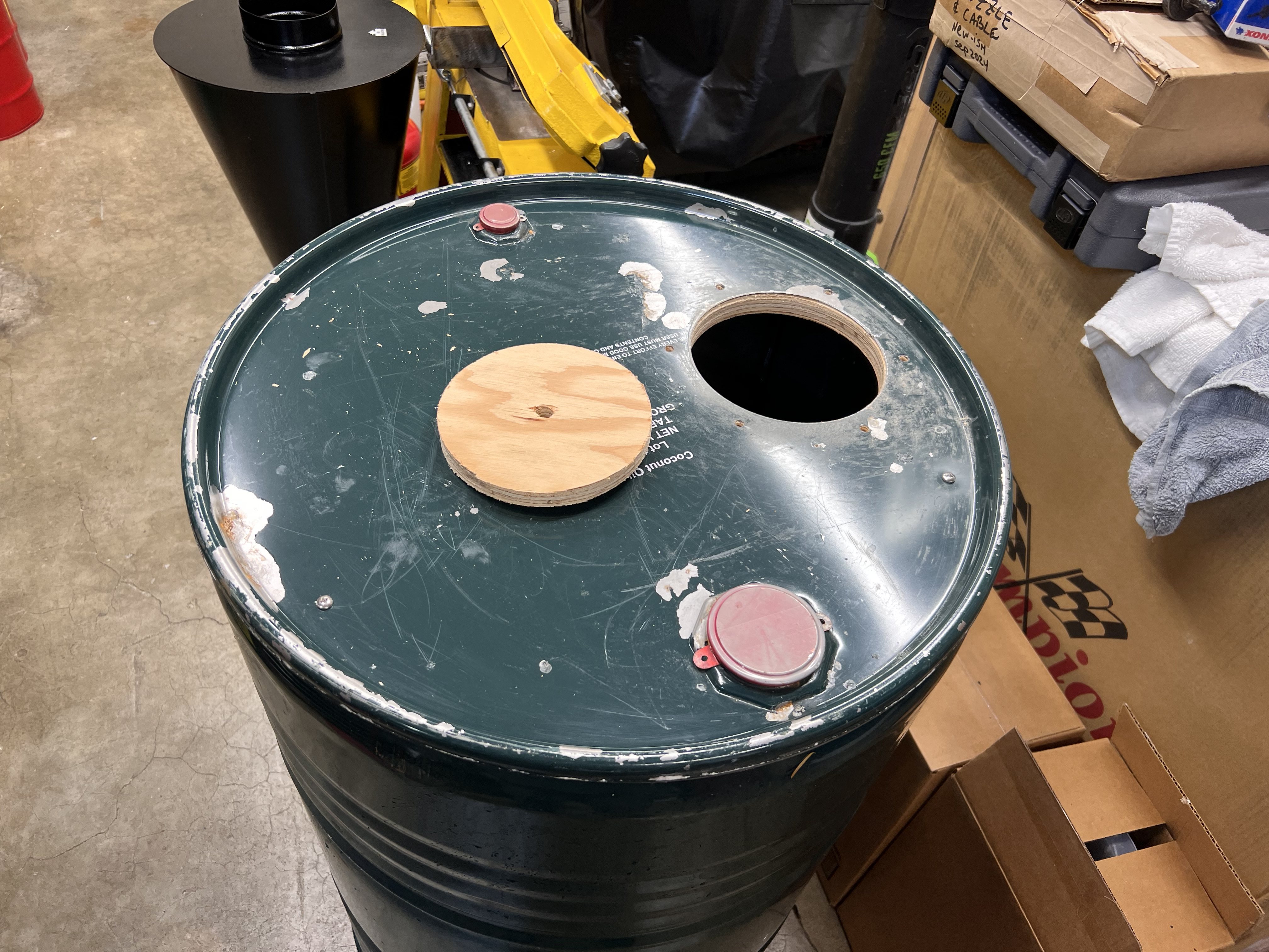

I've found that there are at least three different diameters of "55 gallon drum", and naturally I have purchased one of the weirder sizes: mine are smaller dia. than "fruit barrels", which in turn are smaller dia. than "standard". I've got some lids being gathered by Seattle Barrel Company, but it's going to take them a few weeks to come up with (24).
Meanwhile, I finally got around to mounting the last two "small" cyclonic separators to some existing lids. A 3" hole is req'd and while I have various metal hole saws, several in the right range, none were 3" exactly, so . . . another order cycle. I use a lantern inside a drum to provide backlight, and that makes it easy to align the paper template over the 3" hole, so I could center punch for drilling the (6) 17/64" holes to bolt down the flange.

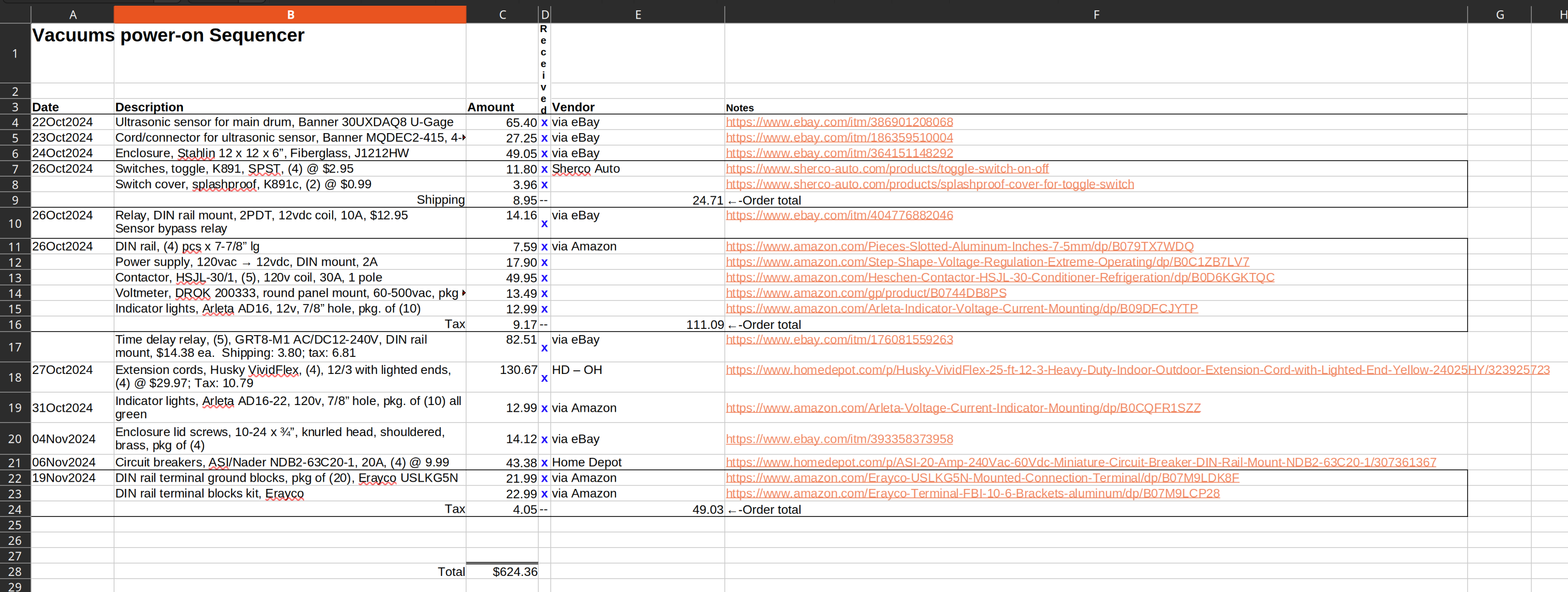

I'm up to around $625 on this box alone ATM. The big-ticket parts are the four extension cords, the (used) project box, and the ultrasonic level sensor.

I should have bought a dump landscape trailer, but dump trucks are so cheap that I was going to save money and use a dumping truck instead, then sell the truck. Well, that was a bad idea, as the truck I chose was a lot worse than I'd thought, though it's sorted now. A dump trailer starts at around $6k for a dead beat-up one, and I bought the truck for $2,700, but the spreadsheet on it right now is . . . $7,300, so it'll be a net loss when I sell it on at project completion. I should have bought a dump trailer.
