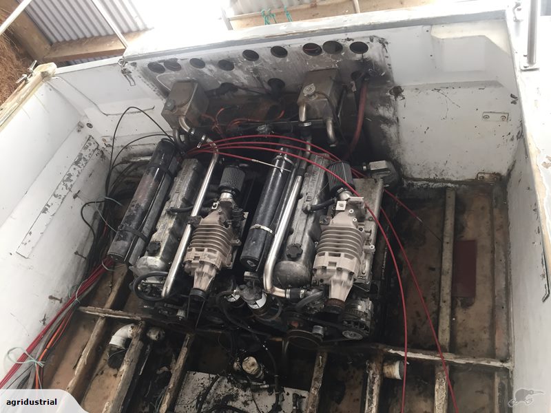

I believe that the original post is correct as I have just perched a 30ft boat with twin ld28 born are supercharged
Photo of engine bay
Photo of engine bay
Re: Supercharged LD28s
Yup, Thanks for that picture. I'd never heard or seen a supercharged LD28 before today.
