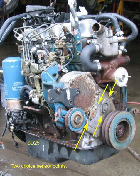

Your scan page IS for the SD25 720 trucks (1984+). I have yet to -see- a 1984+ truck with diesel (neither had tachometer) but then ... I've only seen 2 personally.
The SD22 720 never had an optional tachmeter.
There are a many harnass differences comparing the SD25 vs SD22. There must be a "reluctor" (my term) but ... the FSM gives no specific clue.
-Philip

philip wrote:The SD22 720 never had an optional tachmeter.
That's what I always thought. Now I can verify it. But from the way everyone has lamented the lack of a tach and entertained every other scheme, I was quite certain that was the case with all diesel 720s. I am surprised to find that it was in fact an option on the later 720s with the SD25.
In all practicality it doesn't make any difference because, 1.) the tach, which does have a different part number than the Z tach, is $217 (the gas one is $229). Moot, because it is not available anywhere, at all. 2.) The sensor (pn 25068) is about $60. Rush to your dealer now, because there is one somewhere in the US. 3.) I can't imagine finding a 720 w/ SD25 in a junkyard, so I'm back where I started.
For motorheads, I did get a breakdown of where the sensor fit. Looks like it reads the cam gear, which I suppose has an inset on it. If anyone has one of these trucks, you have a jewel of high interest!

Knucklehead wrote:
philip wrote: I am surprised to find that it was in fact an option on the later 720s with the SD25.
I've had this photo for almost 2yrs ... I didn't know what THESE bases could be for!
-Philip

philip
Deceased
Posts: 1494
Post by philip »
Knucklehead wrote:I am surprised to find that it was in fact an option on the later 720s with the SD25.
I've had this photo for almost 2yrs ... I didn't know what THESE bases could be for! You get one base machined and an extra for ... ?
-Philip
Passed 08May2008
1982 Datsun 720KC SD-22
