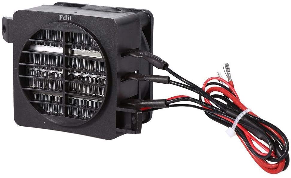

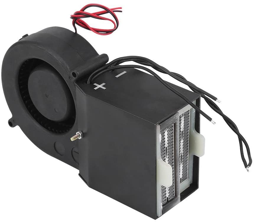

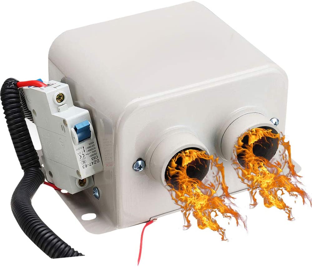

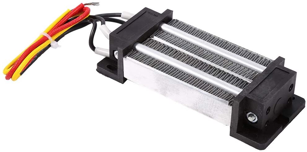

Positive Temperature Coefficient (PTC) heaters are everywhere, and cheap. They have the unique property of getting just so hot, and no hotter. Initially, I was looking at the usual offerings on eBay, Amazon, etc.
I even ordered a couple. But, they are all so cheaply constructed that I began looking for something more robust. Toyota has been installing small PTC heaters in many of their vehicles since at least 2009; they're set up to provide a bit of heat when the ICE's coolant temp is low, particularly in cold climates or in versions of vehicles with diesel engines, which generate little heat when not loaded.

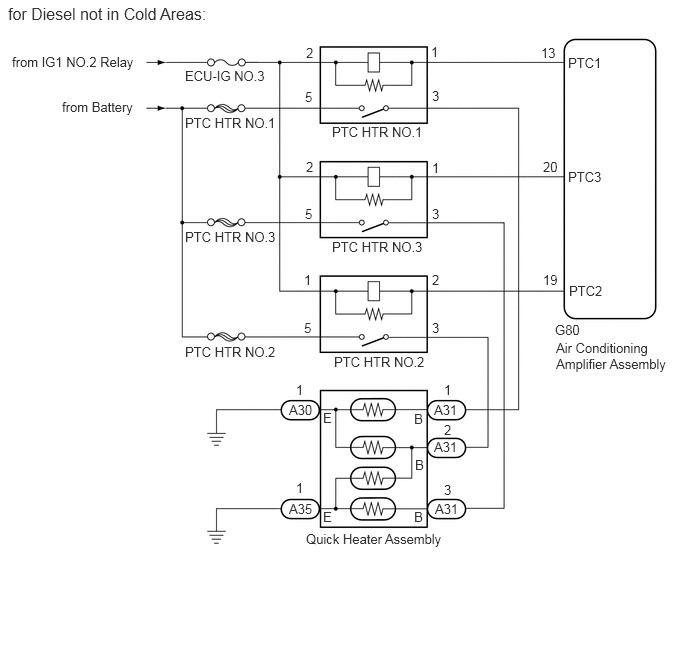

The three most common Toyota PTC heaters are 330W, 495W, and 840W -- the latter is NLA. Below I summarize my best guess as to the applications in which each was installed. Bear in mind that the PTC Quick Heaters were not optioned in all markets nor all versions of a model. Notably, their are PTC heaters installed in Gas-engined vehicles and Cold Climate Diesel-engined vehicles, with two-stage heaters/wiring/relays, but Diesels in non-Cold Spec. got the three-stage units. Go figure.
Below, I document some info and circuit diagrams I've pulled from various sources. Some is redundant, esp. the multiple circuit diagrams, which all show pretty much the same circuit but in differing detail.

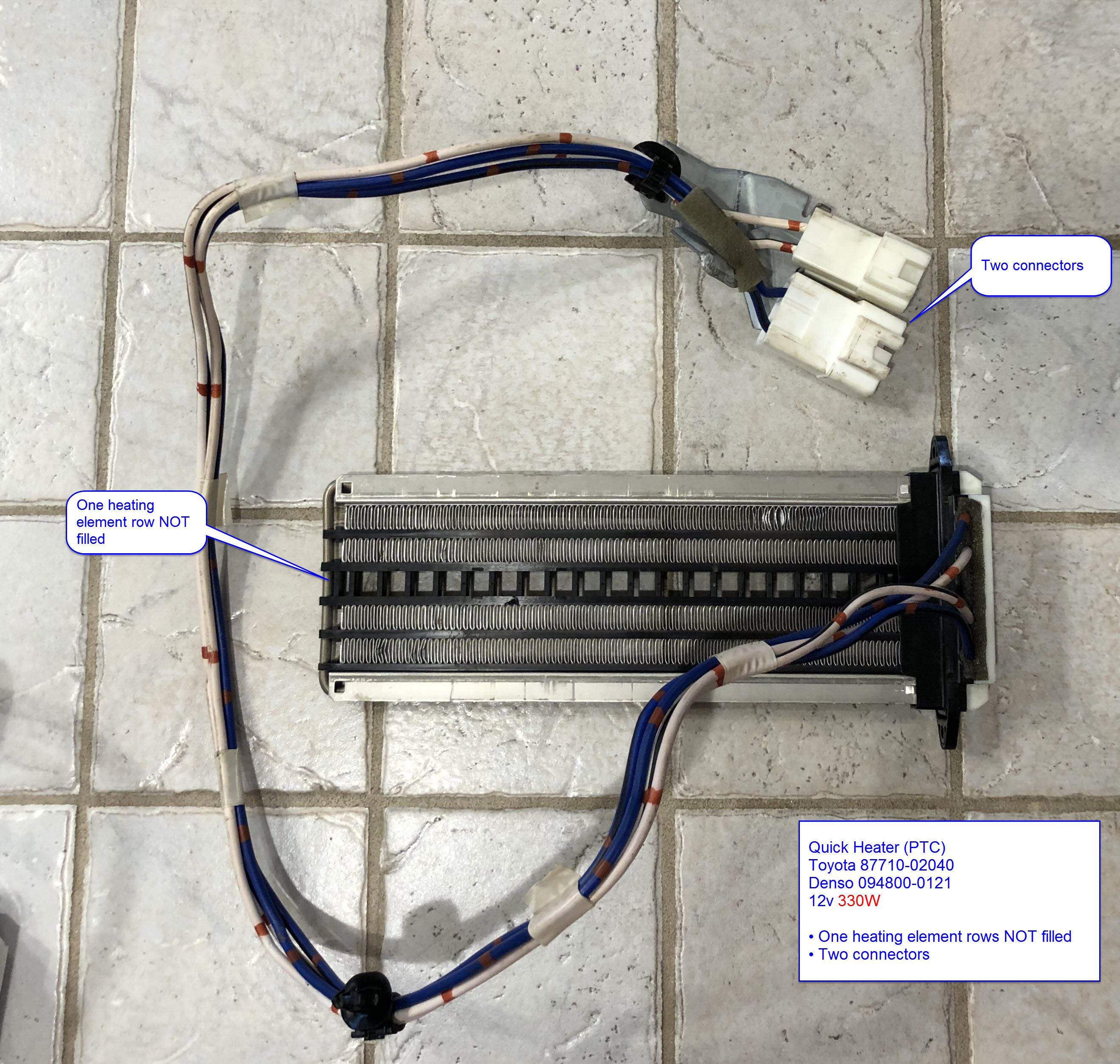

Toyota 87710-02040
Denso 094800-0121
12v 330W
2011-2016 RAV4 (VIN starts with '2')
2017-2018 RAV4 (some Limited/SE/Platinum)
2009-2013 Matrix
2009-2019 Corolla (with cold spec.?)

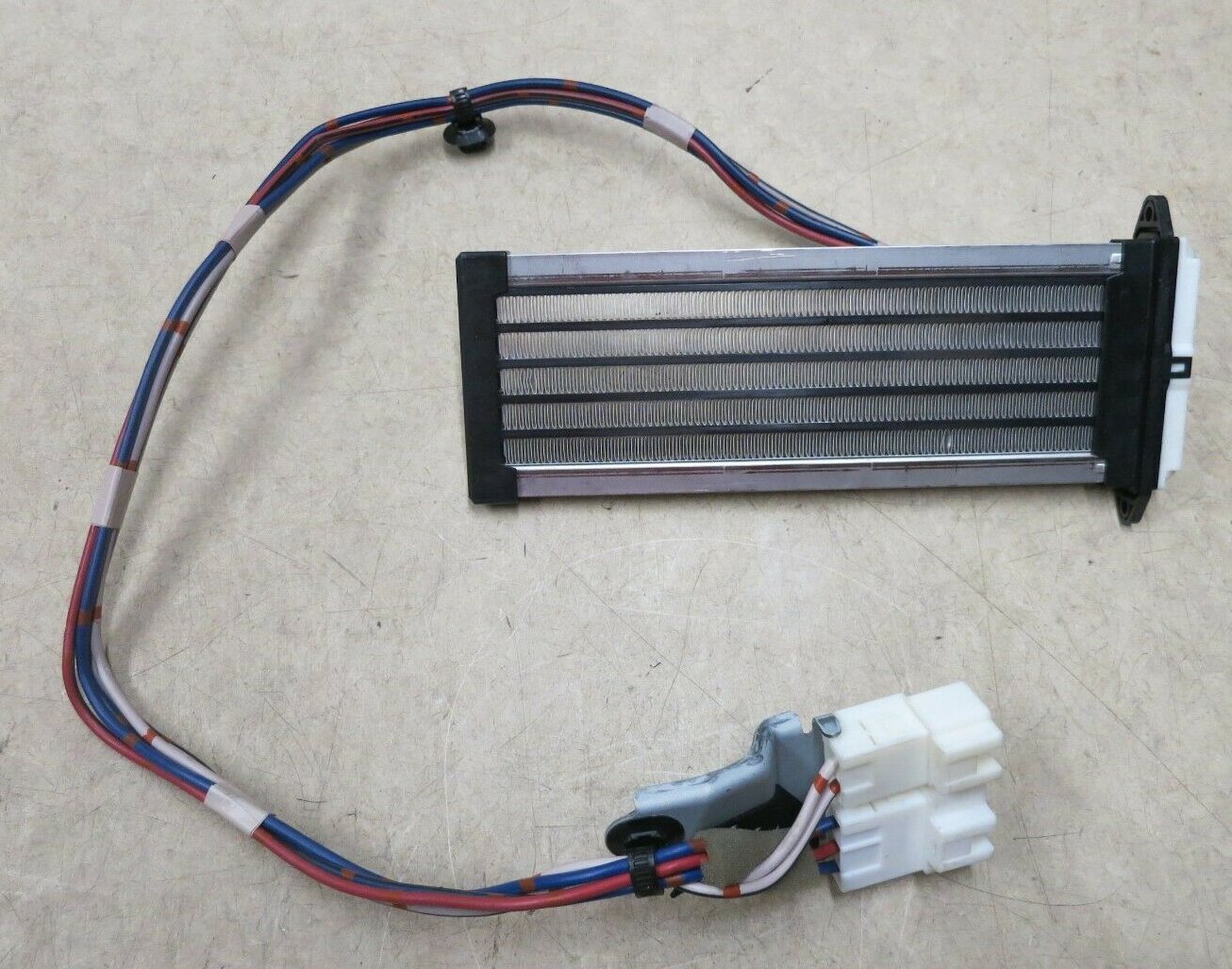

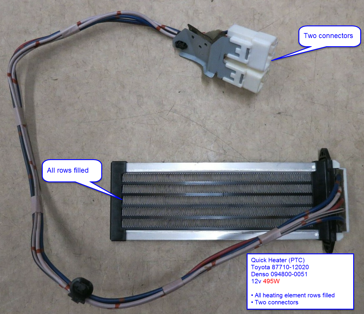

Toyota 87710-12020
Denso 094800-0051
12v 495W
2009-2017 Corolla (some)
2009-2017 Prius
2013-2018 RAV4
2015 RAV4 (2WD Outdoor Limited, Premium Limited)
2016 Scion iM
2011-2017 Lexus CT200h

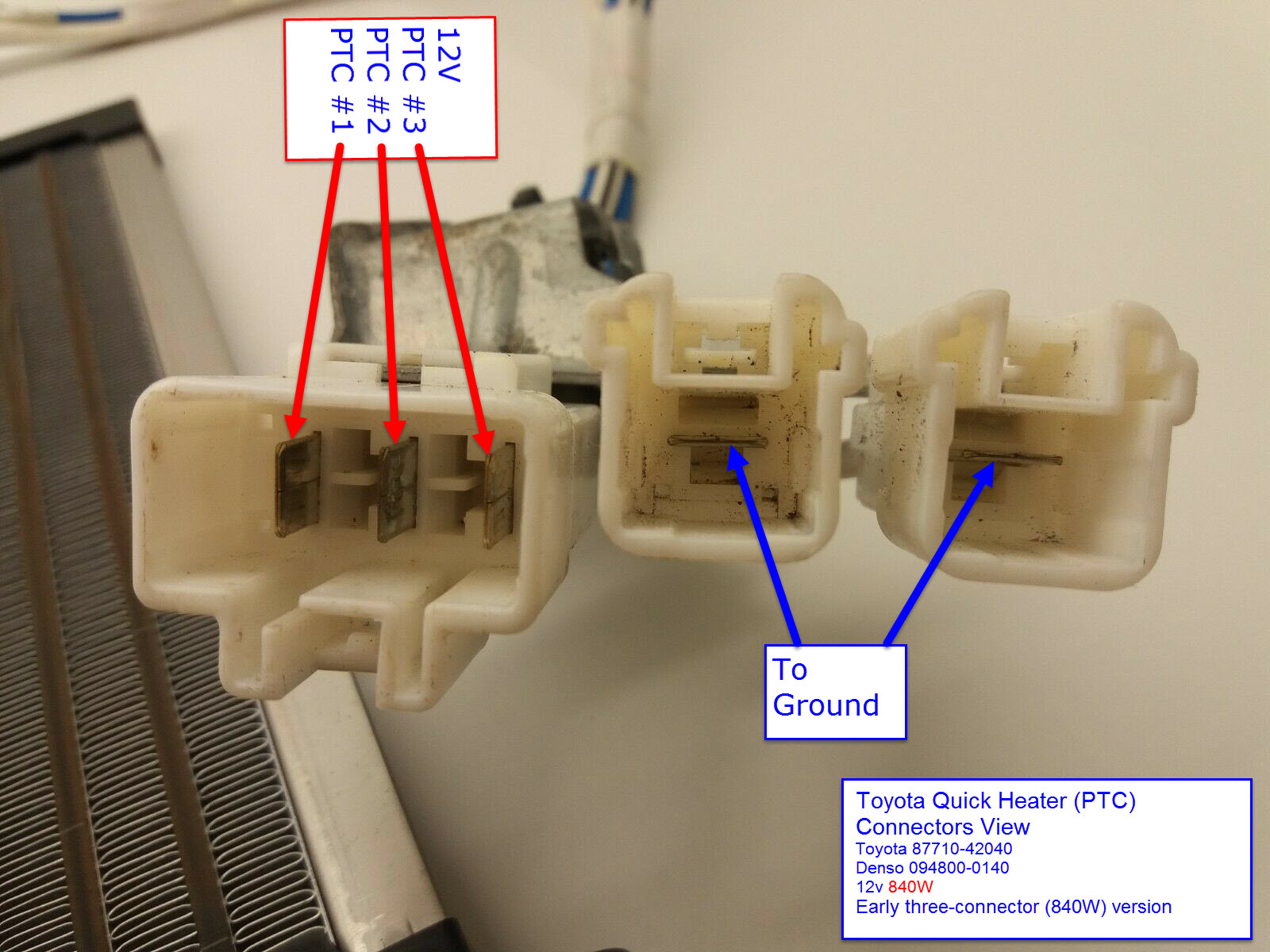

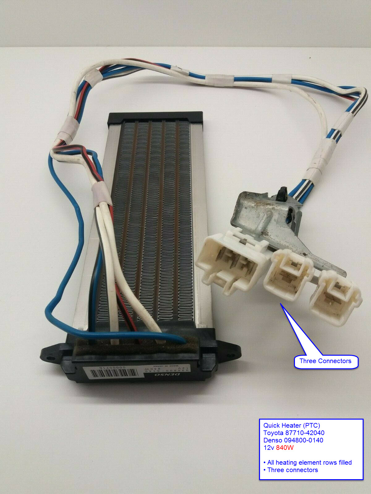

Toyota 87710-42040 (NLA)
Denso 094800-0140
12v 840W (three connectors)
2008-2012 RAV4
2012-2014 RAV4 EV
Toyota 330W PTC Quick Heater
Toyota 495W PTC Quick Heater
Toyota 840W PTC Quick Heater
Toyota 840W PTC Quick Heater, connectors view
A couple more views of the later 495W unit:

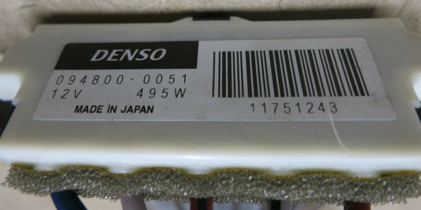

Toyota 495W PTC Quick Heater: Denso part No.

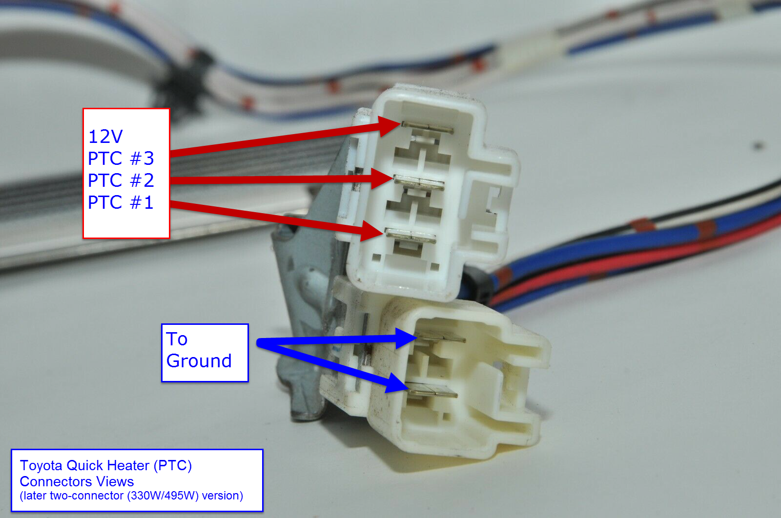

Toyota 495W PTC Quick Heater: connectors view

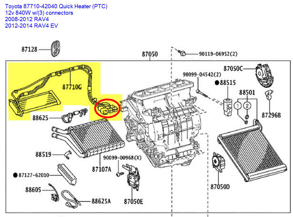

Toyota 840W PTC Quick Heater: installation location in 2012 RAV4

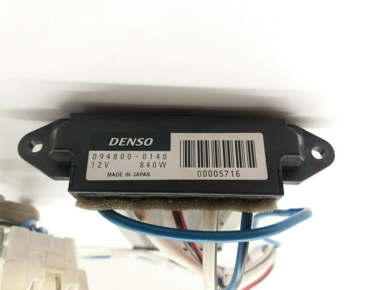

Toyota 840W PTC Quick Heater: Denso part No.

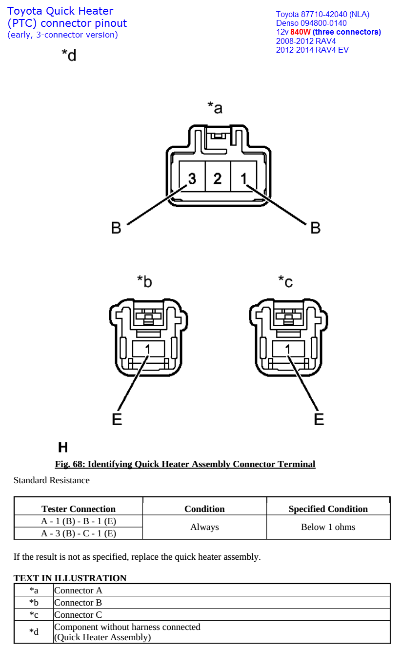

Toyota 840W PTC Quick Heater: Connector terminals diagram (early w/(3) connectors)

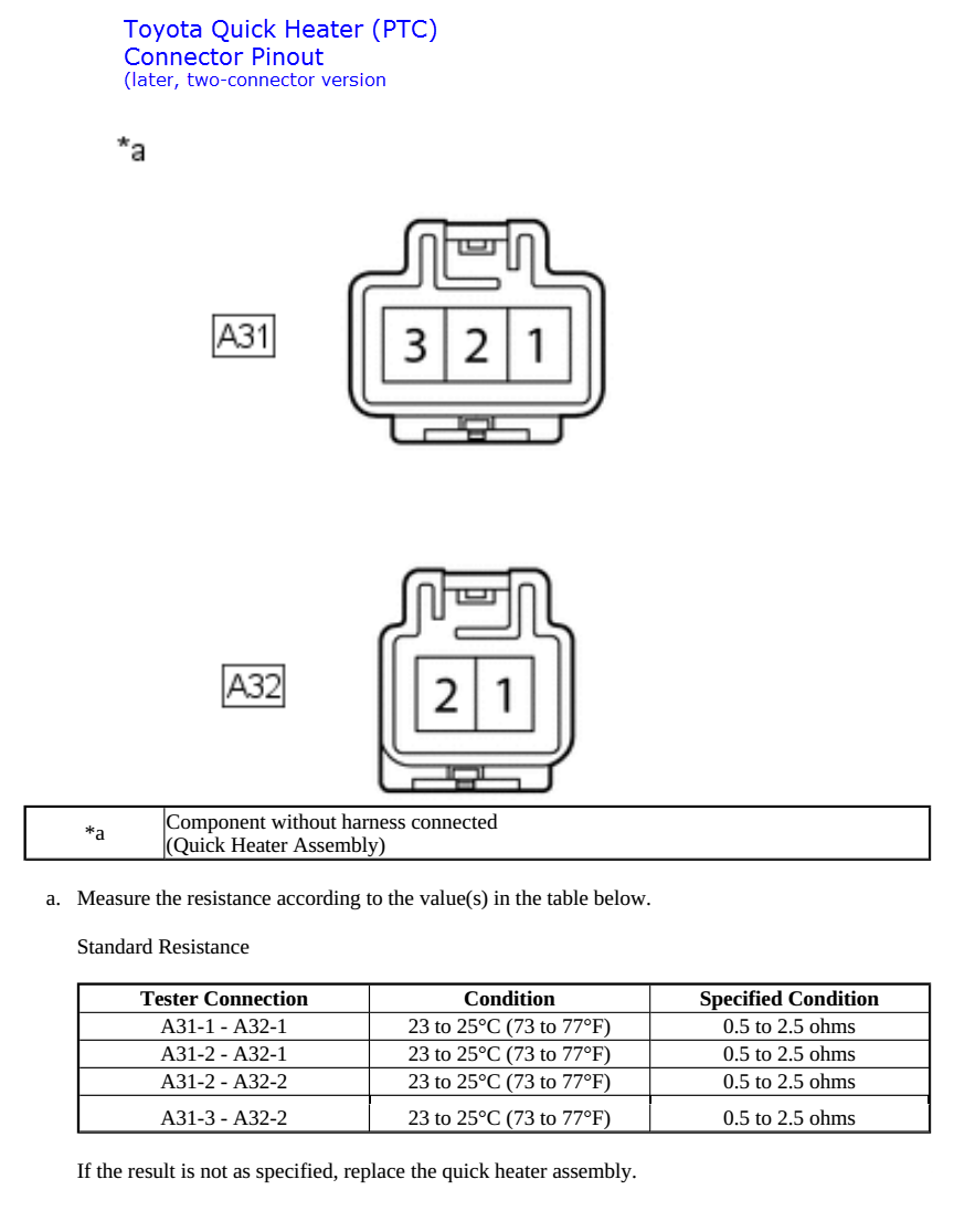

Toyota 495W PTC Quick Heater: Connector terminals diagram (late w/(2) connectors)

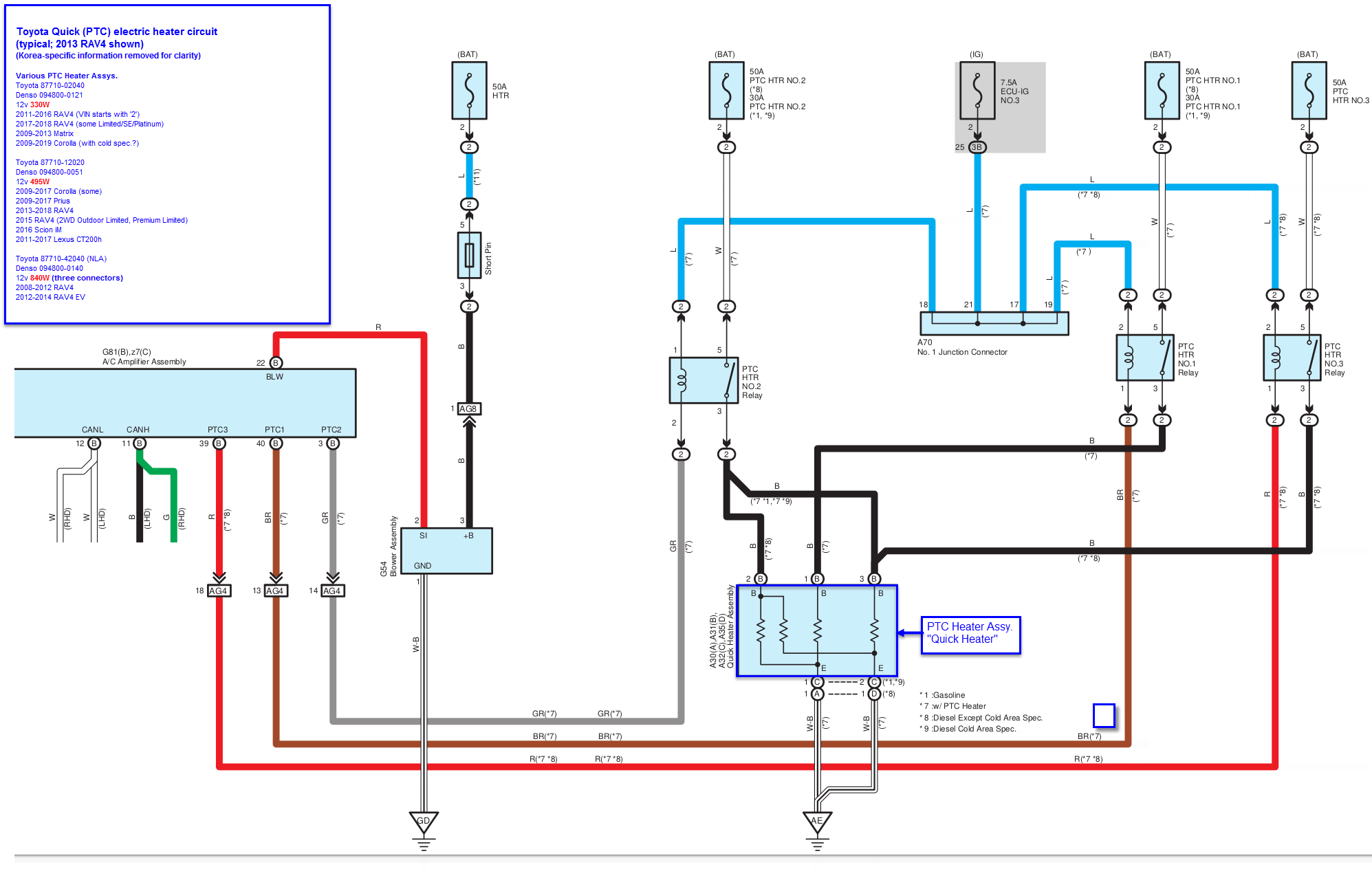

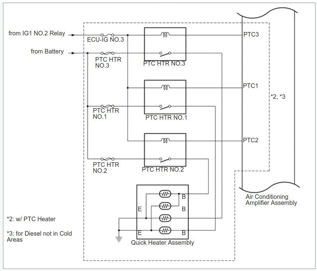

Typical Toyota PTC circuit, including both 2- and 3-stage PTC installations

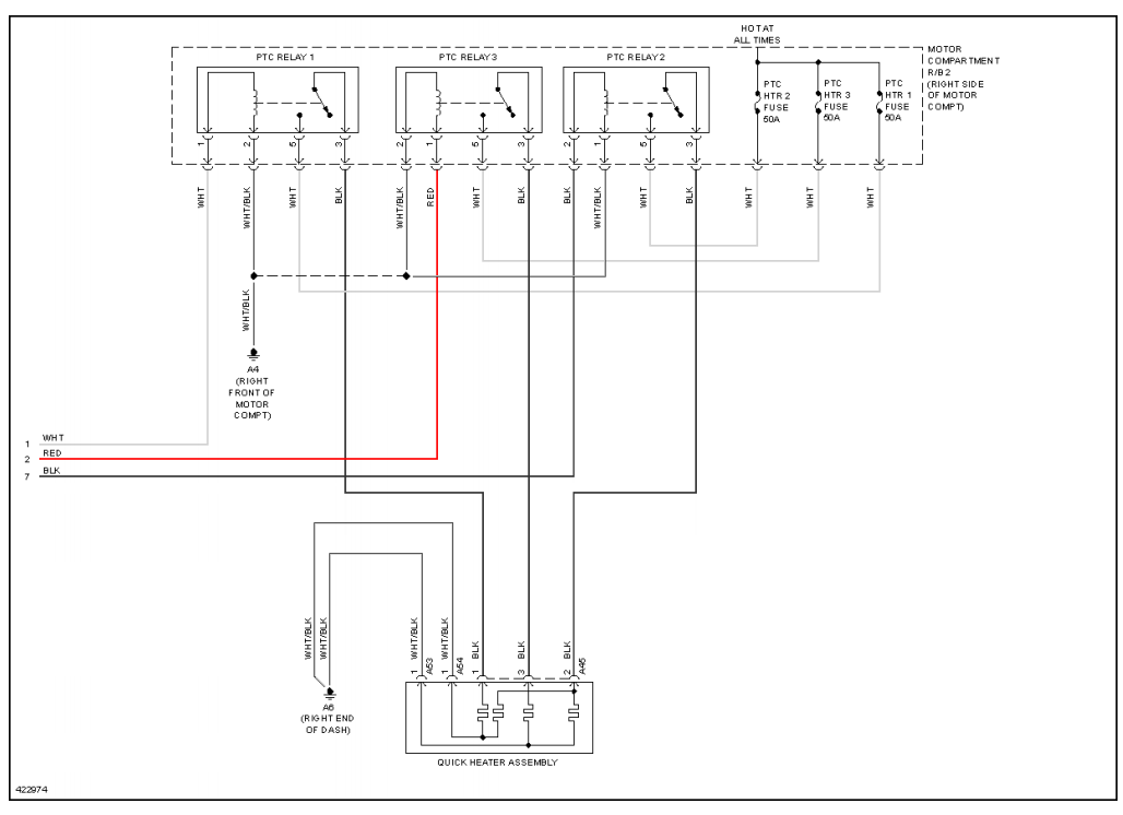

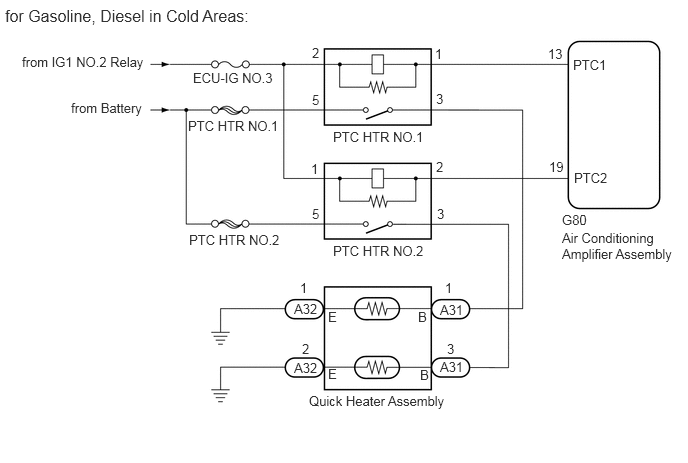

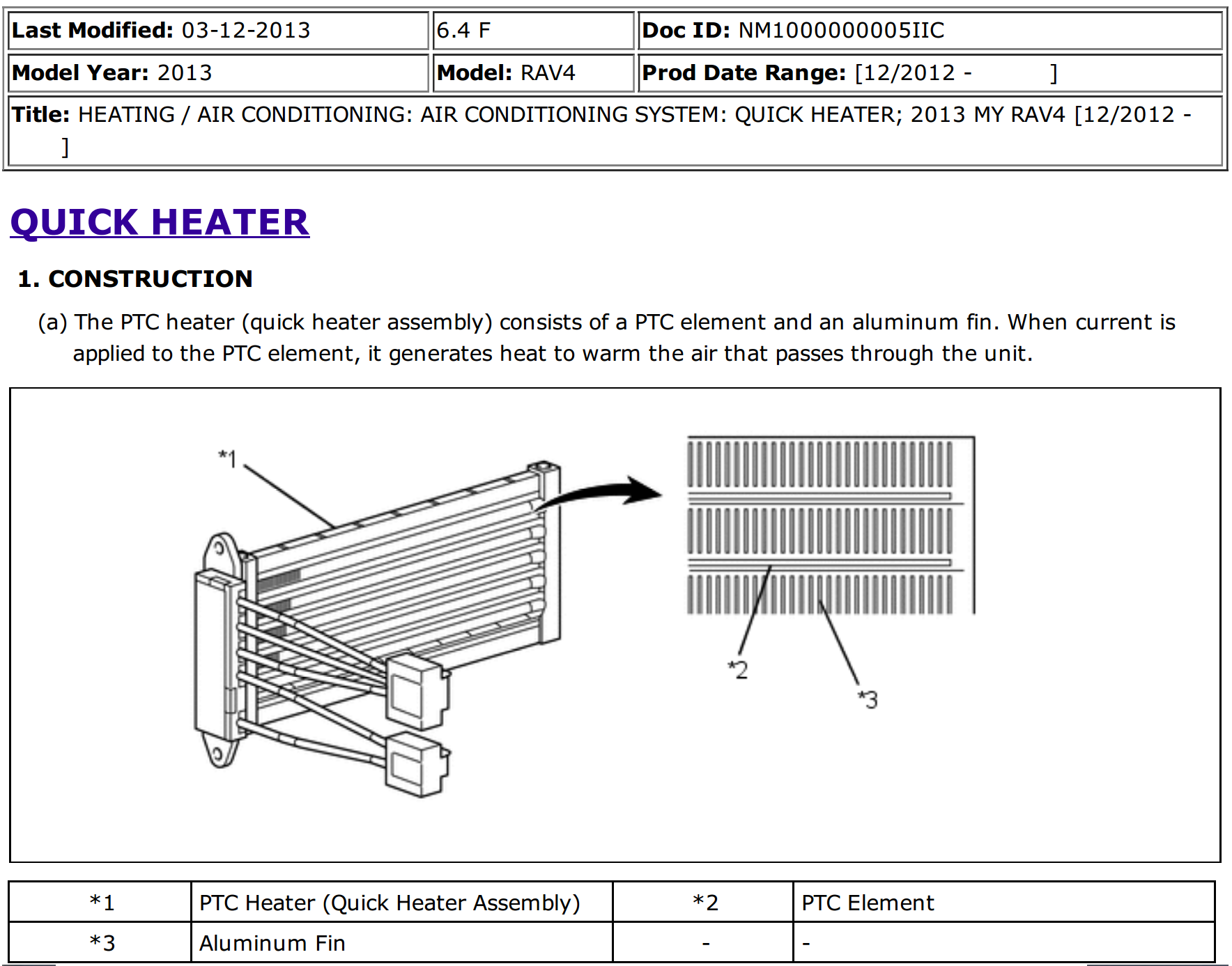

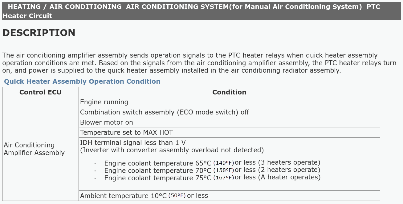

PTC system description

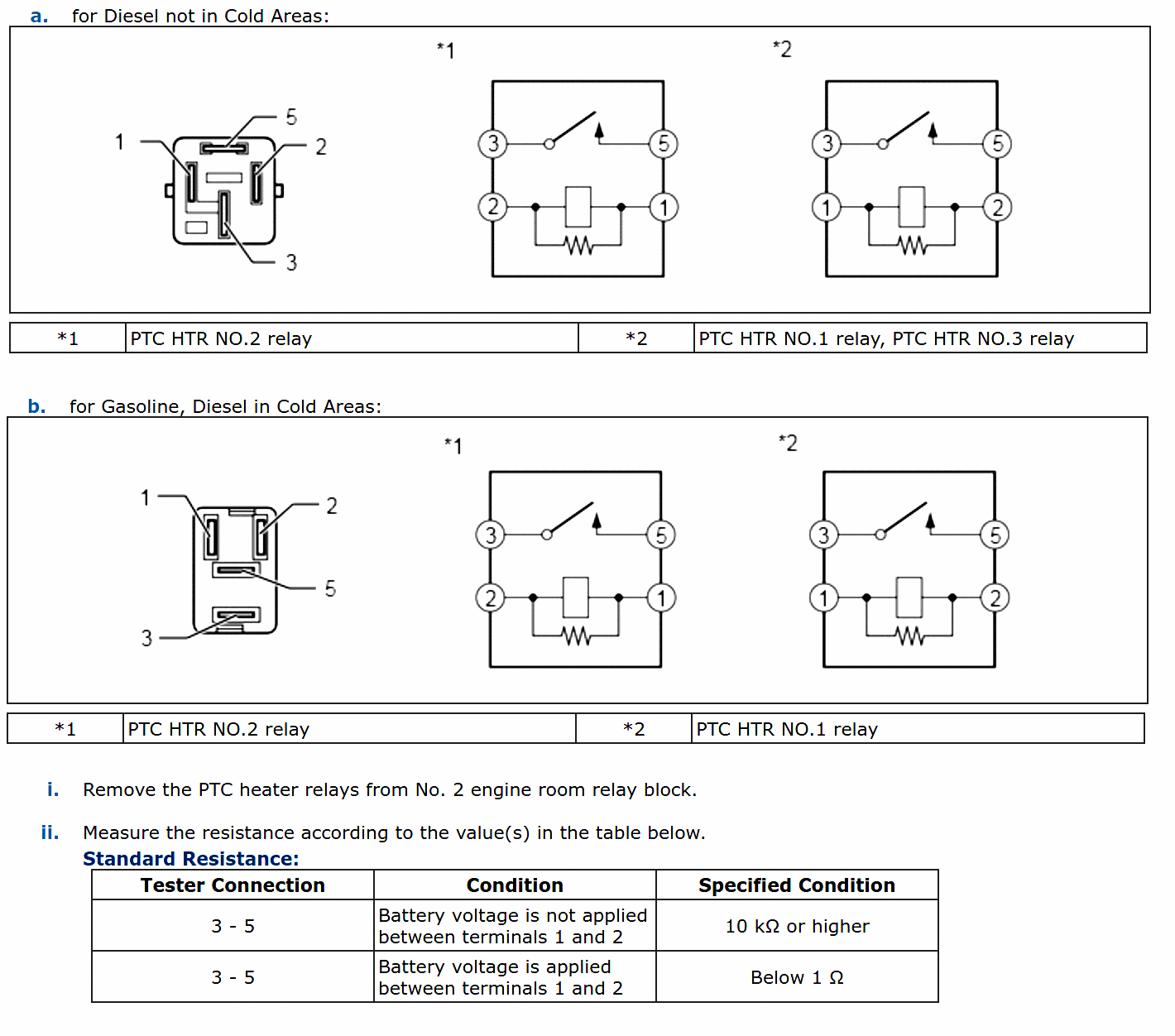

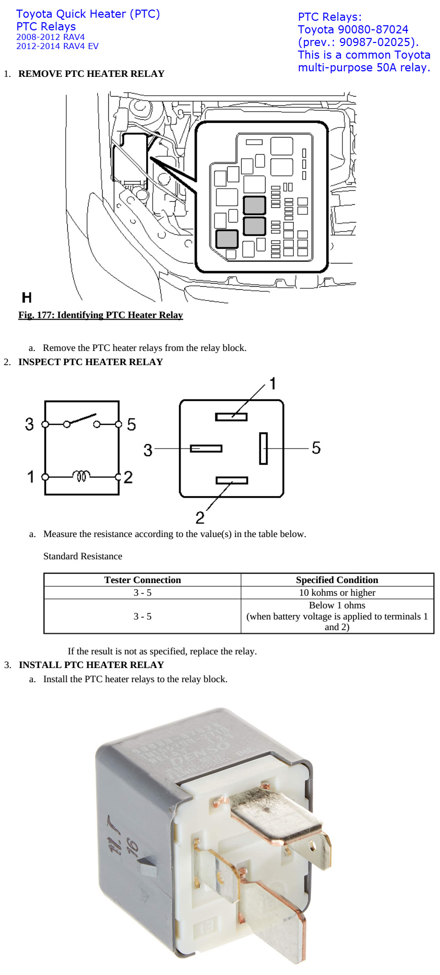

PTC Relays testing info

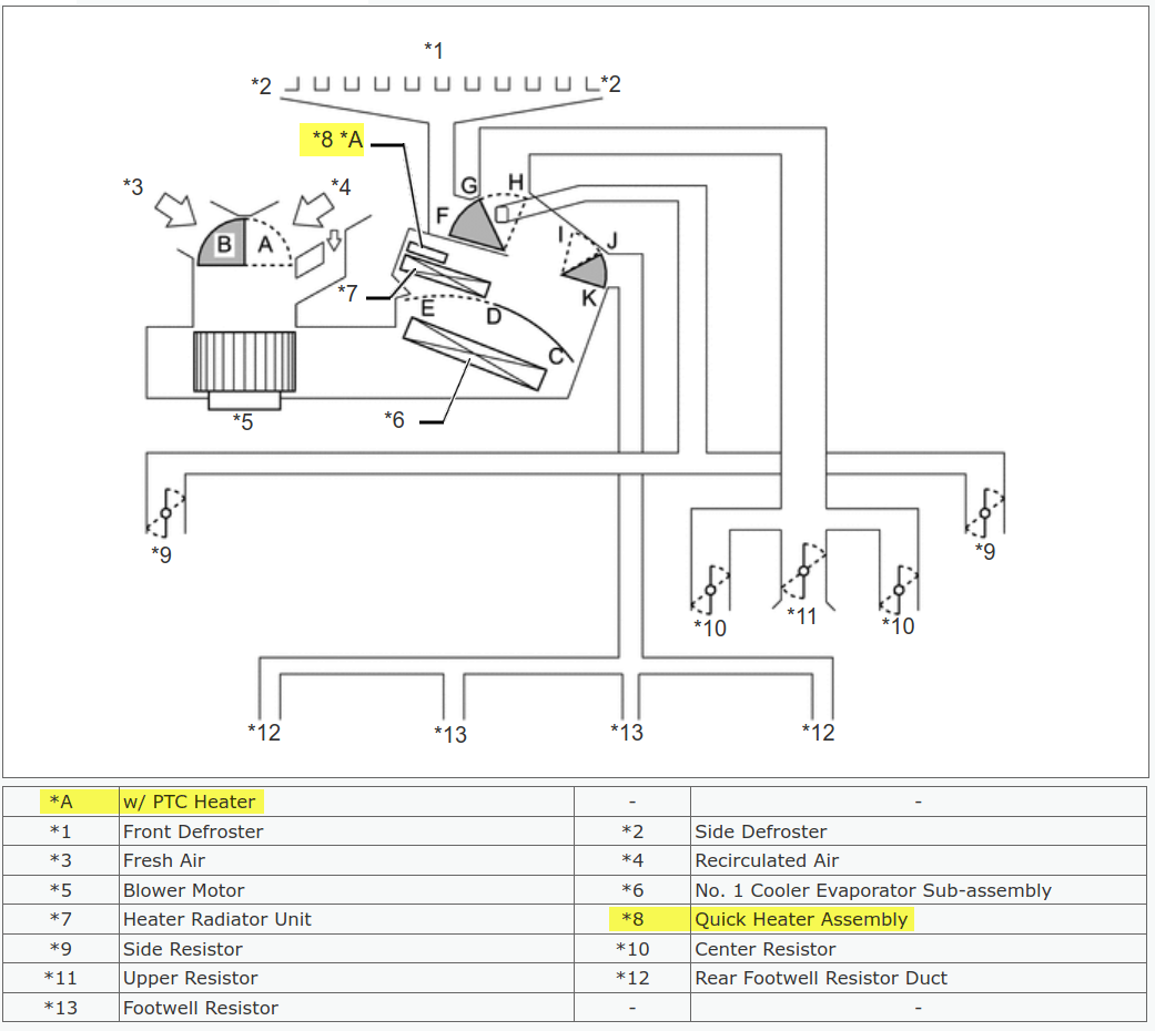

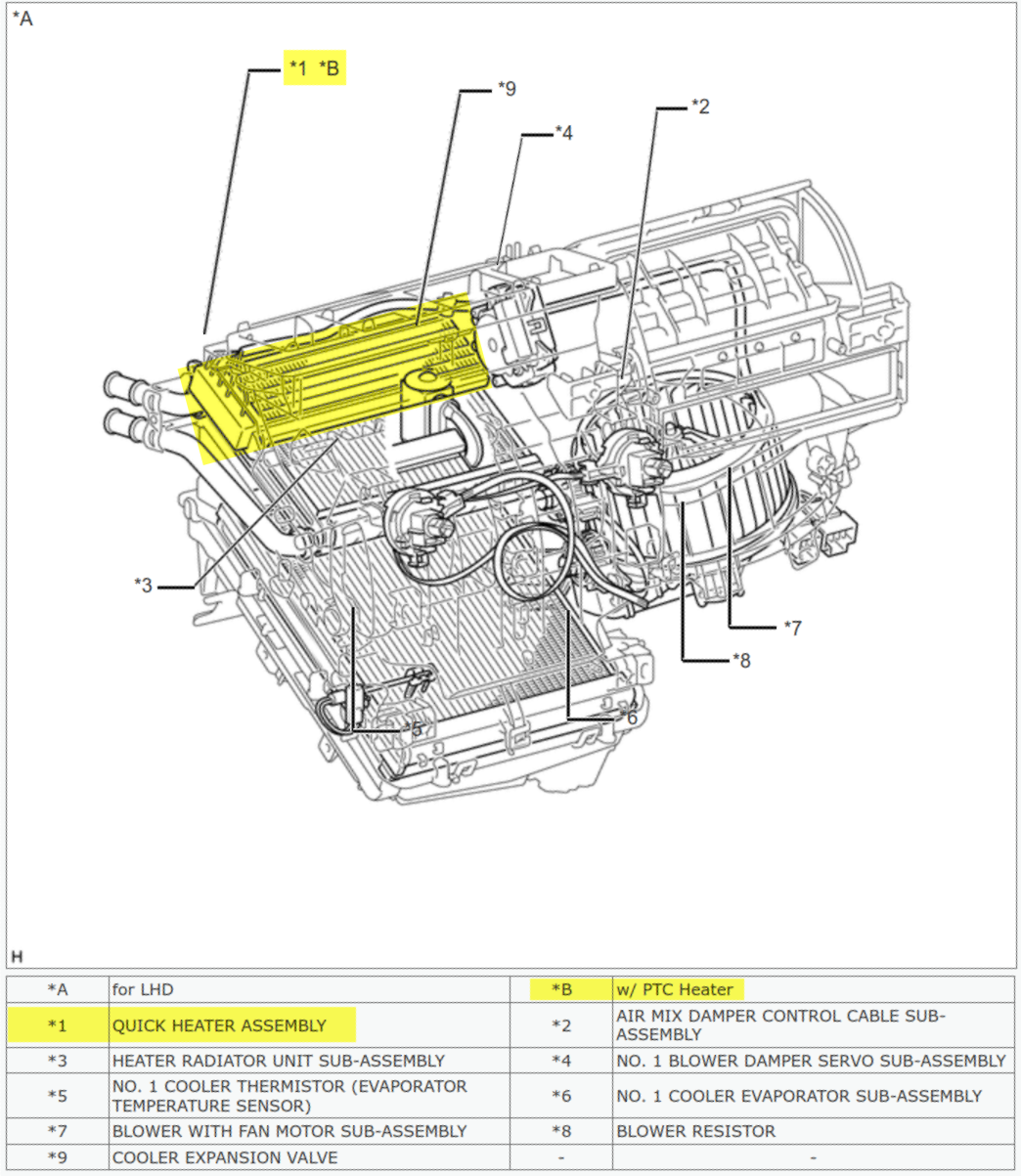

PTC Quick Heater location in A/C Assy.
PTC Quick Heater location in A/C Assy., left side view
