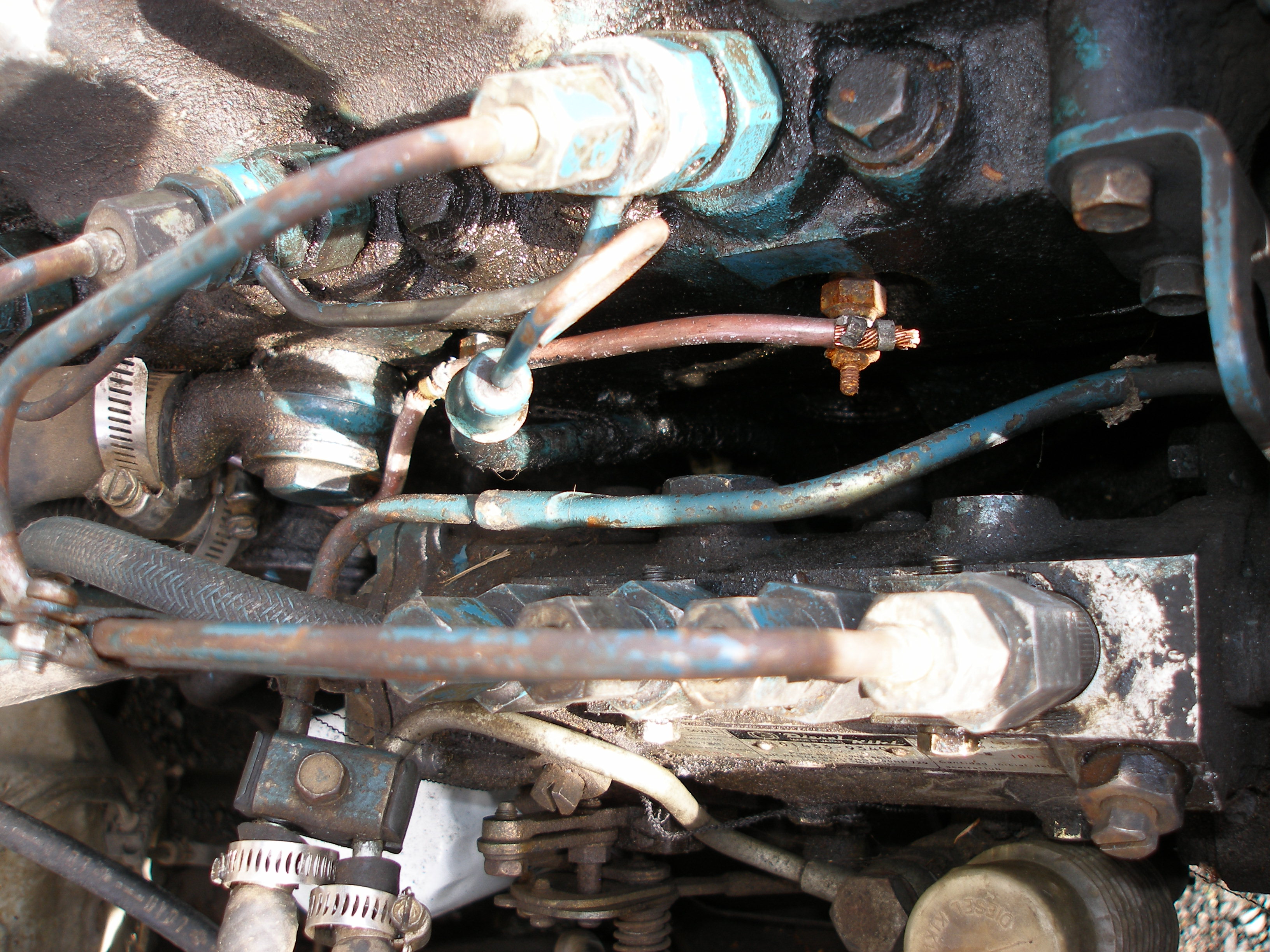

Image Image Image Image Image

This is the ONLY non-A/C intake hose that I've seen that is not cracked. You can bet I'm going to treat it with kid gloves!
New alternator belt. Block heater again (as has the SD from the "Bellingham Truck", same location) but no cord. Coolant "looks" fresh (peering in, not doing a draw test), and the engine oil is fairly clean, certainly much cleaner than usual.
GP bus has been replaced with 8ga wire, reusing the original terminals but not soldered. Testing tonight indicates that No. 1 GP has power at the terminal but not at the GP's stud (touch it and sparks!). Needs work in this area ;)
I was attempting to take a pic of the GP bus wire terminal here, but the camera's focus shifted to the No. 4 injector. Click on that image above and look at the return line where it meets the injector. See anything funny?

After a little while, fuel began spurting (I do not mean dripping) from the return line fitting at No. 4 injector, and dribbling from same location at No. 1. Exactly what happened to Zoltan happened here. Fortunately, I picked up a spare return line and three injectors at the JY last Sunday, so I have spares.
After about three minutes the smoke was still fairly heavy (working in the dark, hard to quantify) and one cylinder starting nailing (hammering) so I backed down the manual throttle for about a minute, which shut it up mostly during that time. Evidently a bad injector or crap in it -- same thing.
Fuel filter is the '81 style with no water-in-fuel sensor.
I'll play with it more this weekend, pin down which injector and possibly try to swap in a JY one -- though the JY injectors look more like cores to me, than swappable good ones. And I'll swap out the steel return line, so it can be driven to the car wash and be de-grimed.
