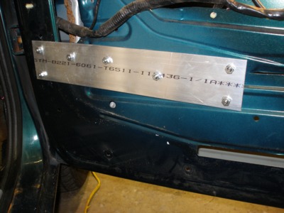

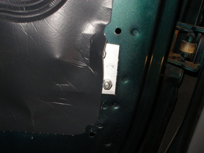

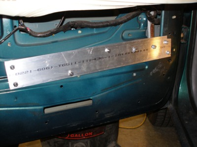

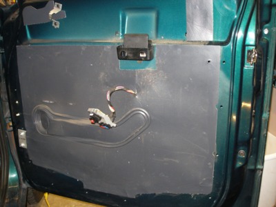

Just like our Gen1 Maximas, Aerostars that have power windows tend to crack their inner door skins. When the door is slammed, the door frame stops but the mass of the PW motor "oil cans" the inner door skin. After enough repetitions, the sheet metal's sharp creases crack, and cracks develop around the spot welds of the inner skin.
My Grey '89 Aero had very bad cracks in 1999, when I first went in to replace the first set of PW motors, and I reinforced them with aluminum flatbar. It was tough work, as access was poor. When I later had occasion to obtain an entire window regulator from a JY, I found that most of the PW doors in the JY had similar cracks in the inner door skin, though few were as bad as on my Grey '89.
When I had to put a second driver's side PW motor in, in 2006, I took a pic of the reinforcement I'd done seven years earlier to both doors:
(click on most images for larger)

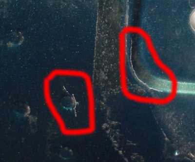

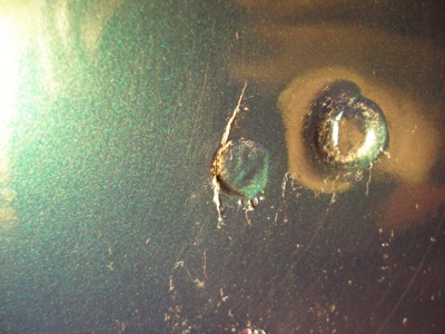

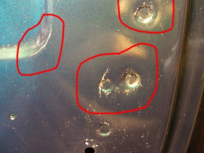

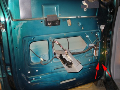

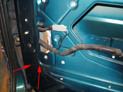

My blue '90 also had severely cracked door skins, like my '89. I had them welded, which is not as permanent fix IMO, as it does not reinforce the metal.
So it was that I was not surprised to find that my '93's inner door skins also have some cracking, though much less than I expected. The doors' inner skins have been redesigned in the intervening four years and access to the PW motor and window regulator is much better on these newer doors. The severity of the cracks is much less on my '93, but then again this Aero has half the miles of my old Grey '89.
I used some 3/16" x 2" alum. flatbar, and took out two of the alum. pop rivets that retain the window regulator to the inner door skin, replacing them with 1/4" bolts.
Nothing is exposed after the interiour door panel is reinstalled, and the fit is fine.
