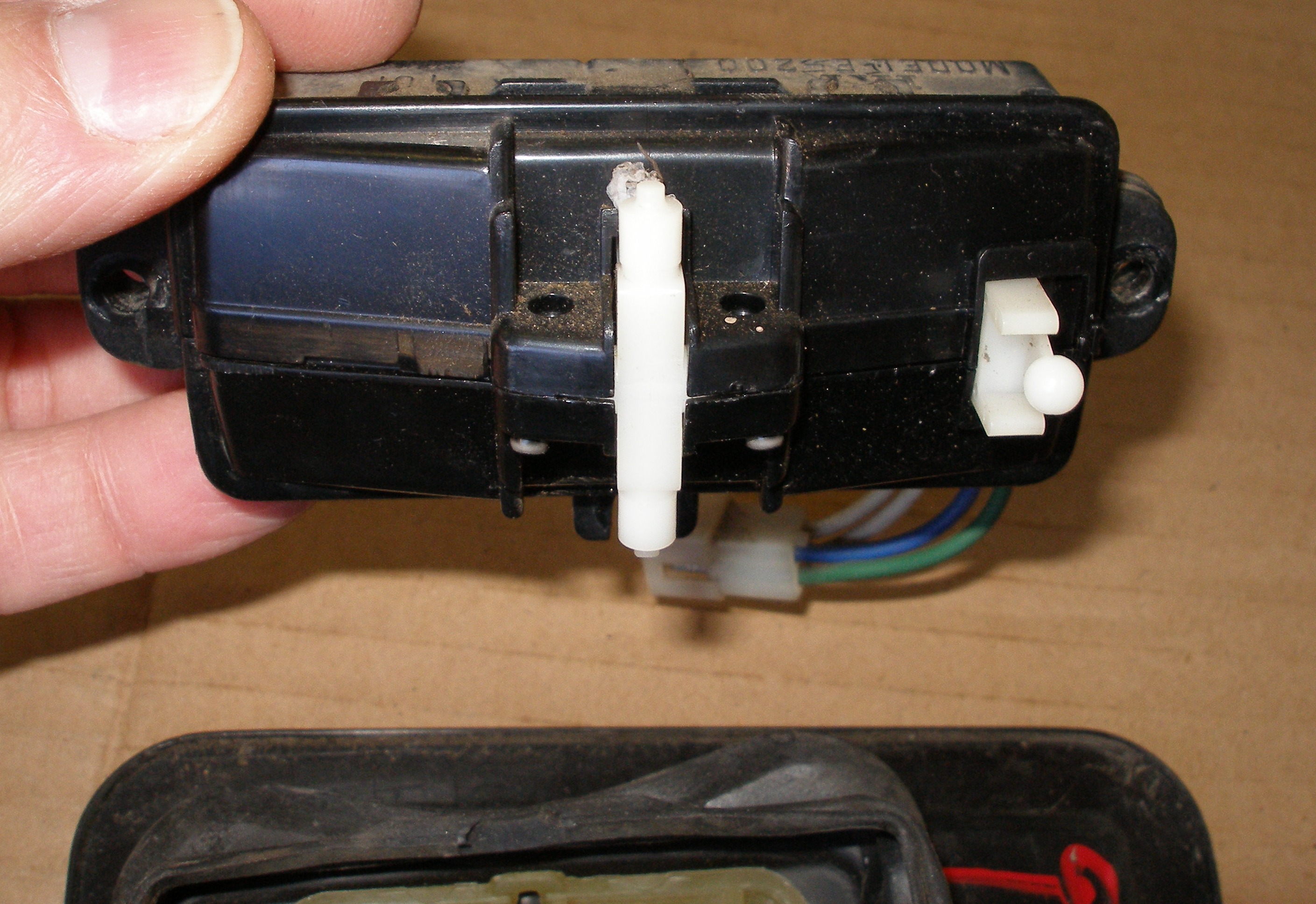

I picked up a passenger-side outside rearview mirror assy. from the JY that was already disassembled -- in the past, these almost always break when I try to remove the mirror. You can see the problem: old, brittle plastic, two axles that snap into place, and one plastic balljoint. The ball separates easily, but the axle . . . well, I suppose now that I see how it's assembled, I'd try with a metal pick and attempt to spring one of the yellow ears back enough to release one end.
(click on most images for larger)

In the 2nd photo, is the larger dark (black) area the back of the glass mirror? Is the "yellow" (looks dirty beige/green on my screen) mounting plate set in some kind of cast dark plastic pocket that's in turn glued to the back of the glass? I'm having trouble transitioning from the front view of the mirror glass to the back view. If I have it right, the motor appears to be mounted off center and a little high (or low? which way is the mirror flipped?). What holds the motor into the hood?
I'm mildly interested because I find the OEM mirrors have a relatively flat curvature that leaves serious blind spots which the more convex side mirrors found on newer cars don't. In theory this could be changed by changing out the glass or changing out the complete mirror and mount assembly with something off a newer car; of course, be nice to find one that kinda matched the squarish style... A crap shoot either way to find something appropriate. It's all TBD at this point, but knowing what's in there really helps in changing the glass. Thanks for the pics.
- Posts: 5462
- Has thanked: 5 times
Yes.rlaggren wrote:In the 2nd photo, is the larger dark (black) area the back of the glass mirror?
Probably. I don't have those pieces anymore (Mark has them) and didn't look too hard when I had them; perhaps Mark will read this and pipe up.Is the "yellow" mounting plate set in some kind of cast dark plastic pocket that's in turn glued to the back of the glass?
There are bolts from the mirror outer housing and pedestal into the door. I don't have any pics, sorry. You can unbolt the assy (pedestal) from the door from inside the door. But you can't unbolt the outer housing from its pedestal without removing the glass -- this has been discussed here before.What holds the motor into the hood?
I have a spare brown mirror in storage (pass or driver, I can't recall) from an '83 and can send it to you for a modest fee (I don't need it), should you want to experiment with one.
